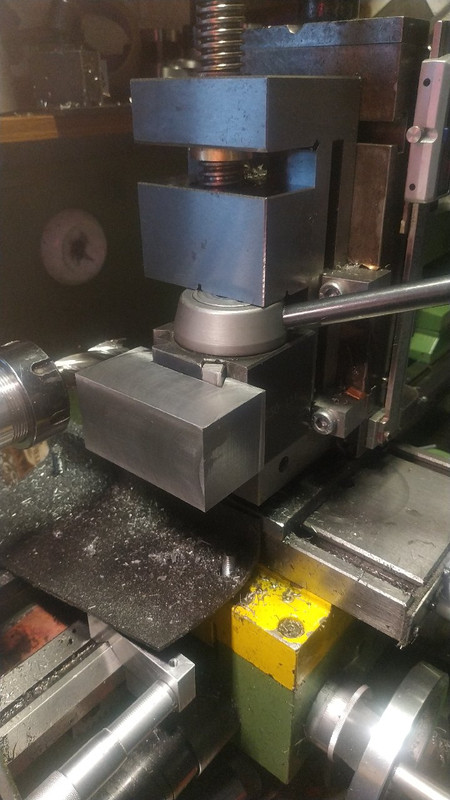

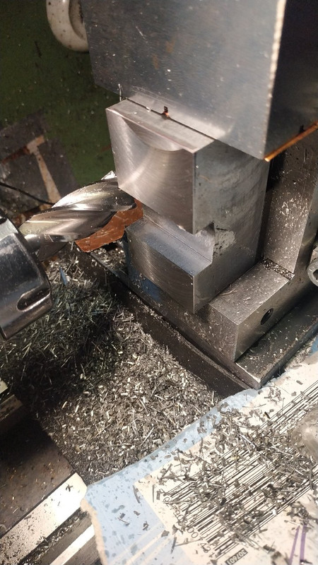

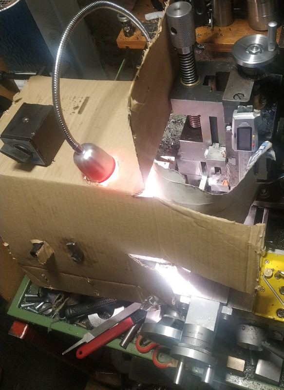

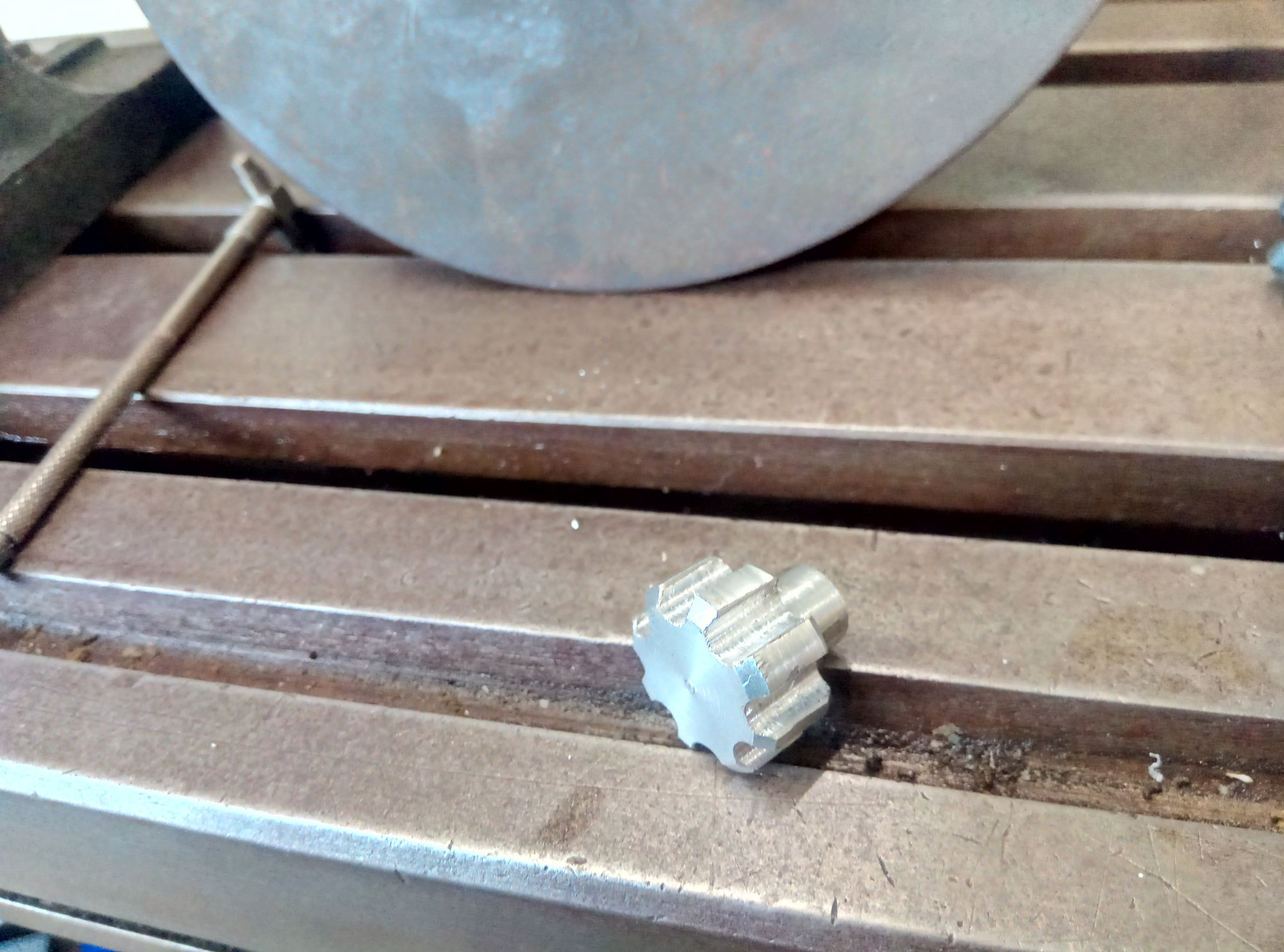

I really don't know how you cope with that, I have seen perspex / polycarbonate screens about a4 size positioned on mag mounts, might be worth your while to make something similar.Face milling with the work towards you. This launches blue hot chips upwards. And down the back of the neck!
My hot chips learning curve extended to burning both fore arms yesterday after discovering that ground HSS can take much deeper interrupted cuts than the inserts I have been destroying in the past.

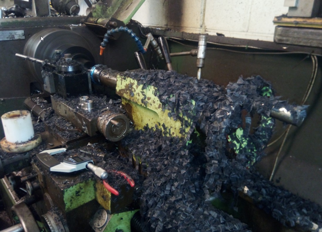

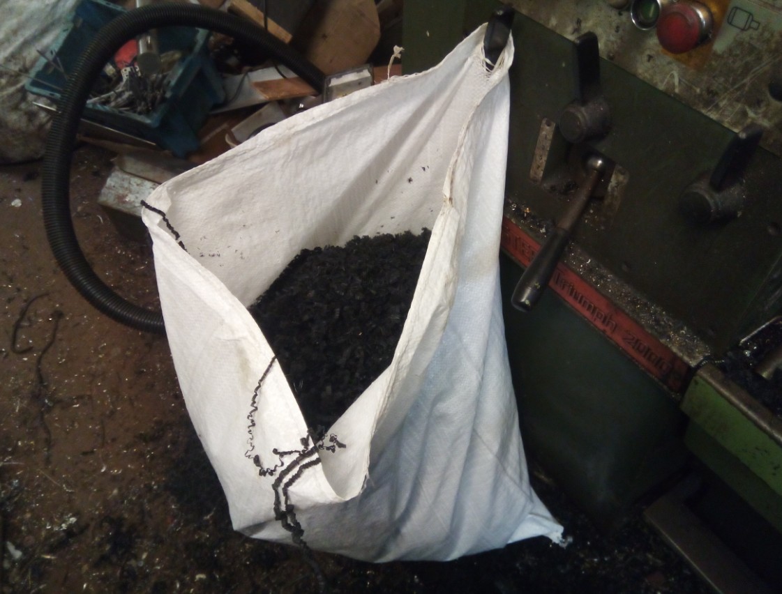

Delrin makes a mess? surely not Good thing though it is easily cleaned up. Brass however is a PITA, months later you will still be getting stabbed with the wee needles.
View attachment 229025 View attachment 229026
Best thing for it is to have a CNC, the same mess but all contained
You are either a sadist or you do not do much cast. (edit, should be masochist I think although you may be both )I love machining brass but cast iron is my favourite.

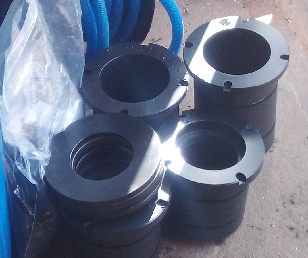

I used to do a lot of hauler plates on the manual lathe and had to wear welding gauntlets whilst cutting the face tapers with the compound slide. Now I do them on the CNC and the worst part is cleaning up afterwards as cast iron is not the best for a lathe and also will set like concrete if flood coolant is used and it is not cleaned up right away.
This is the small ones I do, 13" , most now are bigger, 17" and 19"
Dry is the normal way on a manual lathe but flood helps control the mess on the CNC.I have only ever machined nice high quality free cutting cast iron.

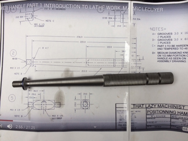

I actually love working with Delrin, well usually Acetal but basically the same. It cuts nice and although it makes a mess, as you say, it vacuums up easily. You can take massive cuts, the depth of which is limited by the insert edge length, so with a DNMG 15**** that is a lot off the dia in one hit Only downside is if you need tight tolerances it can take a bit of work, these had to be +0/-0.02 for some strange reason, in fact I had to actually redo one because although it wasn't out of tol the tube was. Normally I measure the tube and make to suite but I was told to make to drawings so that is what I did.

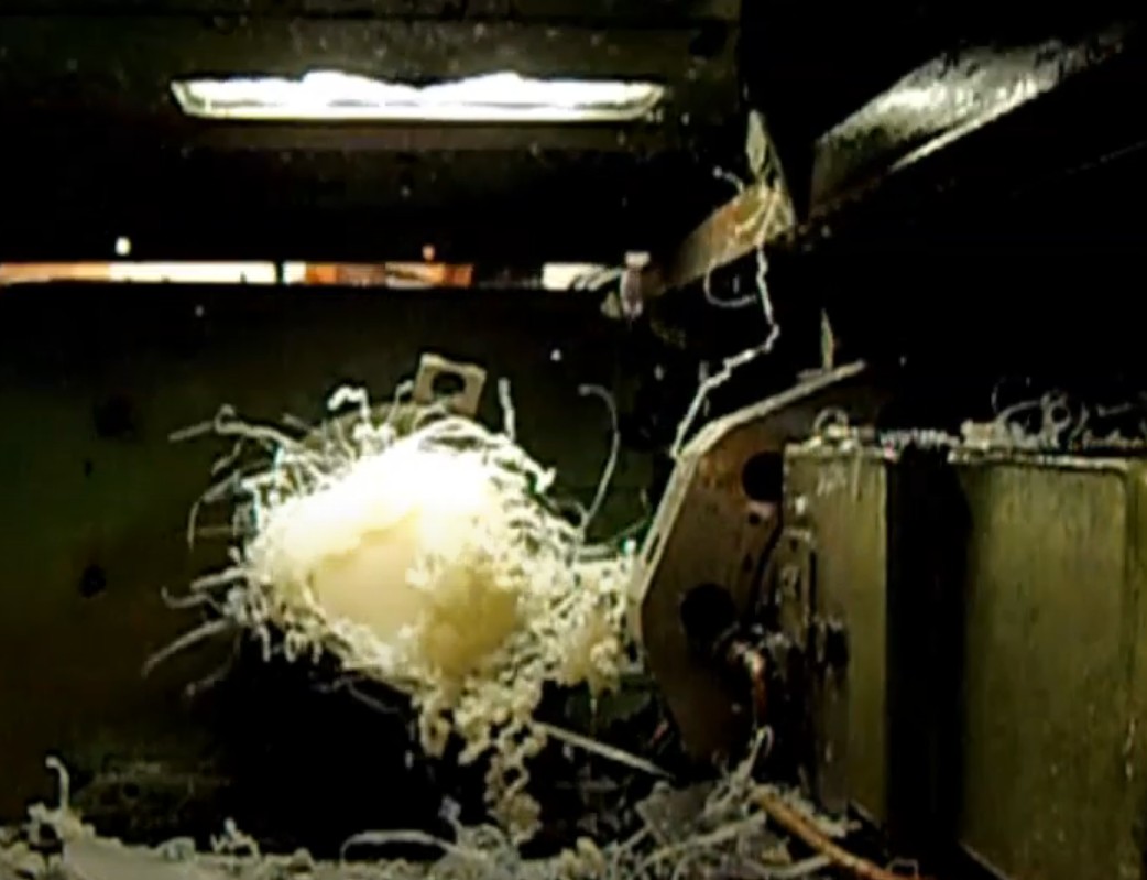

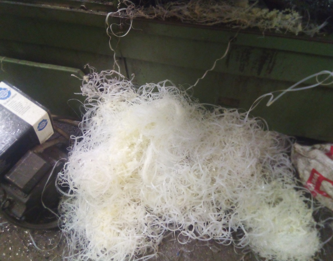

Nylon however I hate, horrible bleeding stuff that will slice your fingers off if you are stupid enough to get in the way of the stringers getting wrapped round a chuck. I have had tools pulled out of the turret before with nylon.
On the CNC it is not too bad as you are out of the way.
Nylon fumes are not bad, Delrin/Aceatl however are a bit potent. Worst thing is if it catches fire you don't notice until the fumes hit your airways and nearly choke you to death. You can hardly see the Delrin/Acetal burning as it is a tiny surface flame and not noticeable, well until you breath it that is.I remember my first go drilling nylon, near knocked my self out with the fumes.
I learned my lesson years ago, had a stainless bin full of Acetal swarf and had been welding nearby, eyes started to stream and started choking, couldn't see the flames but knew what it was right away so threw a soaked cloth over the bin then dumped a bucket of water in it
BTW that is an easy way to identify Delrin/Acetal, put a lighter to the edge then have a quick sniff, you will soon know if it is or isn't
