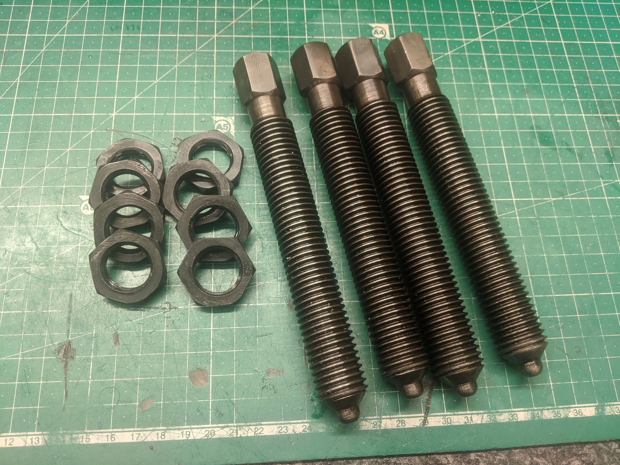

What stock did you use? I haven’t got my mill working so can make a hex.

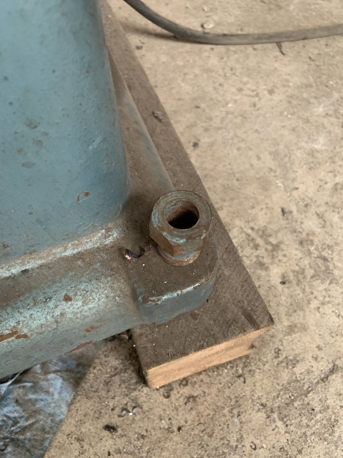

On my lathe the levelling screws have 9/16 holes to bolt it down once levelled.@Brad93
Just round bar I had, screws are EN1A and nuts are EN8M.
You can do a hex in the lathe but it is a bit of a rigmarole. I'd be happy to put a hex on something for you if needed but I'm quite sure there will be someone local to you willing to help.
Or just drill a hole to put a bar through?
My lathe is a weird hybrid, everything is metric apart from the leadscrew, all the fasteners are still imperial though (just like my mill)
What's the 9/16 hole for? The base of my lathe has threaded holes for the levelling screws.
@Brad93, to bolt it to the ground?
The manual for the L5A wants it to be levelled then the base to be mortared to the floor... It's not critical enough for me to go that far.

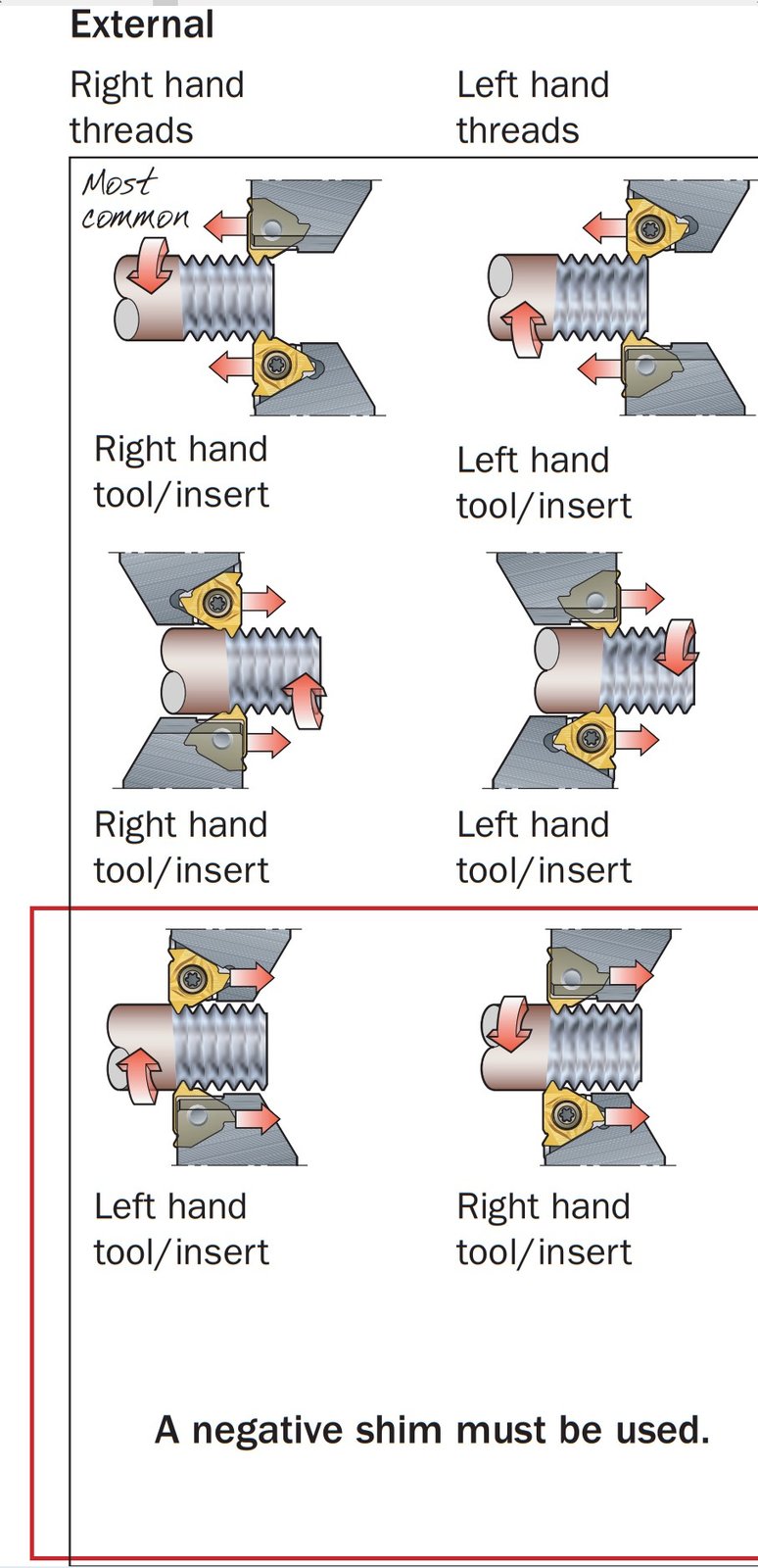

The screwcutting leadscrew is imperial so it cuts imperial straight "out of the box". I use a 127t and a 40t to cut metric with a 63t in there for the .75 pitches.
There's pictures of me making them a couple pages back.
