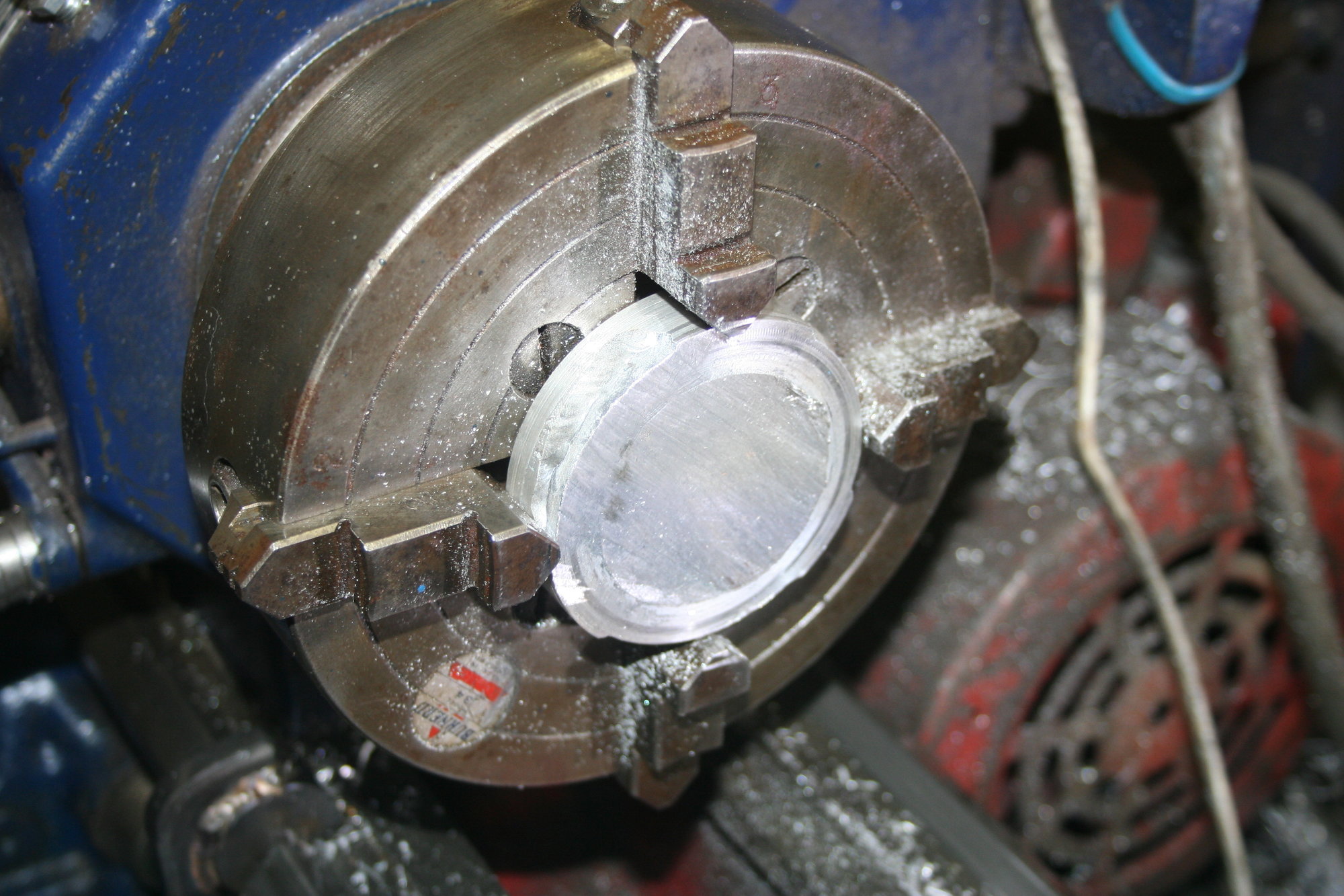

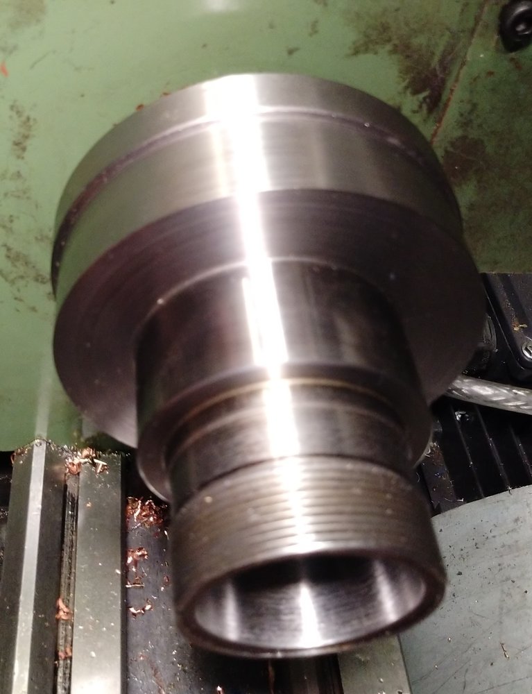

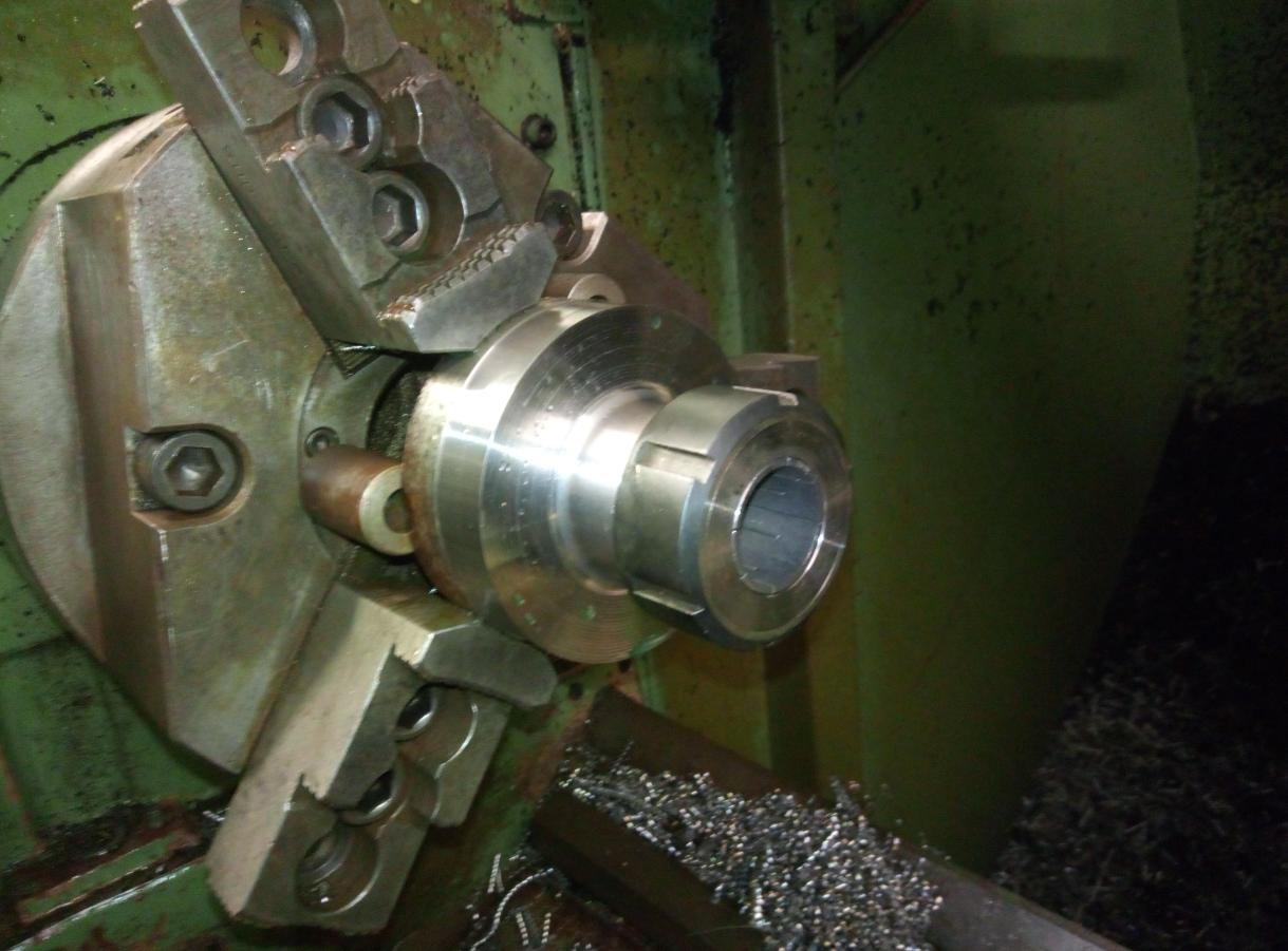

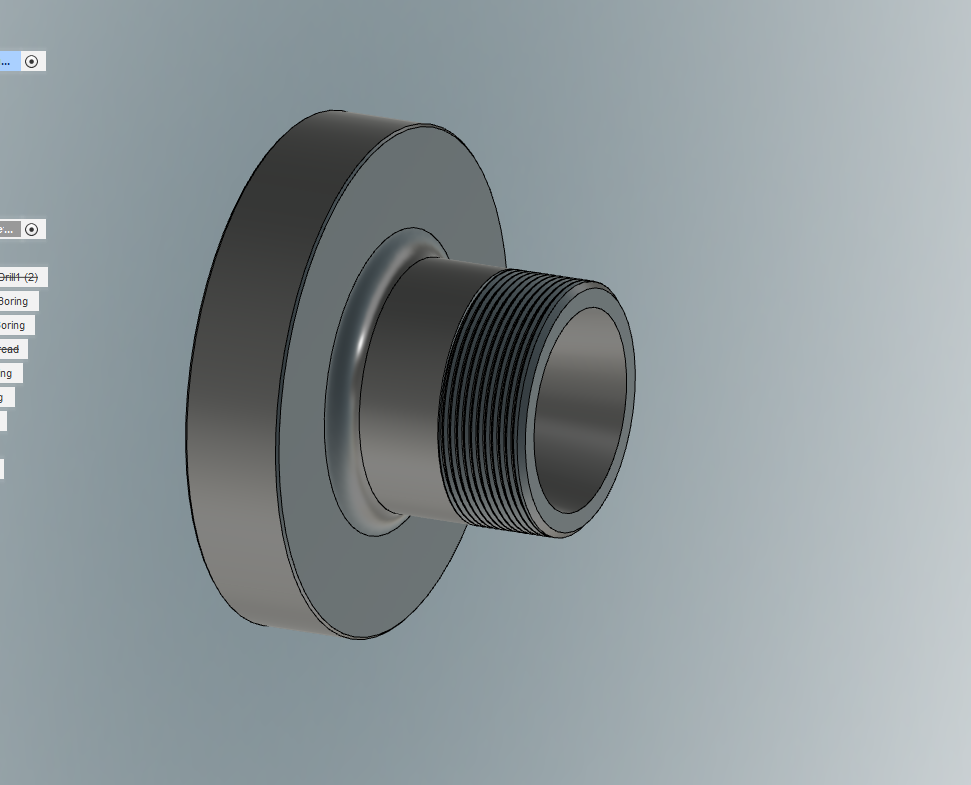

So as it was 11am I thought I will wait until I have my dinner then head up to the Cat. I had been looking for ER40 lathe collet chucks but they were all quite expensive so I had a look in the shed and found some 4" dia steel, some kind of tool steel but not sure what.

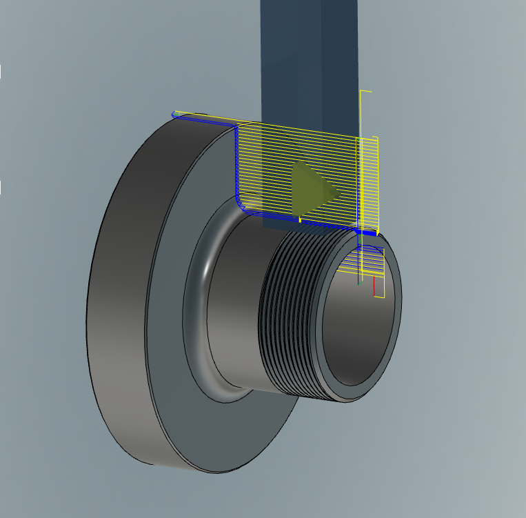

So started Fusion and drew this up.
The to Manufactirer side of Fusion for the toolpath.

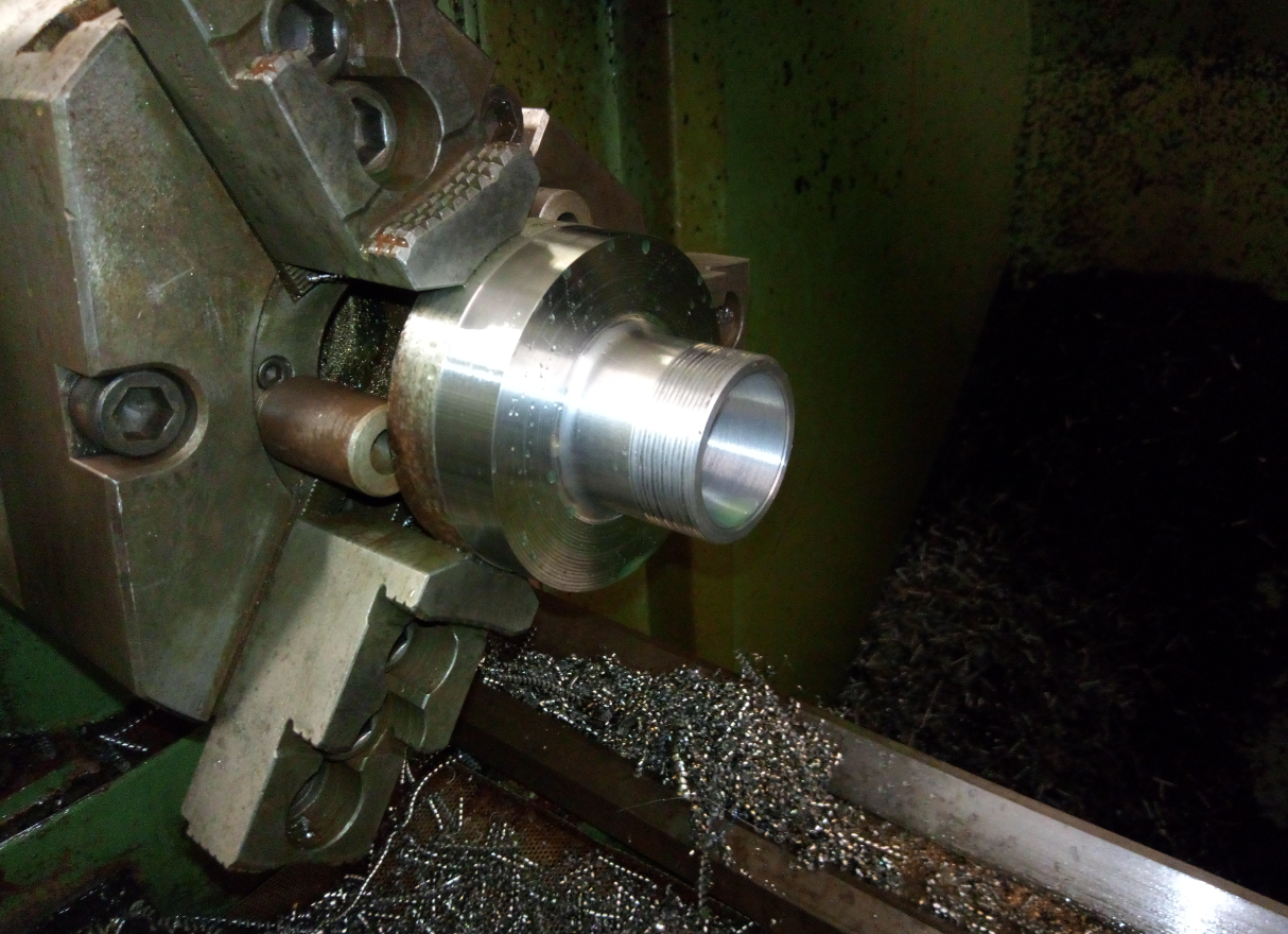

Then into the CNC with the steel and made this.
Collet and nut fit fine.
Not enough meat left to part off in the CNC so easier to just chuck in the Triumph using a bit of 25mm dia in the collet yu hold it.
So now I have an ER40 collet chuck for the lathe
