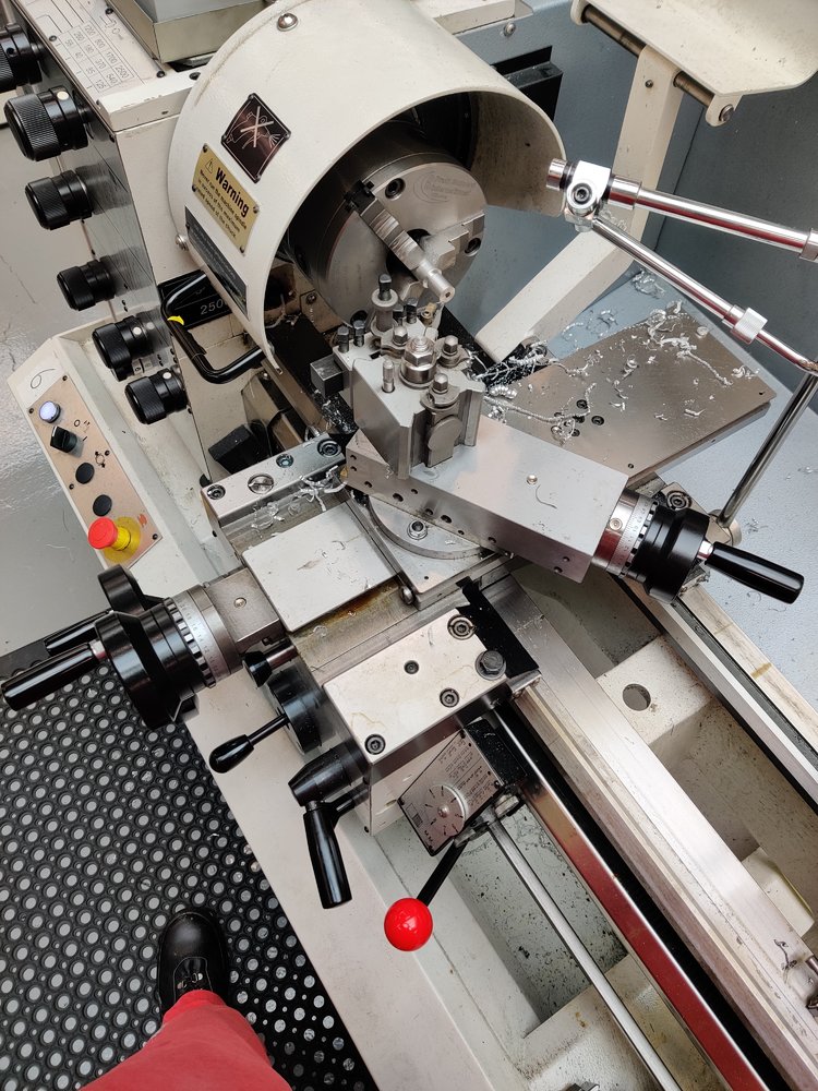

Not mine unfortunatelyThats an unusually clean lathe what is it?

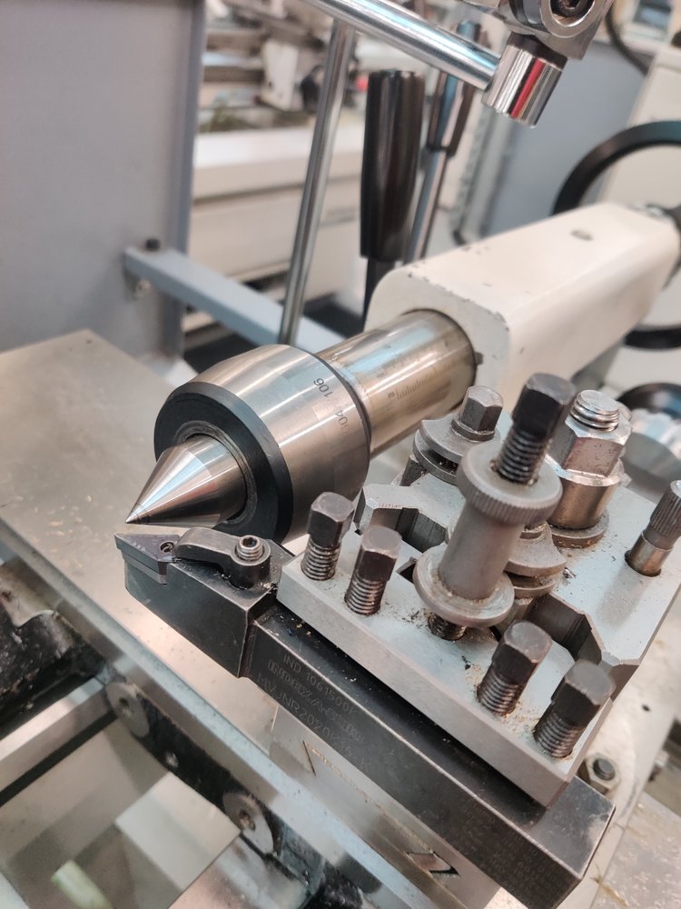

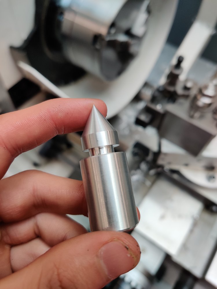

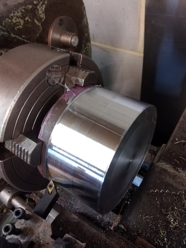

Very nice. What rpm and can you take a close up of the tool tip please?First time cutting a taper quite happy with this 30° cut
ThanksVery nice. What rpm and can you take a close up of the tool tip please?
No that's great thanks.Thanks
1700rpm and what I would to refer to as a finishing tip I'll get a pic of the box next time for the exact number , very nice to use and easy to get a good finish in my experience if I'm at a higher rpm and decent feed rate.
This is the tool here as I said not certain on exact tip but will find out
I also use these pointy tools for light cuts and finishing. They give a much better finish especially on my old Triumph lathe which only goes to 1000rpm.

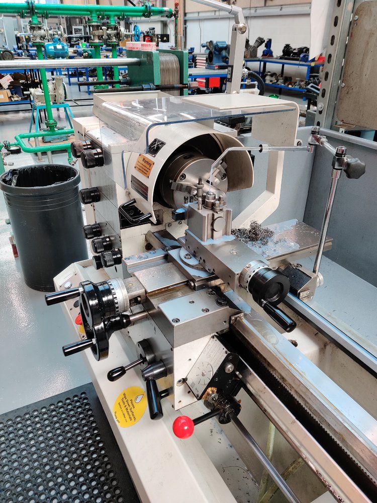

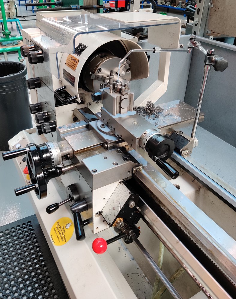

Indeed so. Can I have one pleaseThat's just a big Chinese mini lathe
It is. Colchester bought harrison. 600 group then moved production to Taiwan. Hence why XYZ lathes look practically Identical too.That looks remarkably like a Harrison M300
They probably work just as good. The Taiwanese got pretty good at making lathes.Never turned on anything else so nothing to compare to , yet
Well I don't think they would mind since their official name is Republic Of China.Taiwan have been making good lathes for many years. They would NOT be amused to be called Chinese!

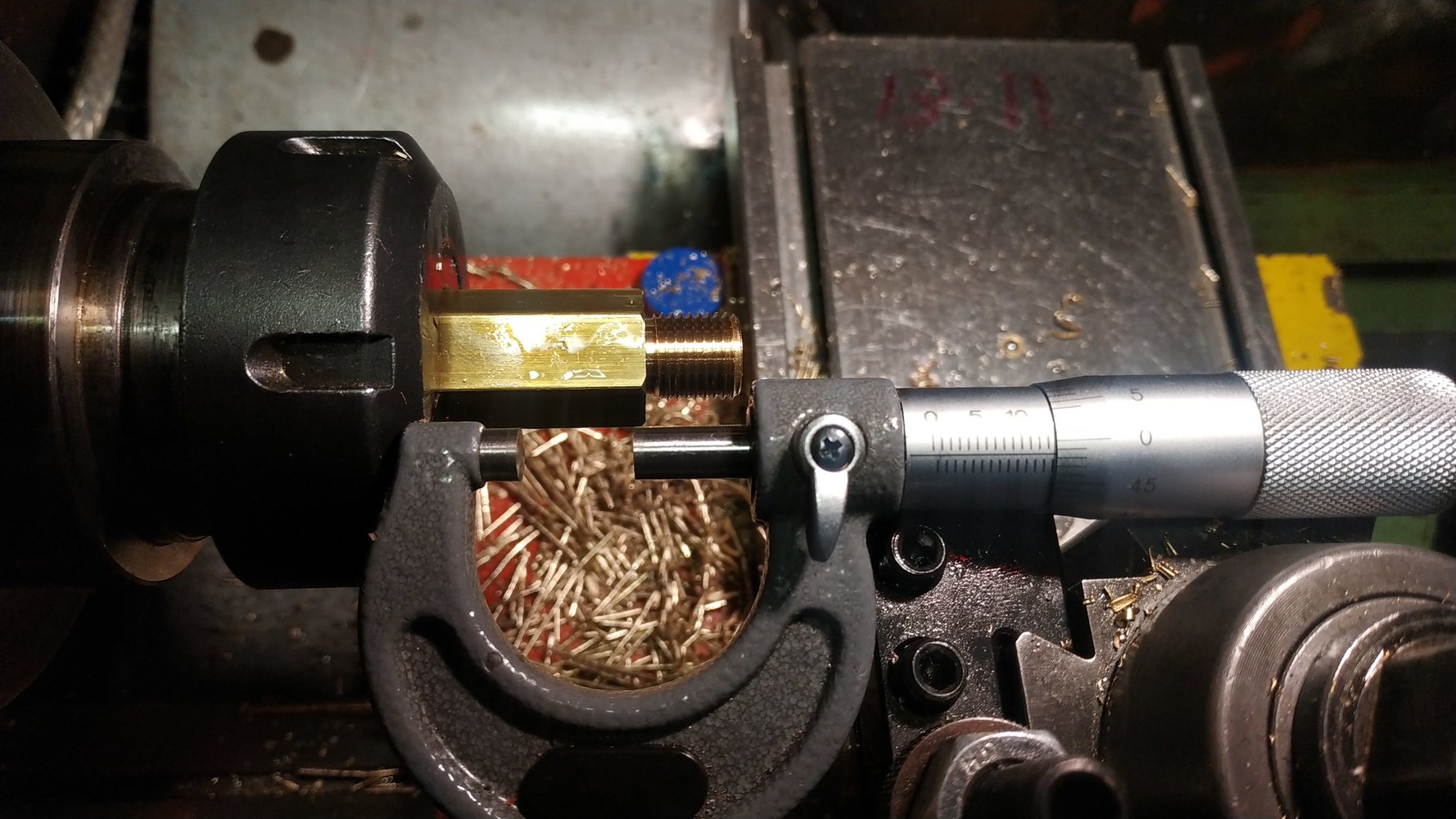

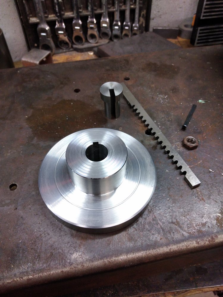

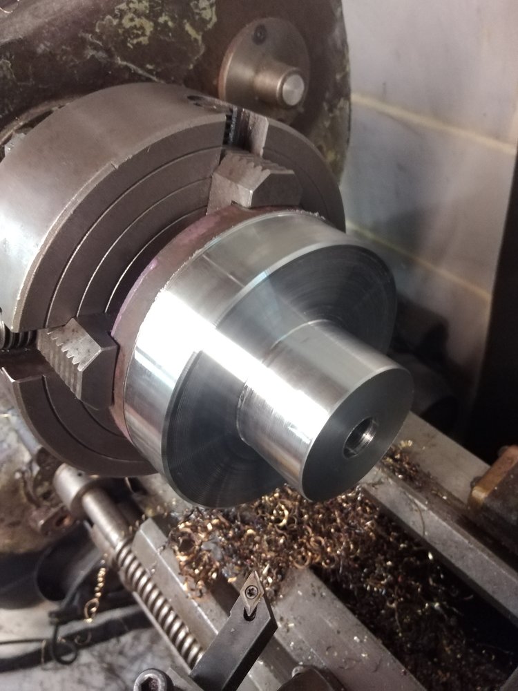

Did you single point the male thread or use a die?Made a couple of steering rod adapter bushes for fitting a different model's steering rack to a drift car. M16x1.5 male thread and M14x1.5 female.
