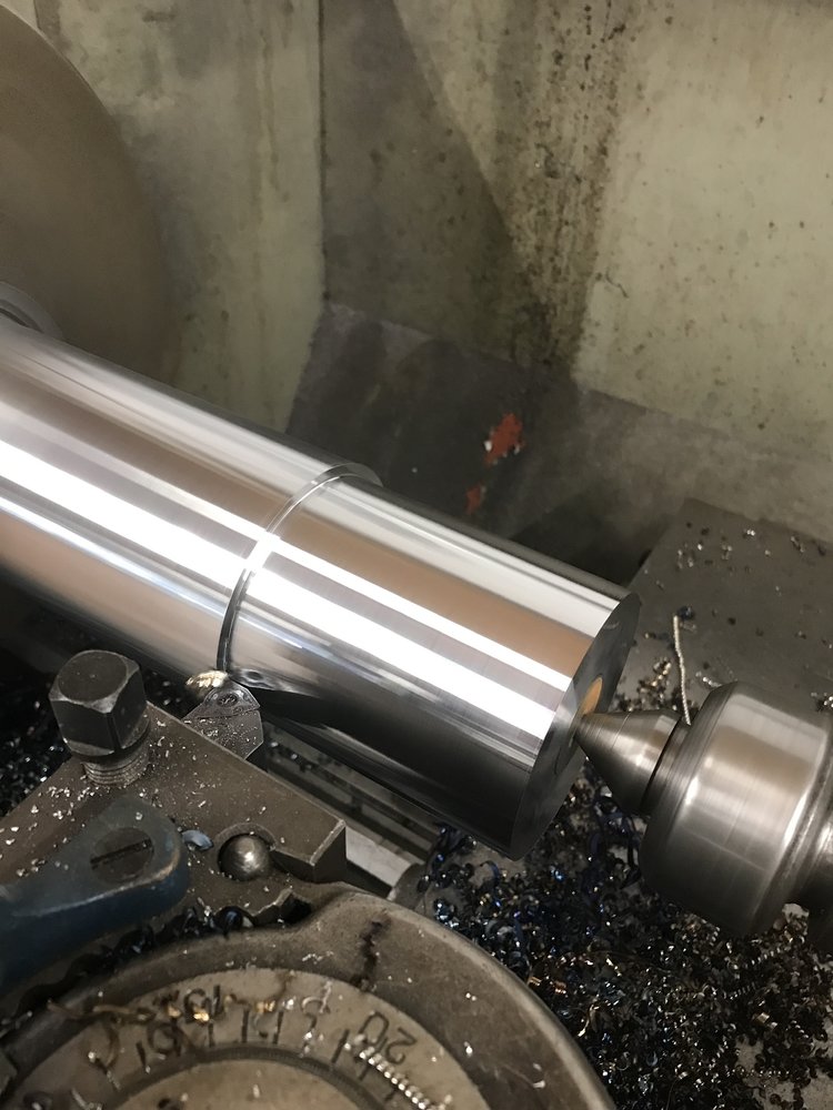

Behave Johnny , lolMade some En36b shavings. 8mm drill for scale. 8mm on diameter off per pass. Pity I didn’t have a stronger leadscrew or a Cnc lathe or I could take bigger cuts
Doesnt even feel it. Reckon I try 10mm next time
View attachment 345046 View attachment 345047
No coolant in first pic and the chips dont look like they got that hot? , I normally see mine go a blue or yellow typeMade some En36b shavings. 8mm drill for scale. 8mm on the diameter taken off per pass. Pity I didn’t have a stronger leadscrew or a Cnc lathe or I could take bigger cuts
I don’t use coolant for heavy roughing. It makes too much mess. They do get hot,that dark grey colour is hotter than purple. It’s very dependant on the grade of steel.If you take Princess cuts in En36 they come out purple …No coolant in first pic and the chips dont look like they got that hot? , I normally see mine go a blue or yellow type
so it just had the bulk bashed off of it. No finesse…
