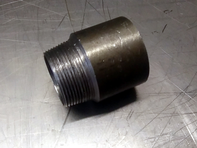

Tube for vac chamber. Decided to make it in two parts two either be used together or seperately depending on item size. Wouldnt fit in bandsaw vice but it had no problem following a line by hand. 150 and 43mm lengths.
Flipping it now for other side. This had lathe and me covered in powdery dust, galv/zinc seasoning?
I was expecting it to ring, short bit turned ok.
Im thinking a good fitting connector tube, probably from my lump of delrin.

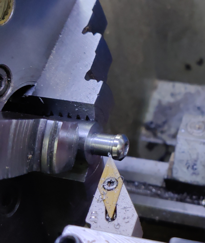

Do you know a good grinding firm?Spigot shaft back from hardening. Finished ground the two bearing journals and the flange. Had warped 0,04mm so was well happy with that
View attachment 350042 View attachment 350043
No, done myself Ona friends cylindrical grinderDo you know a good grinding firm?
