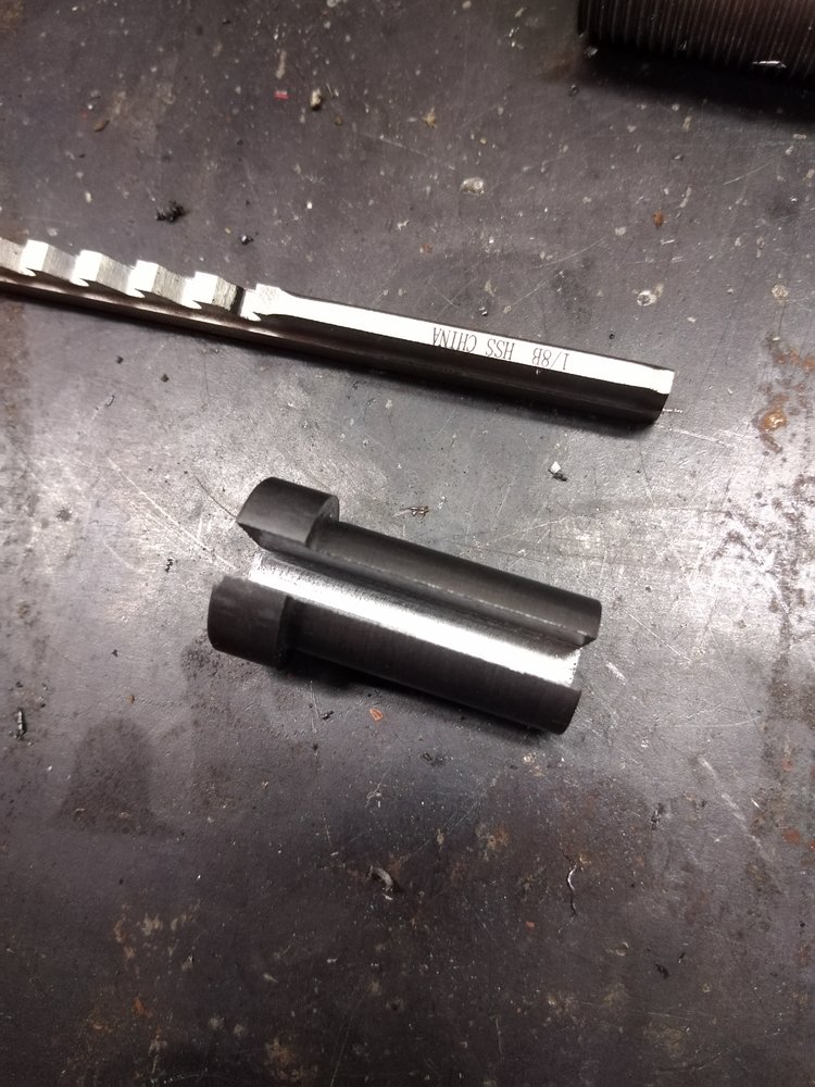

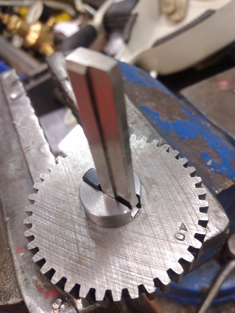

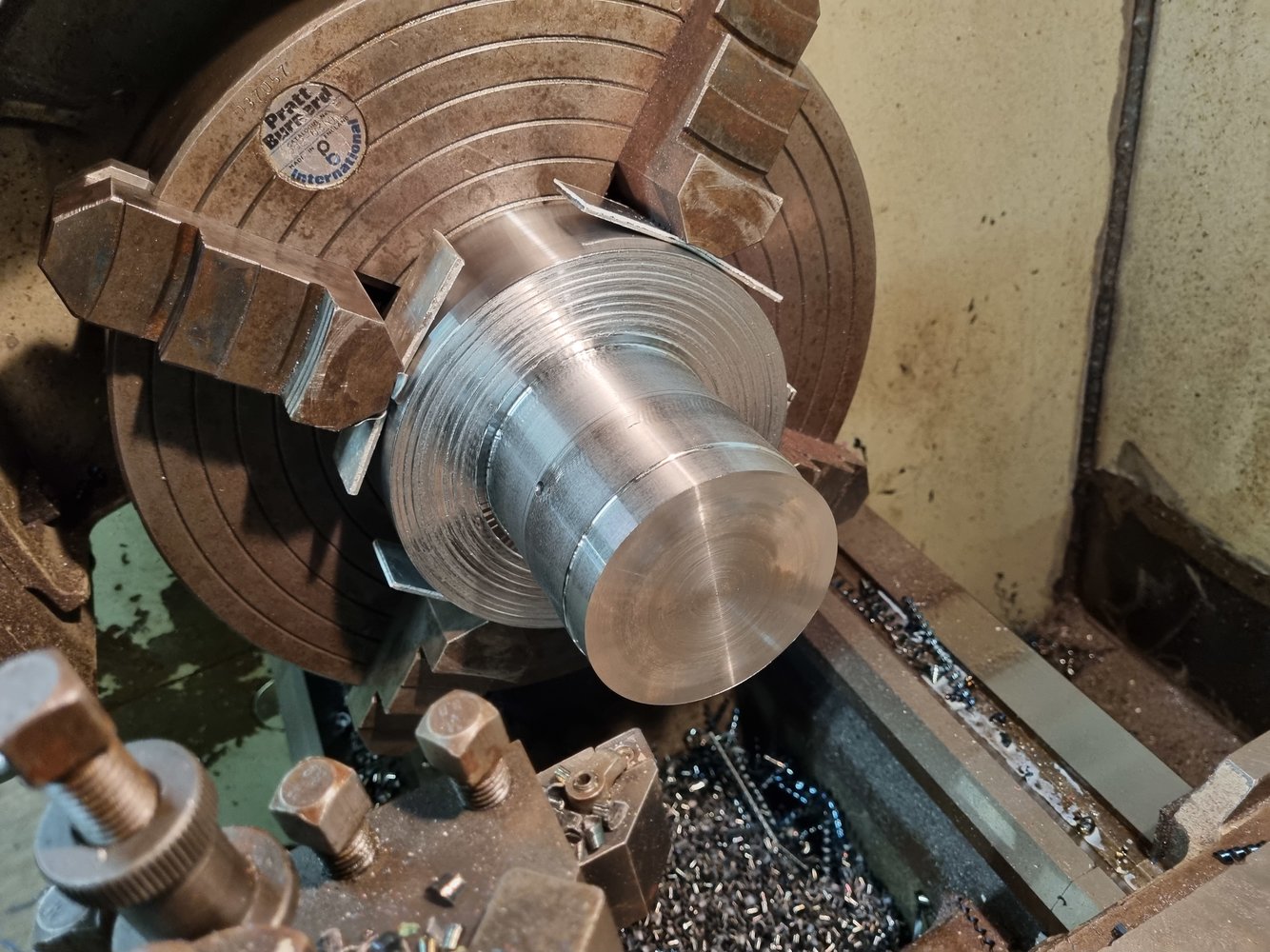

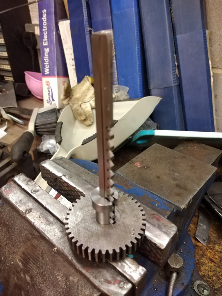

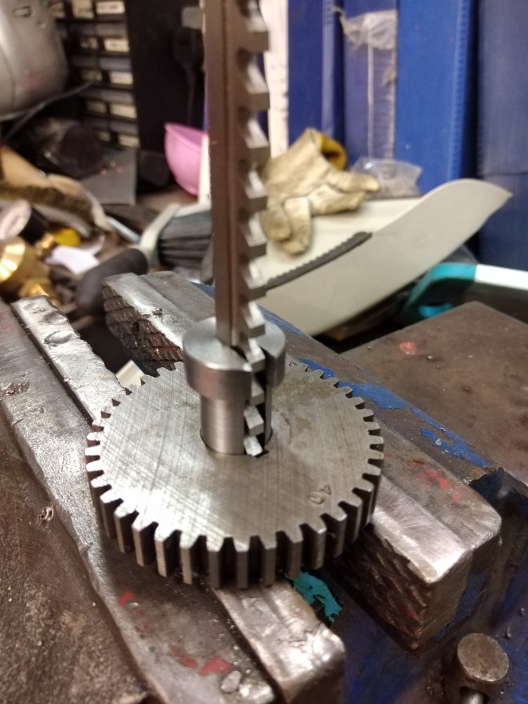

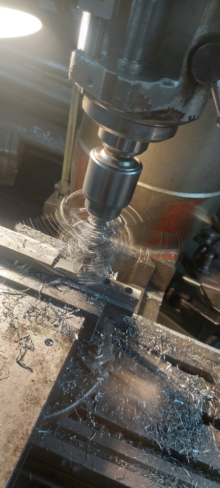

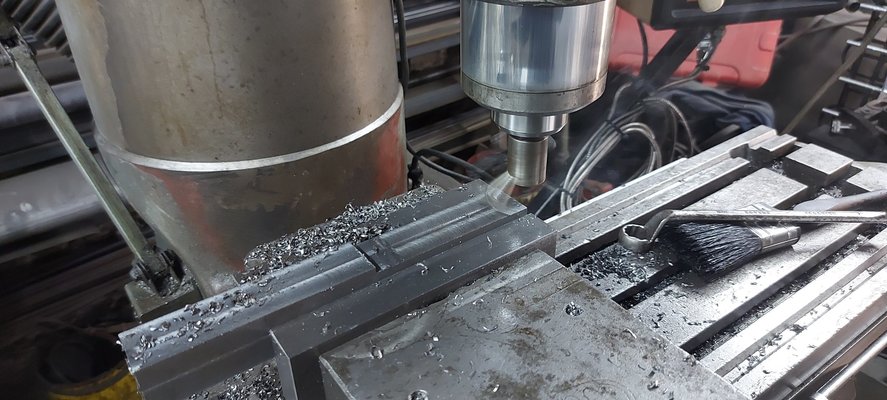

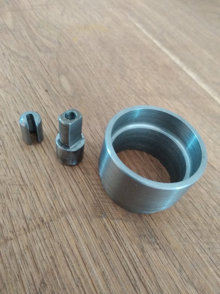

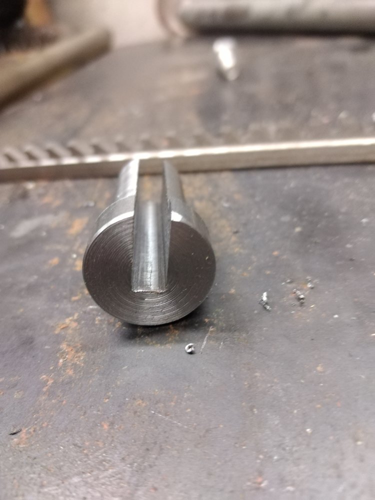

Bit of a repeat, but another keyway broach bush.

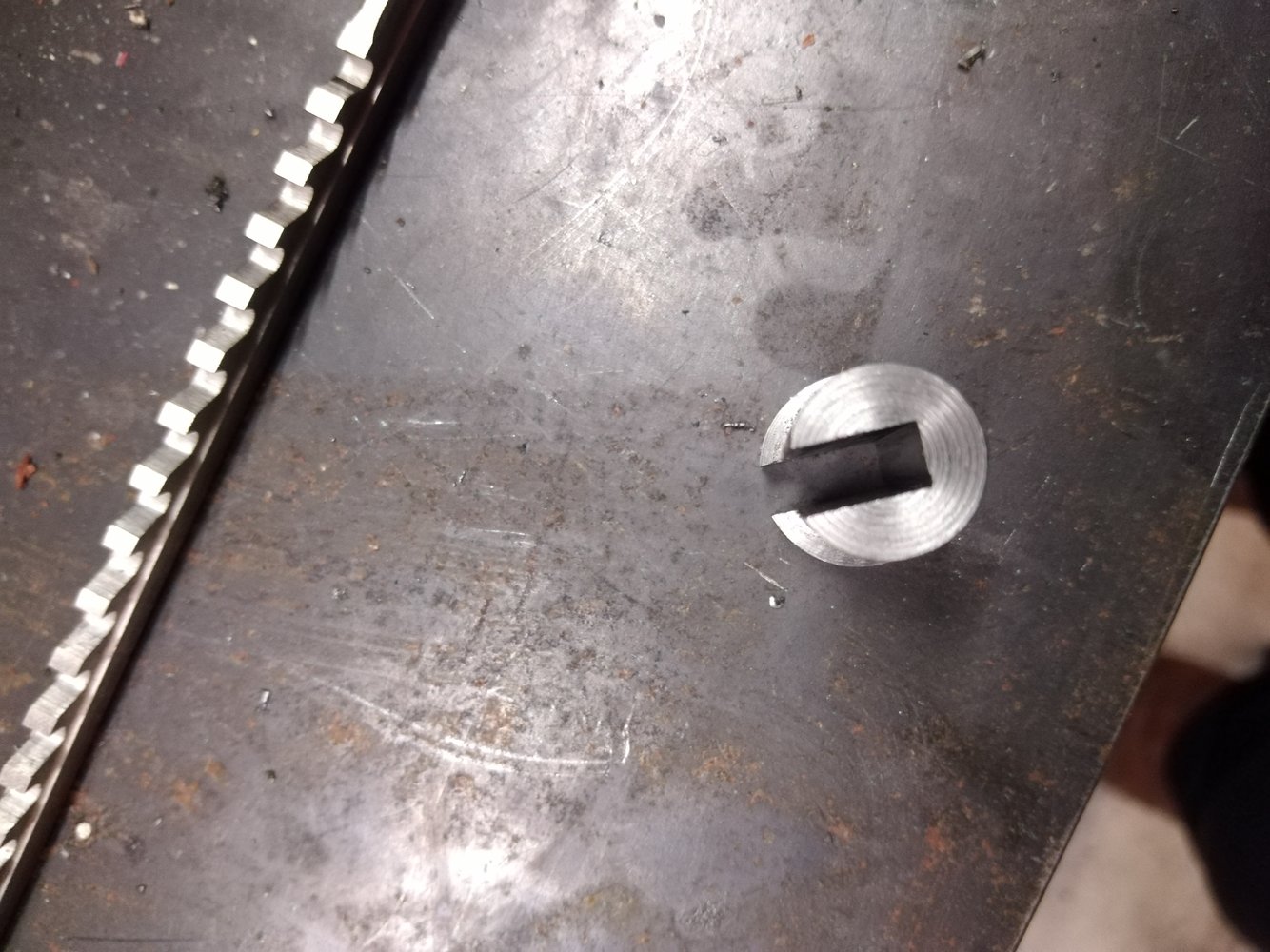

It's 9/16" diameter with a 3/16" wide slot. The slot accepts an "A" type broach and will cut a 1/8" keyway. The bush cuts keyways for Southbend/Boxford lathe gears.

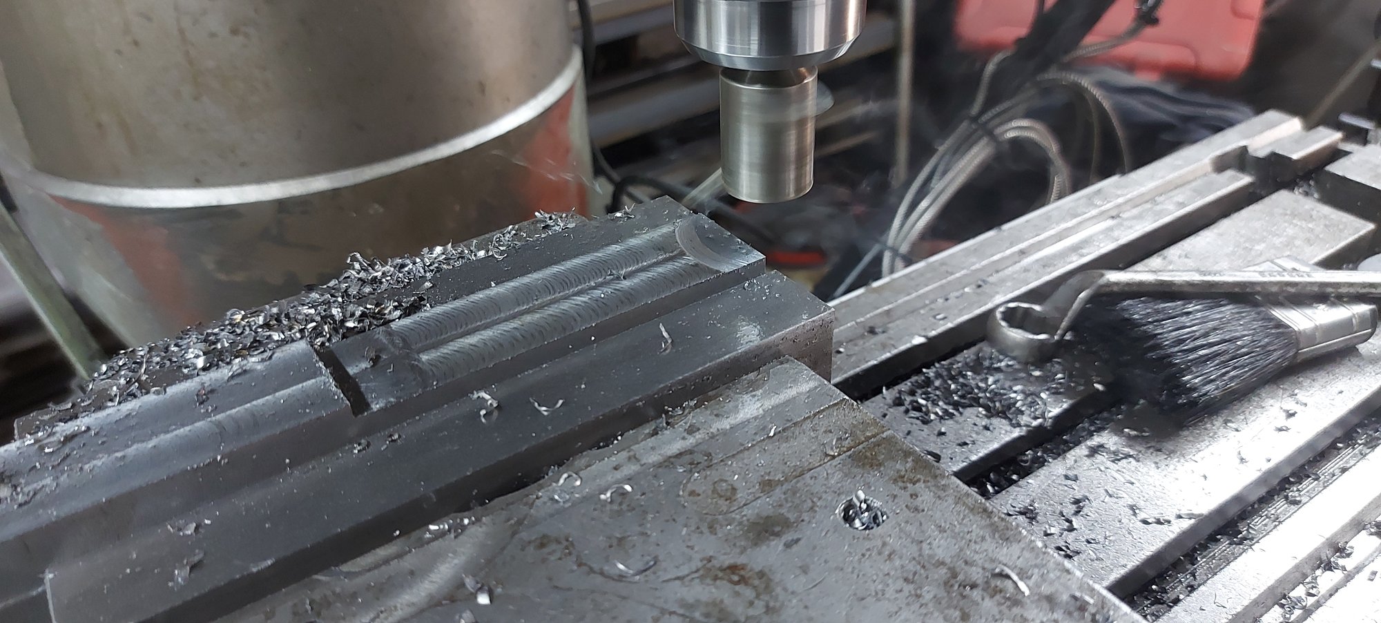

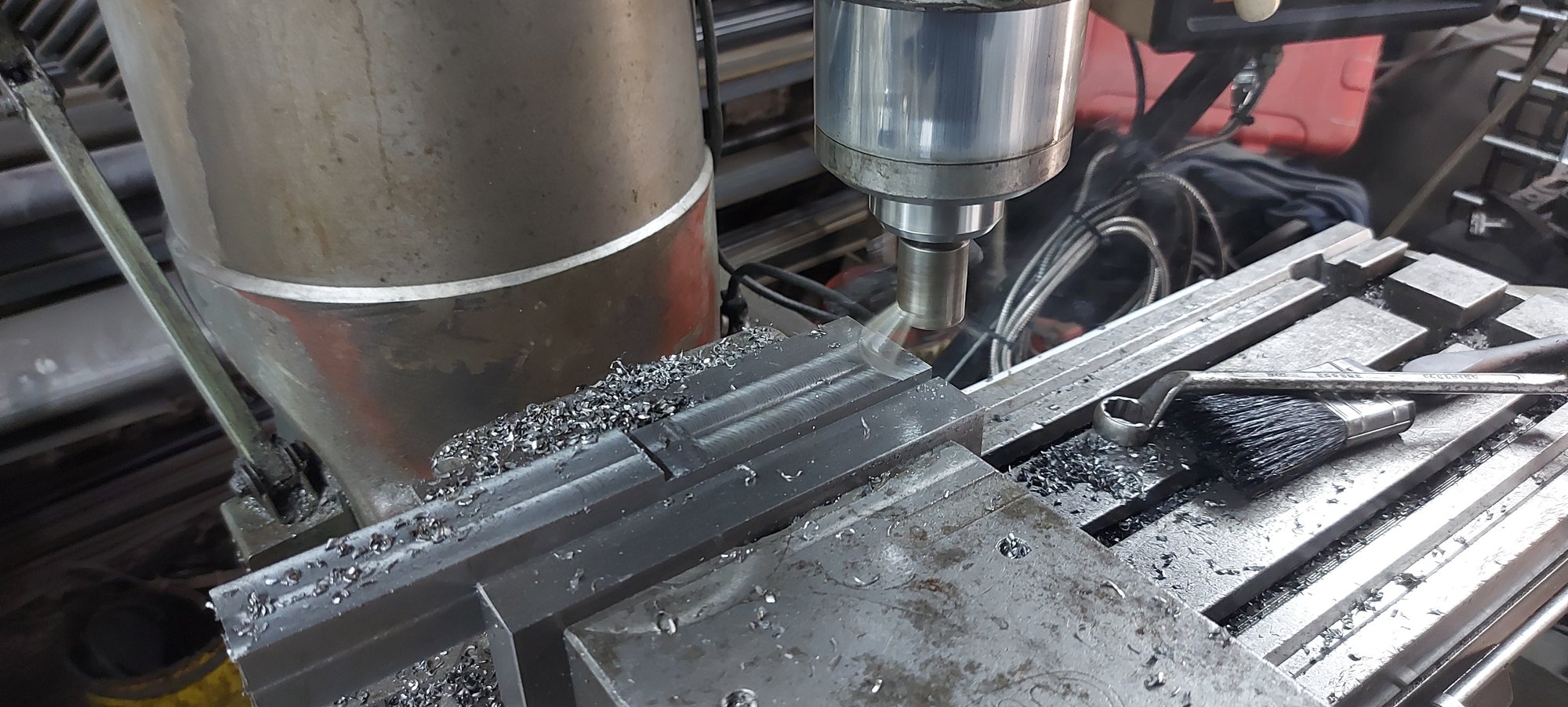

The important thing is to accurately find centre for the slot otherwise the keyway will be wonky.

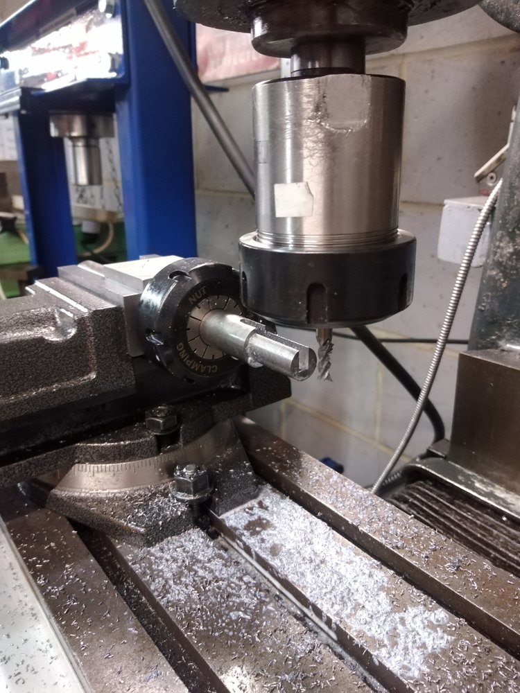

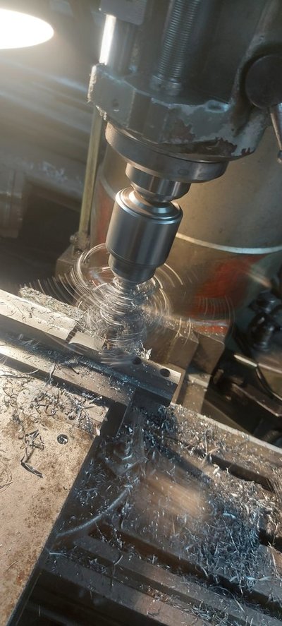

A Doubleboost style wiggler was used to accurately find the edge of the bar, the centre was then located using the DRO.
I've measured up the remaining width either side of the slot as best as can be done with a set of Aldi calipers and the two sides are within 0.05mm of each other so I'm pretty happy.
I have another bush to make for a 5mm keyway broach soon. Waiting for it to turn up so I can measure for the slot depth before milling. It has been turned already.
These are great little jobs for practising basic machining operations.
