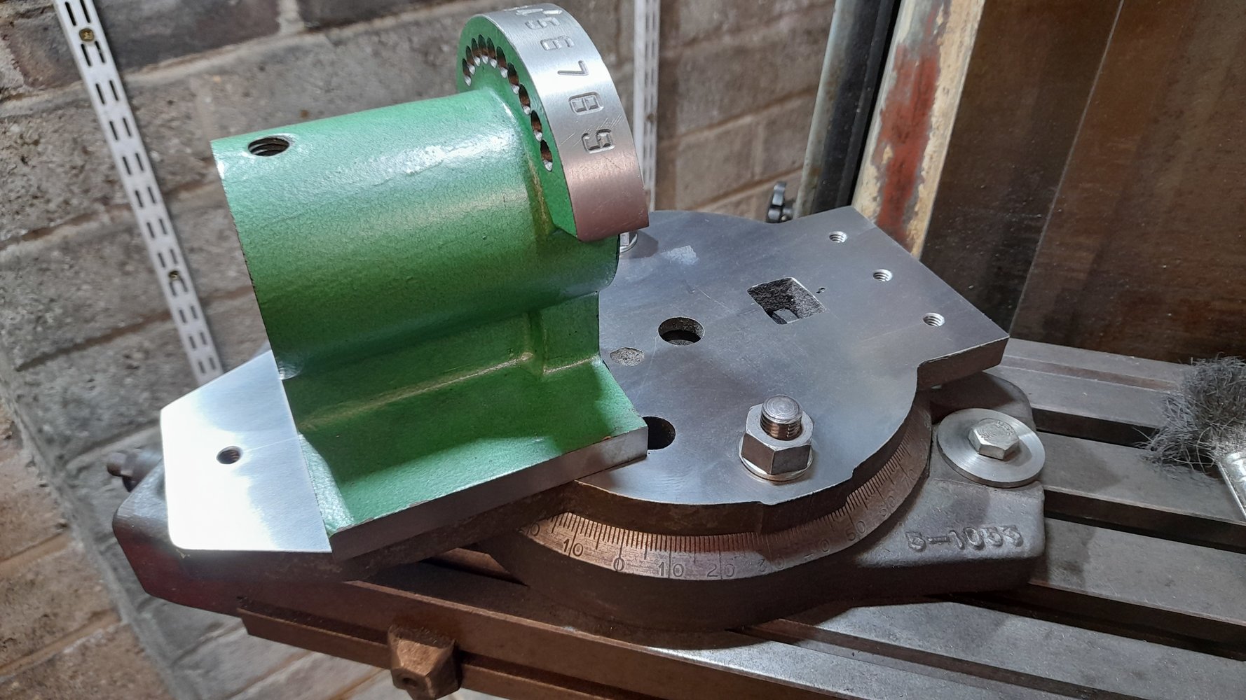

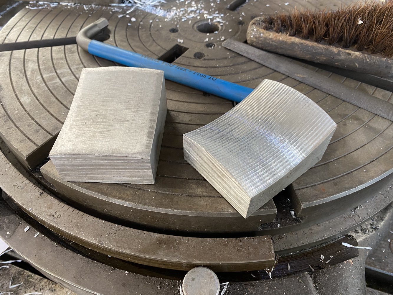

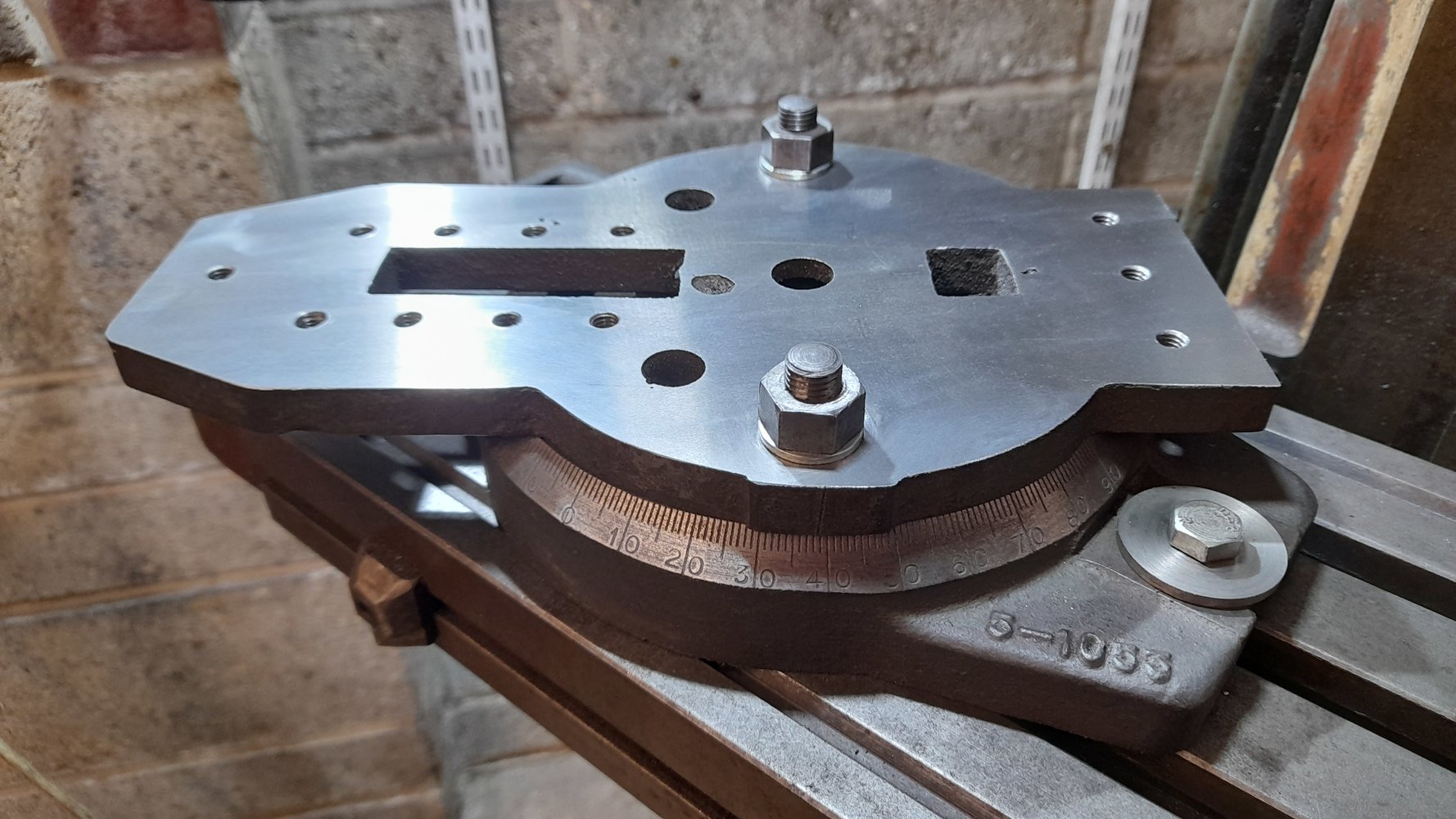

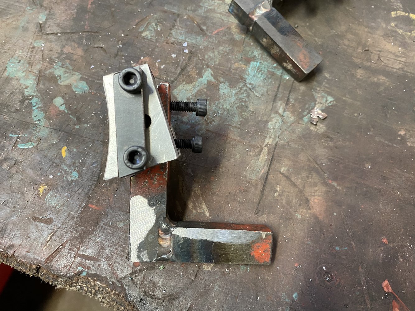

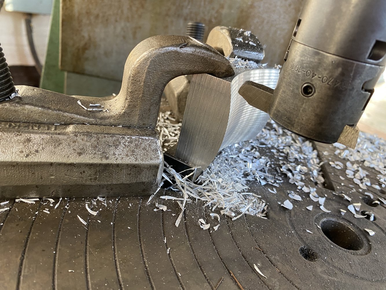

Heel plate? Are you going to polish it before anodising - will the machining marks be visible?Bit of a waste of material as I only had a lump of 4" x 2" aluminium and the part is only 20mm thick but it was spare and already had been paid for so...
First side done.
Turned over and had to face off 30mm, should have chopped on the bandsaw I suppose but I just wasted it instead
Didn't have any suitable Acetal sheet so just used some 140mm dia.
Shoved it in the lathe and parted off then faced and engraved the other side, bit of chatter at the ends but it is hardly seen in real life and will get scratched up anyway.
View attachment 381057View attachment 381058
Still need to anodise the aluminium but that will have to wait until next weekend.

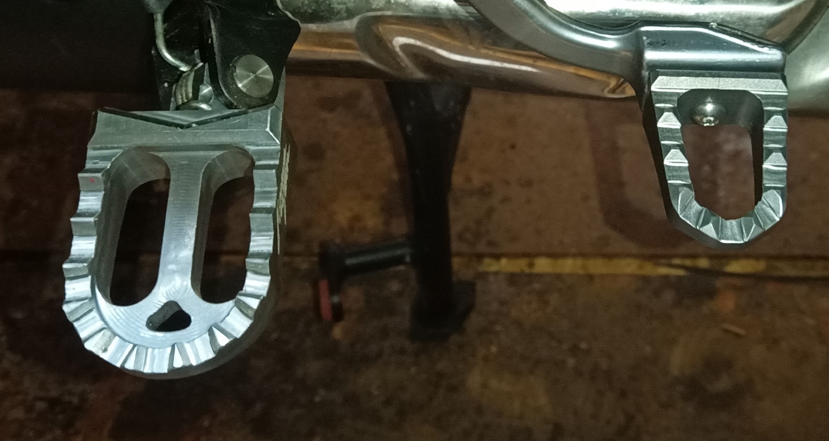

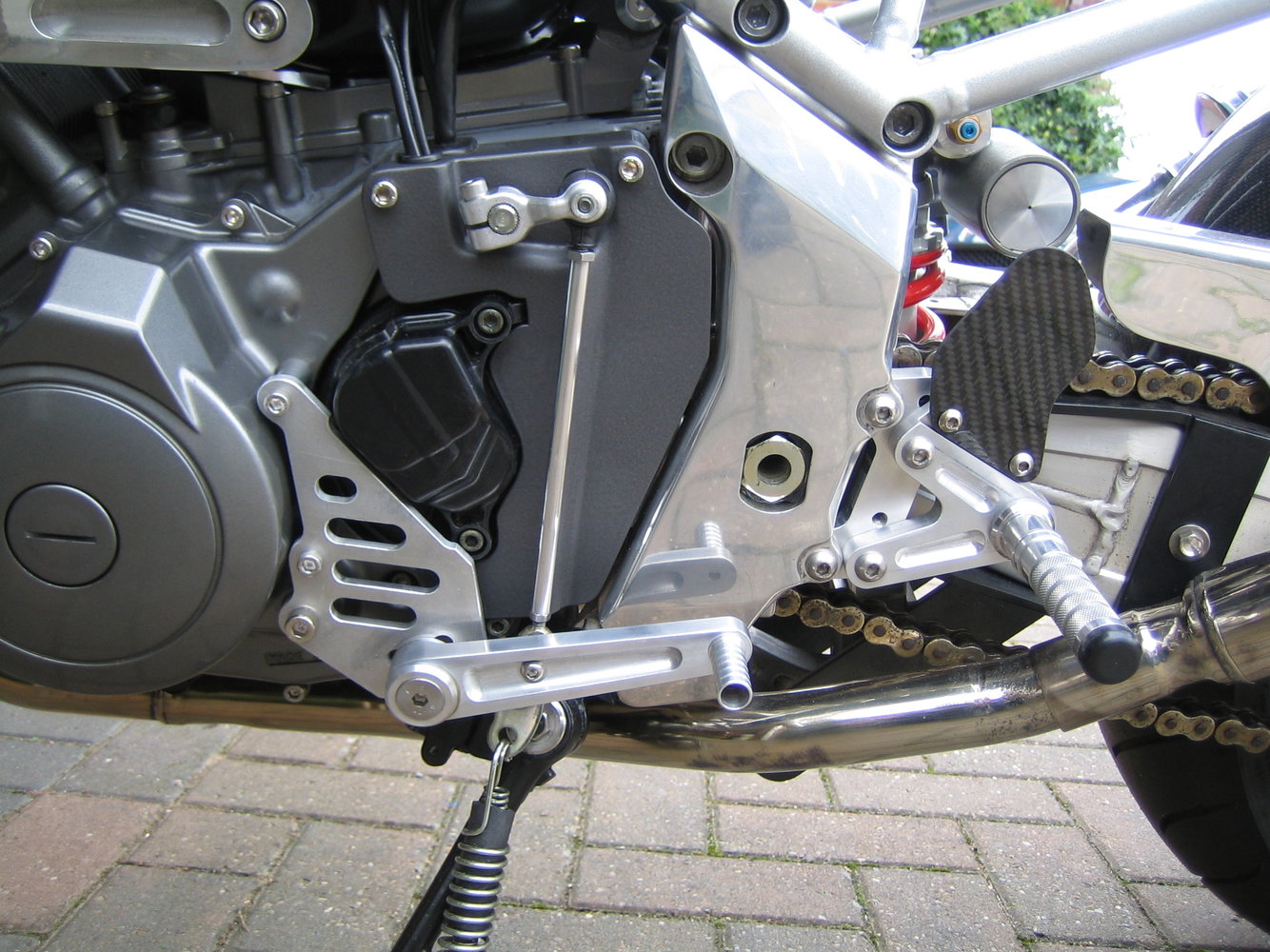

Nope, a chain fin or whatever you call it and nope, not going to polish as I want the machining marks to show.Heel plate? Are you going to polish it before anodising - will the machining marks be visible?

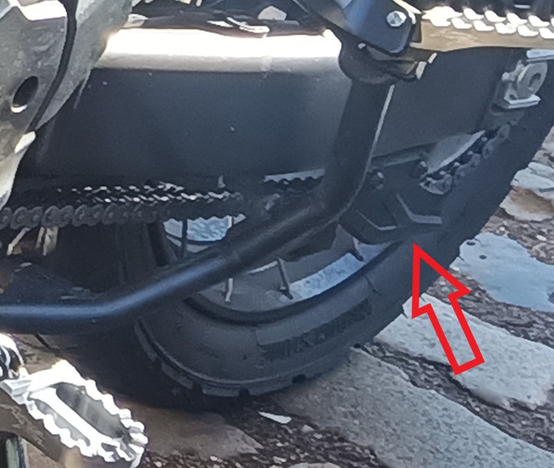

Chain fin - to stop your toes going between chain and rear sprocket?Nope, a chain fin or whatever you call it and nope, not going to polish as I want the machining marks to show.
Here is a footpeg and brake pedal I made, I reckon the machining marks add to the look but maybe that is just me
Oh there is no chance of you getting the Chiron, already spoken forJust so long as I get to buy that Chiron for the same price he sold it to you for when you decide to sell it, and I won't mention what he said about you![]()
Yes, exactly that, original below.Chain fin - to stop your toes going between chain and rear sprocket?
Machining marks - thought you might, are you going to finish it off so the machining marks follow the outline of the insert?
Heel plate as in carbon below:

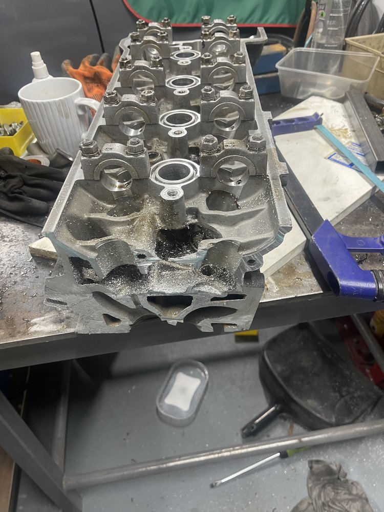

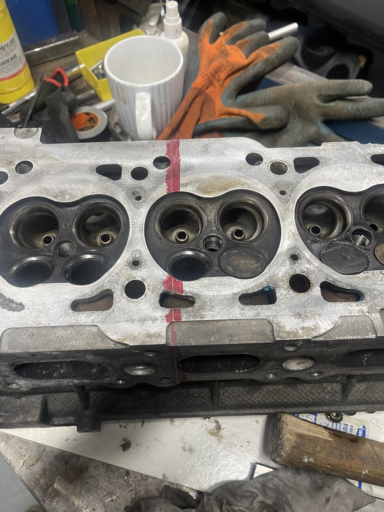

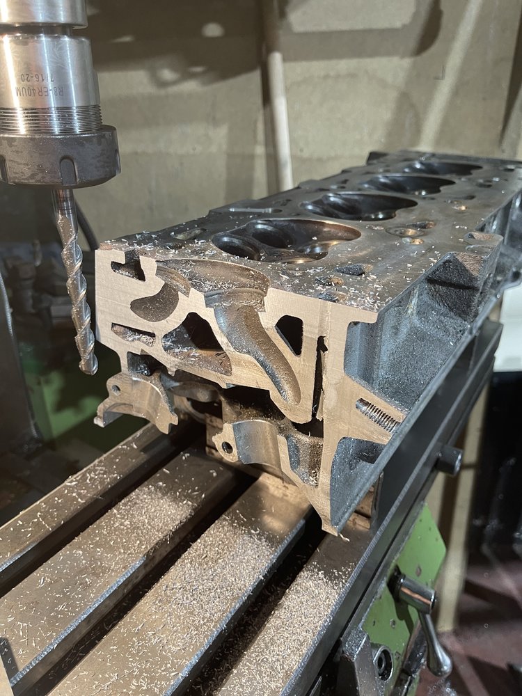

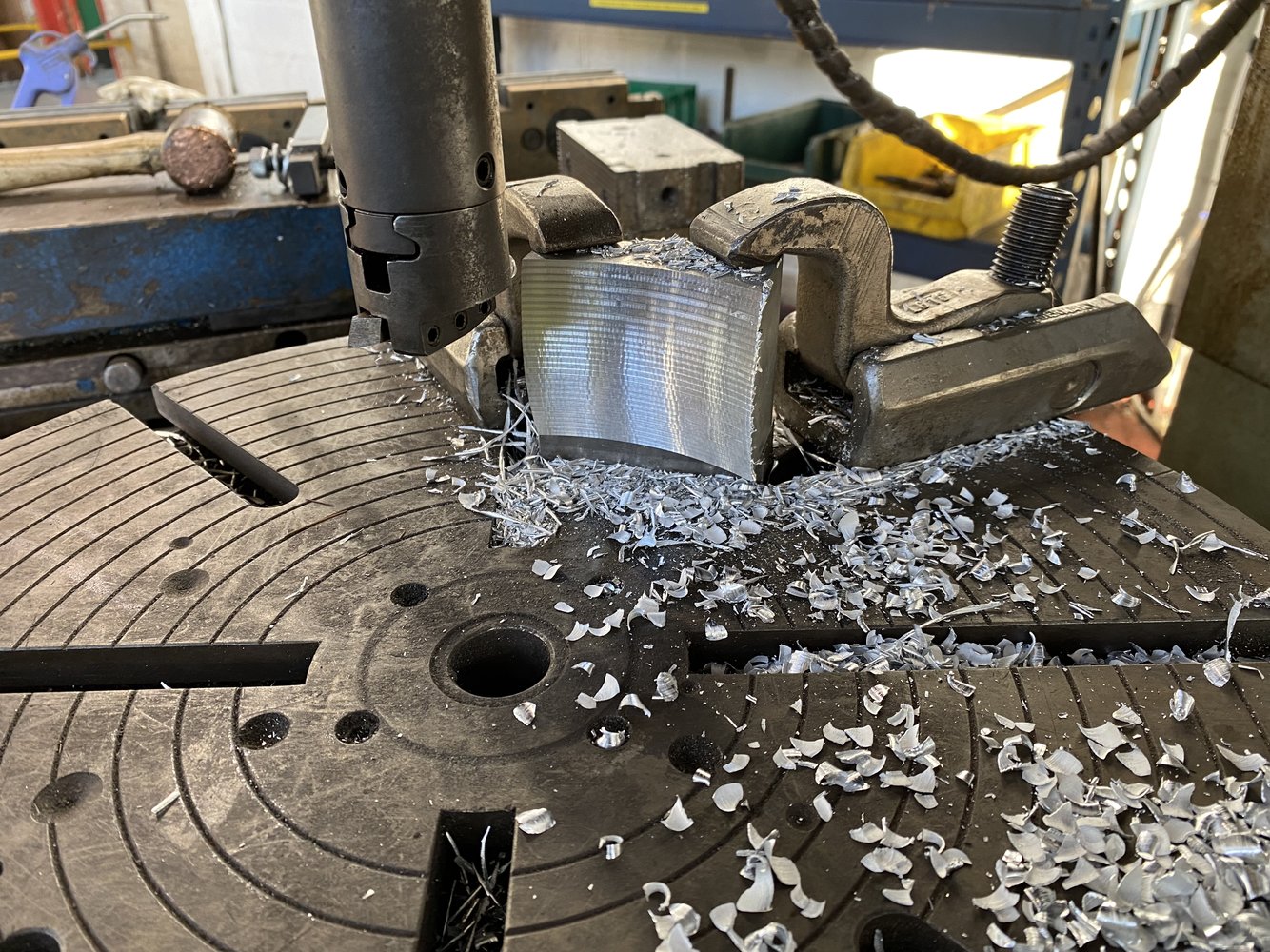

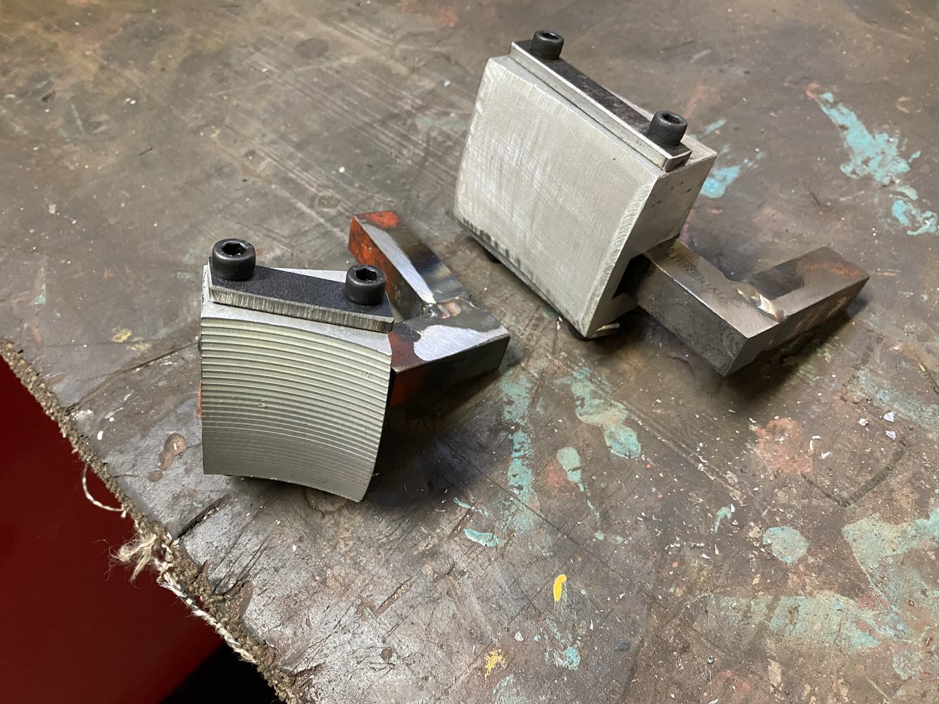

What's going on here? I've never seen someone skim an entire cylinder or 2 of the end of a cylinder head.Nothing like the talent of a lot of you guys but faced off a cut down cylinder head today to tidy the cut up before welding and then re-machining. Was just nice to be a in a workshop of my own again, despite the cold lol.
Were you part of the JLR team that “ developed “ their V6 by any chance?Nothing like the talent of a lot of you guys but faced off a cut down cylinder head today to tidy the cut up before welding and then re-machining. Was just nice to be a in a workshop of my own again, despite the cold lol.
View attachment 381609 View attachment 381610 View attachment 381611
It’s a Vauxhall Carlton 24v head. You are correct. Lopping two cylinders off and mating to an omega A 2.4 bottom end to create a 16v CIH aka manta 400 incarnation. They were cast strictly as a 16v but this is a way of doing it on a moderately better budget. Still not cheap by any stretch but I’ve wanted to have a go for some time.What's going on here? I've never seen someone skim an entire cylinder or 2 of the end of a cylinder head.
Straight 6 or v12 head onto a 4 cylinder? If so, what engine?
