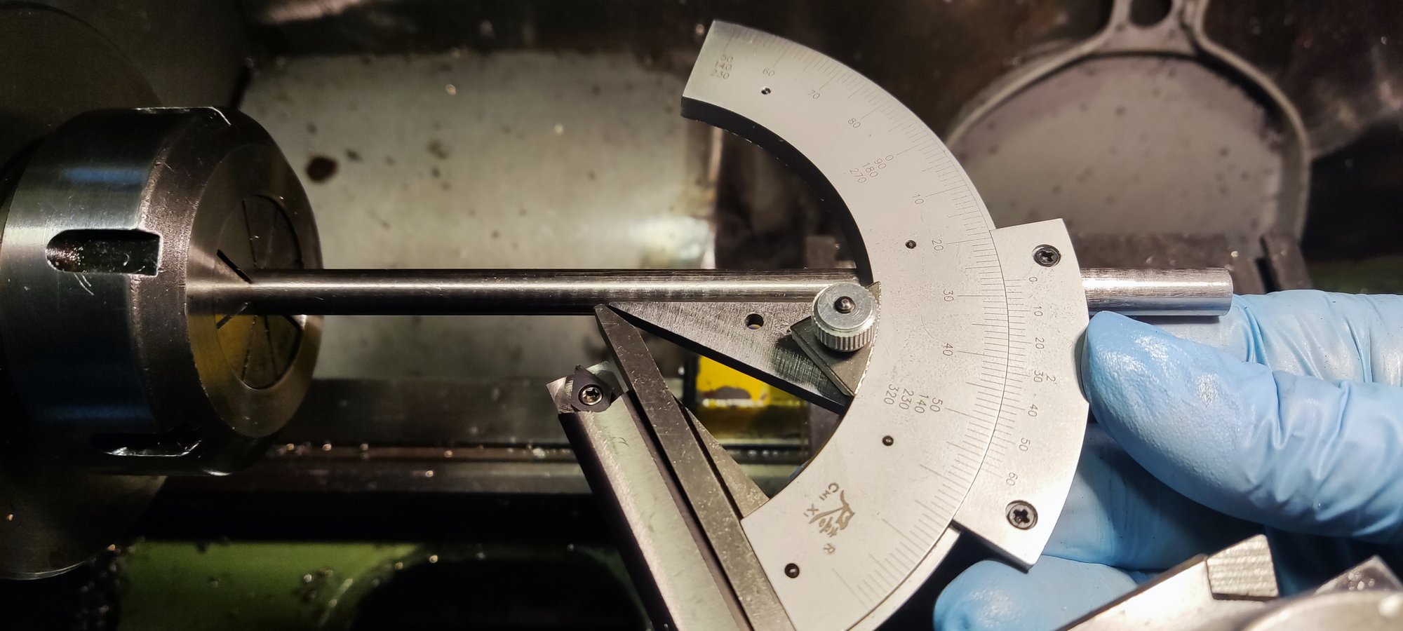

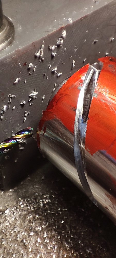

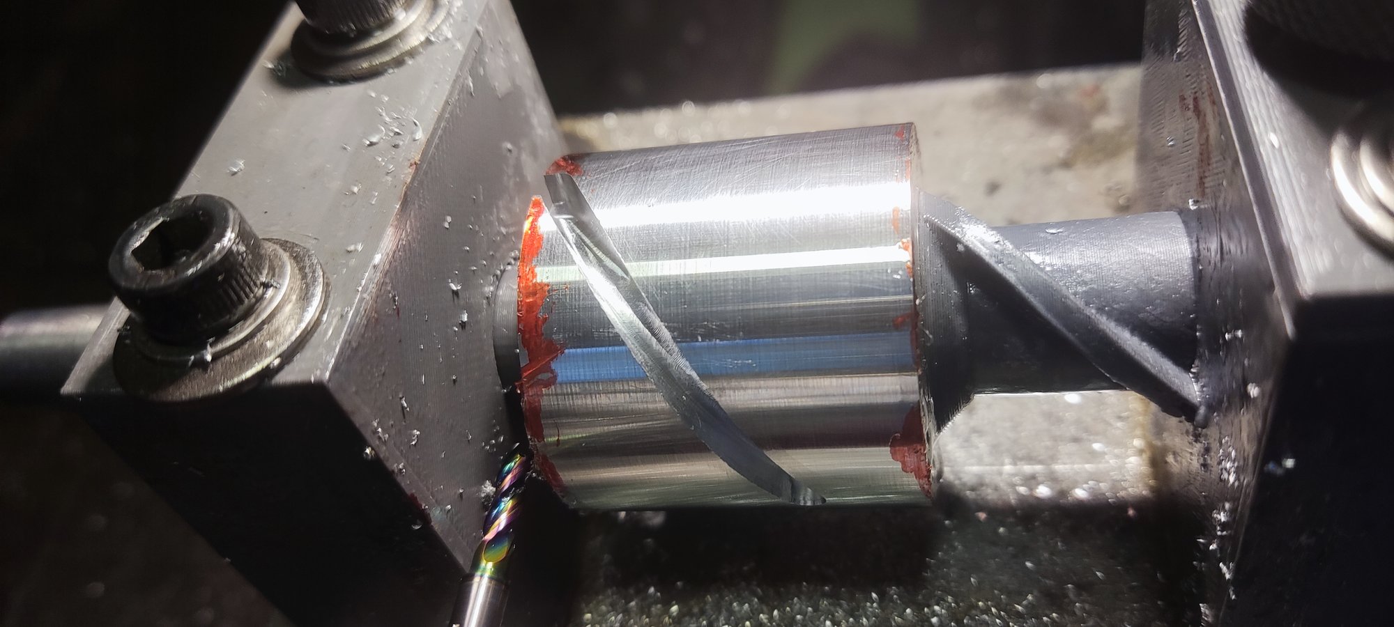

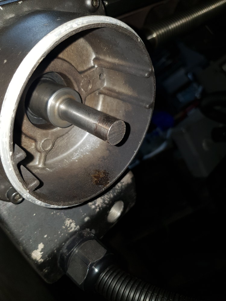

Runout typically grows futher from the chuck so I'd measure on the surface just above the inserts. If its the same then fair enough, if its higher you may want to shorten the shank.Less than 0.01mm runout on the endmill shank. I can live with that.
I'm still in doubt if I should cut down the shanks for a bit less stickout.
