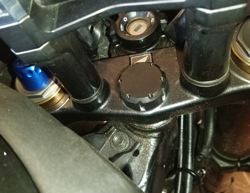

Too expensive to buy I would think. If I thought there was a market then making a mould and casting would be the better option but I don't think there would be enough of a market as it would only be suitable for these particular bars.I was just thinking if you made them to go round the top and hide other "hero marks" then it may stop them sliding down under impact. Dependent on costs it may be an interesting option for other AT owners.
Well of course I wouldn't say they were idiot marks would I!Oh and they are not hero marks, more like IDIOT marks
Right side was when I was taking off the Sky Lift and forgot to lock the casters and it just slid off onto the road and the left side was when I stupidly tried to turn on the steep hill knowing the road was only wide enough to get across the road and not fully turned, I forgot I am a short **** and the bike weighs a lot![]()

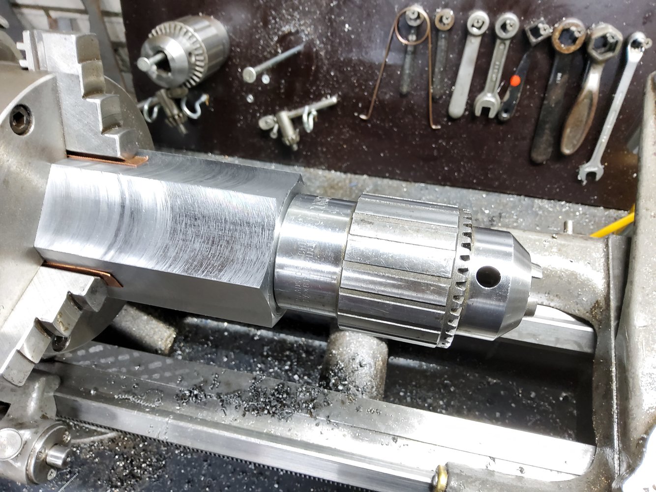

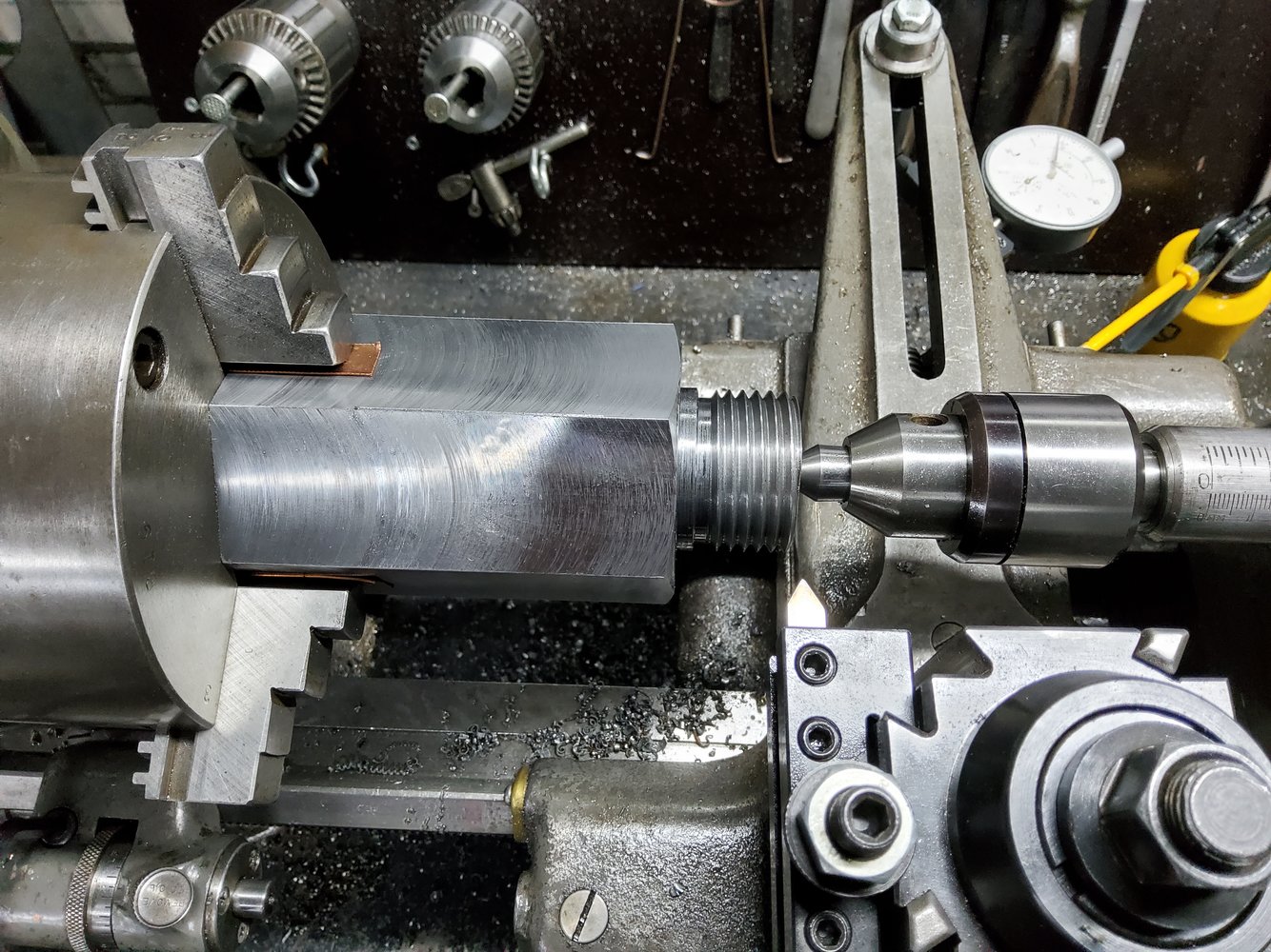

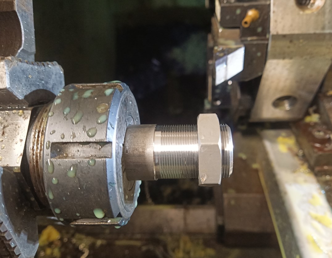

Collet blocks are Very Seriously Handy bits of kit.......I was looking at collet blocks lately. I thought it would be handy to have now I have a mill.
I know the Chinese ones are cheap, but because I laid my hands on 2.5m of 60mm hex very cheap I decided to do some tinkering myself.
I cleaned up the sides of the hex with a flycutter and turned down and threaded one end for 1.5" x 8tpi.
My South Bend 9" came with two Jacobs headstock chucks, so my idea was to use those for the work holding.
The 60 degree threading inserts I have are not fit for an 8tpi thread so with a quick grind I made a hss threading tool.
Next job will be to drill the centre and bore it out so I can fit long stock in it.
I will have a lot of stickout with a Jacobs chuck on there, but with a machinist jack under the part it should be rigid enough I guess.
The threads turned out near perfect. No play in the chuck whatsoever. View attachment 441398View attachment 441399

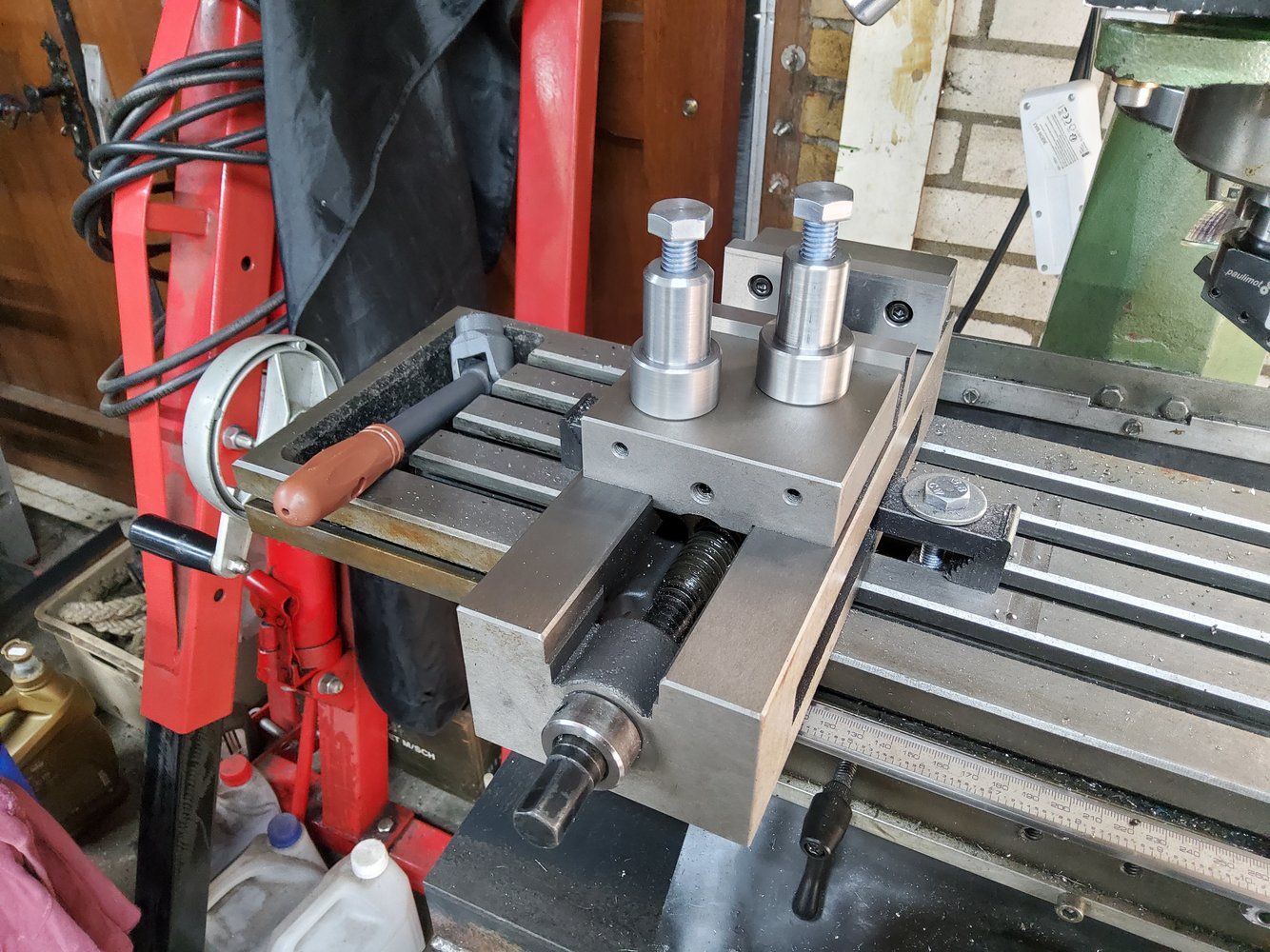

The chamfers not being the same on those two would do my head inI had an urge to use the lathe and make something, so I turned two simple machinist jacks for the mill this afternoon.View attachment 443976
You've noticed that, but you didn't notice the base on the right one being slightly bigger?The chamfers not being the same on those two would do my head in![]()
