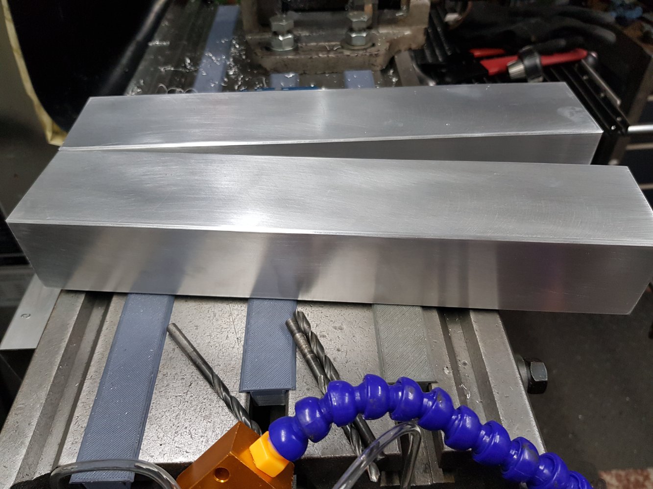

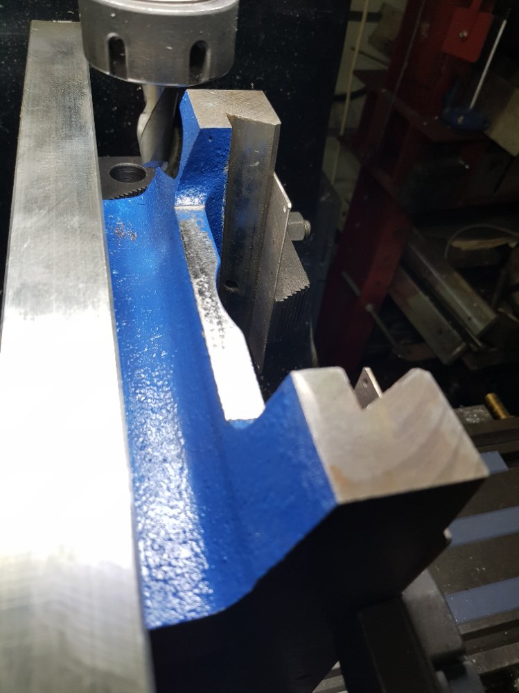

Definitely need fewer teeth for cutting that sort of depth. Those high tooth count saws are for shallow slots. Same sort of principle as a hacksaw blade, you wouldn't cut that deep/wide with a high tooth count blade. You need a 36 tooth or similar. Though they'll all wander if you do really deep.They are pretty grotty aren't they? Wasn't sure if it was just me, it usually is. Worth a try though to experiment with. Maybe one with fewer teeth would be better? I'm not spending any more money to find out.

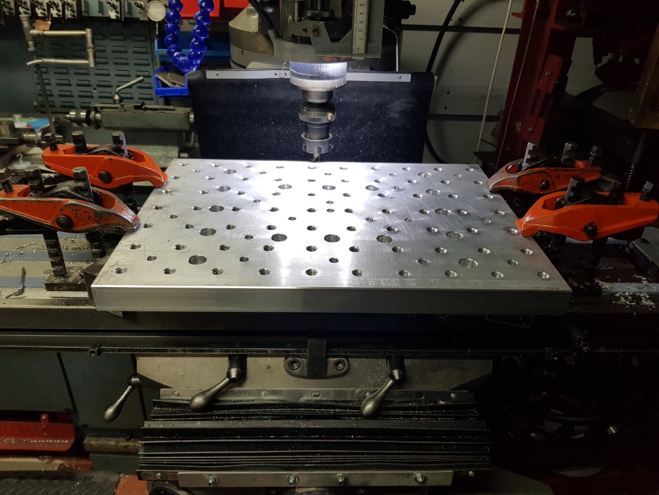

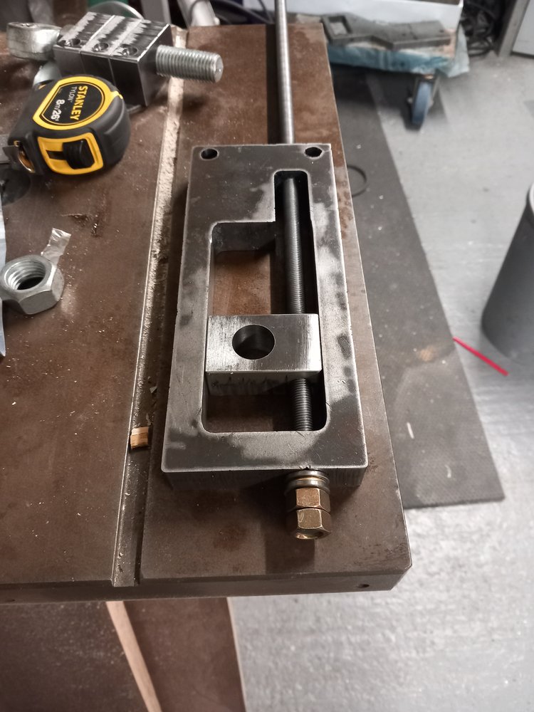

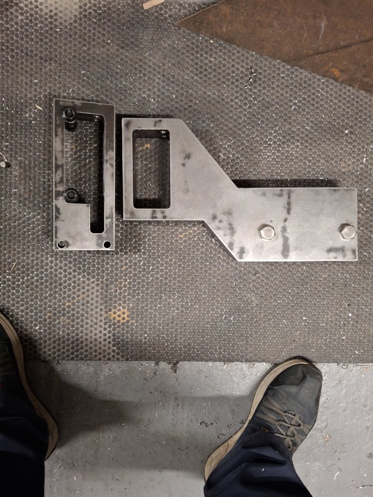

It's often the same with a lathe. Takes ages taking sensible cuts and a CNC makes it look like child's play.I had a local fabricator make a nose cone for a space ship with a 75mm hole in the top, then realised I actually need it 5".Luckily a 40 taper Bridgeport (clone) has an enormous work envelope.

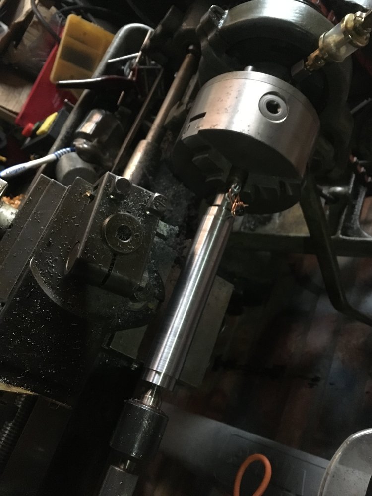

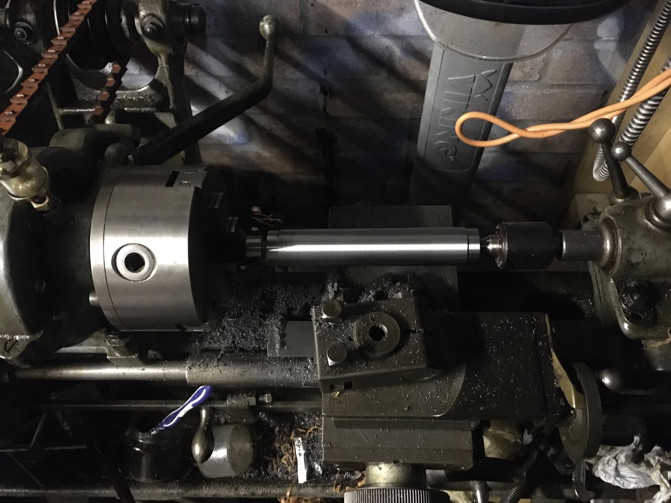

I tried to trepan it out but it made a terrible noise, and interpolating with a small endmill was no better, so I resorted to taking over two hundred, approx 0.2mm passes with a boring head. Never again.![]()

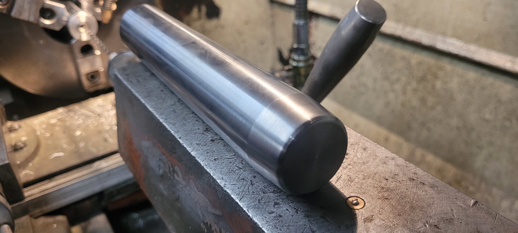

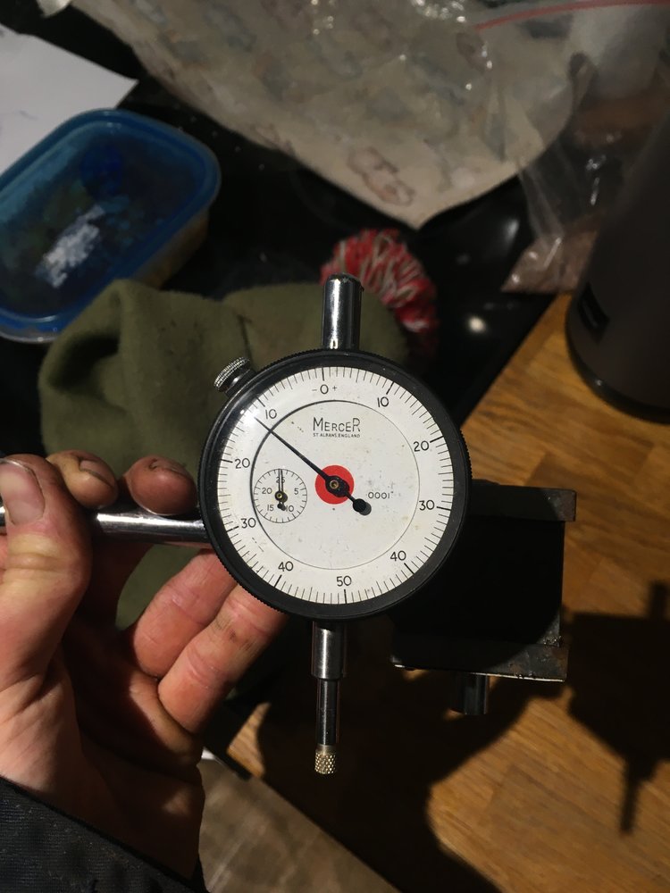

Only Allah is perfect ....its a 3 jaw self centering chuck none of them are totaly accurate
Didn't he make hexagonal wrenchesOnly Allah is perfect ....
Only the geometry bit.Didn't he make hexagonal wrenches![]()

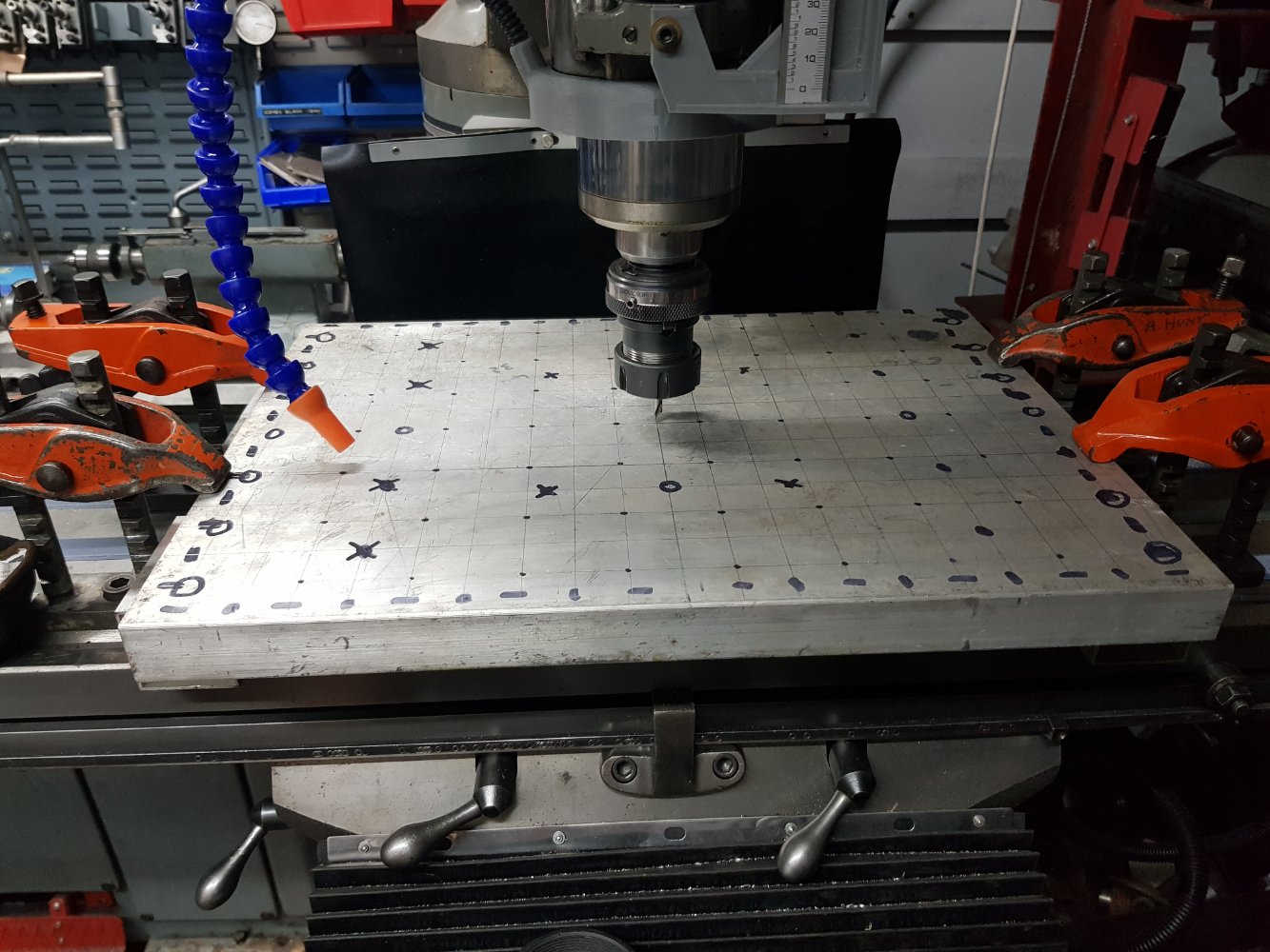

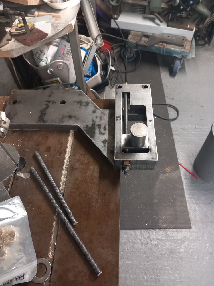

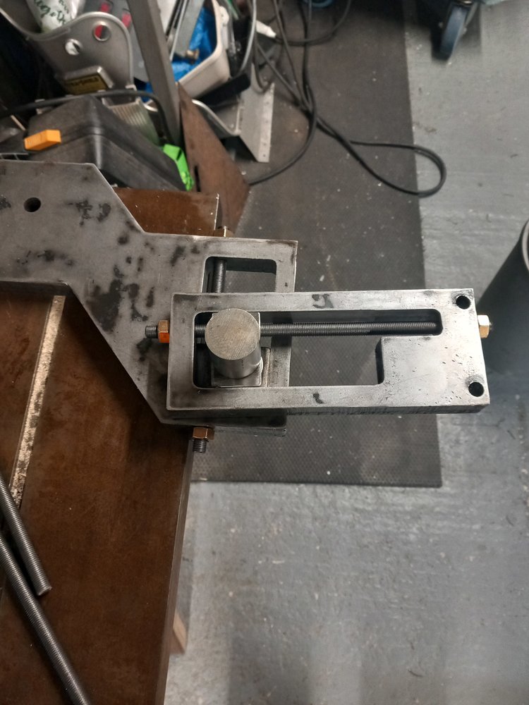

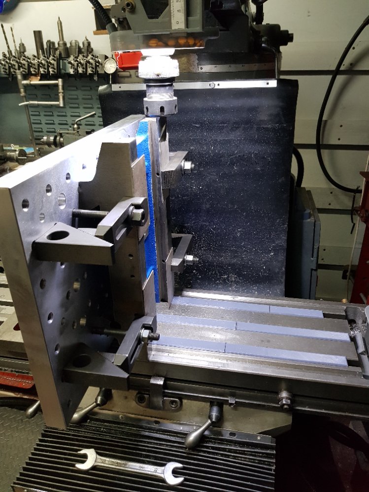

What is it in the last photo?First slots on the mill, on any mill I'm going to get a dro, what's everyone's preference,and a bit of skimming
View attachment 453643 View attachment 453644 View attachment 453645
