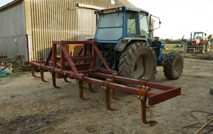

Originally Posted by madkayaker:-
"its a type of plough! welcome to the forum 3.2mm rods will do the job nicely but don't try to fill the weld in one pass and clean the skin (can't thing of proper name!) before the next pass"
I think he meant slag - cleaning it off between each run.
CJ
Skin = Millscale...
