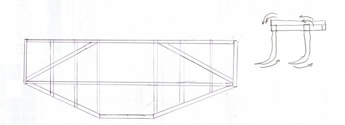

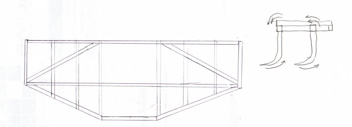

REALLY SORRY to say this but STOP wasting money on this now. It will be a pile of scrap within 20'. It's massively under engineered and certainly fail the second it goes in the ground. I dont want to put a downer on your project which is something i admire you trying but you are wasting your time.
Have u ever pulled a shakerator? I presume you're using McConnell legs or copys... We had a 3m one with 7 legs and it put out Fendt 718 on its **** propery and that was on ploughed land. A 6m machine needs to built like a battle ship and yours isn't... Please go and look at www.sumo1.com and see how massive a 6m subsoiler needs to be.... They should be trailed and need a 400hp crawler to pull....they are MASSIVE.
The best thing to do would be to cut it down to 4m and MASSIVELY reinforce it and it "might" work. Sorry again if I seem harsh but it won't work in its current form.
