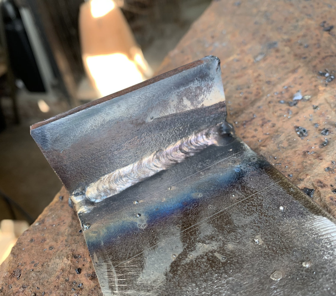

Burn a box of rods in the flat on a plate run bead after bead and when you start to get the feel and see what's going on and then you get slag peel practice another box on another plate run more beads then move on to a lap weld then try a tee fillet
