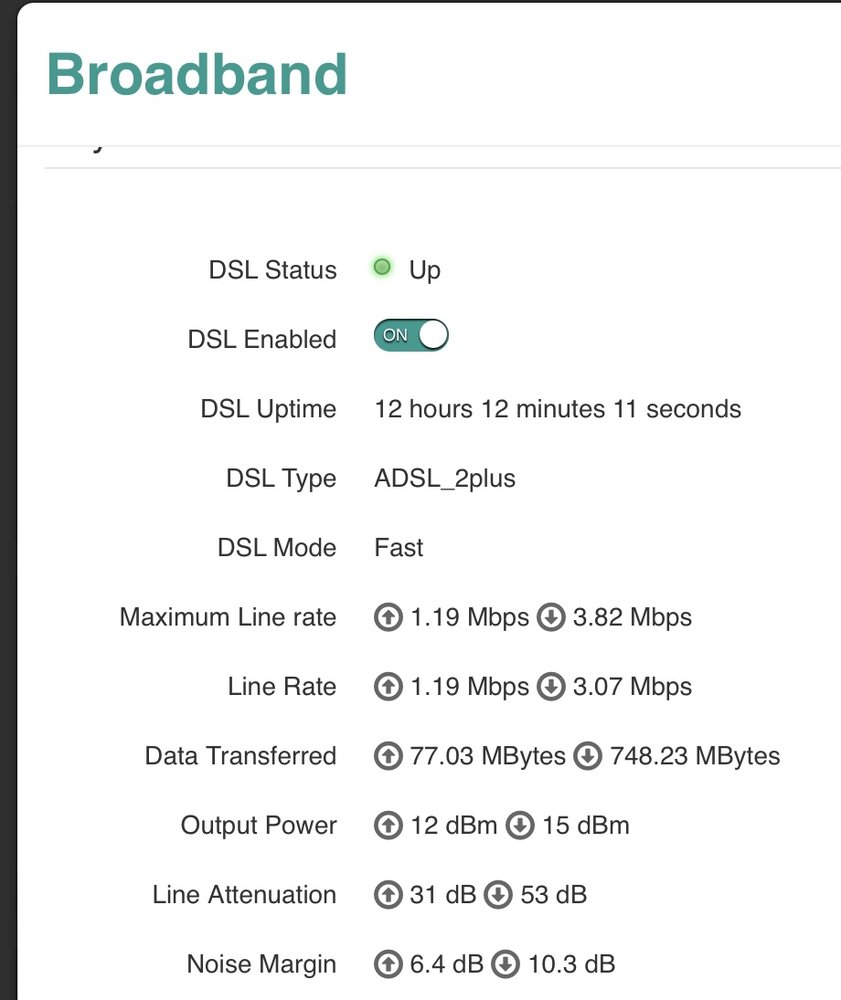

Yes, I thought that was weird.that speed test is measuring it wrong. it is impossible for your throughput to be faster than your sync speed and your upload sync is 1.19mbps. its why i tell people to take speed tests with a pinch of salt.

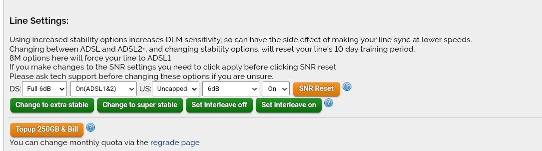

Still, I’d happily knock the upload down to 0.5 Mb/s in favour of the download if I could. Any chance of that?
