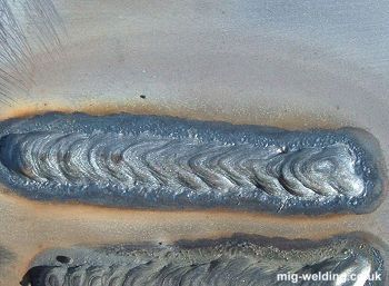

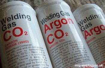

All welds were made in the same hour with the same welder settings on 1.5mm steel using a curving ziz-zag motion. The gases were sourced from a DIY store and were all used at the same regulator setting, apart from the Argoshield Light which was in a big bottle with a different regulator.
A Clarke 155T welder was used on it's second to lowest setting unless otherwise stated.
CO2 vs Argon/CO2 Mix (1.5mm steel or thicker)
The weld to the right was made using 80% Argon, 20% CO2 shielding gas. It was nice and easy to do. The arc was very stable and controllable and the weld turned out quite neat.
100% CO2 gas was used for the weld on the left. The arc felt much less stable with CO2 shielding gas, and the weld progressed in a stuttering fashion with blobs of molten weld (spatter) being blown off at regular intervals. That's a bit of spatter stuck to the weld about half way up on the left. The arc also seemed slightly brighter than with the argon mix.
