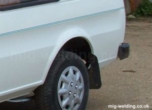

The photograph doesn't do this wheel arch justice.
There are rust marks all around the wheel arch, and some really big bubbles in the paint. The bubbles are about 20mm diameter which is only possible with a really good thickness of paint or filler.
Also the shape is not consistent around the wheel arch. All of these things, together with the lack of metal to weld the end of the new sills on to, suggest a big wheel arch botch*.

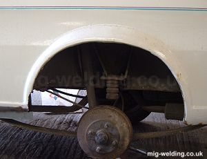

With the paint and filler removed (with the help of a wire brush on the end of an angle grinder) the state of the wheel arch is obvious. It's mostly made of fibre glass.
The car I'm working on is a van that has been converted into a camper. Unfortunately the only available replacement rear wheel arch repair panel is for the saloon version.
I decided it would be easier to buy the saloon repair section and cut out the bits I need rather than making the outer wheel arch from scratch. The wheel arch has been marked out for trimming.

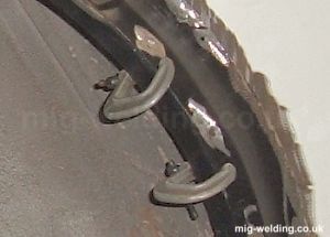

I should give the clamps a mention here. The clamps I'm using to hold the repair section in place are mini G clamps. These are available (from places like Axminster Tools in the UK) for about £1 each and have a maximum extension of 1 inch.
I only discovered then a few weeks ago and they have come in very handy. Their big advantage is their light weight doesn't put any real load on the panels to be welded so you can use as many as you like. I'm planning to buy some more.

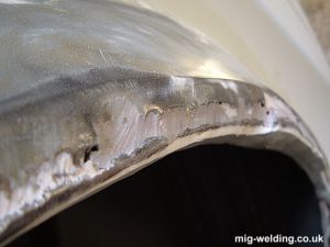

I've plug welded the outer wheel arch flange to the inner wheel arch and seam welded the repair section to the body sides. I've not made a continuous seam weld.
The area behind the wheel arch is inside the cabin so should stay dry. If the area behind the joint was wet then the joint should be fully seam welded. Proper restoration work would also require a fully seam welded joint to minimise the chance of bubbling in the future.
I've used a long steel ruler to make sure the weld to the side panel is below the level of the surrounding panel work.

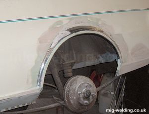

After grinding the welds down, a little body filler was required to achieve the correct shape.
I tend to apply the body filler using the normal plastic scraper, then smooth it using a steel ruler. The ruler removes any excess filler above the level of the surrounding bodywork, improving the shape and reducing the need for sanding. See the body filler page.

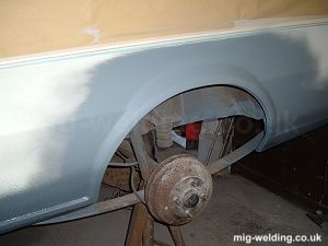

The primer is a cellulose primer filler. It's a high build primer. I applied about 4 coats of the primer and then a thin guide coat consisting of body colored paint mixed with primer and lots of thinners.
The idea is to completely sand off the guide coat using 400 grade wet and dry paper. This ensures a smooth surface for a final primer coat and then colour paint.
A couple of colour coats were enough to finish the job. Doesn't she look lovely.
