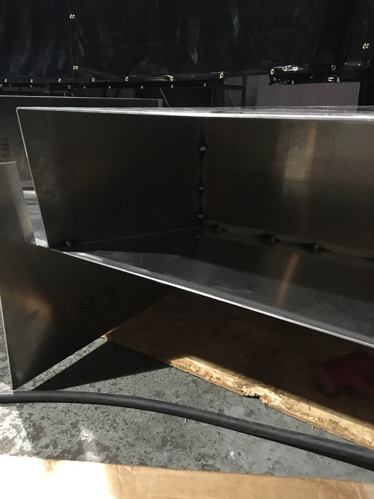

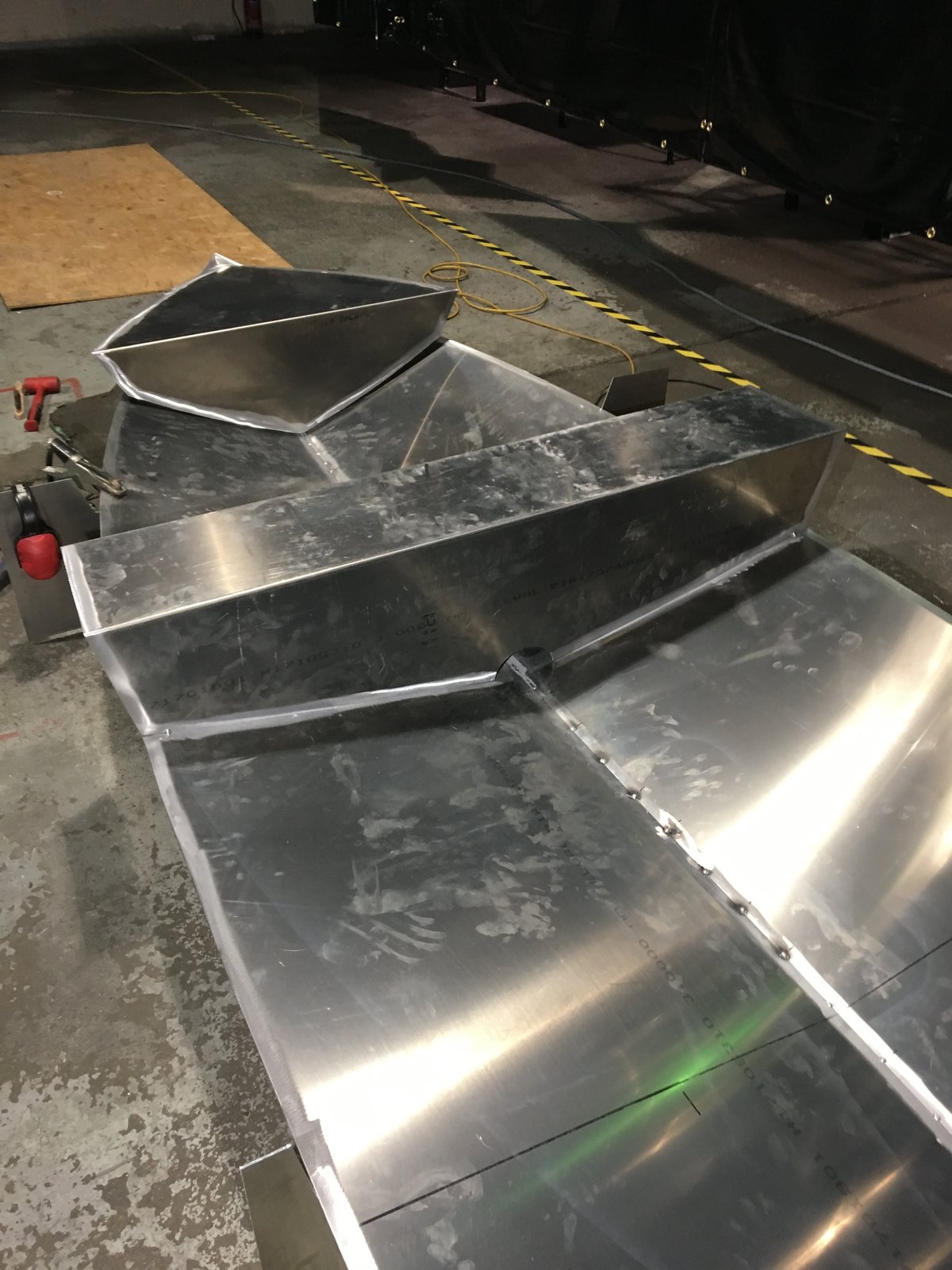

Just as easy to weld on small upstands where required and use clamps, also if you weld only the one side then they can quickly be tapped off with a hammer in the opposite direction and the remnants of the weld cleaned with a flap disc. That is a method I use all the time.
