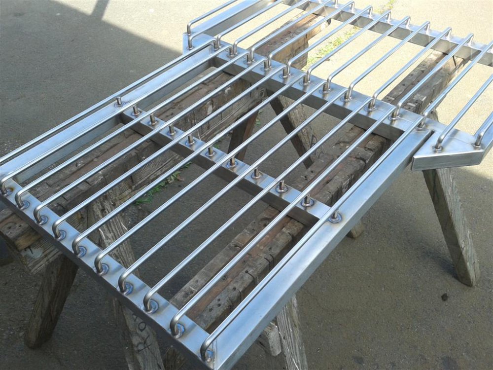

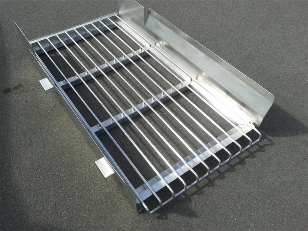

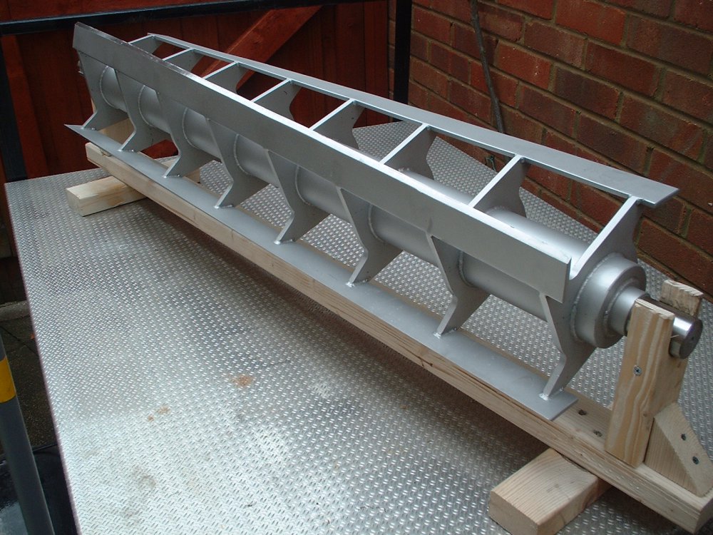

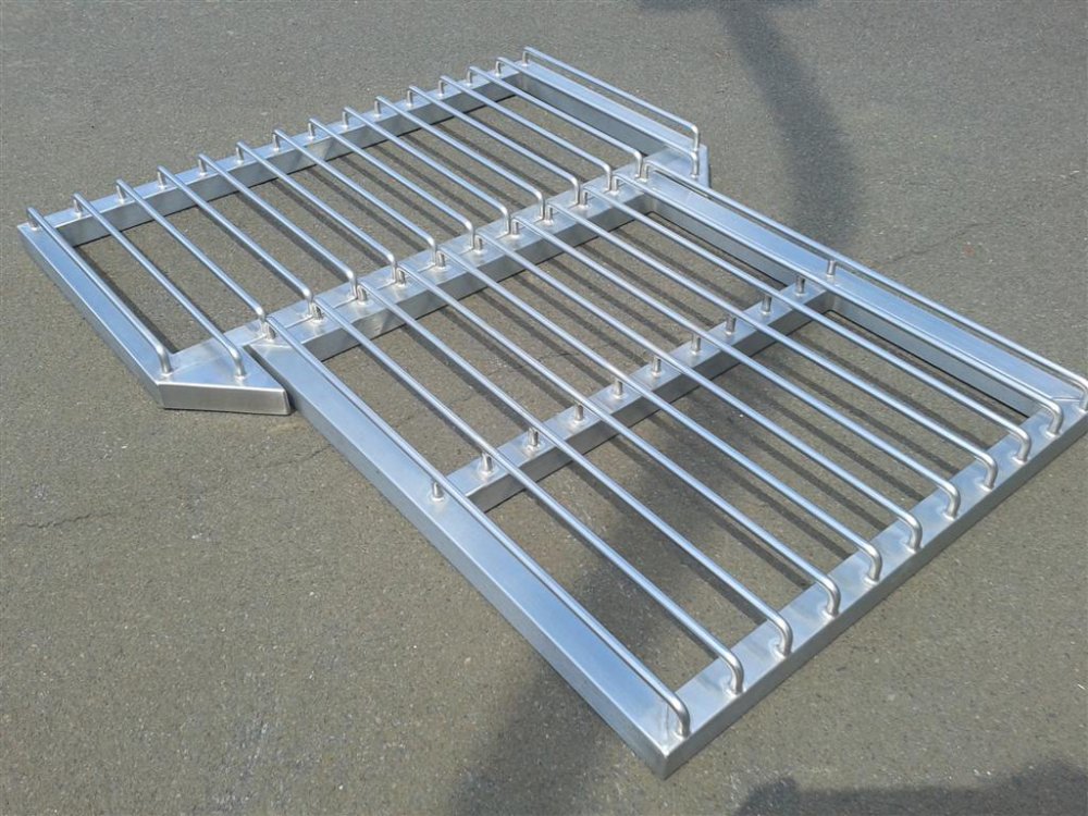

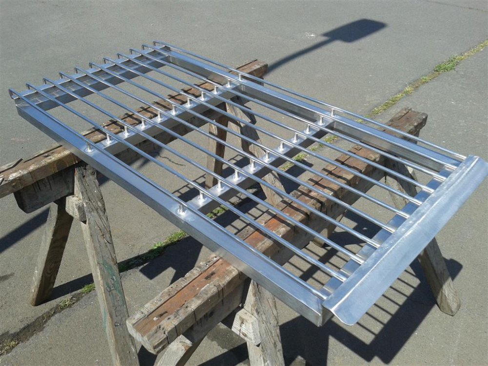

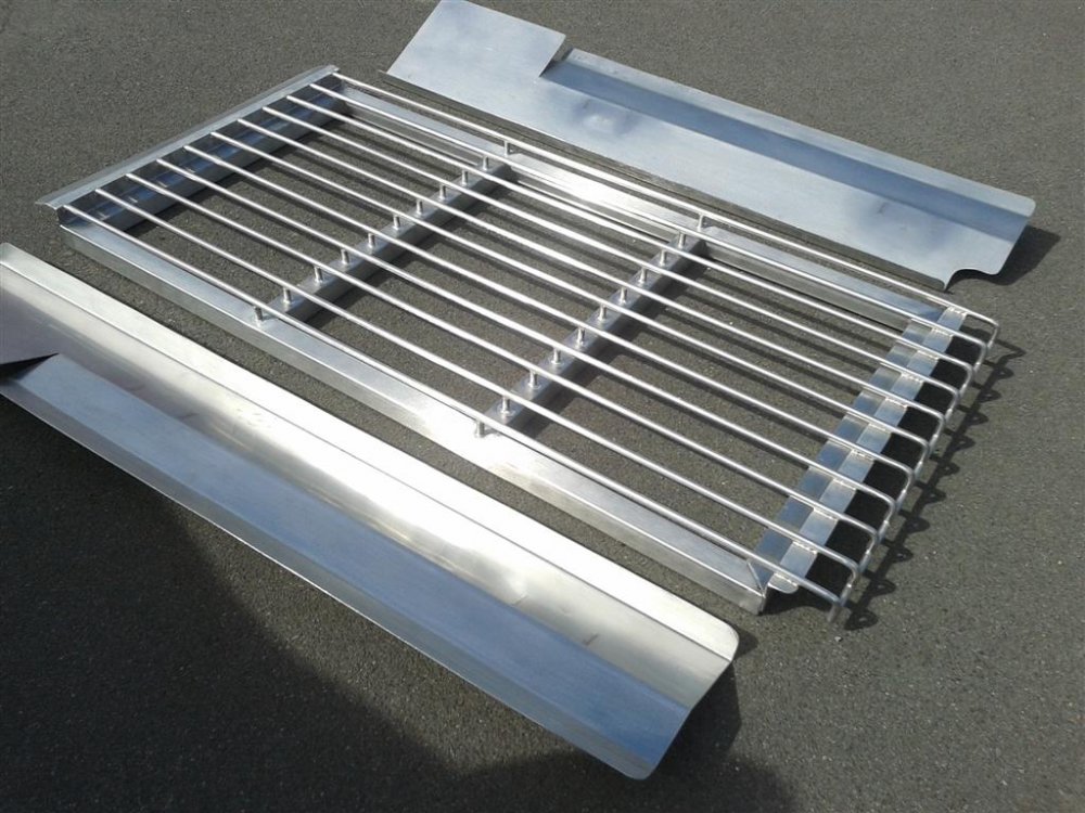

That looks a bit of a swine to weld up Paul. Very neat work mateAnother stainless part, this is a slide to get meat out of an injection machine into a dolav,

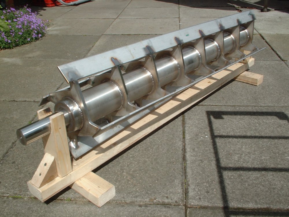

Its actually an alternative to the outfeed roller bed in this job, "clickme" to deal with a different meat product that doesn't travel over the rollers too well.

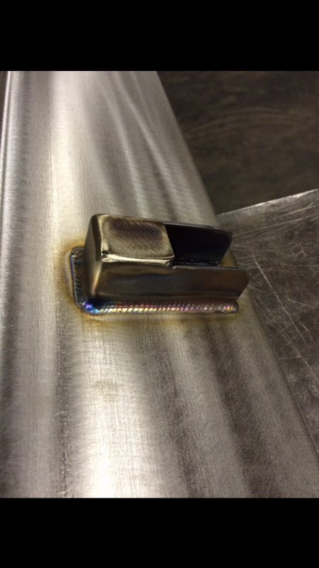

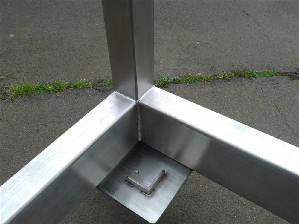

A proper wrist twister welding it up, every joint is continuously welded for hygiene purposes

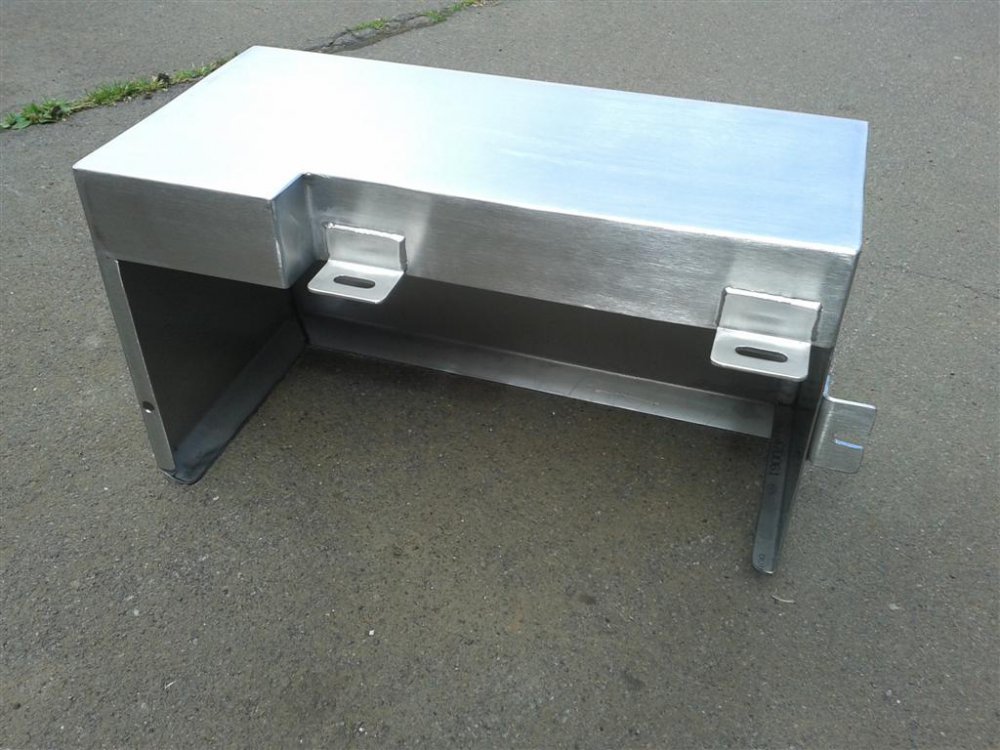

Some sheet metal sides to go with it

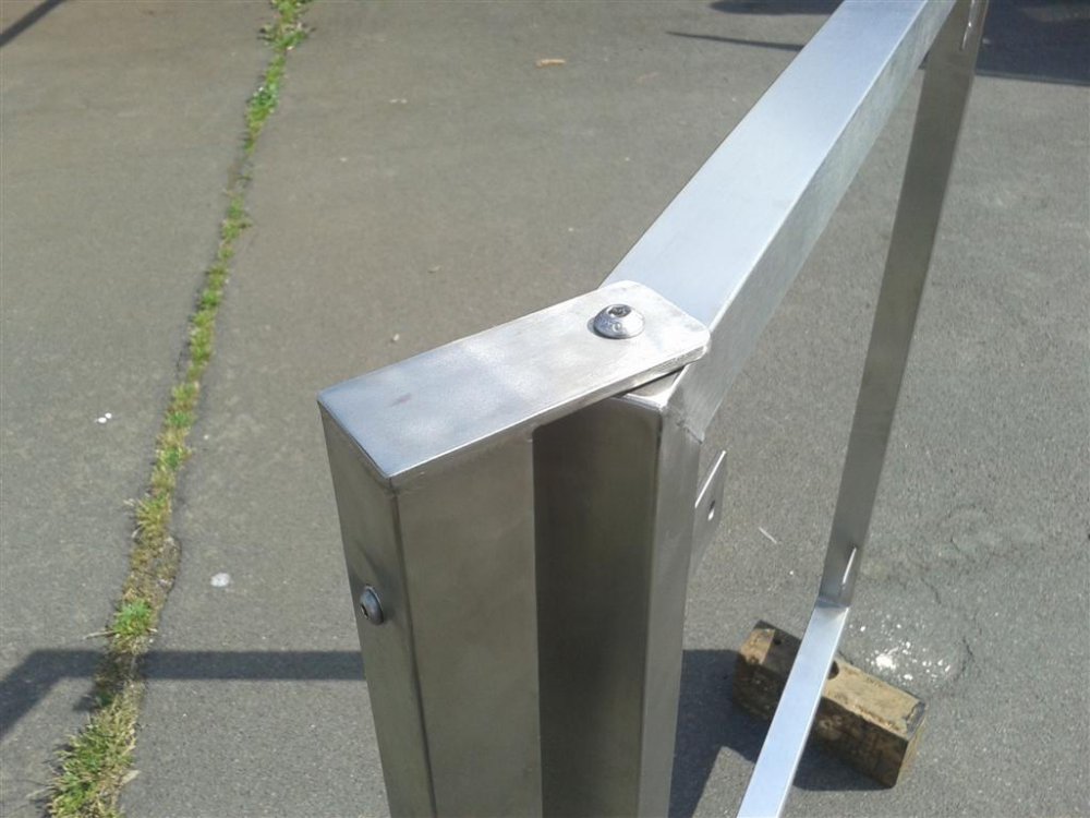

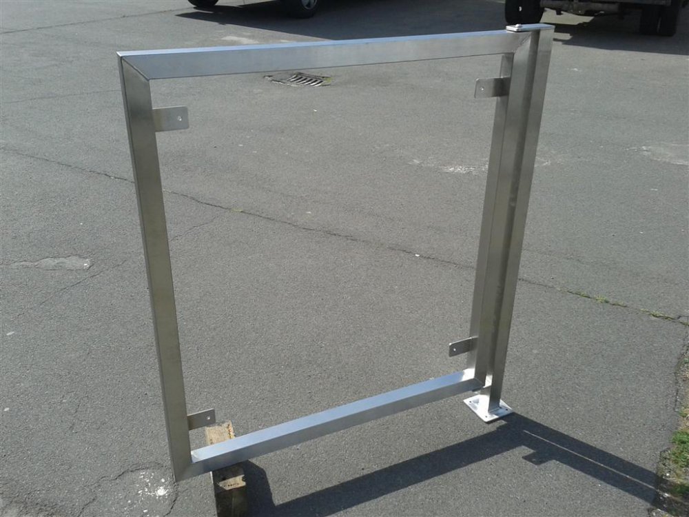

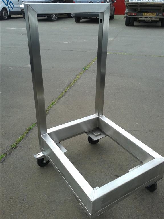

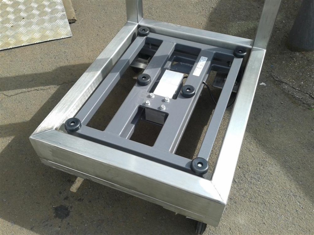

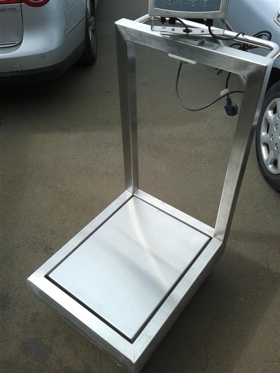

Little job finished off today, its a trolley to make a platform scale mobile, material is 100 x 50 3 and 50 x 50 x 3 box section, the scale is 130 deep and needs to be level with the top of the frame so there is a 30mm box section fame underneath to get the depth,
The scale has rubber feet so some simple location brackets will keep it in place
The scale fitted, without and then with the stainless platform on.

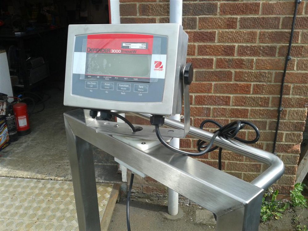

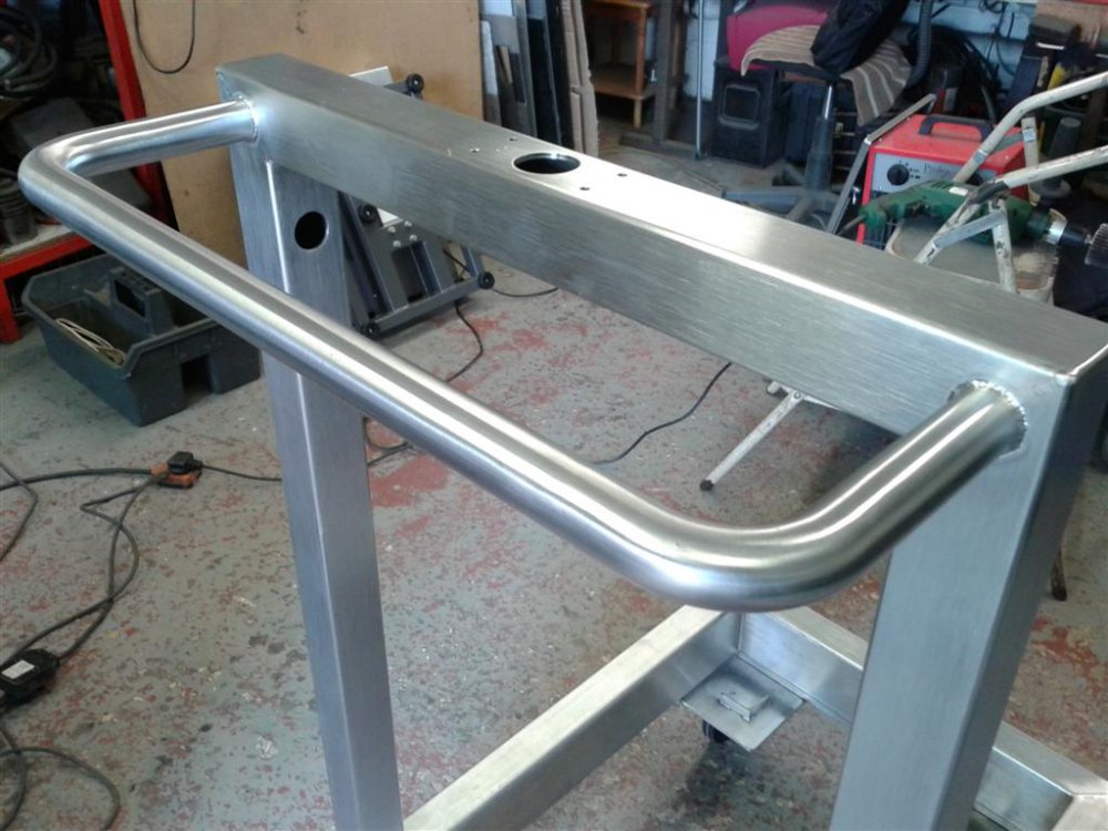

The handle is fabricated from 1" stainless tube and pre formed bends then its all polished out, there are five separate pieces to it, can you spot the joins.
A swivel bracket for the head completes the job, a couple of polyethylene plates drilled to be a tight fit on the tube keep it together and provide a bearing surface
Elbow grease and patience, coupled with a combination of pickling paste, scotchbrite, wire brushes, flap wheels, and garryson blocks, for sheet metal you can get a nice clean industrial finish with a DA sander and scotchbrite,Amazing work! Can I ask how you polish up your stainless like that?
This motor guard was made from 2B sheet, and hand finished with scotchbrite and abrasive block,

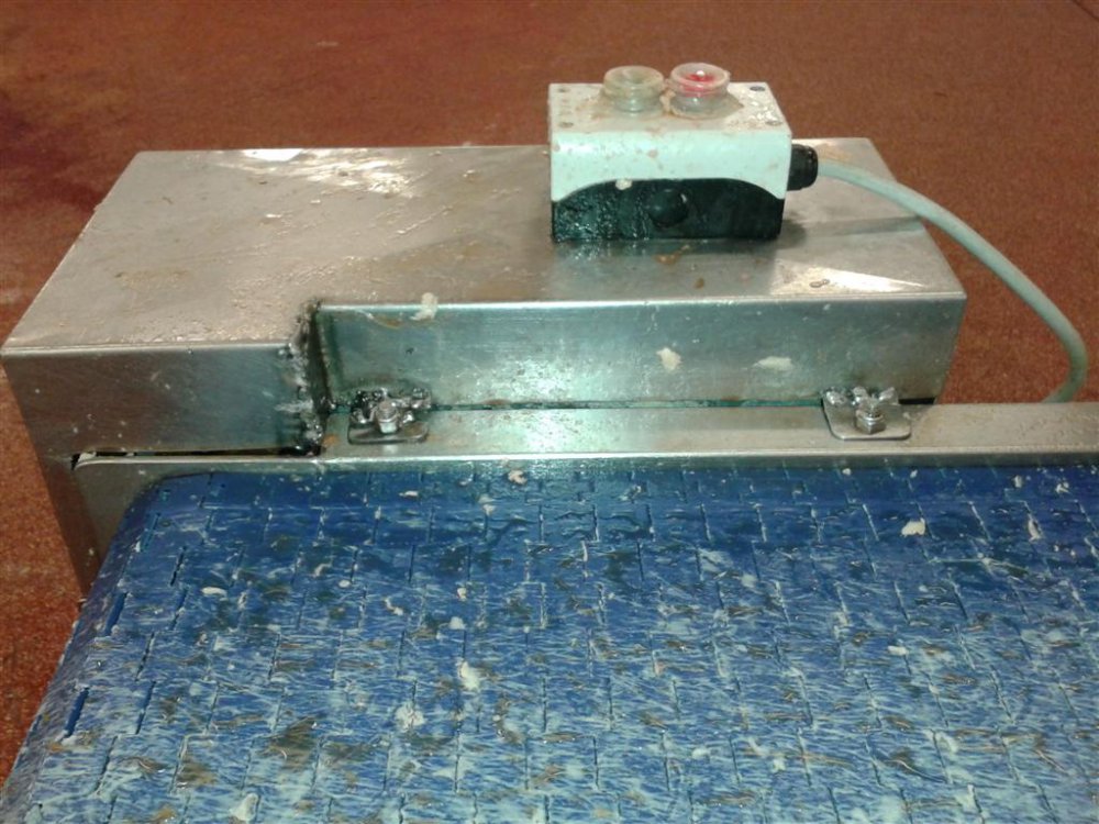

Its to replace this one that Mr maintenance has had a go at repairing.
