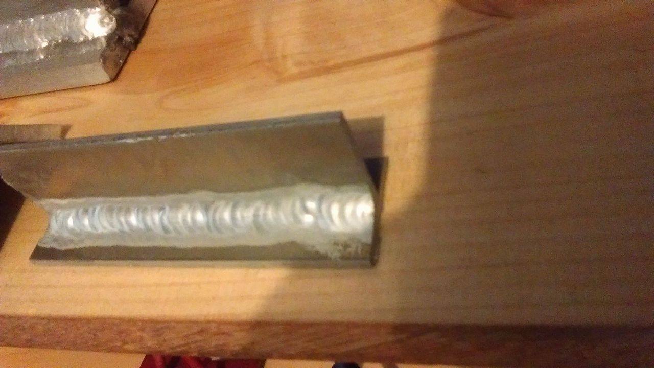

These off cuts I use for my tuition sessions are 6082 T6.Thanks Richard, What grade Aluminium are you using in these examples? Are some easier to weld than others? I got on well with the scrap piece of tread plate.
The filler is 4043 and 5356.
Your chequer plate will of probably been the same/similar 6*** grade.
Regarding striking an arc and laying a run on top you probably won't find that any harder on other grades. If your that unsure post me a bit and I'll weld on it. Put your mind at ease.
That's the same grade I use a lot of. There is nothing wrong with it.I think its just me, but i may try and get another bit of tread plate to test as i'm not getting on too well with this 6082T6.

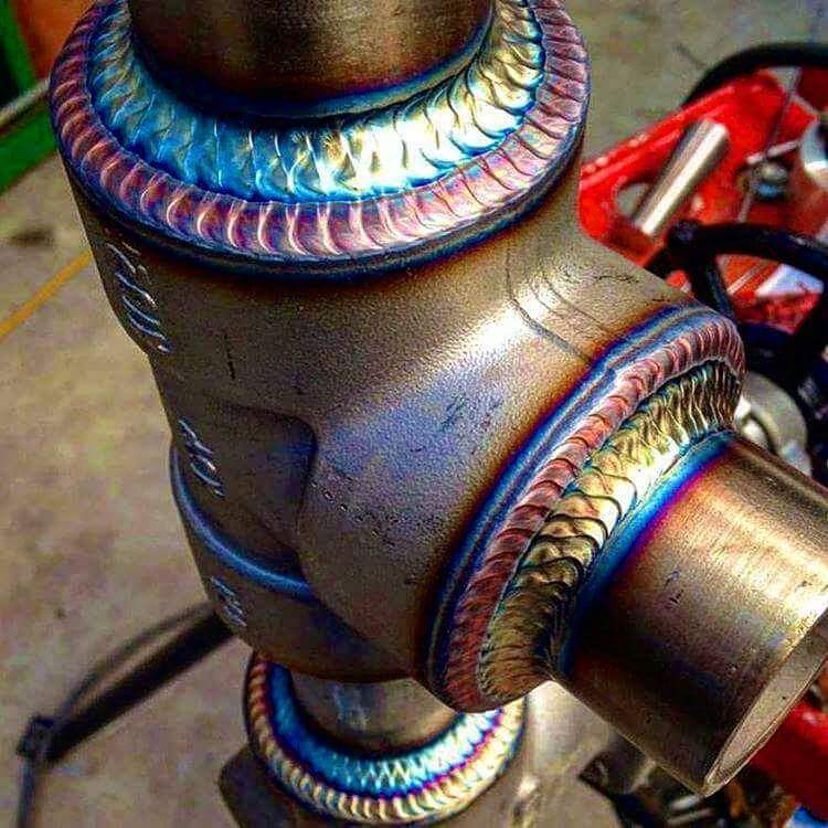

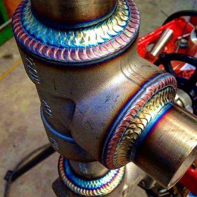

Don't believe him. He is telling huge porkie pies.You should see mine after Richards tuition View attachment 96758
It does doesn't it......I think Richard has already given the game away though.......... I was not even aware this can only be done in steel......lolWow! that looks like a real wonder of engineering UKR
Well your pics look like they are. Coming on nicely so keep them coming and use any excuse to throw them on the threads.Indeed. Often you try move away from the fact of leaning on walls and things because depending on where and what your welding there might not always be stuff you can use to lean on to steady your arm, which then you use your other arm and your body to comfortably prop and hold your welding hand steady.
