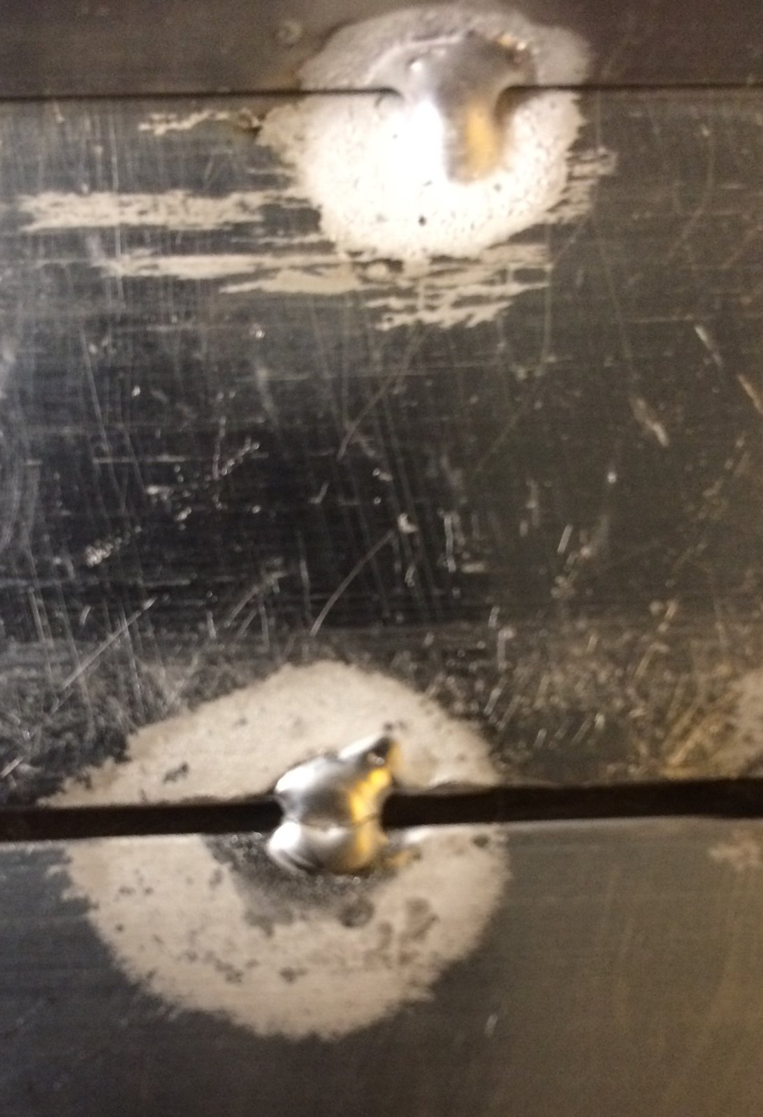

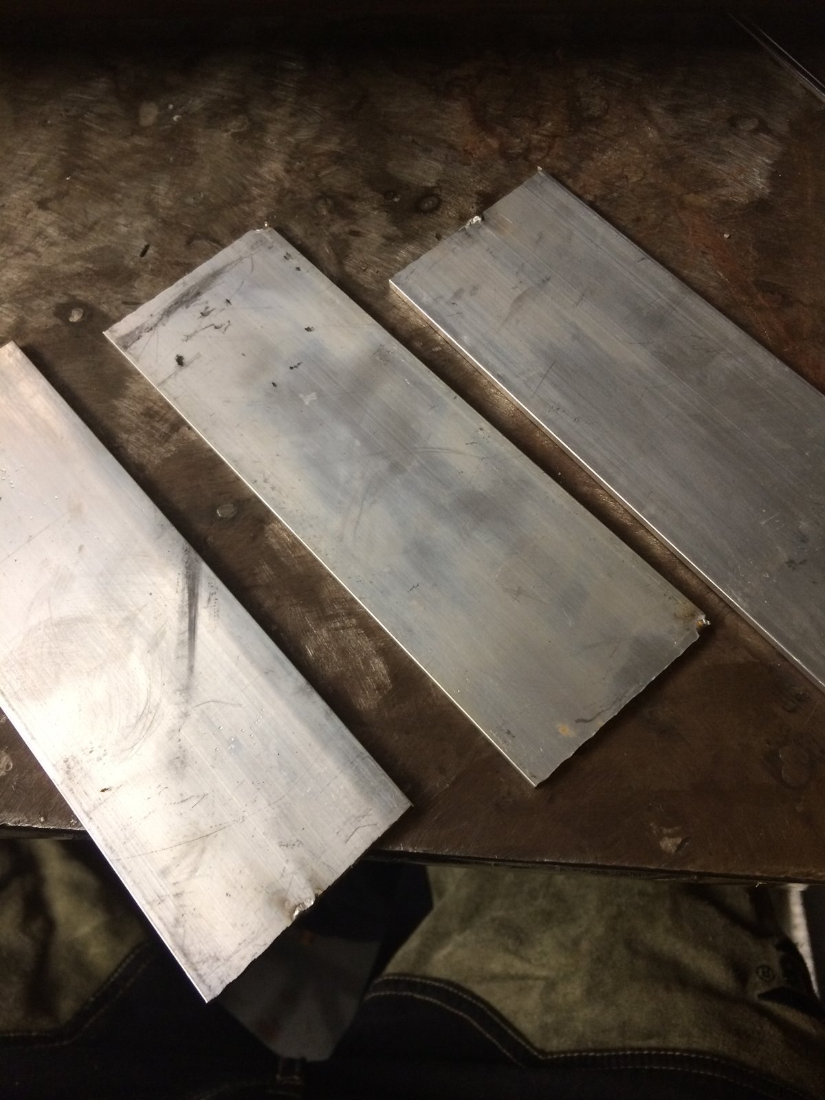

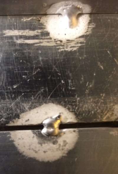

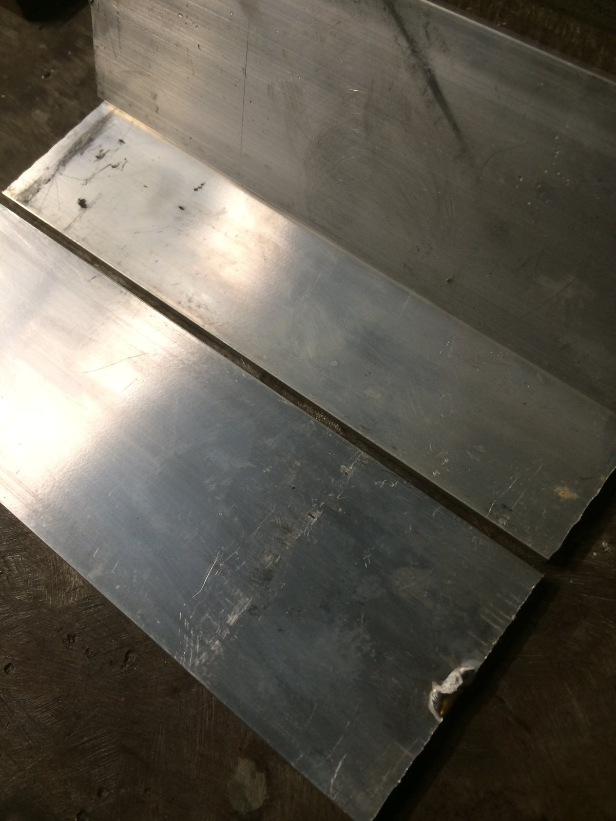

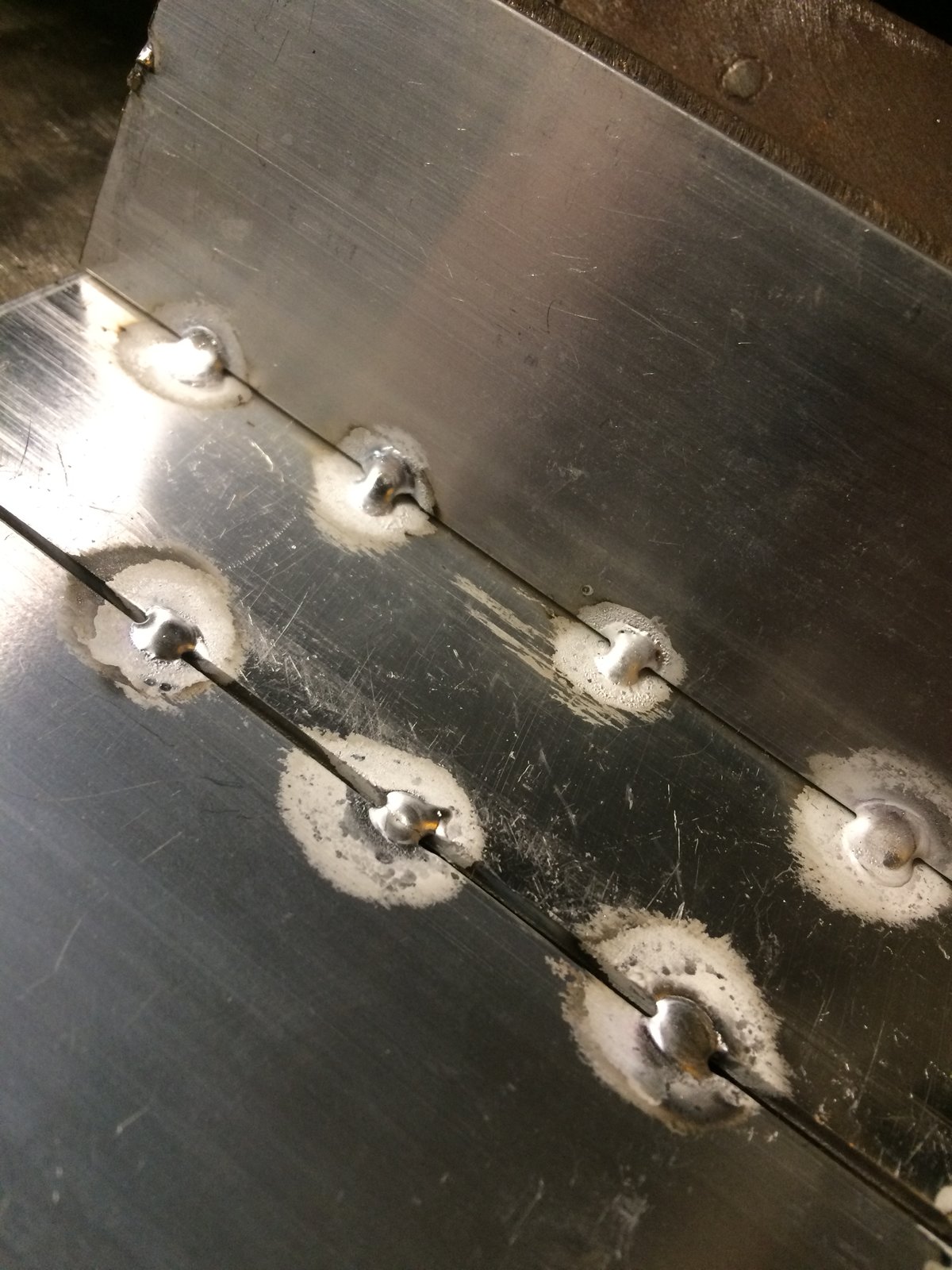

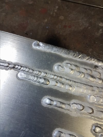

No mate. Clamp it tight to your bench and use the bench to suck the heat out and 1mm Alu is easily doable when learning.Am I heading for a world of pain trying to learn on ~1mm alu sheet? I have a massive pile of it lying around that I could practise on. Would I be much better off buying something a bit more substantial to start on?
By all means plug it in and get cracking with the pedalSo if the pedal is an available option would you say it's a good idea to learn without it anyway, at least to begin with?

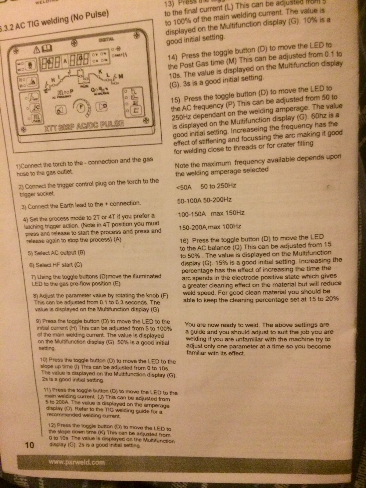

Your dead right with the ac balance. You set the positive side on your machine.On my parweld...
Item 16 on the booklet for AC tig with no pulse for Ali .. I can only adj my AC balance from 15 to 50% and adj to the positive side..
so to say get 70% negative as I believe Richard suggested does that mean I set this to 30% on my machine.. if I want 60% to the neg side I set it to 40%..
Also to set the initial current No9 on the booklet, it says I can adj the value from 5% to 15% of the main welding current but, when I try to adj the figure is set in Amps rather than a percentage ? So I guess? If I want 10% background and main current is 100amps I set it to 10 amps.. seems a daft way to set it imo if I'm correct..

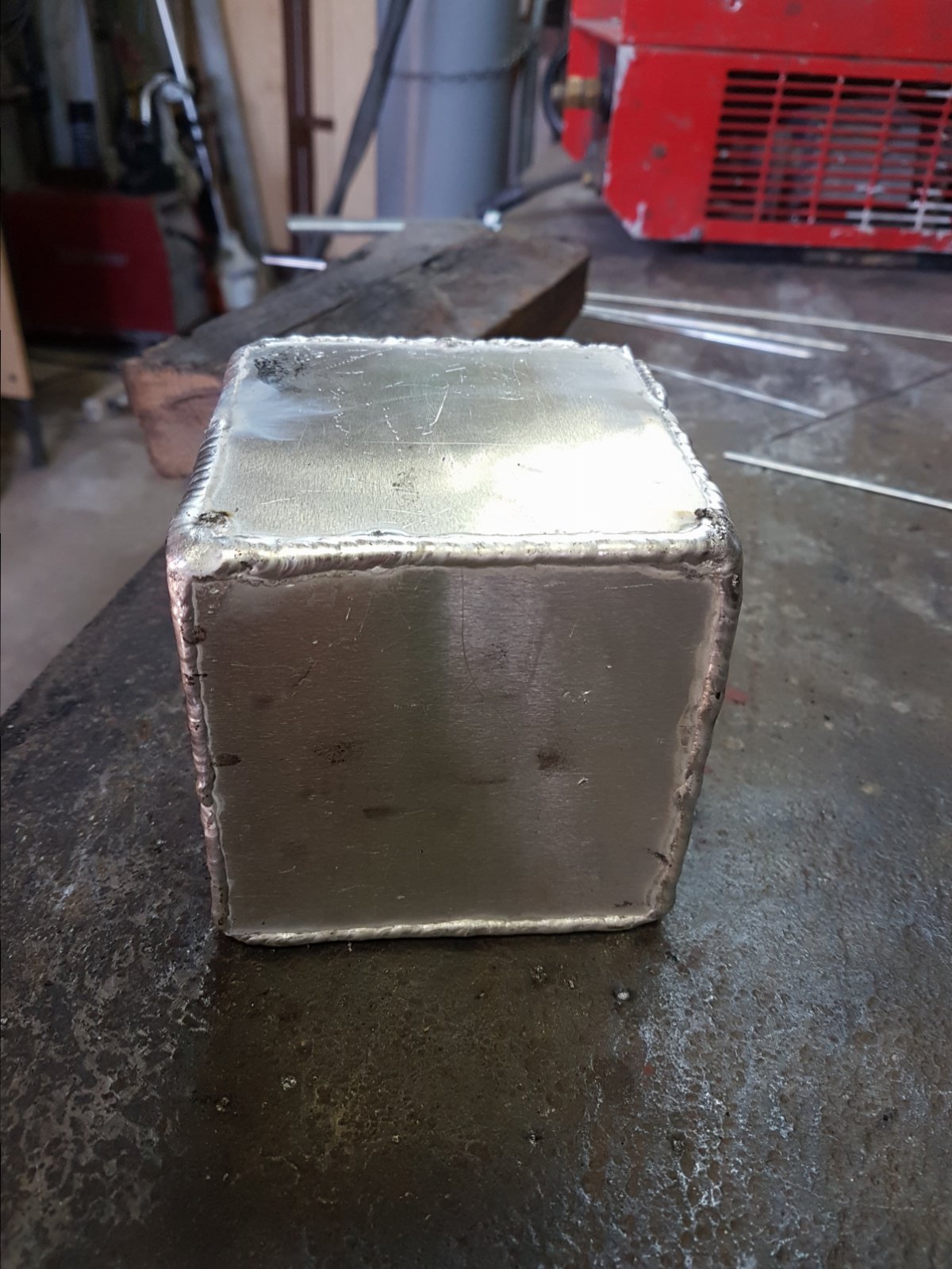

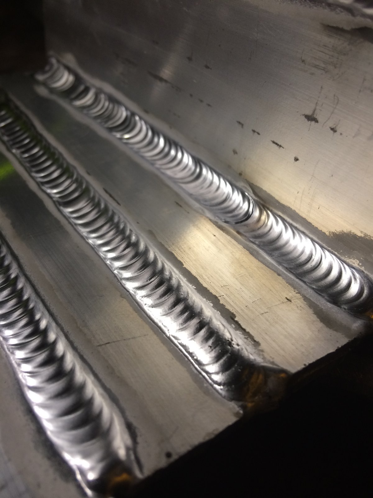

My preferred are
3mm outside corner
5mm butt and lap
8mm fillet.

Is there any ways of telling what series alloy I have??
2.4MM 5356 is what I usually use for most jobs, then again I mainly weld marine stuff so......Or is there a generic filler rod for practicing?? And thickNess?
