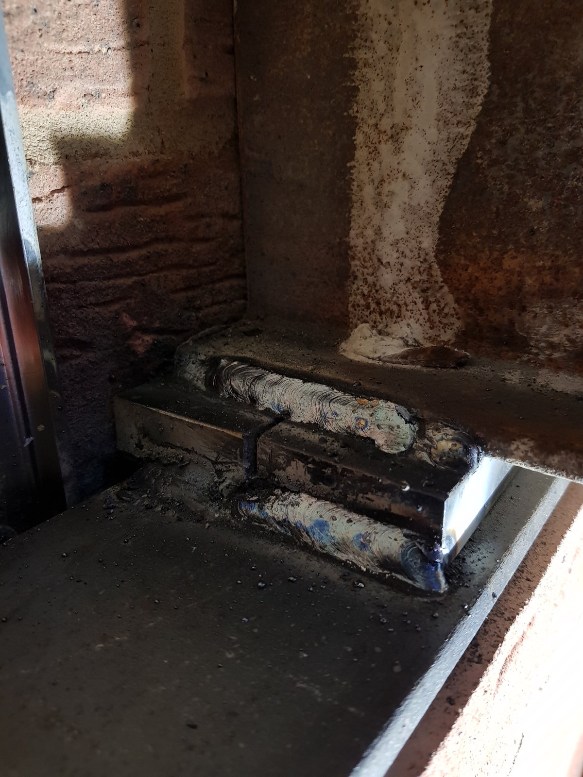

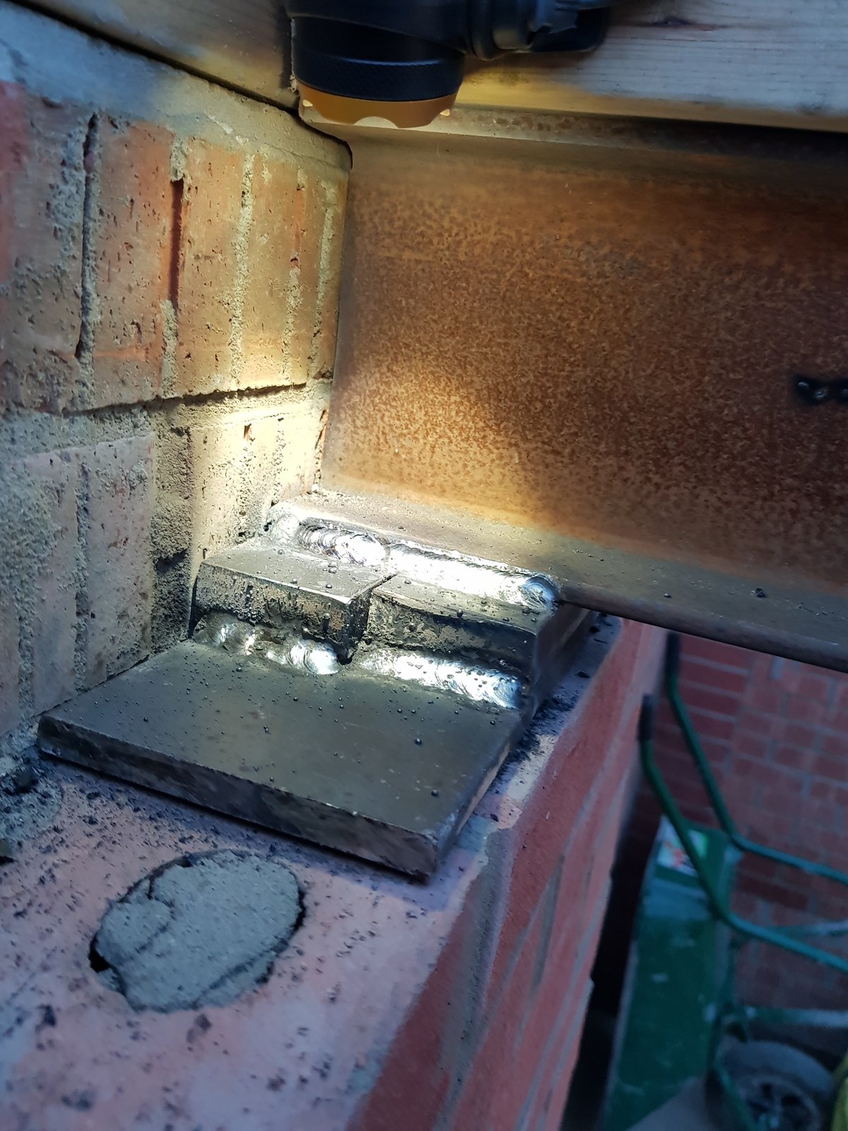

View attachment 125241 View attachment 125242 Stick welded a fillet joint can be a pain. Especially when you can't see to well and out of position. I just welded some brackets this morning. Couldn't see a lot. Damp rods. And a crud make of rods. Over gunned them to. Worm tracking is sometimes down to incorrect rod angle and speed.
Beam’s a tight fit there..
