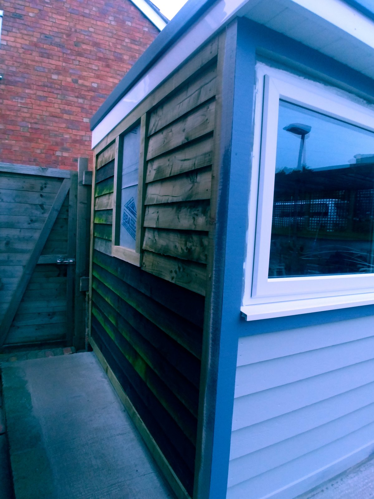

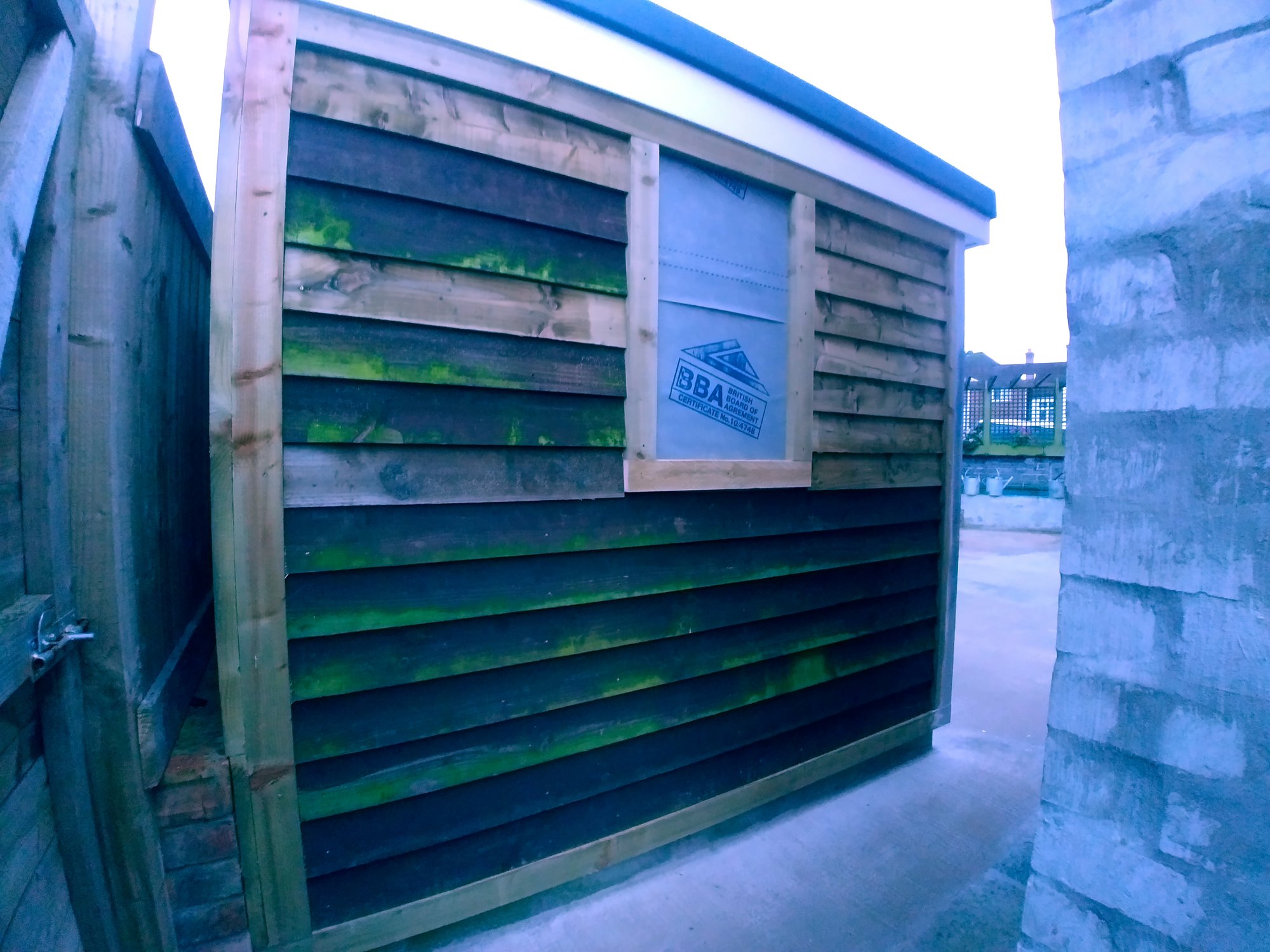

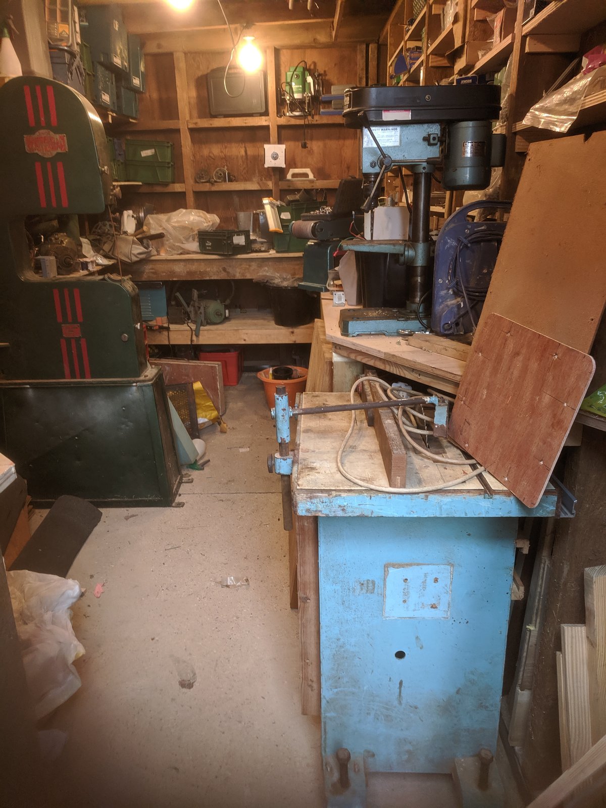

Oh how I miss working in a shed that size, not!I've got an excuse with mine.
All built using reclaimed roof materials.
Been bone dry for 3 years though.

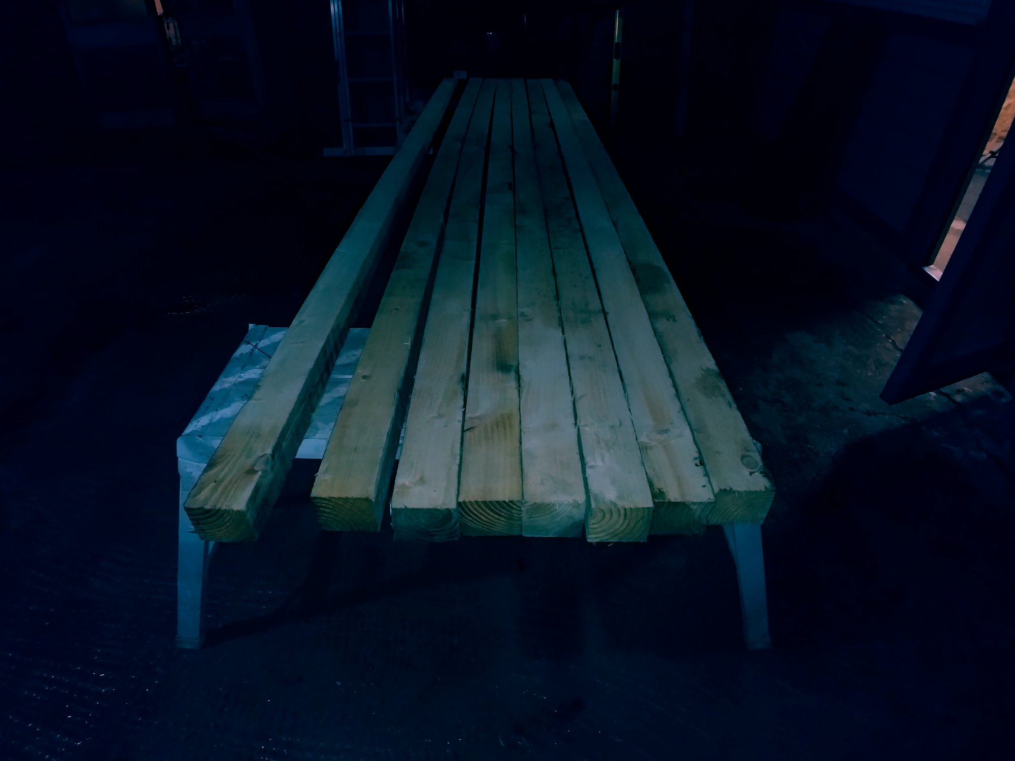

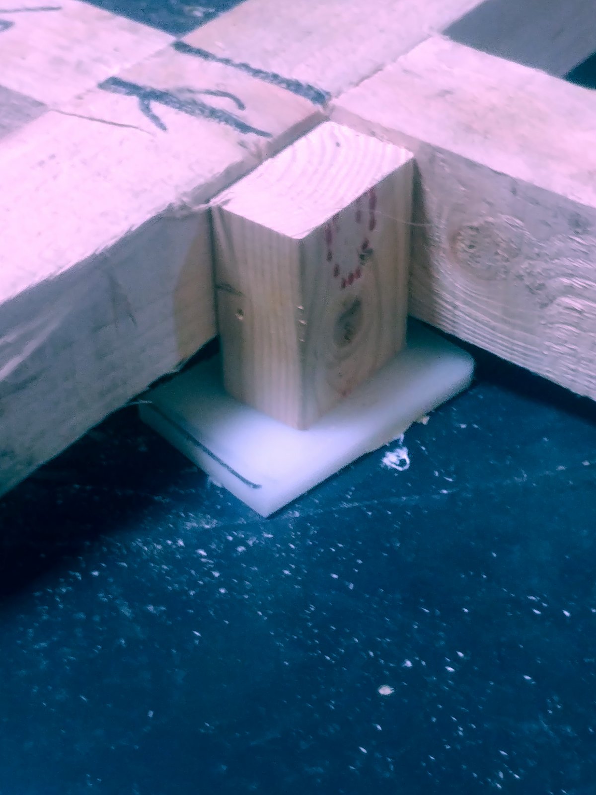

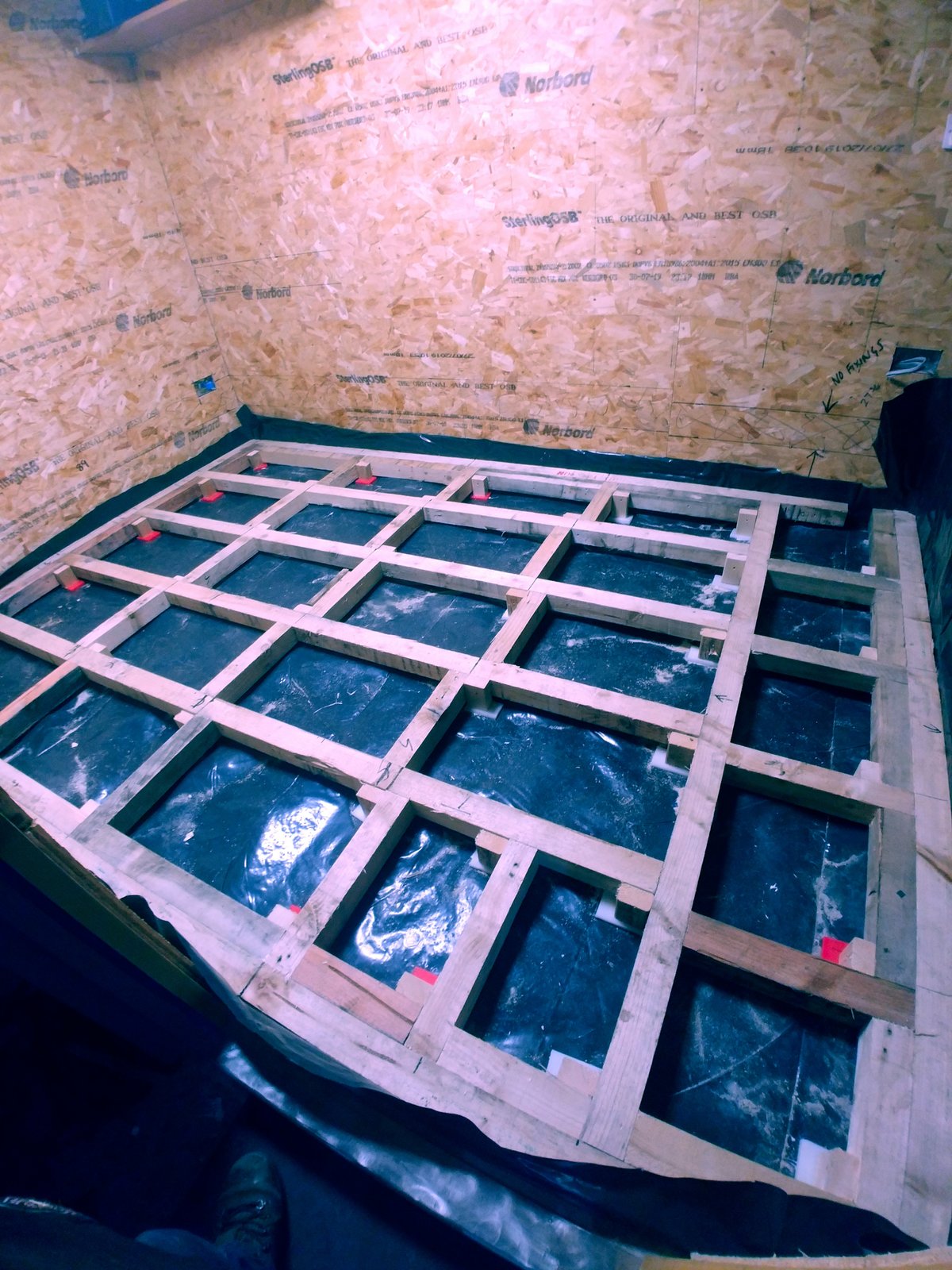

the beams are about 3" square and the stubby legs took all the bounce out the floor, but there are some packers under the beams in places, The original floor was part of the concrete yard and had a slope on it for drainage so it was a pain on my own to level up but i will give it a good bounce test before the flooring goes on later today.If the floor has to carry a high load why the stubby legs and why did you not support the "beams" directly from the pads? You've now got loads of failure points in the verticals which I assume are screwed or nailed. I'd have used larger pads that overlapped the whole of each joint area. But then I do like going OTT. I should have been a Victorian engineer

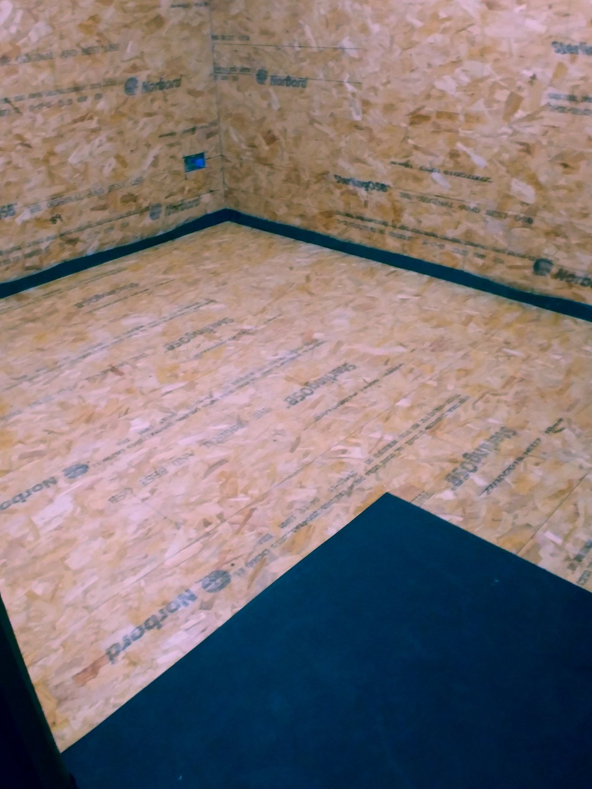

Nice and simple today putting the OSB floor down and as soon as the door was closed it felt warm

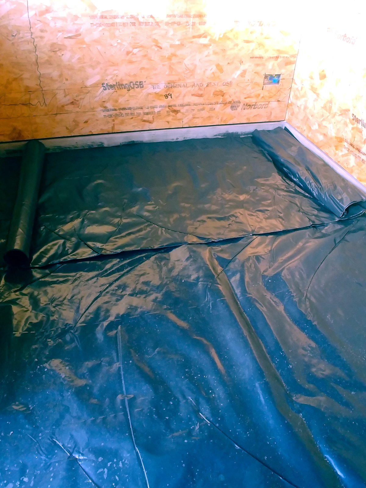

Yes i used some 100mm fibre glass insulation i had sitting around and the OSB is 18mm which my local builders place has for about £11 for a 8' x 2' sheet so i use it roofing flooring and walls.Hi did you insulated before OSB went down ? What osb thickness did you use ?
