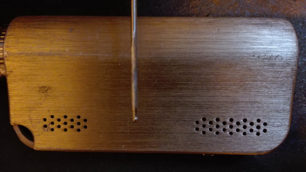

Lower frequency will make focusing the arc even tougher on a fillet weld which was what the OP said he was struggling with. Highish amps to start, bit of neg balance and up the freq. will all help to get the arc to go right where you want to to quickly without the arc wander you get with big tungstens and low freq.
