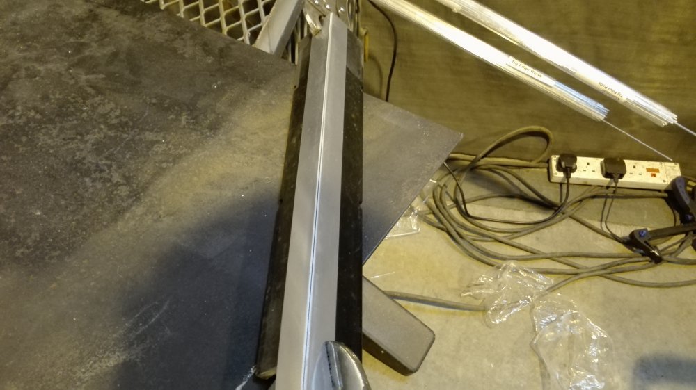

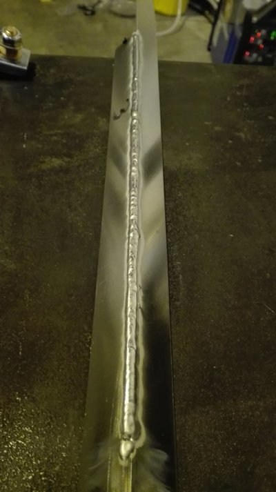

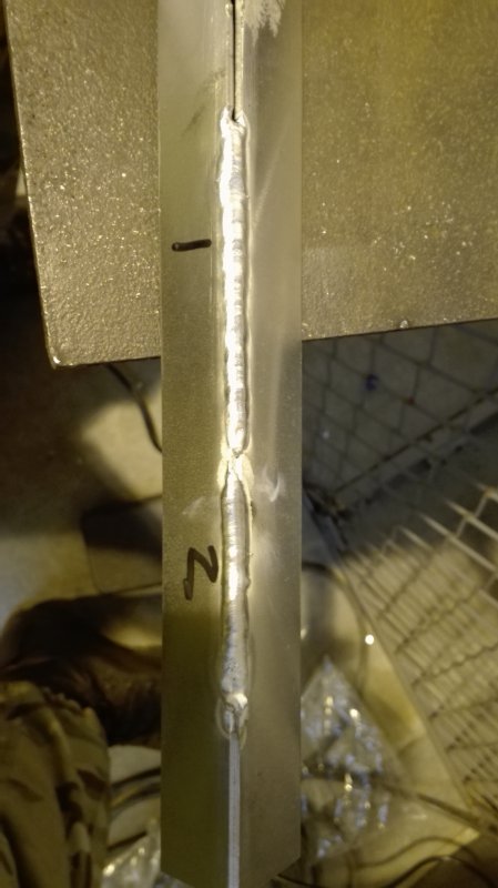

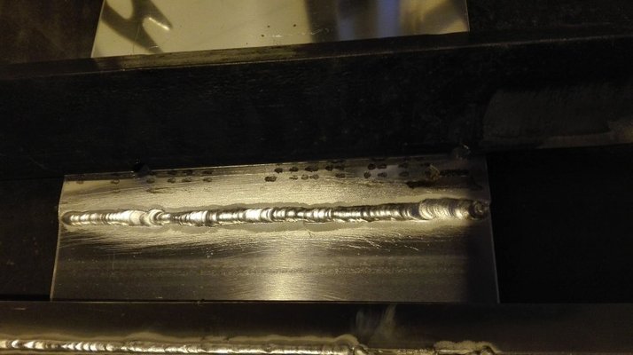

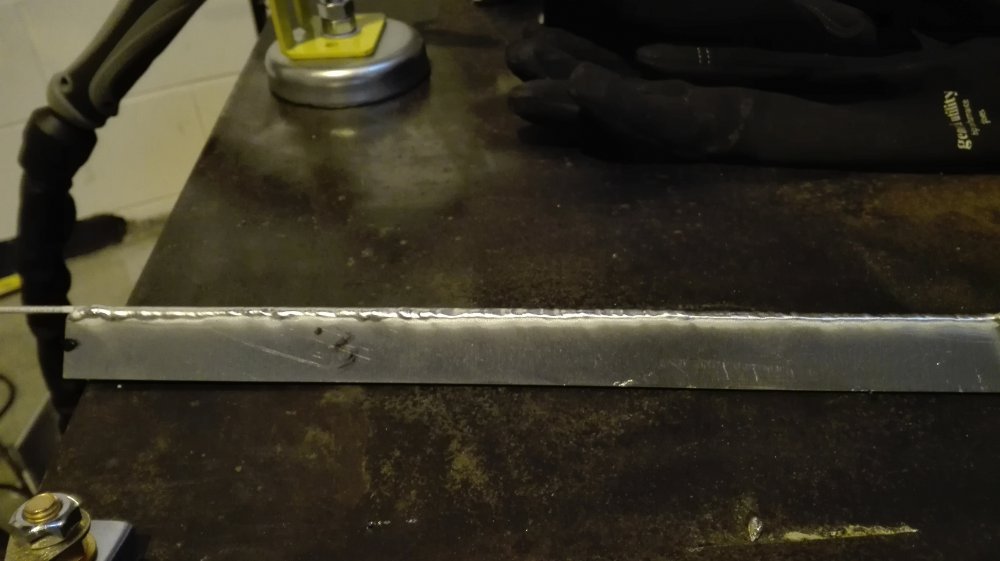

in my view i would expect you to go far with what seems like a gift , i practice but nothing near the ability you have !
Your torch is laid back a bit far but your feeding technique for filler rod is excellent.
couple of months on and off ! but old, bad eyesight and knackered hands don't help !How long have you been at it?
I spend an un-healthy amount of time in front of YouTube watching so many different videos which helped me a lot.
I do plan to get myself coded later in the year so for now its all about getting plenty of torch time in.
yeh need to get myself some better gloves and changing the protective screen on my shield helped a bit ! i need to learn to set up better too , so i can rest these old hands and stop the shaking!First time I picked up a mig welder I hadn't taken the protective film of my mask....couldn't see a thing
One thing I did find that helped me was a slightly thinner pair of gloves...although my hands aren't knackered I really struggled to tig with bulky gloves.....perhaps that's something which might change in time
Yes the first thing I noticed was the angle of your torch is too far inclinded you should be only a matter of 10-15 degrees off vertical and that's only so that you can see what your doing and room to add fill. The more vertical you can get it the better.Oh really? I was actually worried it wasn't back far enough! I must admit it does feel as though I'm holding it a little cock wristed so perhaps straightening it up a little would cure that so ill give it a go. Seen videos with people holding it bolt upright and still producing some excellent welds.
Pleased to hear your comment reference the filler rod! Yesterday I couldn't feed it at all. It's still a little shaky at the moment but I guess that's something which will improve with practice?
I'm impressed with your control of finger feeding it looked smoother than mine and I do it all the time. I was also suprised at how slow you were travelling. That vid was 2 minutes long, Id of done the full plate length in that time. Get that current up and get travelling. Alu Tig is or should be quite a quick process .
Agreed. Comfort makes like much easier. Not always easy to get comfortable though but while your job is on the bench its nice to be comfortable.One of the things which suck with me from my quick intro to tig was that if you're not comfortable you've pretty much lost the battle already. It didn't help that the guy who showed me the ropes is about 3ft tall and has the smallest welding bench I've ever seen....I was hunched right over on it.
