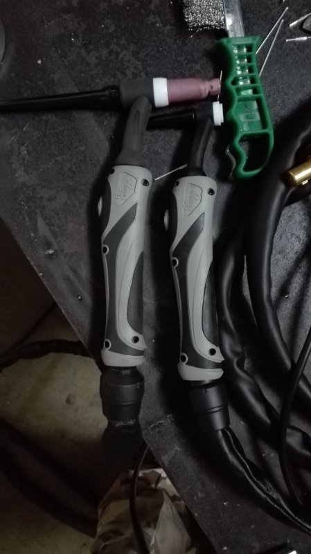

You've got one of those fancy grip style 26's haven't you with a big chunky body?

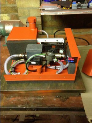

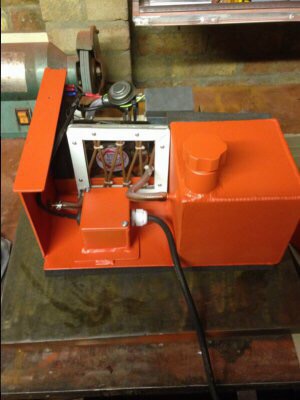

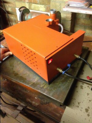

Taking into consideration the lengths of runs, material thickness and your interest in the process I strongly advise against wasting money on buying a wp9. If you buy a cheap one you'll be lucky if 90 amps ac doesn't kill it and if you spend money on a ck or like then you've done over £100 for (maybe) 100-120 amps ac and that is seriously limiting if you have 200 amps on tap. You can build a basic cheap cooler for £100 and buy a parweld wp20 for £80 which is a faaaaaar better introductory way of reaping water cooled benifits. I can advise on cooler building if your unsure As ive made a few nice ones and you could use your new found skill to make the tank. I can only imagine your going to get advise on running a total loss cooling system next and tap off your supply. DONT do that. Not only is it a waste but tap water will eventually ruin a good torch. Water cooling is the best move you could make for your kit and it doesn't need to be expensive.
Yep. both those torches look gash to be honest.... I'm not a fan of those style at all. I will bring a straight handle style 26 with me for you to try (I'm not lugging the cooler and wp20 into the car ) I expect you will find it better... My first cooler was a 1 gallon bucket and a small gear circulation pump. Doesn't need to be anything fancy.
