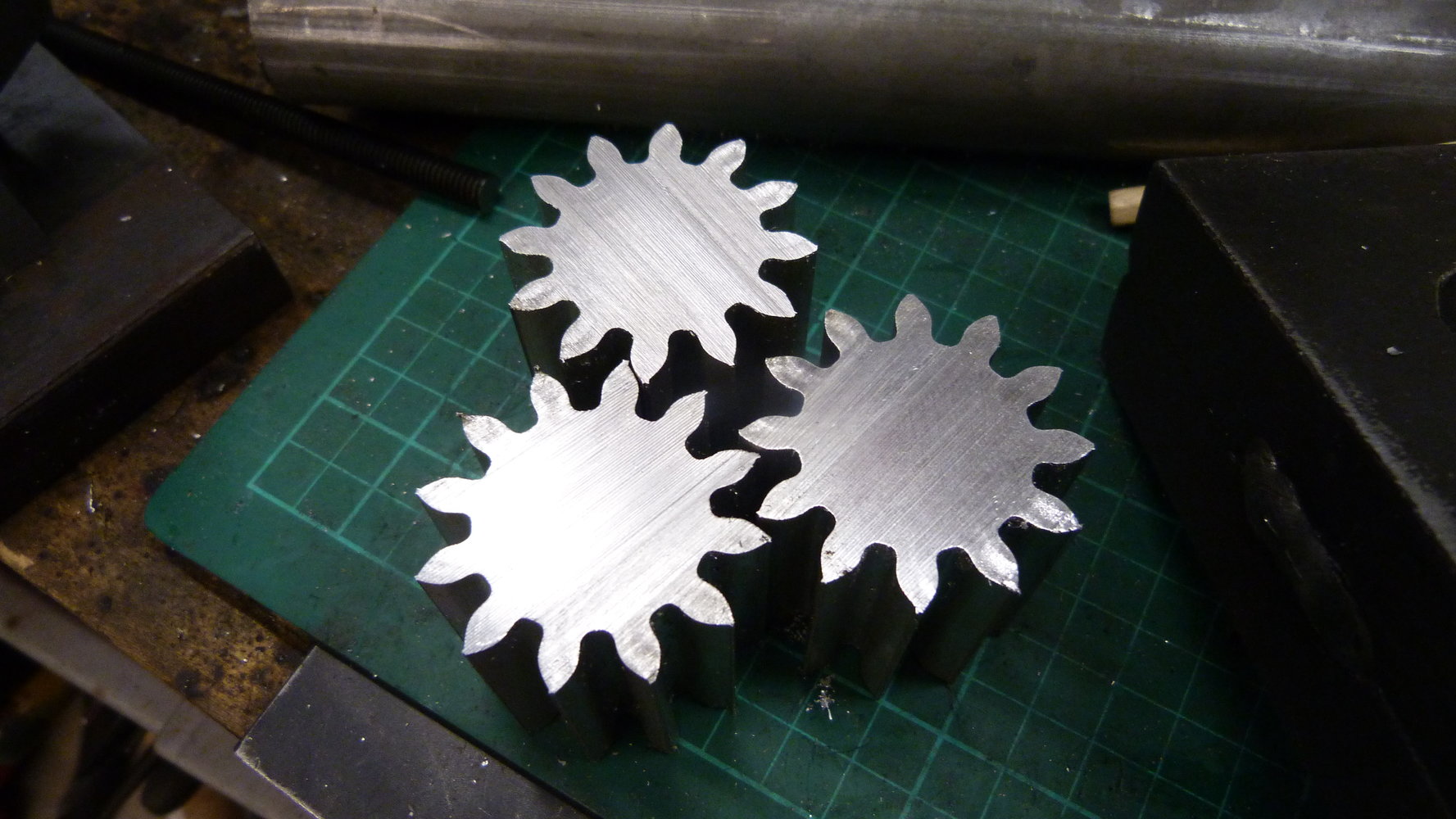

The 12 tooth 8dp gears use a 1.75" blank so I thought it would be best to have a go on some smaller and cheaper ally bar first just to get my eye in. I wasn't trying to cut a gear, just get a taste of how the cutter feels and to test my set up.
These are some test cuts.

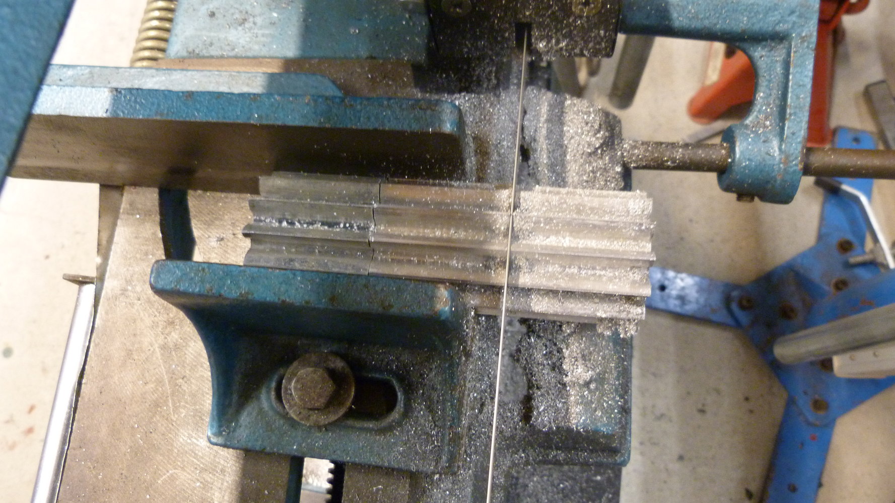

New bandsaw blade day. I think the thick plate had killed it. It was sticking and jamming on plate the other day and it took an age to cut the practice bar of ally.

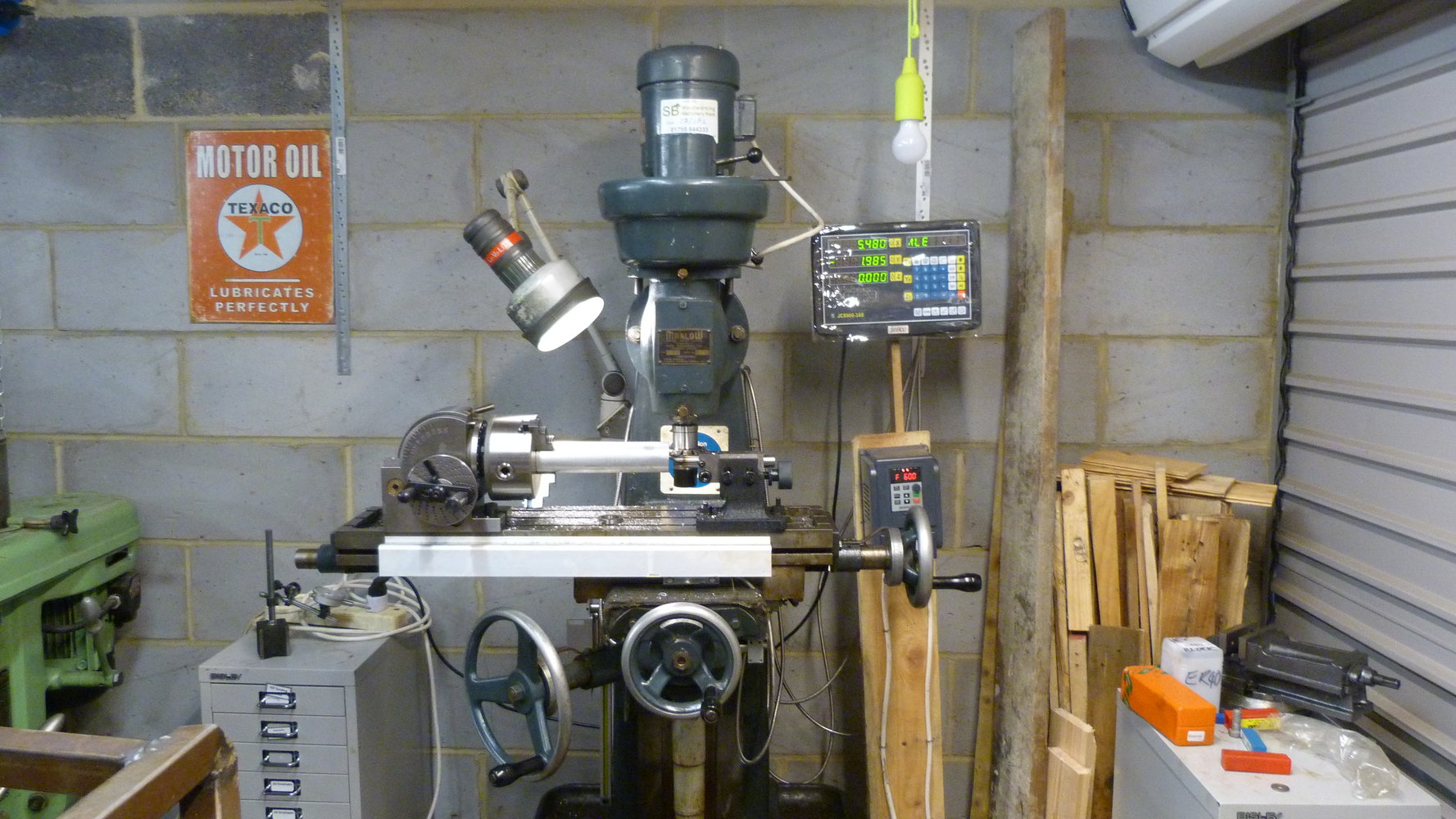

It's a big old lump. 1.75" bar, so no machining required. At least for my requirements of accuracy anyway.
I thought I'd make a big long gear that I could cut into smaller pieces later on.

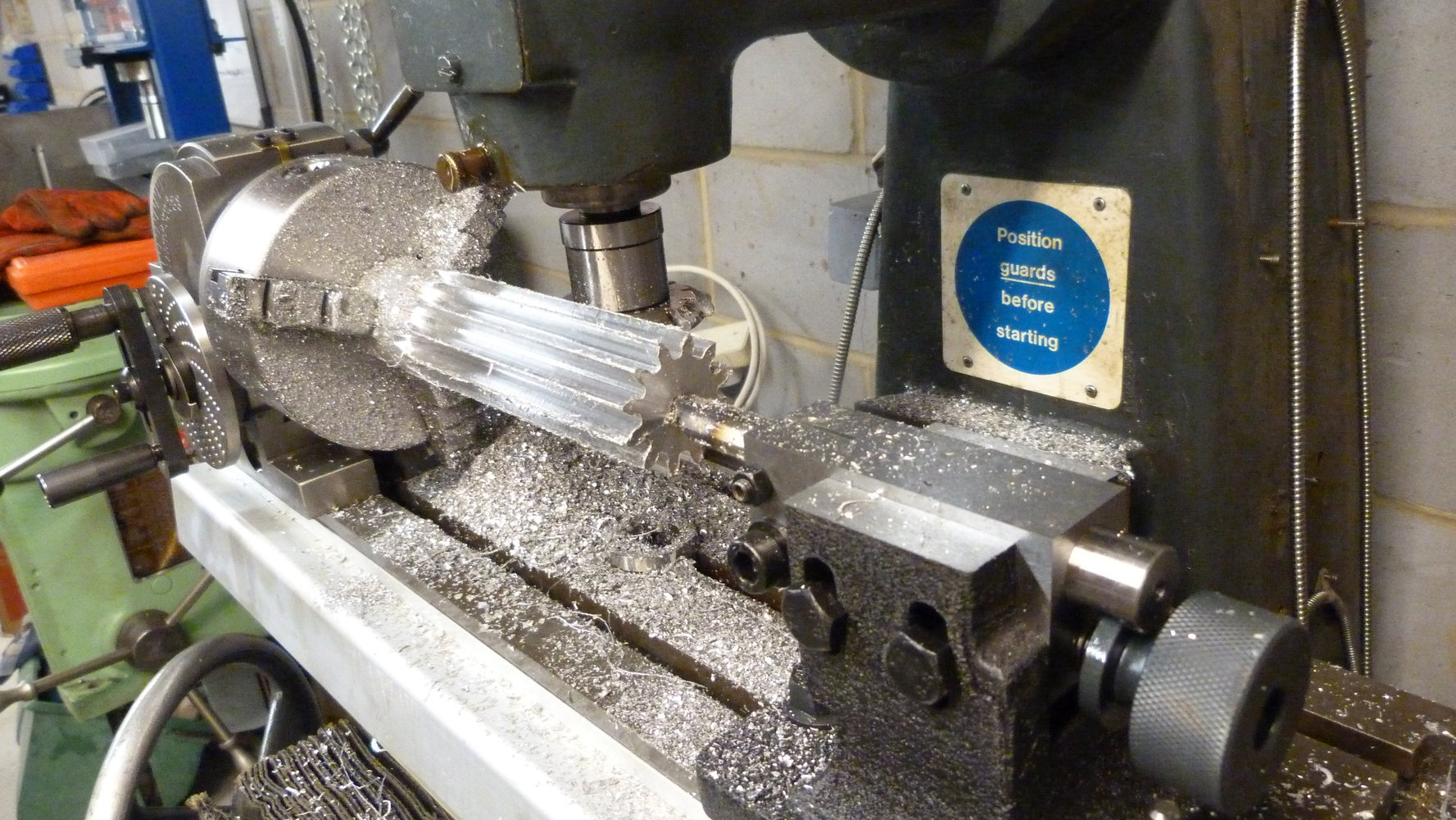

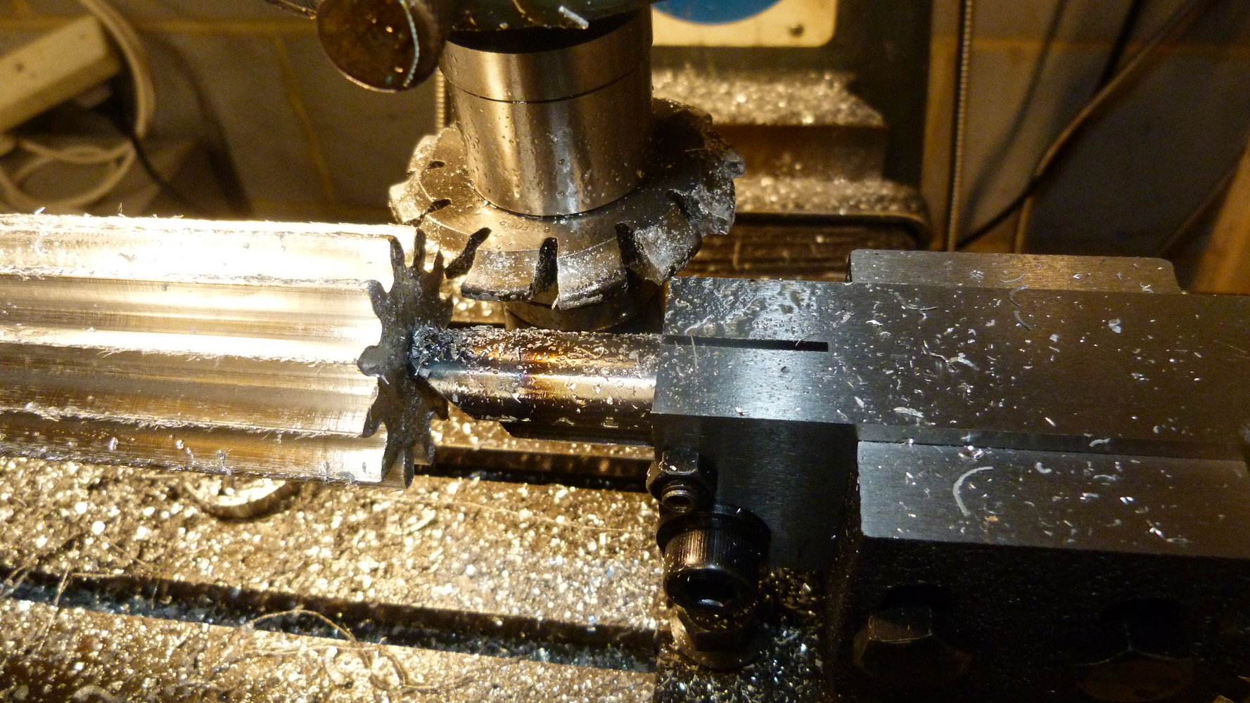

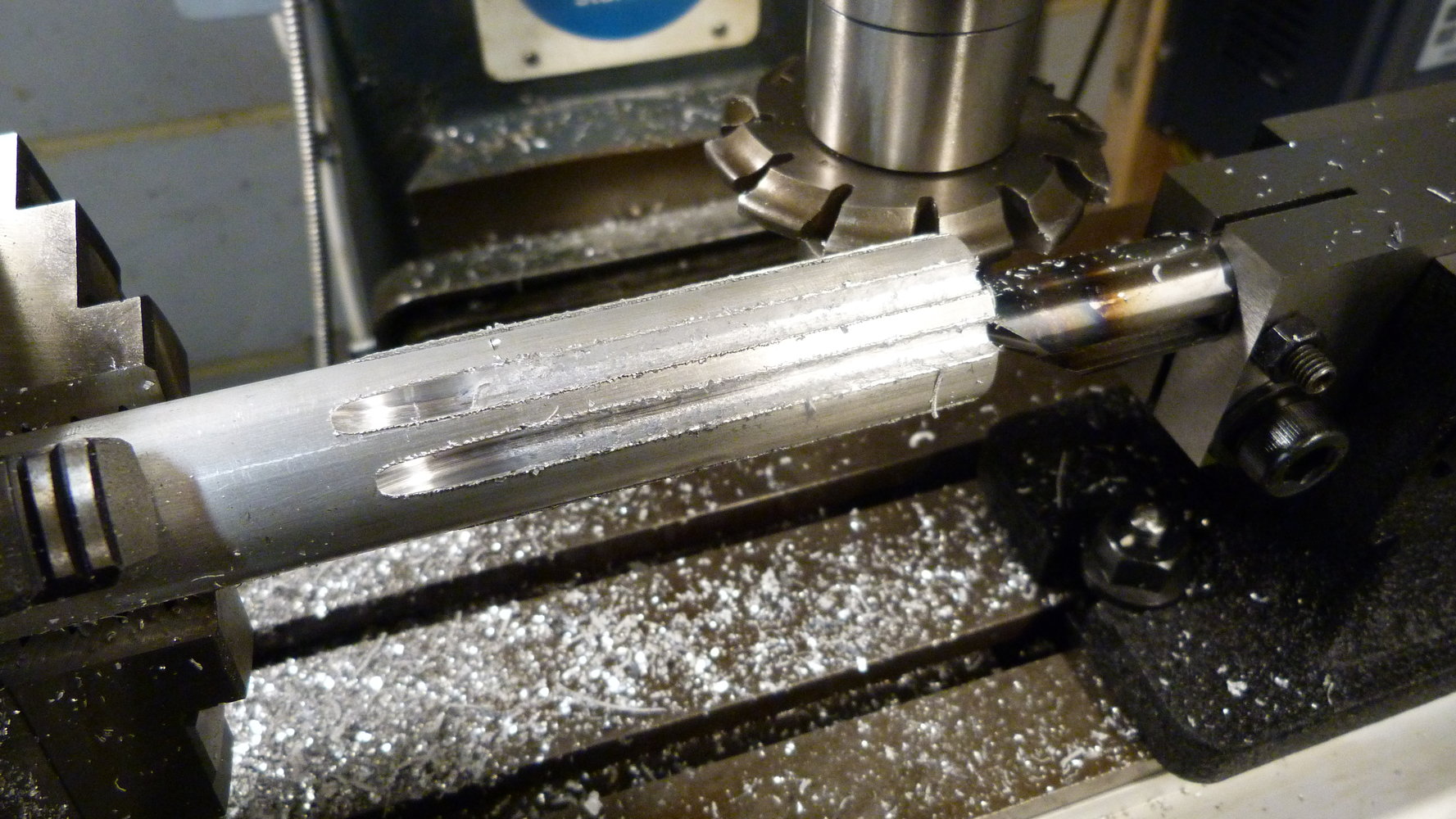

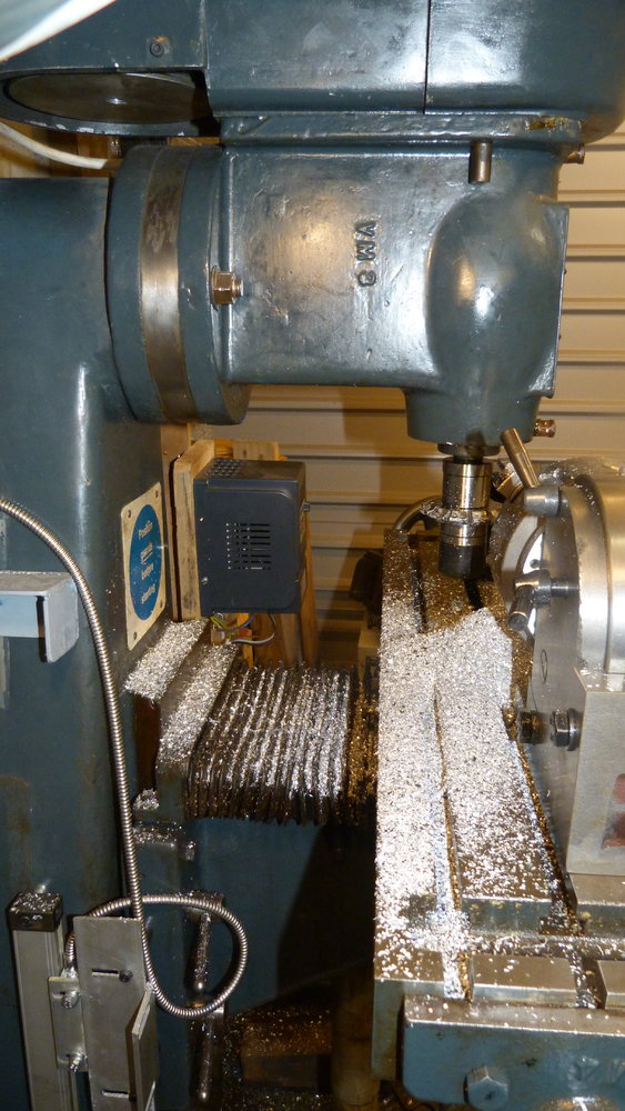

I had to take cuts in multiple passes. The required depth is .2696" (6.8mm) so I'm not doing it in one go on my mill. I set a depth of cut, indexed all the way round and then put some more cut on. That way I could be sure that the teeth were in the right place after 12 cuts so I wasn't wasting my time if I made an error. As it happened I made two errors.
In the excitement I forgot to lock the z axis. The table dropped 0.1mm before I noticed. I chose to ignore this issue as the error was very small.
My second problem was a bit worse. The nut on the stub arbour worked a bit loose and the cutter dropped. I noticed this quickly before it got dangerous but it messed up my cut a bit. You can see the extra wide cut showing at 12 o'clock below. Fortuntately the cut wasn't very deep and I hoped I was going to lose the extra material that had been taken during subsequent deeper cuts anyway.
Bit further in. I used WD40 spray as lube and coolant The bar got very hot although the cutter stayed cool.

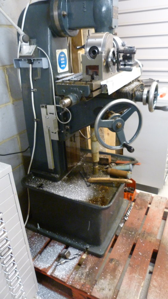

Next time I'll know to leave a bit more room at the end for the cutter. I could have used the extra available stick out on the tailstock to give more clearance. It was a bit tight but I had a few mm to spare.
This is it "finished" on the mill at least.
I felt a little bit of a fraud as I didn't use the dividing plates. The 12 tooth gear is a good one to start on. I only used the spindexer part of the dividing head. It has 36 spaced holes so I just cut on positions 3,6,9,12,15 etc. It's a lot easier to keep track using the 3 times table compared to anonymous holes on the plate, even with the indexer arms. Possibly saved me from making more errors.

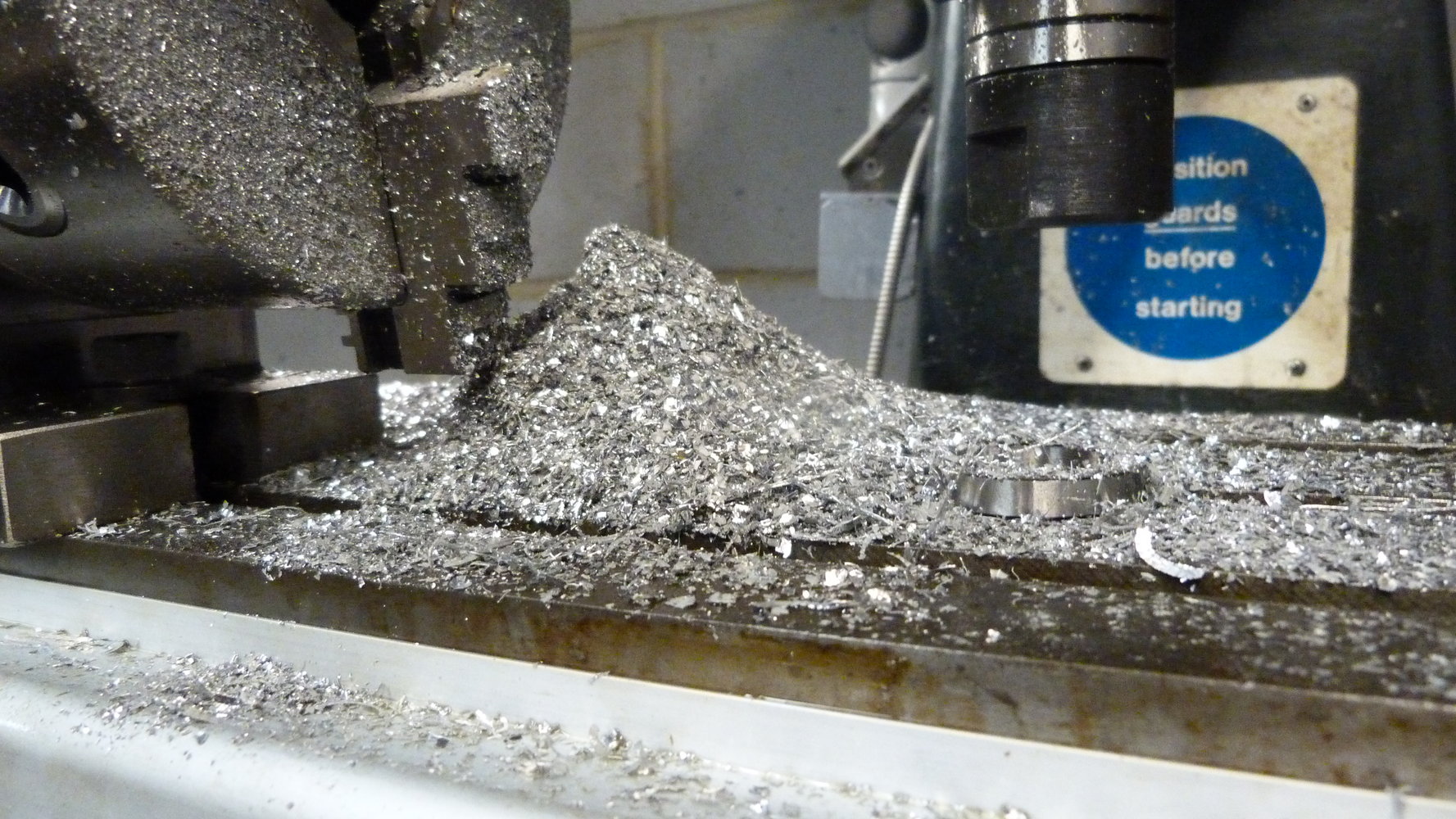

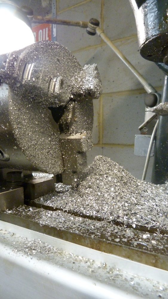

Needless to say there was a lot of cutting. It was like a winter scene on the mill afterwards. Tomorrow I shall be mostly cleaning up...

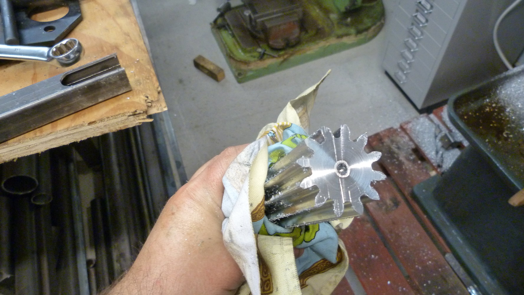

Straight off the mill. It is far too hot to hold directly hence the cloth. I need to remove the burrs and tidy it up properly.

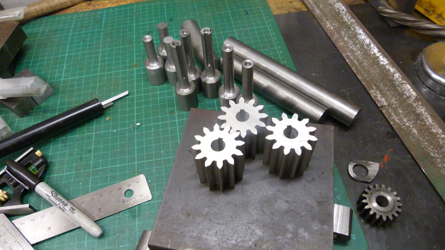

This pic below shows the gear with two, module 2, 17 tooth spur gears for scale. They were the gears from pictures earlier in the thread used with 34mm tubes.

From the 190mm blank I obtained 130mm of spur gear.
Chopped up into three pieces to give a pair and a spare. It will be interesting to see how long they last. I expect I will have to remake them out of steel again quite quickly. I hope to get the rollers to roll very thin sheet with them. Just to prove the machine works before the teeth start snapping off.

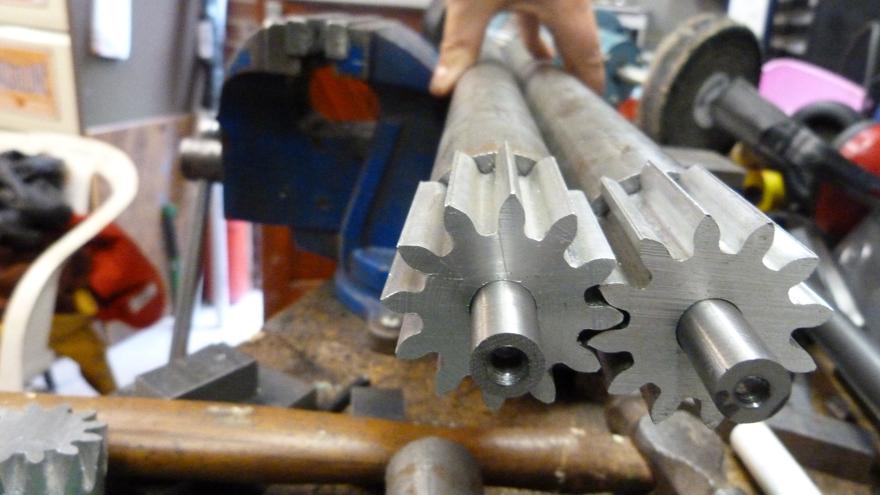

I've made them proportionally wider to make them slightly more robust. They are roughly 42mm wide. The steel gears in the foreground are 38mm in diameter compared the the ally gears of 44.5mm 1.75"
Centre drilled on the lathe. The teeth felt remarkably strong in the chuck jaws considering the material they are made from.

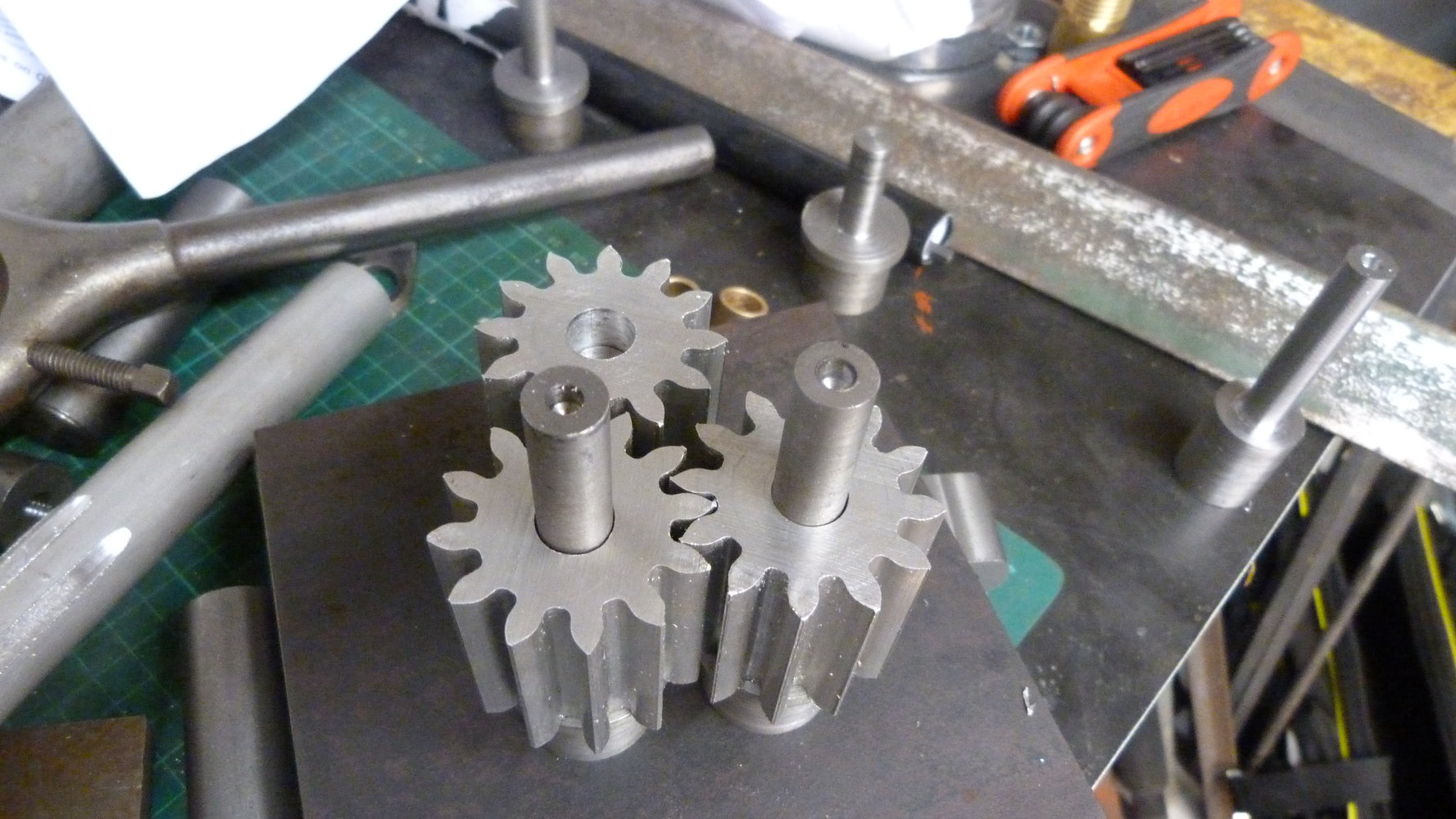

I'll get round to keying the shafts and gears. I still have five shafts to make again. Those are just the old ones from the 34mm tubes. They aren't quite as slack a fit as they appear in the picture below

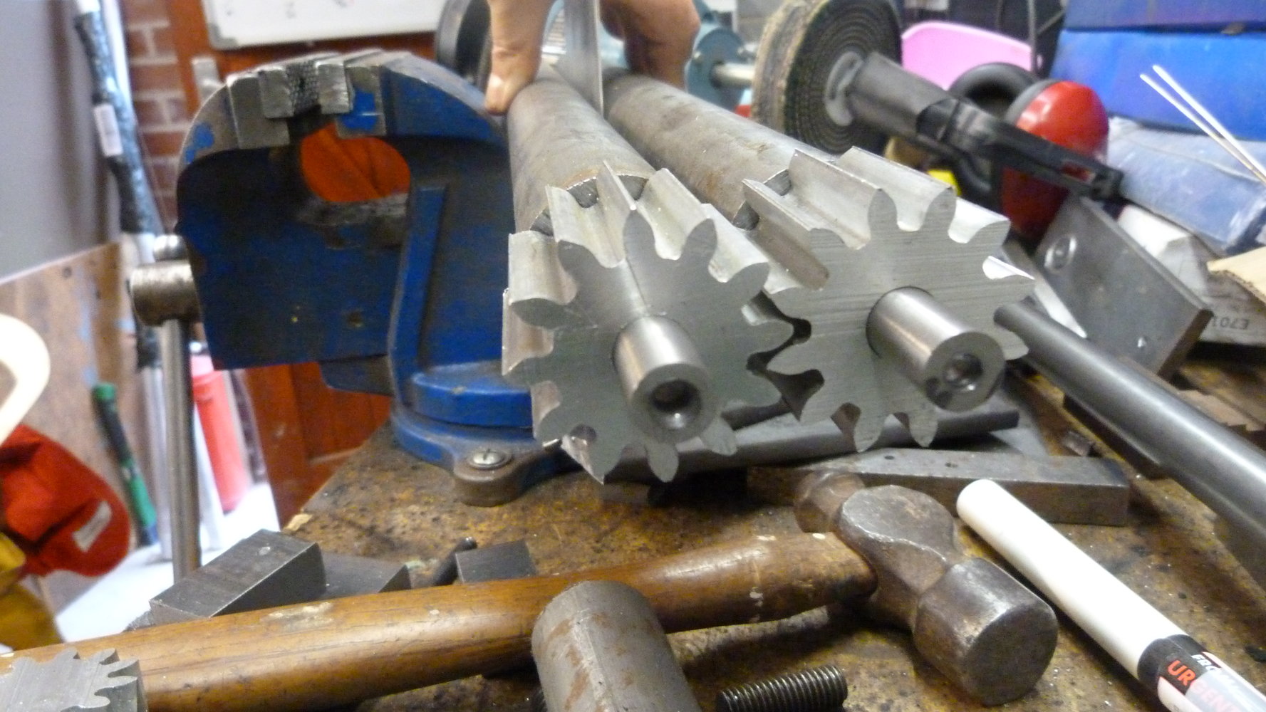

This is the tooth engagement with the rollers tight up against each other.
This is the tooth engagement with approximately 1.4mm of material between the rollers. There is plenty of engagement still so thank you very much @Hopefuldave .

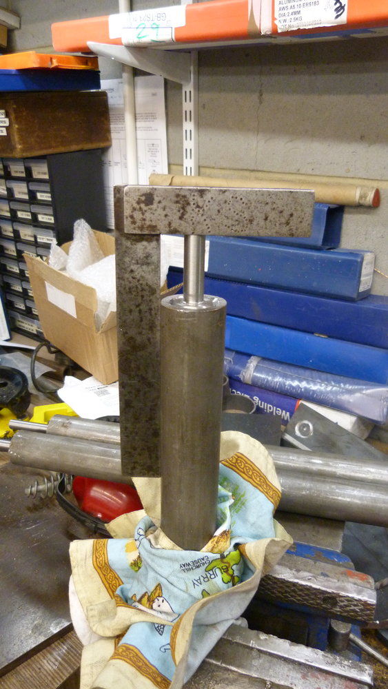

A bit more to show. I just do bits during odd evenings when I'm not too tired after work or busy with other stuff. I don't work when I'm tired as it leads to increasing sloppyness and can be a bit dangerous too. I'm in no danger of rushing this.
Bungs got welded into the tubes this week. Setting up the alignment as best as I could in the picture. Some bungs show more run out than others when tested with a DTI but the tubes are only so round anyway. The welds are glorified tacks and I hope that some self alignment occurs when the tubes are screwed tight up against each other under pressure and rolling in the frame. Keyways were milled into the shafts prior to welding. I should have checked the dimensions of shaft keyway. I assumed it was supposed to be 2mm deep for a 4mm key but that's not the case. Older and wiser now.

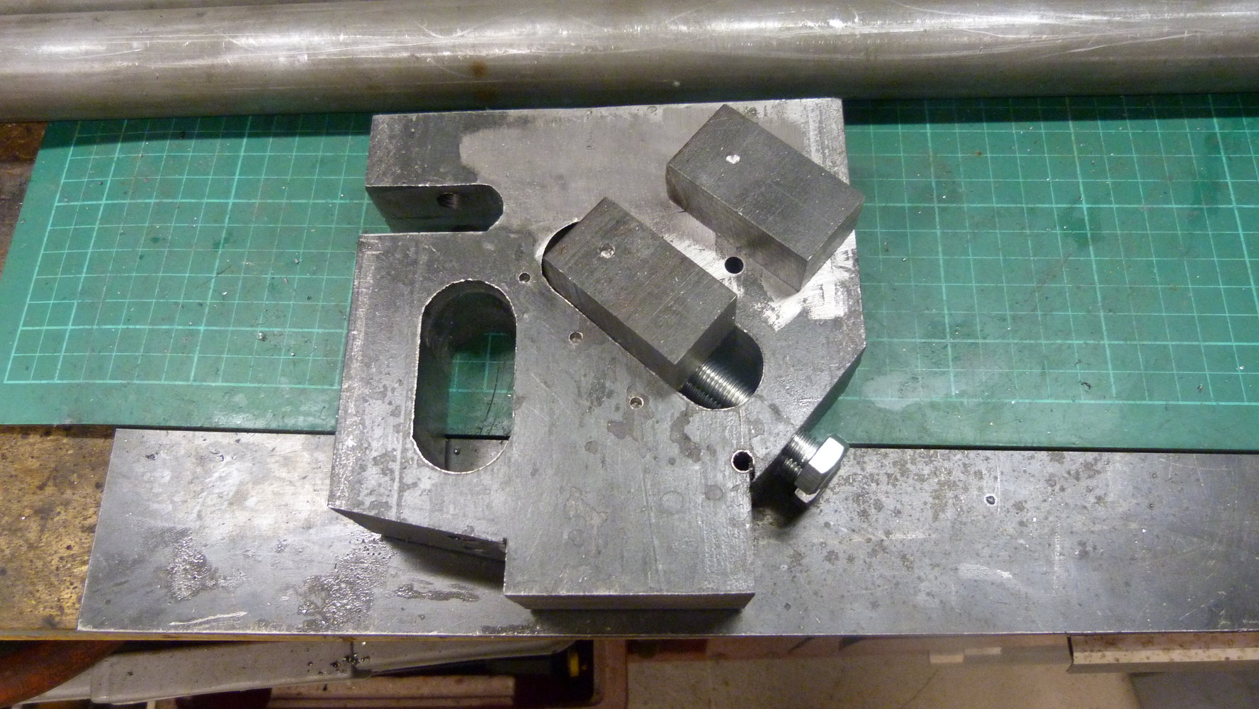

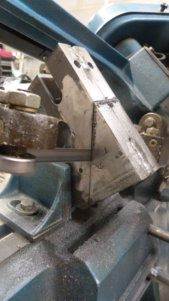

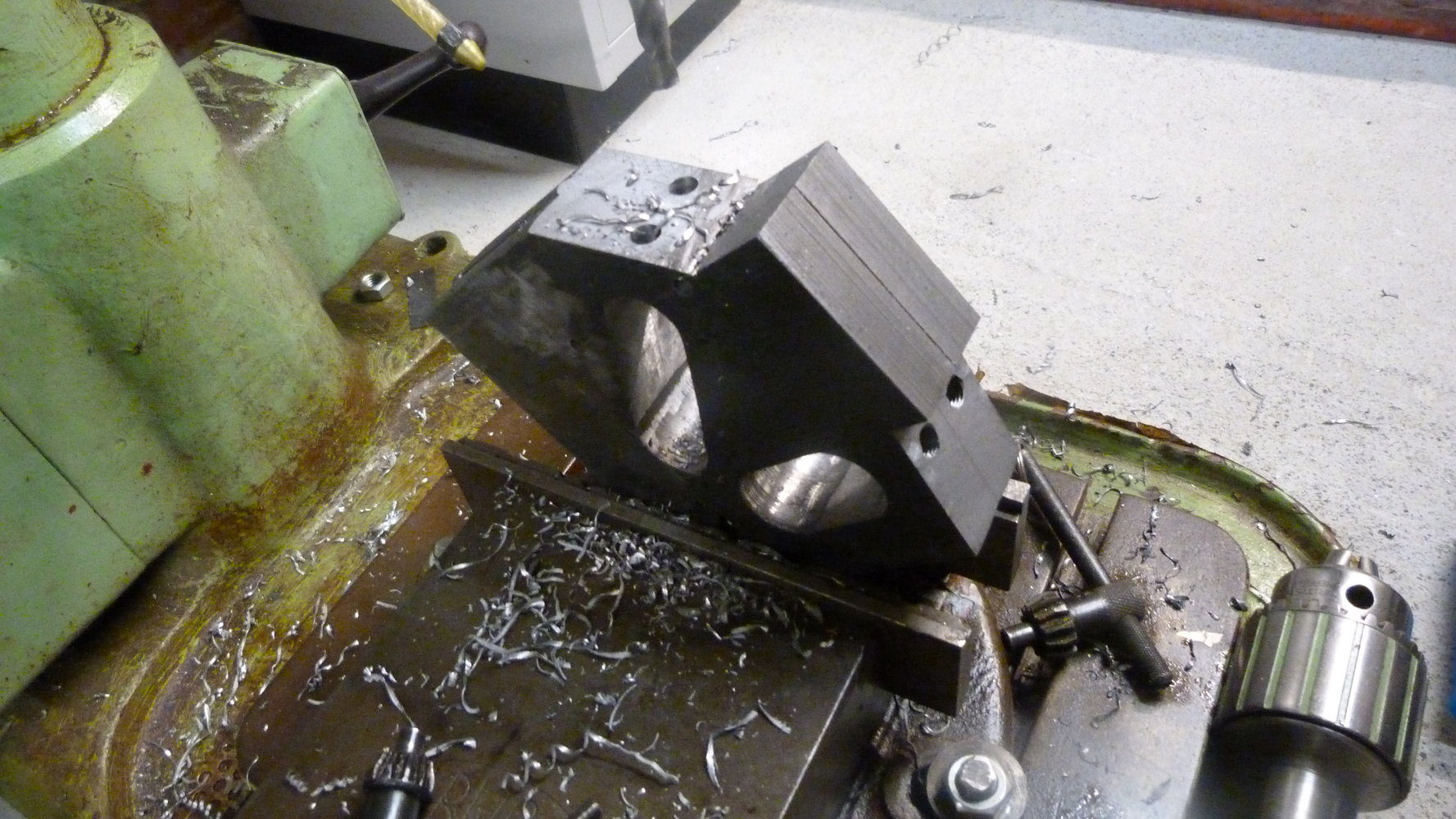

The welded tab was removed after this so the work fitted in the bandsaw easier for the relief cuts at the bottom. The top drilled holes are a bit to close to where the bushings sit. I have got away with it just, but ideally they should be a few mm further to left in the picture. This is what I get for a total absence of planning and " That looks about right" estimation and design.
The angled cut leaves a flat surface to drill into for the final two holes. This prevents drills wandering as they are going in to the surface at 90 degrees. The relief cuts don't have to be perfect.

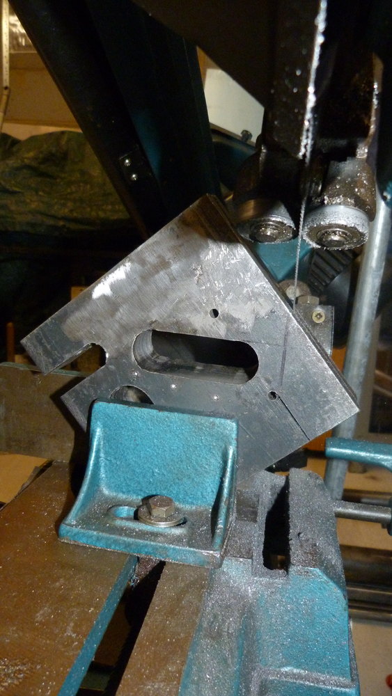

This is the plate/s post bandsaw and a bit of hacksawing too. I was a mm or so out on the cut on the right hand side. I drew two lines on the left side and hit the lower one fine. I didn't miss the remaining line that shows. Even I'm not that shoddy. The rollers show in the background. Welded up with the gears on them all ready to do some work.
Final bit of drilling into a nice flat surface.
Plates finally all tapped. They need splitting next. Rough and sharp edges need tidying up and feet welding to bottom to accept some bolts.
Bushing carriers need fitting and shaping next. Shame about those extraneous holes. I think I will get round to welding them up.

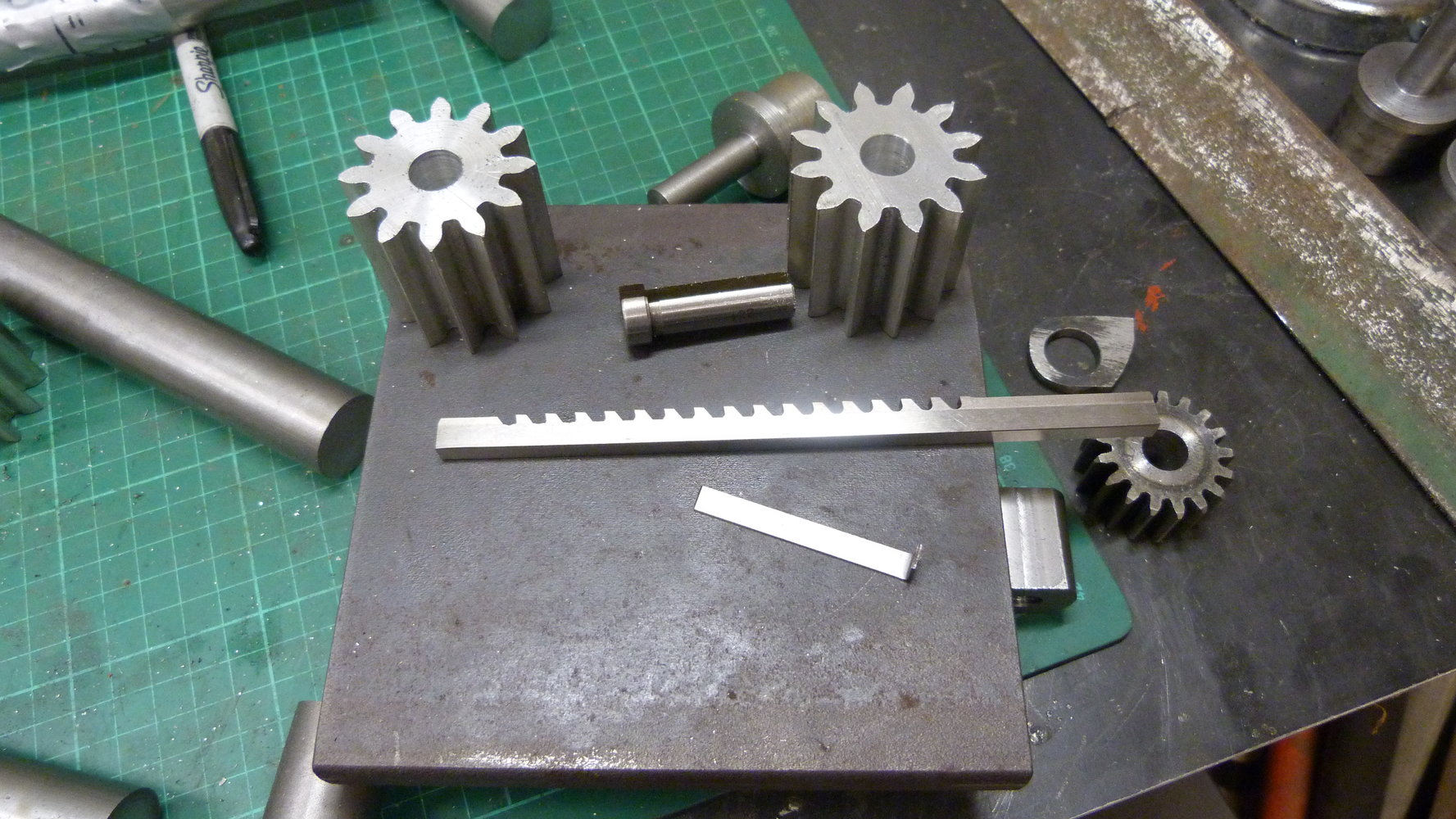

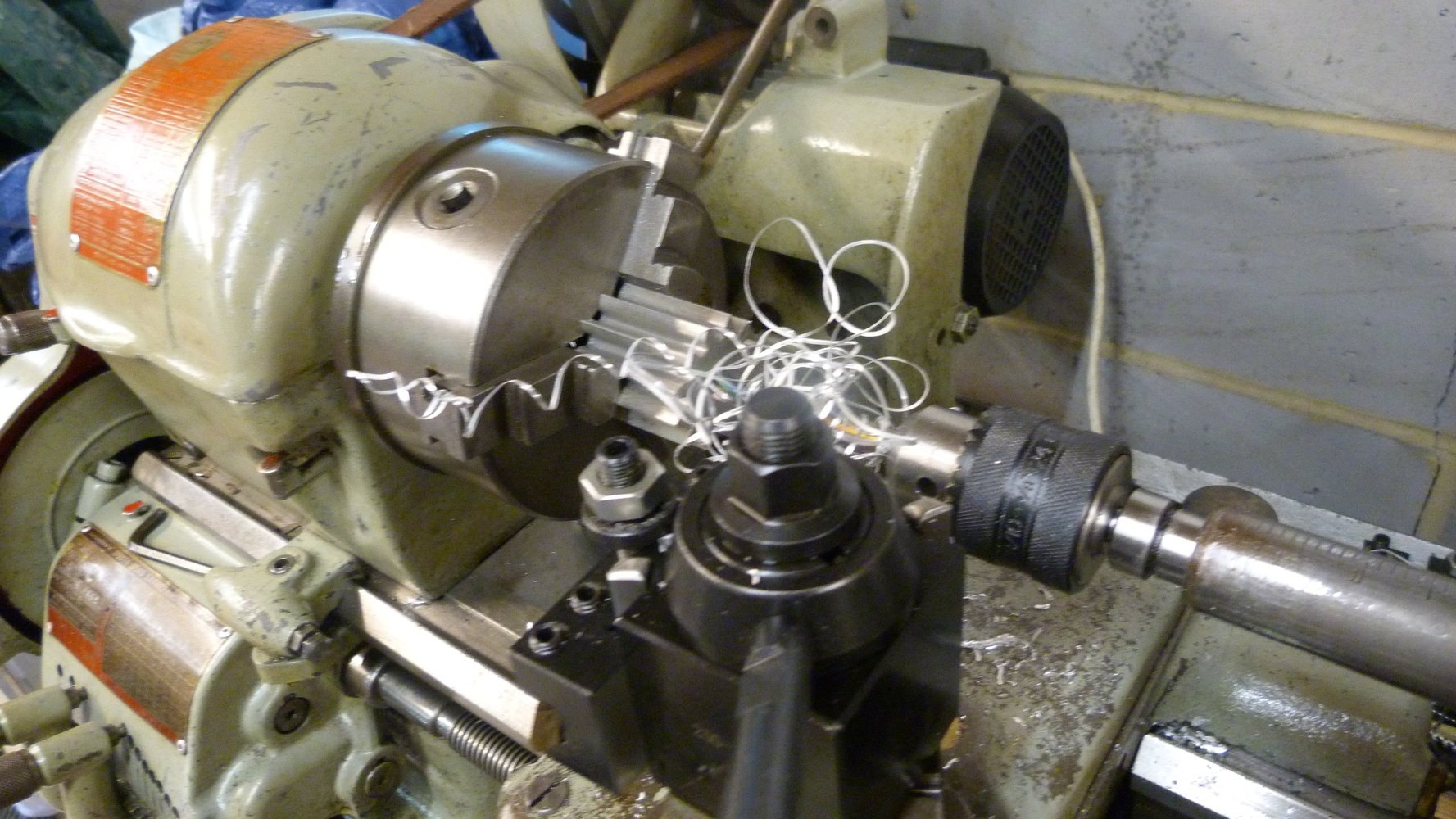

Just a thought when you make the gears in steel. On the lathe cut down to the root diameter with a parting blade to mark the width of each gear. That will reduce the amount of material to be removed with the gear cutter.
More useful if you are making gears with a shoulder for grub screws but every little helps.
This idea occurred to me after I'd made a few dozen gears

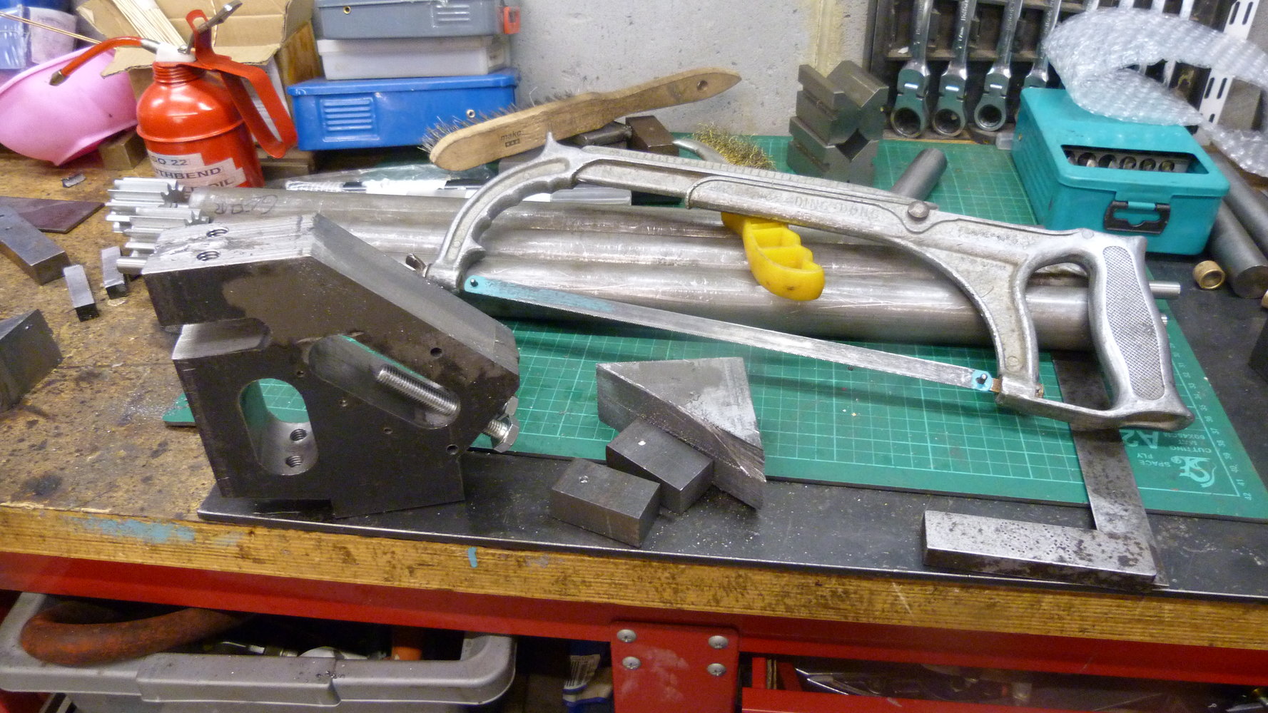

Plenty more faffing about in the last couple of weeks.

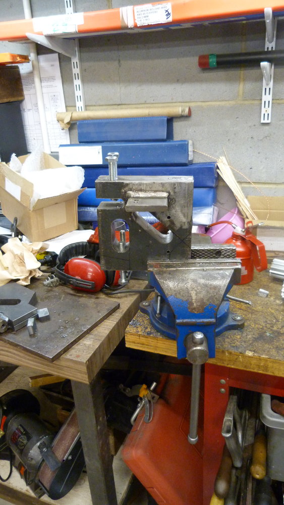

Weight reduction in the bandsaw.
Finished the cut with the hacksaw as there wasn't enough clearance in the bandsaw.

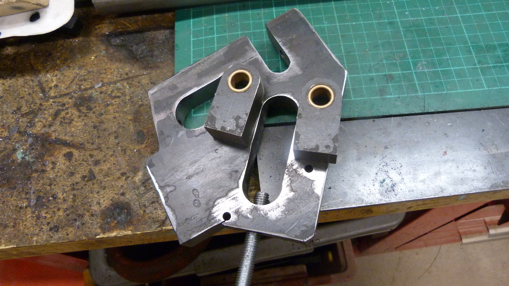

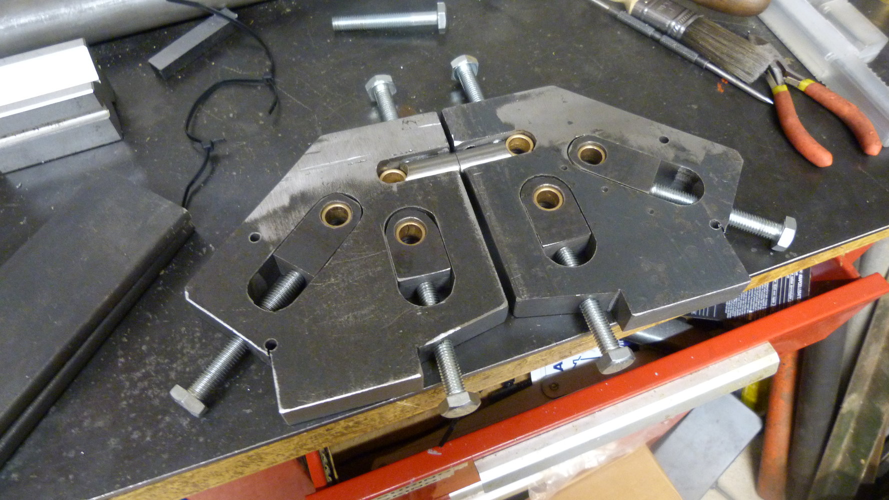

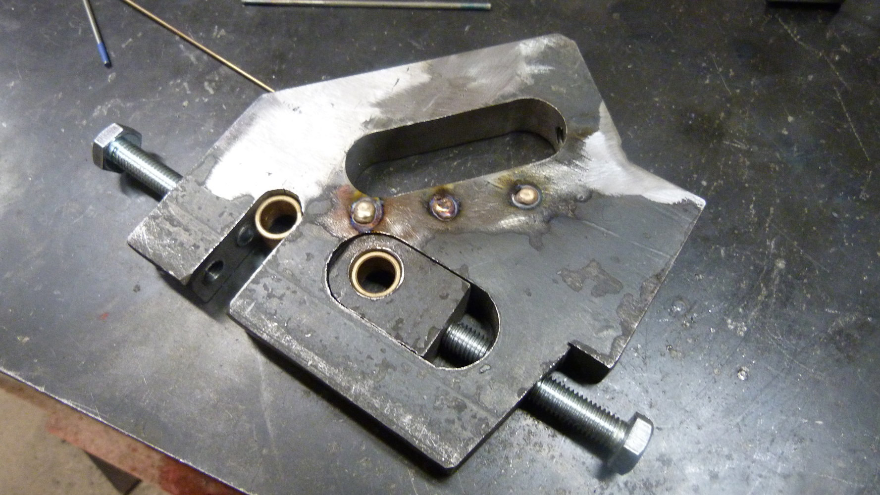

First bearing carriers. The round ends were done by eye with a flap disc and hand file. I got a little better as I went along . They aren't a close fit in the ends as the drilled ends have a slightly wider diameter than the slots as I was a bit conservative when milling the slots. Not a big deal really as the parallel sides locate the bearing and the carriers don't go to the end as there will be material between the rollers giving a gap. The holes could be a little more central on some of them. They might get remade.
"Shock and surprise!"
"Space invader"
I was quite pleased with the bit below.
I needed the two retaining pieces to fill the slots keeping the top oilite bearings in place. I thought about cutting more 20mm thick plate in the bandsaw and drilling 16mm diameter holes for a radius end but I didn't really want to go there. Anything to do with 20mm plate is a lot of effort.
Instead I used a facemill to mill two flats on 19mm round bar to bring the height down to 16mm-ish and then cut a notch with an end mill. So much quicker.
Improvised way cover. Makes Hoovering up easier.
Pretty pattern left by the milling cutter. The pattern isn't sharp in the slightest. Might help grip the bush. Possibly an indicator of shoddy milling?
I've also drilled and tapped two further holes in the top, you can see the one on the right peeking out. As it turned out the original holes were ok. The top screws don't crush the top bushes with the retainers in place. The bolts should get replaced with something more appropriate later. I'll drill locating holes in the retainers and put the screws in the lathe to remove the bottom threads so they don't get squashed and jam in the frames.

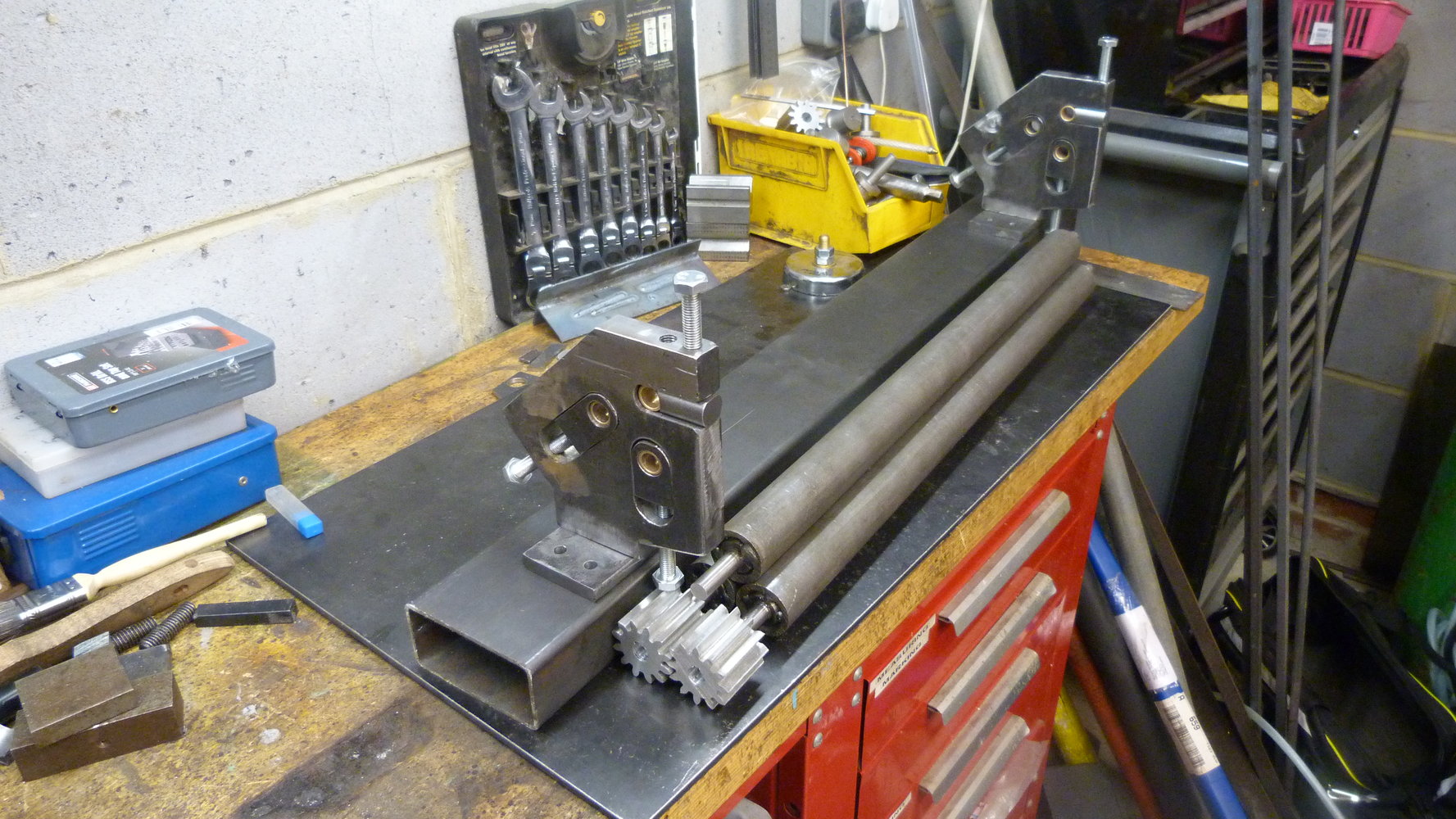

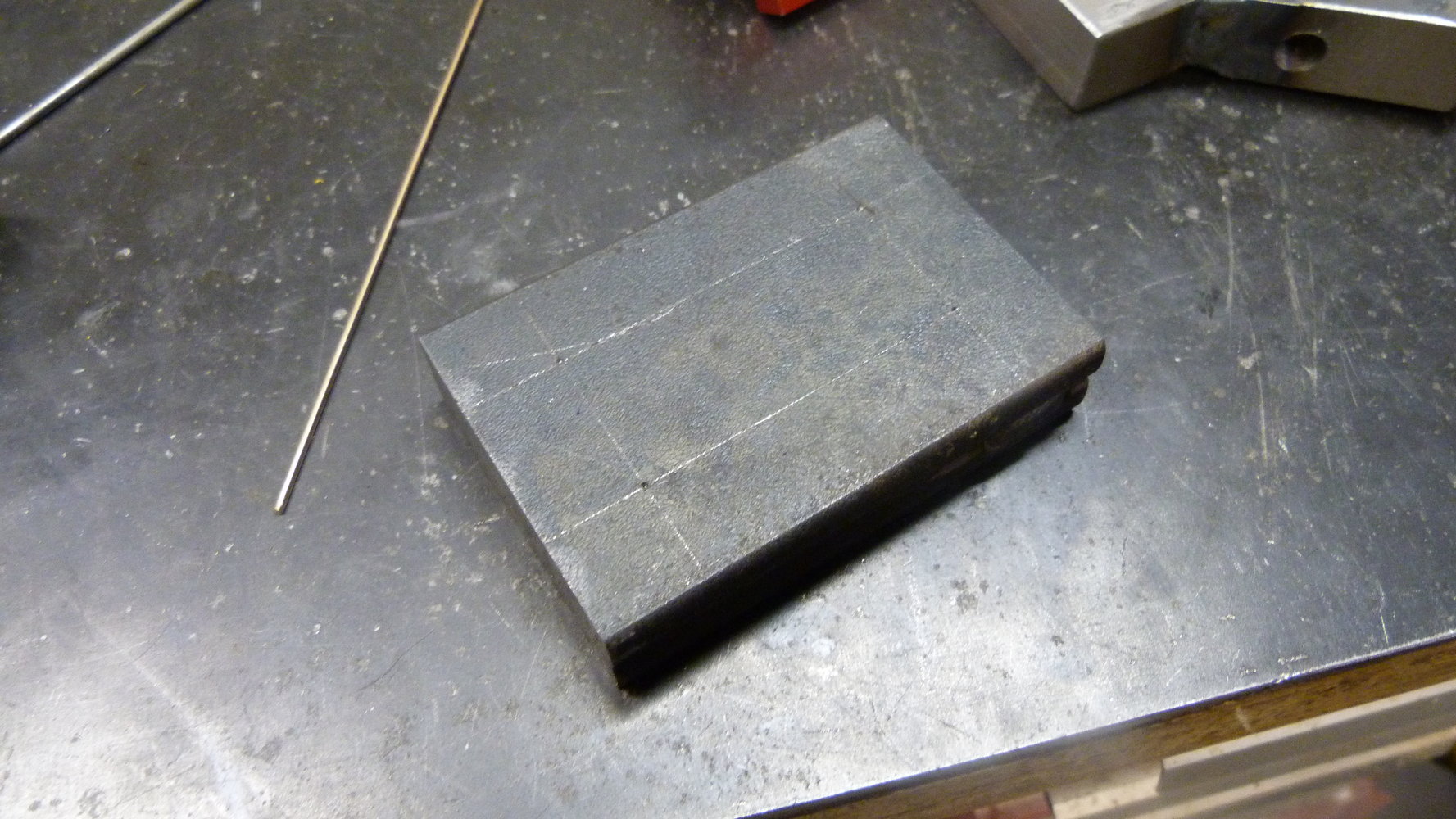

Two more plates welded on top of each other and marked out for feet.
Everything was sufficiently parallel and symmetrical that I could just flip the workpiece in the vice without losing my X axis.
I've had a couple of offcuts of 100mm by 50mm box knocking around the garage for a while so it will be good to make some use from it. A slight clearance issue discovered with the bottom front screws but my bolt holes in the plates are far enough back that it should be fine, if a little forward heavy. I still need to make a handle and ensure it clears. Also a bit of marking out, drilling and welding to do. The rollers need welding up properly but I need to see how concentric everything is and check for run out issues first before I do that.
