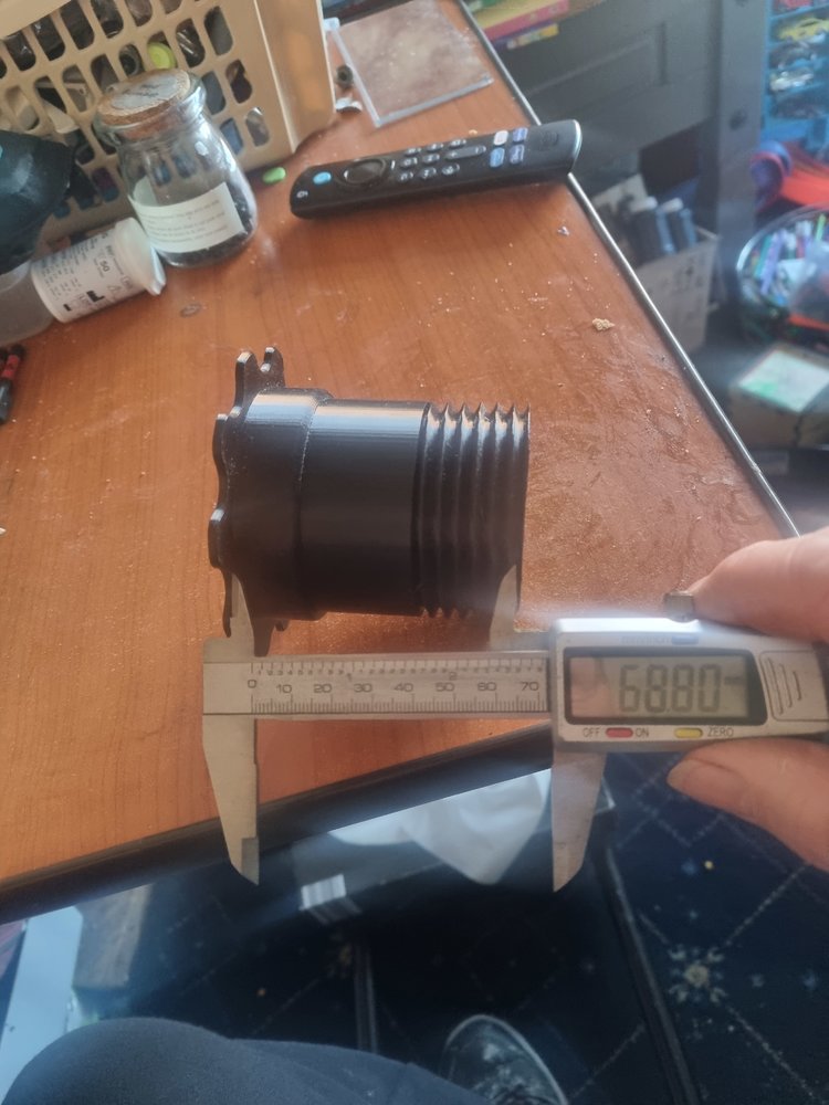

Is it possible to reduce the length of an object in one direction using bambu studio.
@Onoff lads showed me how to do it uniform or non uniform but I need the width increasing at a bigger % than ghe length.
I reduced the length by 5mm on the object but it played havoc with the threads (they go tight)
I need to take 5mm of the one end not both.

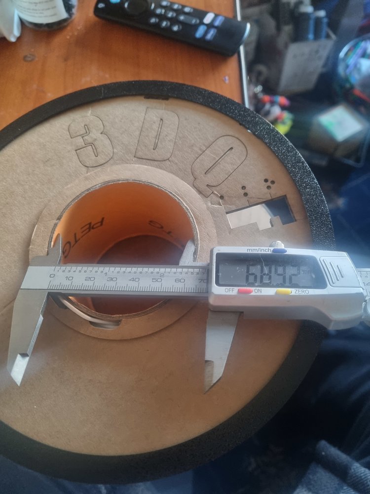

The keyway / slot is just to tighten it after you fill it with dead batteries or sand etc.Is the keyway in the cap significant? I'm assuming that is where the spool gets mounted. The thread in the caps is M60x5.5 with the threads reduced by.15 for clearance, so it needs a cap generating with that slot, or more sensibly a fixed cap at the ends. I may have run out of time for today.
