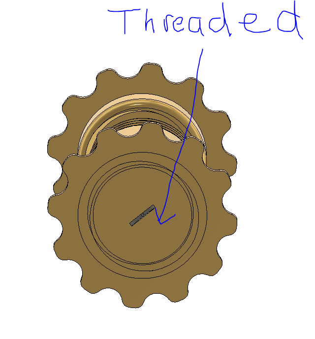

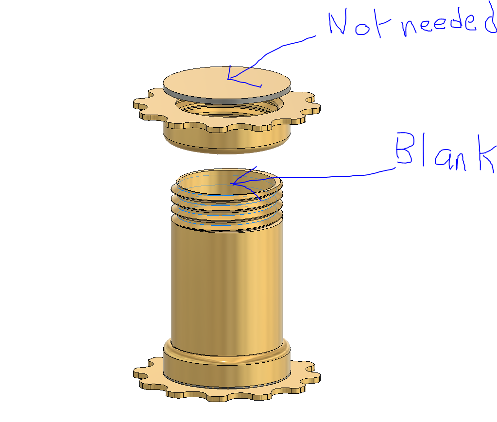

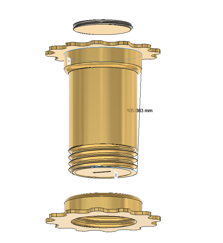

Not sure now. Lolas long as the overall length of the spindle is 68mm i am not sure it matters. If I was a print farm It might be easier to use 2 parts. As once the ballast/wright is added and held in place by the threaded blank with the slot in it, the big thread is very quick to use.

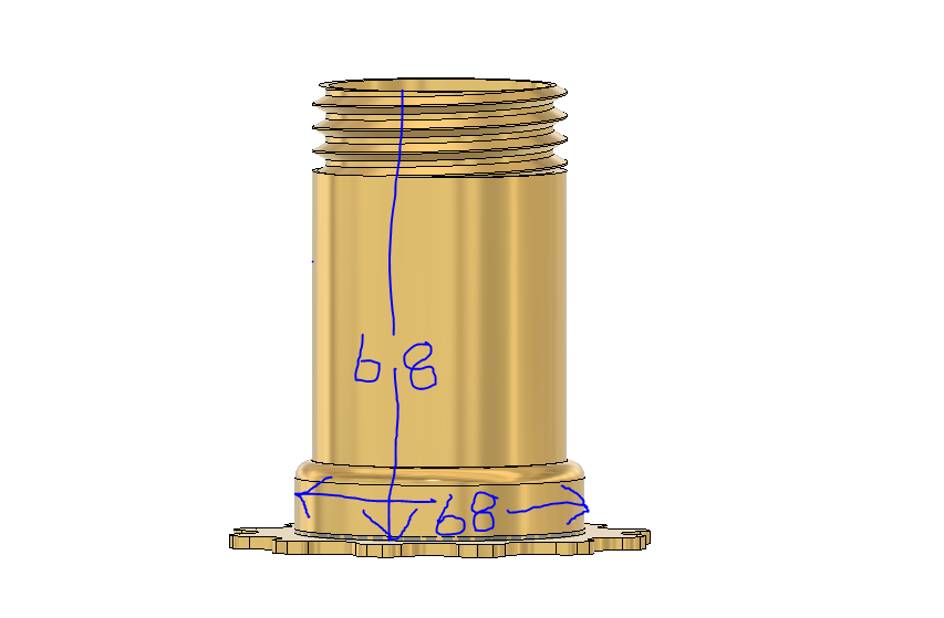

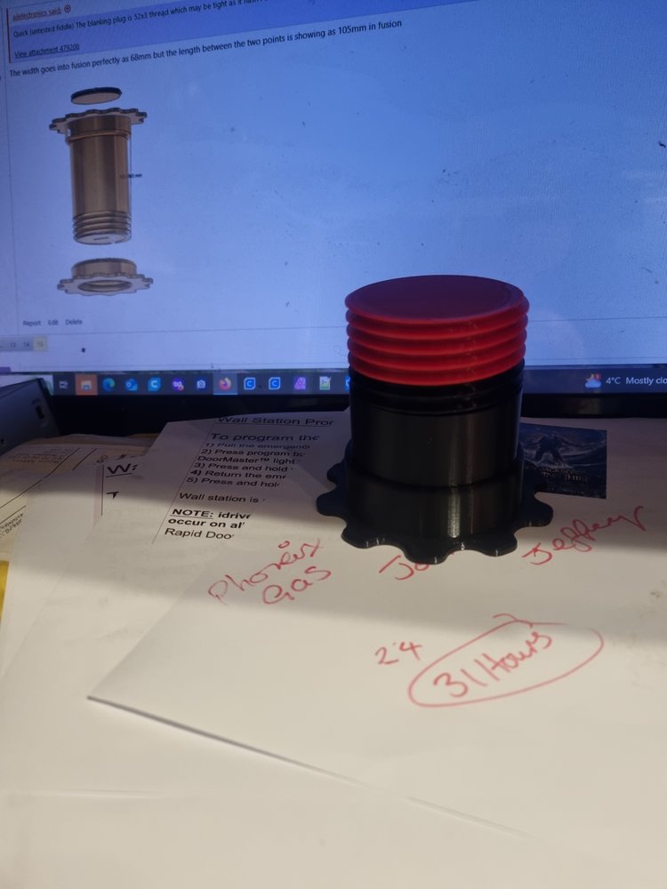

I think I could have coped with altering the outer thread and the width and length given enough time but the real.sticking point was the blanking piece thread. That said after I sat and thought about it all once I had expanded the models (all at the same time) the blanking piece should fit and the large thread should fit. As long as I could chop out the correct chunk from the middle of the spindle.
That was what was annoying me as once I resized in Bambu studio I could not edit in Fusion the same way Jake showed me on video.![]()
I think I will get a working window in about 30 mins. Fingers crossed.Well just load my work into Fusion and save out as .stl and you are sorted!
I will however try to adjust your fusion file

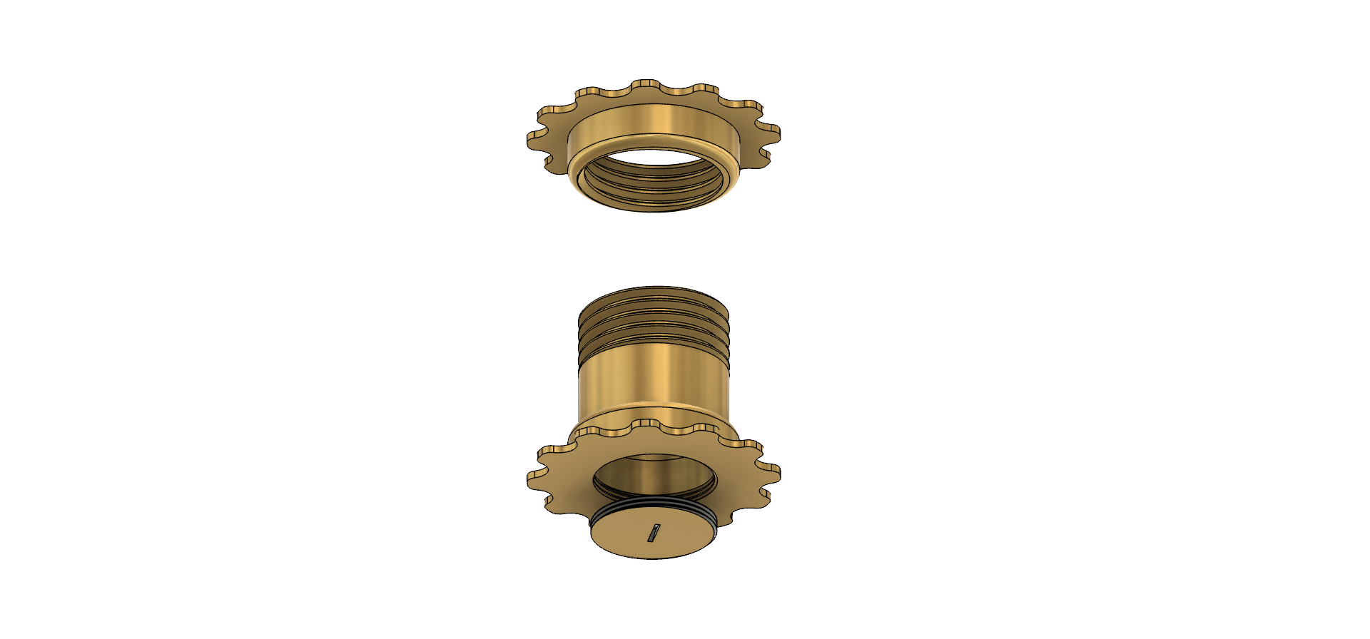

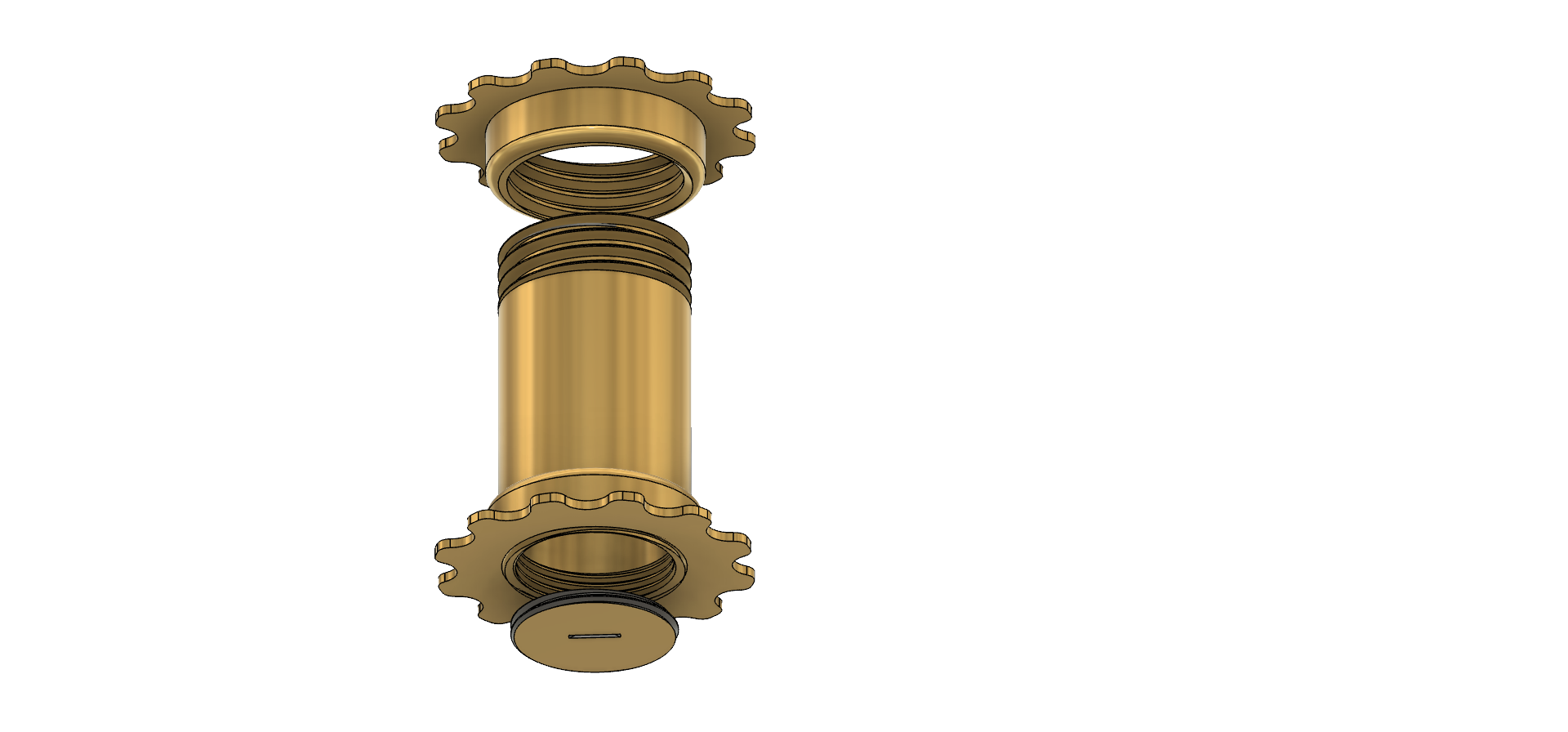

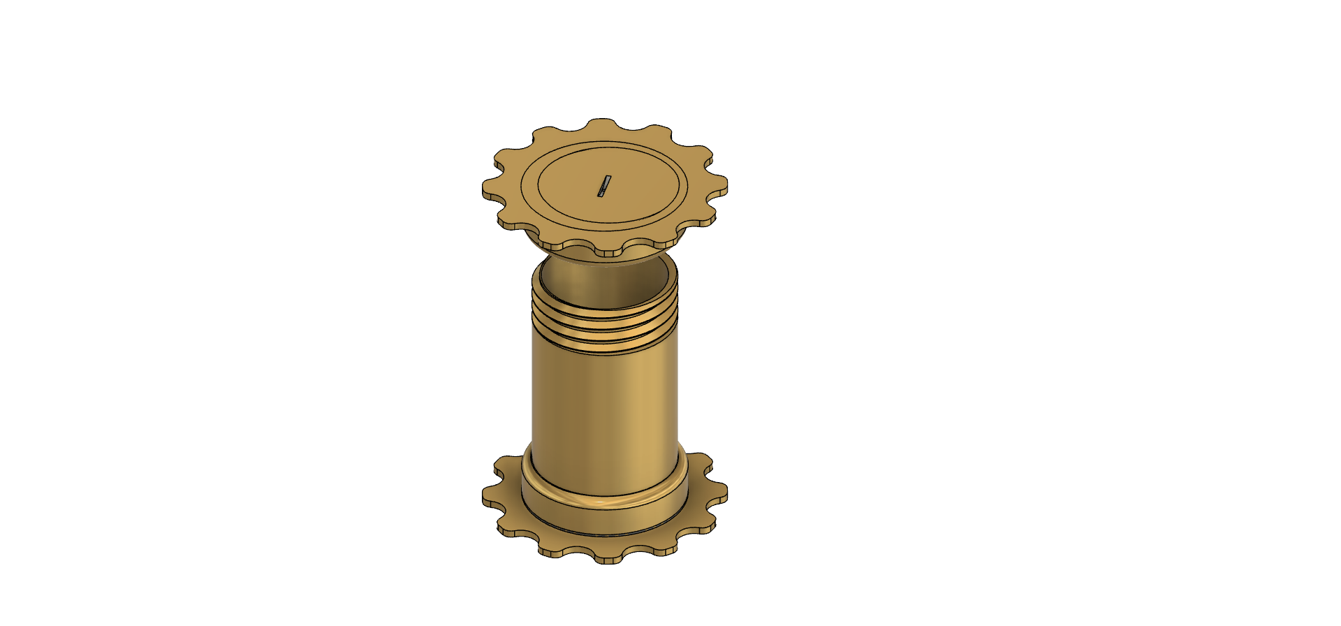

The weight is put in from the fixed end. (Which could be a spinner, as in your design)I must be missing something then? You need a spindle which you can fill with weight, so as long as you have access to the interior and pulls up on the spool, surely that does the job?
With the spinner tightened down on the spindle, you have exactly what you need, or so I thought. You can select that top blank in the Fusion file and move it down to become part of the spindle if that is how you prefer it.

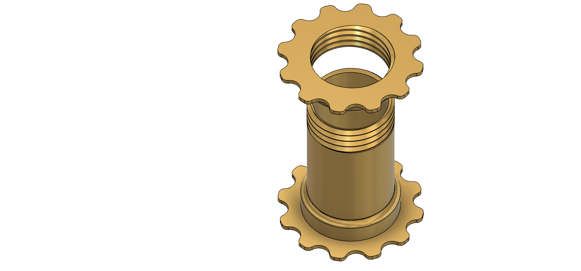

The width goes into fusion perfectly as 68mm but the length between the two points is showing as 105mm in fusionQuick (untested fiddle) The blanking plug is 52x3 thread which may be tight as it hasn't been offset.
Just getting wife's tea. Will get onto it ASAP.The thread offsets haven't been done, but how is this so far? The spinner will close through the 68mm you want, down to 64mm ish.
How to offset threads for clearance..
Be very wary of the 'Measure' tool in Fusion - it gives you the 'as the crow flies' distance between two points, which may not be the ones that you think you've selected. It's safer to select a whole face for one of the references which then gives you the perpendicular distance from the face to a point.but the length between the two points is showing as 105mm in fusion
Usually, you would get the option to show the distance in X, Y, Z coordinates, but it doesn't seem to do this for step files.
Yep....the screen shot was to show where I need to measure from. That's one reason for fixed spinner at one end.It was a diagonal measurement he was showing, although it was far too long anyway.
@ukracer To get an accurate measurement, hide the spinner so the rule is parallel to the spindle.
As Misterg says getting the correct place to measure is tricky. Well to me it is anyway.It was a diagonal measurement he was showing, although it was far too long anyway.
