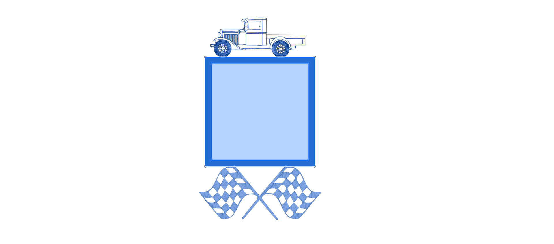

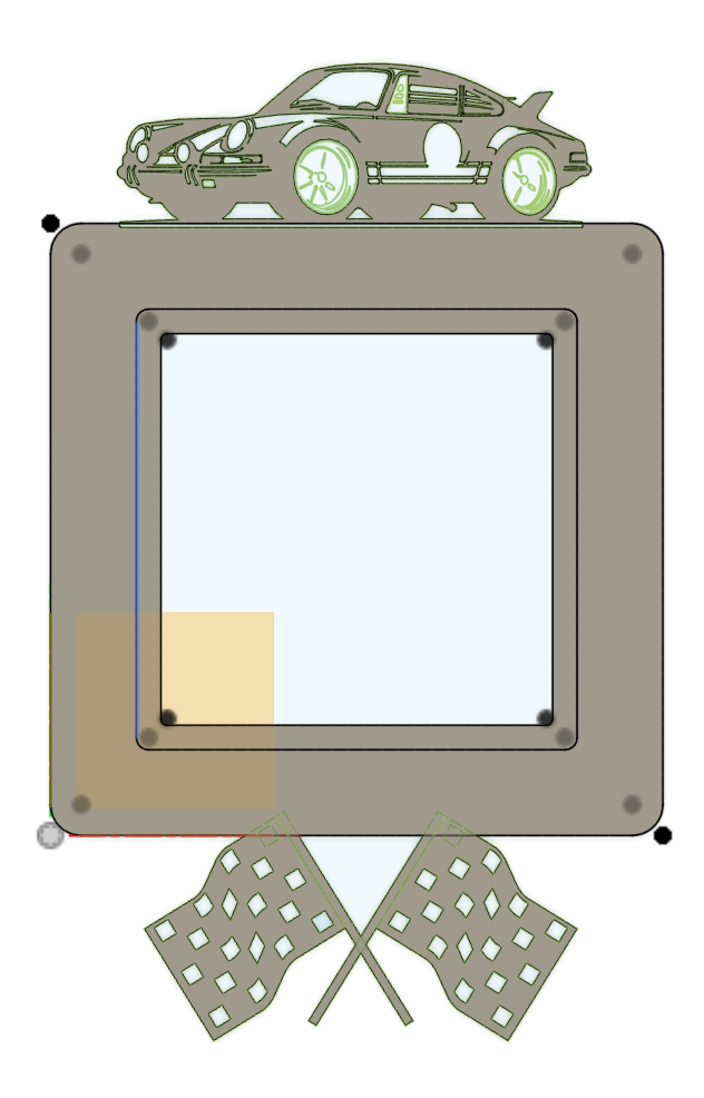

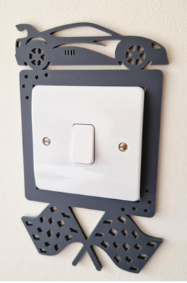

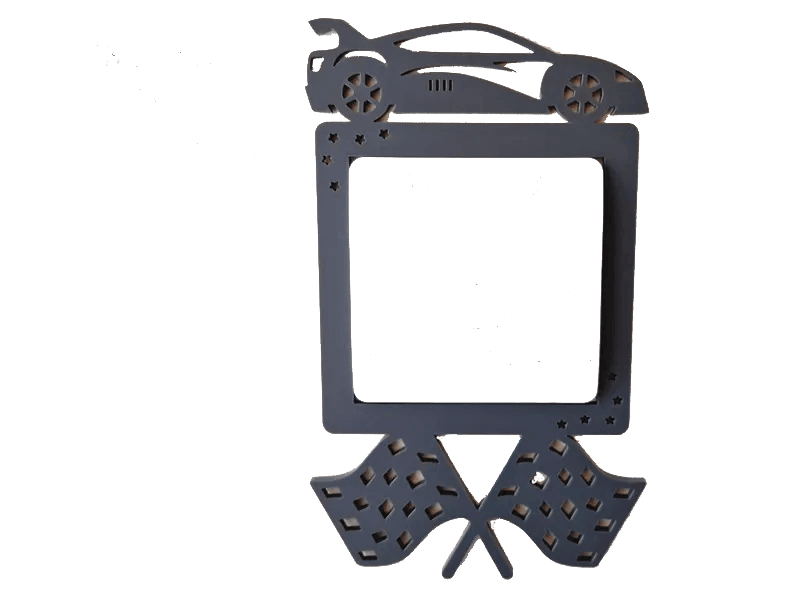

Very easy to design your own in Fusion. Once you have a suitable image, convert it to an svg file, then Insert.. Insert SVG and add it to your sketch of the actual surround (internal square for UK light switch is 86mm). I would think 1.5 to 2.5mm thick is fine, with the bit that goes behind the switch say 0.6mm. You might want to adjust either the infill and/or the number of initial layers.I dont suppose anyone has come across this on their travels or something car related switch surround?View attachment 481774
Sadly not easy for me.. I guess there must be a tutorial that shows how to do it in Fusion, but I have not found it yet.Very easy to design your own in Fusion. Once you have a suitable image, convert it to an svg file, then Insert.. Insert SVG and add it to your sketch of the actual surround (internal square for UK light switch is 86mm). I would think 1.5 to 2.5mm thick is fine, with the bit that goes behind the switch say 0.6mm. You might want to adjust either the infill and/or the number of initial layers.
Sadly not easy for me.. I guess there must be a tutorial that shows how to do it in Fusion, but I have not found it yet.![]()
Yes I could but the original has gone now so the only image I have is not 90 degrees to the screen.Can you find or draw it on paper? Scan it, save it and pass it to one of the free online, image to .stl converter sites.
It's not important I just know some people on here can use search engines better than me. And it's not exactly something I can get from b and q or screwfix.![]()

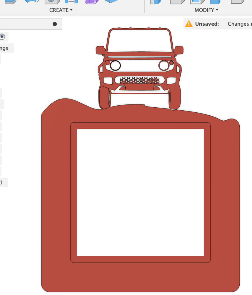

I had another gohow to do it in Fusion

what extension should they be??I had another go View attachment 481926
Sorry, I thought I'd added that bit but it disappeared when I posted itwhat extension should they be??

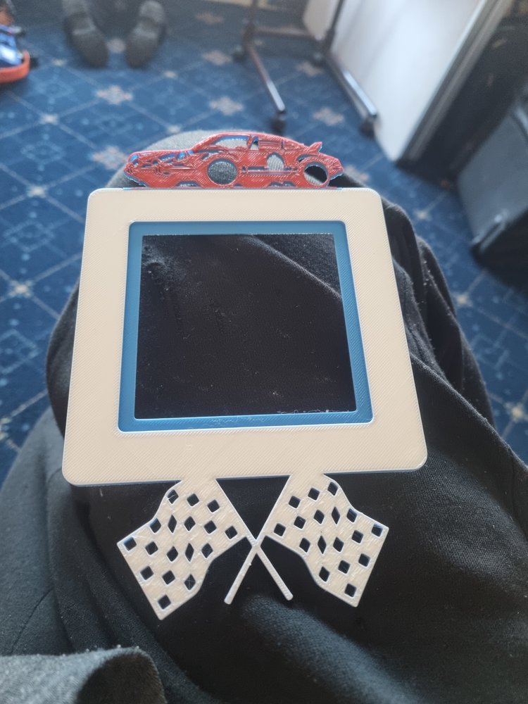

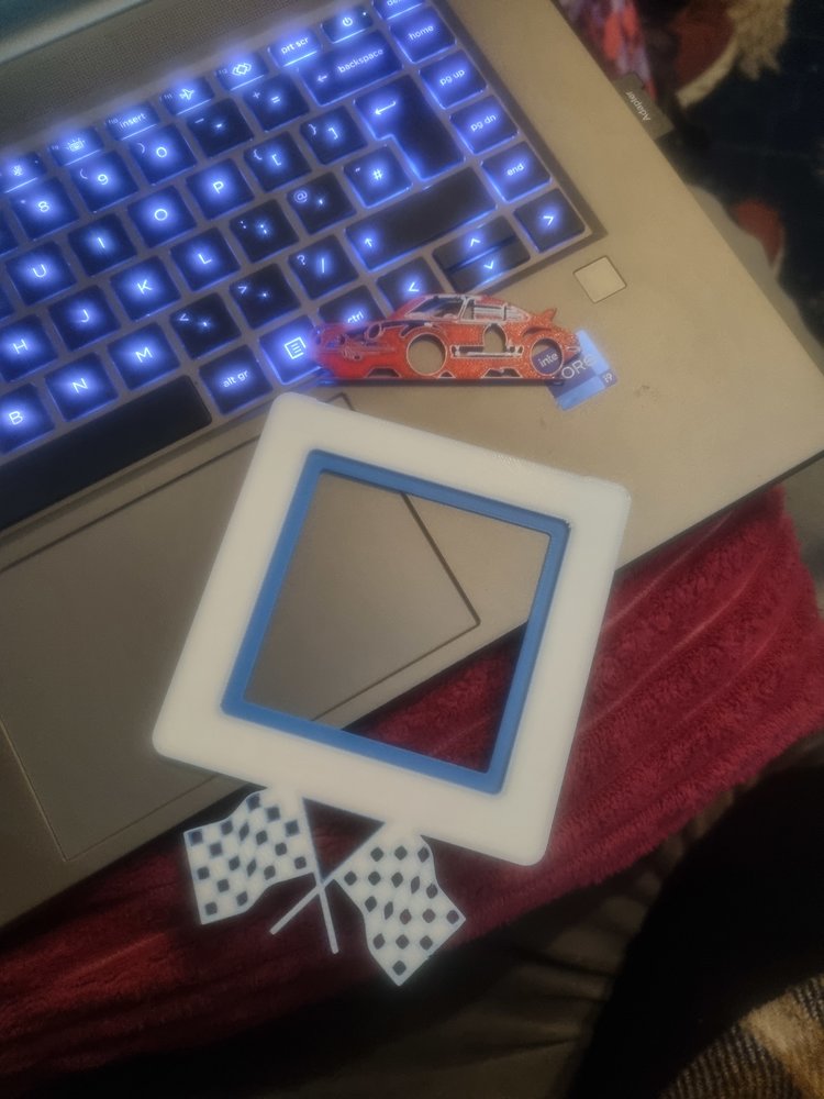

Printed out a test piece.Sorry, I thought I'd added that bit but it disappeared when I posted it
Change SwitchPlate01.txt to SwitchPlate01.f3d
Change SwitchPlate02.txt to SwitchPlate01.stl
It's slightly small. The hole that is. It's 72mm square the switch I have. strange it seems the perfect size according to inspect tool in bambu..Oh pants. I missed a skinny bit in the extrude step. Sorry, try this stl instead..
Change the .txt to stl as before
What's wrong with the size - does it not fit your switch ?
Ok, I made the main opening 86 mm, but assumed you wanted it to go behind the switch, so it has a thin (0.6mm) 4mm flange round the inside of that 86mm. I guess you could trim it off with a stanley
Well something is weird.Ok, I made the main opening 86 mm, but assumed you wanted it to go behind the switch, so it has a thin (0.6mm) 4mm flange round the inside of that 86mm. I guess you could trim it off with a stanley
I was printing it too small . LolLoosen the plate and slide it over diagonally?
