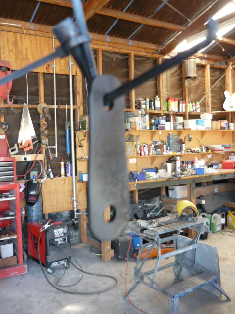

Oops, missed that picture haha.Kim, I think the tool he illustrated IS a slotted bar, the Mole grips are just for location.

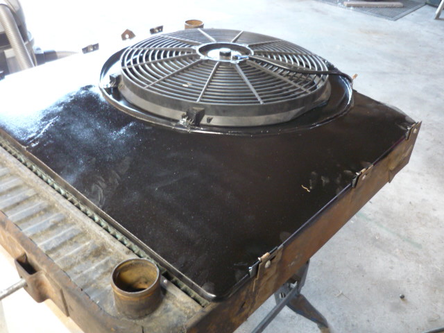

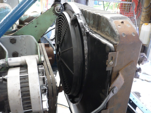

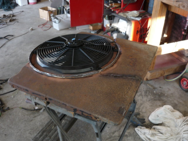

with your electric fan do you need to connect it up to a speed controller and somehow fit a temperature sensor?
i know they can be quite pricey compared to the cost of just the fan.

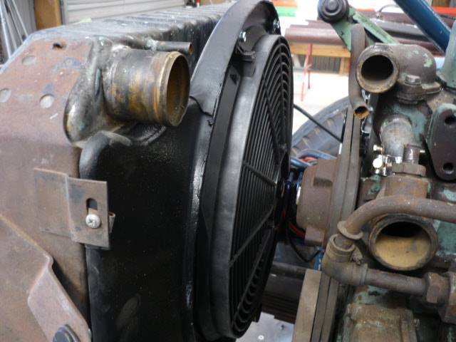

do you have a link to the sensor? im thinking of doing the electric fan conversion on my 260zI have a fan switch on order and I will need to mount it in the top radiator hose (more to follow I hope). It's a simple on/off style thermostat and I will drive the fan via a relay. Variable speed is nice from a noise point of view but I will keep it simple to start with.

for the temp sensor for the fan, it should go on the bottom hose not the top
water coming out of the engine should always be hot (90'C ish)

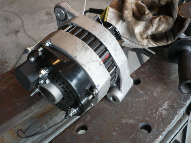

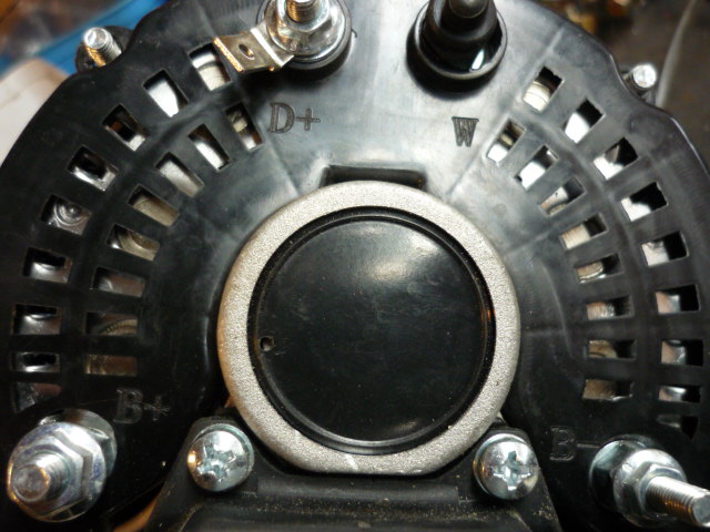

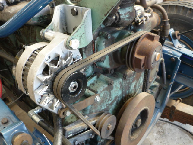

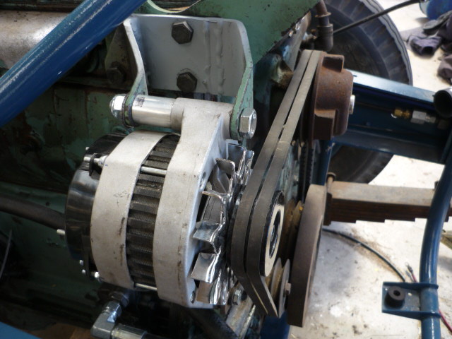

The "w" connection is to run a rev counter off the alternator. If you google running a rev counter from the alternator it explains how to do it. It's a direct connection to the coils so you get an ac pulse.
Nice rebuild by the way.
