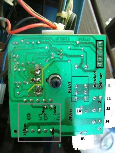

It's died again but this time when you pull the trigger there is no wire feed but will still arc.

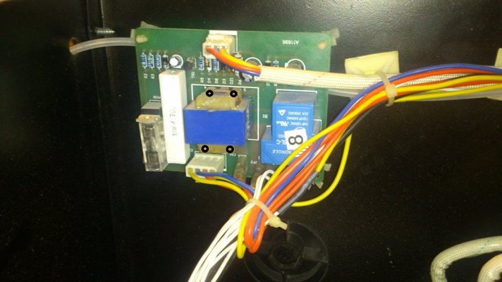

In the pic of the board what is the the right bang in the middle beside the relay? Looking at it the there's insulation around the coiled copper wire inside and looks a little melted.. Could this cause the problem or what does that do?
I heard a pop when it died no smoke tho

As Snooper has said that is a transformer and should have AC voltage into one side and a lower AC out. probable 240AC in one side and 12 to 24AC out.
Input will probable be one of the two black circles pairs and out on the other pair. Remember to set your meter to AC.
Also if something went "pop" have you checked the fuse on the pcb !!
The spark in work tested the transformer for me and it's dead..

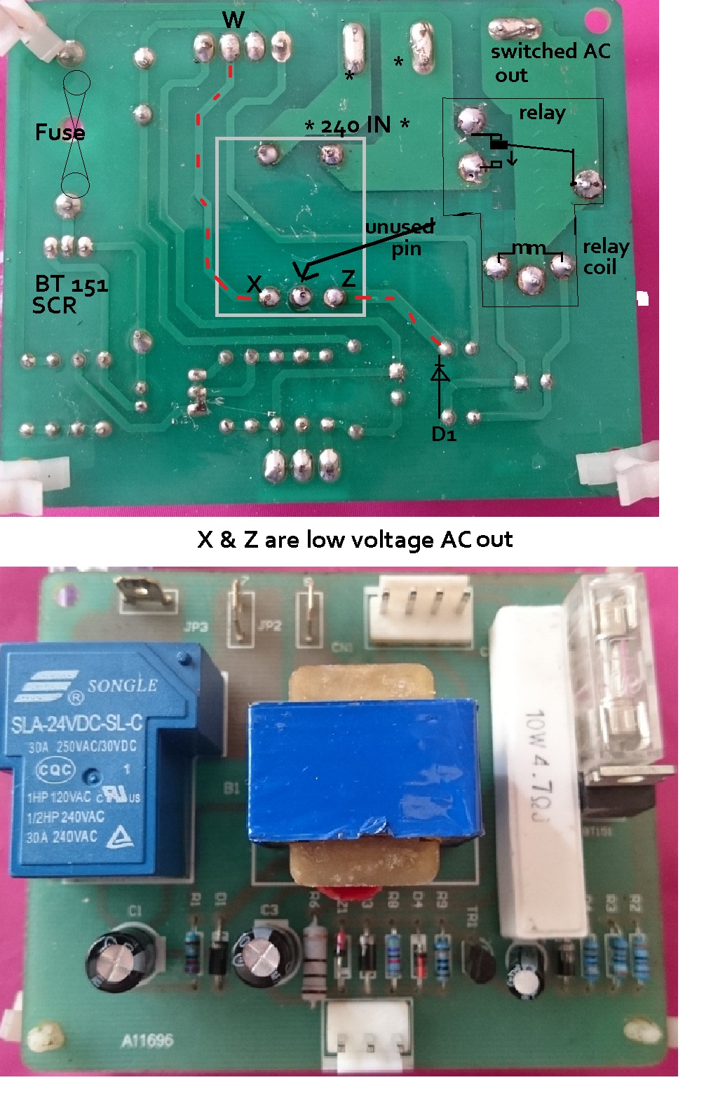

I would have thought it would be a 24vAC out and the extra pins may not even be used and are there from manufacture and allow the people winding the transformer to select which pins thy use when winding it. The extra pins also allow for better support when pcb mounting.
If you look at these pcbs from Clarke machines you will see that several pins are not even soldered to the board and some connect to the same part of the track as again they are not connected to the winding's
Just getting a 240AC in to 24AC out that is physically bigger should suffice and mount it near the pcb and run wires to pcb. Insulate the wires as some will be carrying 240v.

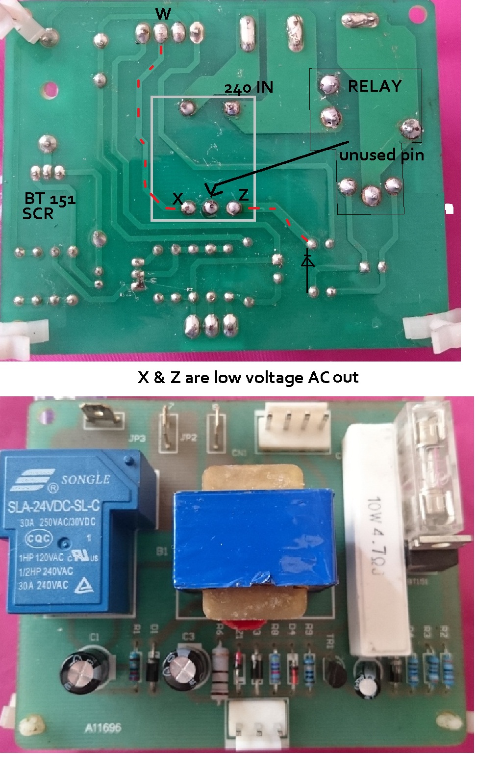

No I don't think that is what you need. You need a SINGLE out put. If you look at the attached image you will see that the middle pin is soldered to the pcb BUT it is not used (there is no track to it!)
With those small pcb type transformers they have a very thing wire on one of the input wires (hidden under the plastic tape) that is the fuse for the transformer, very crude!! It fails if the transformer is over loaded.
As you have the transformer remover then with all the plugs removed from pcb, meter between the X and Z solder pads on pcb with meter set to lowest Ohms setting. you may find you get a short (meter reading 00.00) indicating something on pcb is short. Report back if that is so. Also where does pin W's wire on the 4 pin plug go to ?
