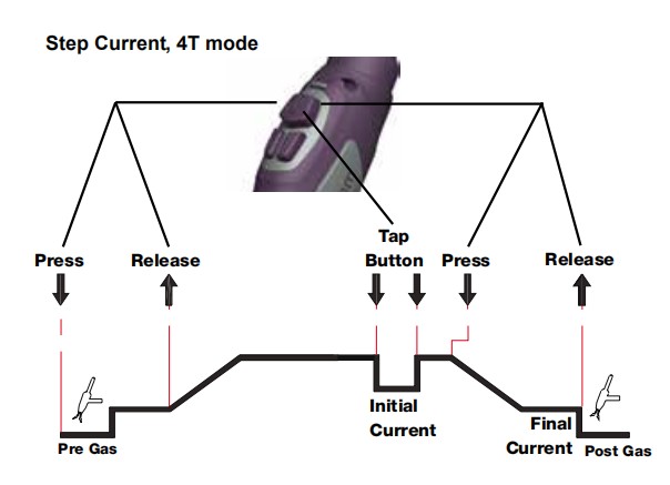

As for foot pedal or no - I would say yes, if you're welding ally you really need one. Sure it's another element to master, but otherwise you just end up oxidising the metal waiting for it to melt. For steel/ stainless not an issue.
