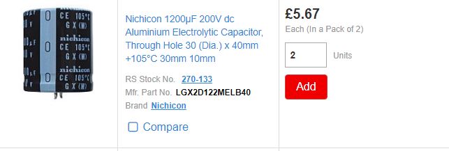

I've been looking at electrolytics on the web and these seem excellent quality;
it would help if I could simply turn on the welder allowing the caps to fully charge leaving it running for a while before welding but I'm unsure of the circuits and would the caps actually charge with the welder only switched on with the fan running; I see there is a relay on the board and wonder if this only activates once welding gets underway hence the caps only charge up then?
If the caps are in series to share the applied voltage they have to be nose to tail (electrolytics being polarised, they tend to burst if wired backwards), so one bank with have their positives to the common "centre point", the other their negatives - that point will be at (close enough to) half the applied voltage and probably doesn't have a load on it.
the two that have blown could be the first two to suffer inrush hence they blow first? If all six are involved then this changes values; I've forgotten how it works but I think however connected the voltage remains the same but series capacitors the value remains at the lowest uF but in parallel the values add up so in this case I think the 200V is constant but the value could be 1200uF in series or 3600uF in parallel.
