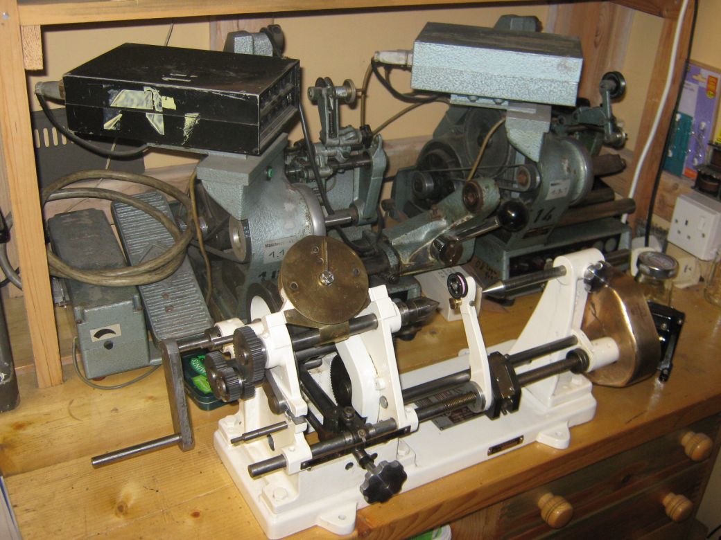

Three of my winders; the front one is an AVO Wave Winder I fully restored from seized up scrap winning an award for the restoration. I made new parts for it here it's shown unfinished.
A pair of Aumann winders (German).

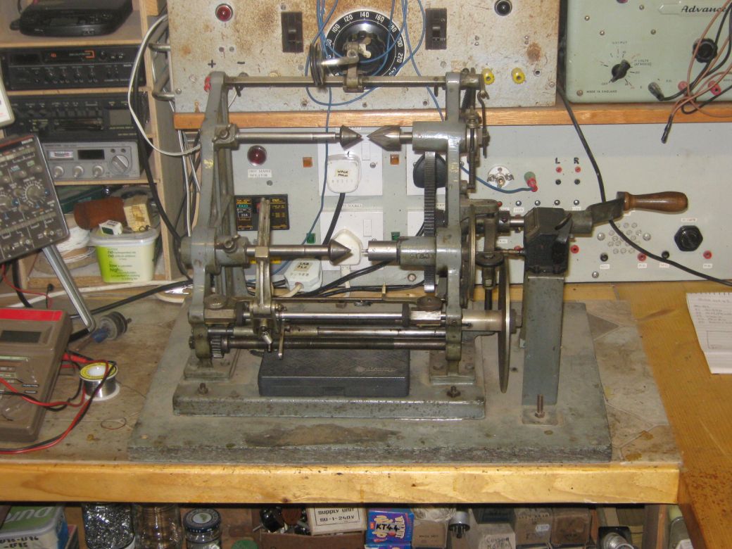

My manual AVO Douglas winder that I wound many coils on. All winders sold years ago when I gave up vintage radio restoration.

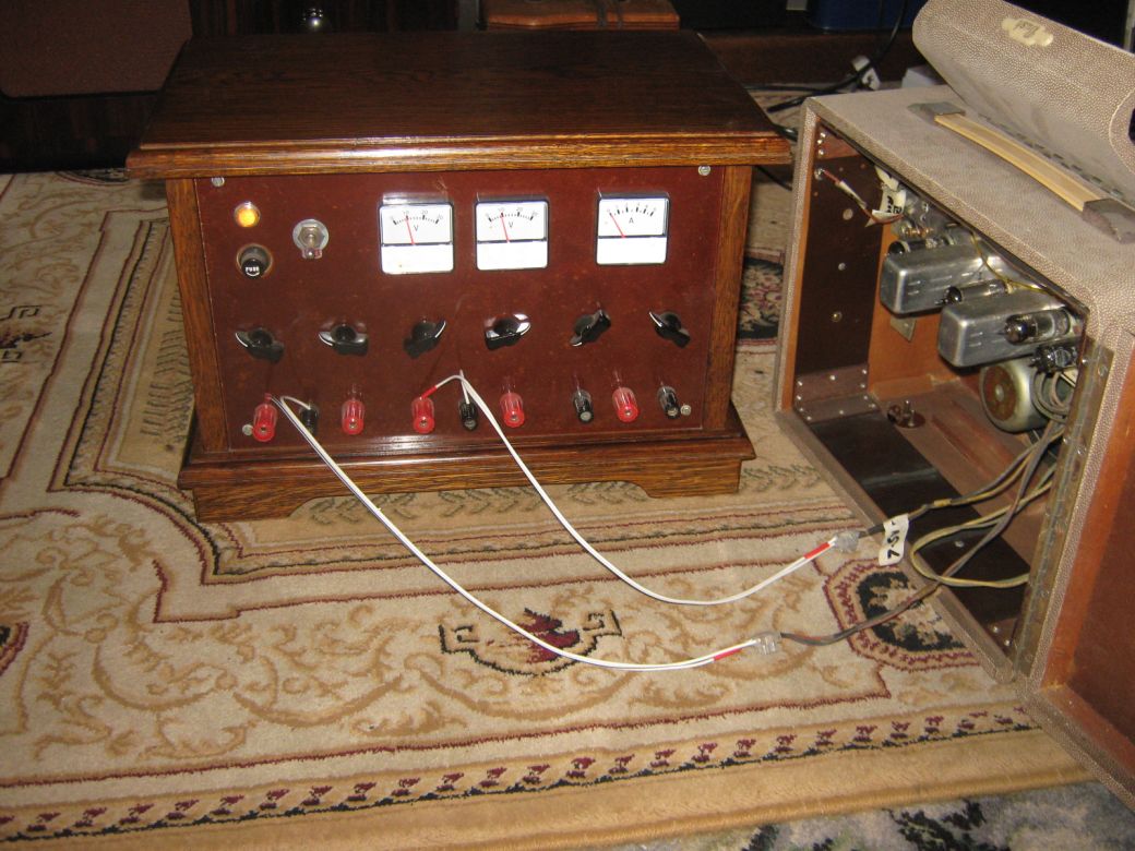

Mains vintage radios I could power up from my bench circuits but battery sets needed lots of different voltages in both positive and negative DC. The batteries haven't been available for many years so I designed and made my own bespoke power supply in fact I made two of these giving one to a friend. It's many years since I made this PSU but I wound two transformers; one each for HT & LT. The HT gave a range of volts from around 60 to 160 in steps of ten through a wafer switch; the steps were controlled by Zener diodes into the base of a power transistor ( BU508?). The LT was both positive and negative fully variable on each using regulators (LM317?) from memory. These gave variable DC to around 36V? Here the PSU is hooked up to Bush battery radio. I used to completely restore these old radios both chassis and cabinet; a fascinating hobby I enjoyed for about ten years directly after retirement to keep me interested during our long winters.
