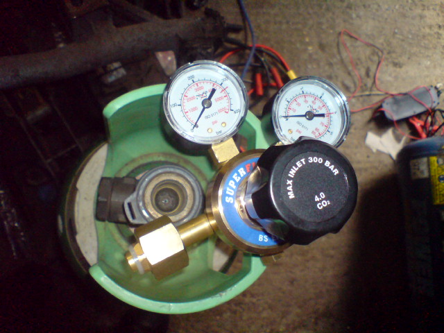

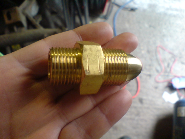

it seem to me hobbyweld has less gas?
will my current weld gauge fit? it fit the standard air products cylinder the big one.
