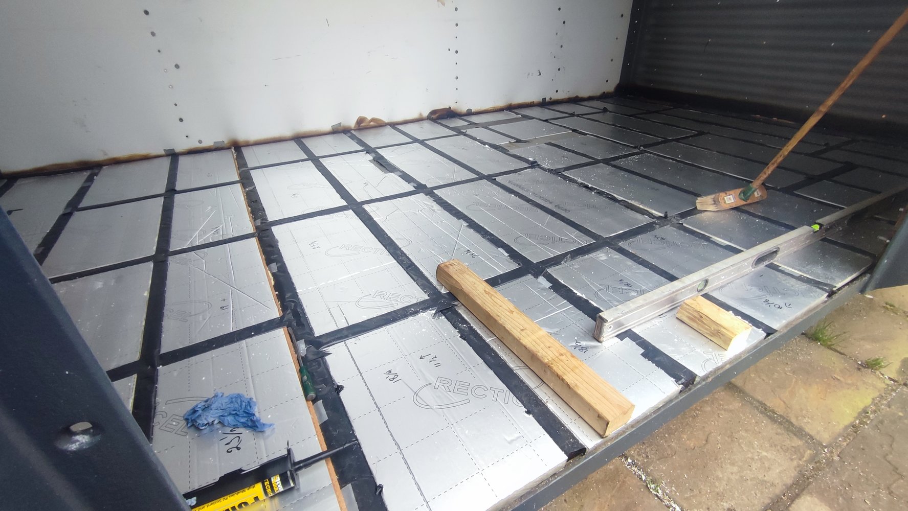

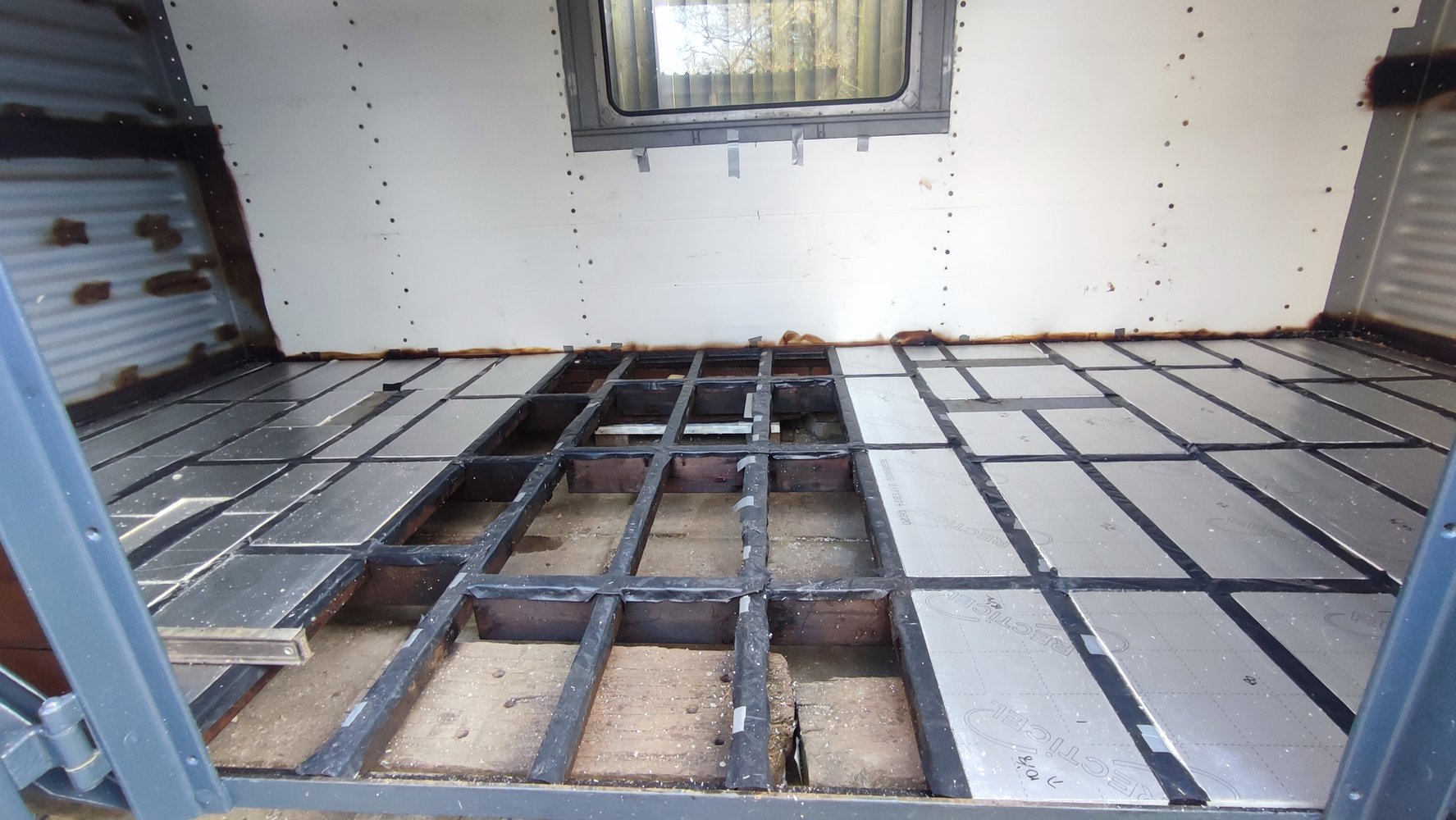

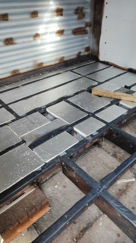

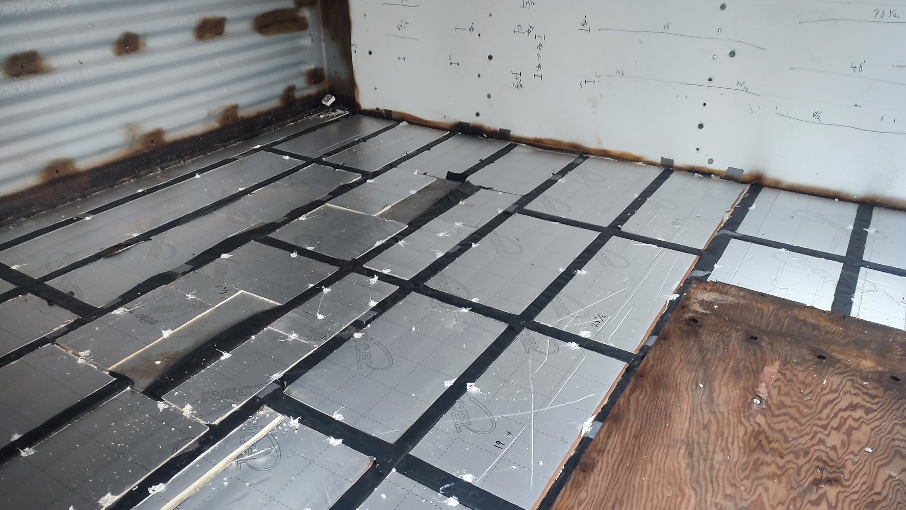

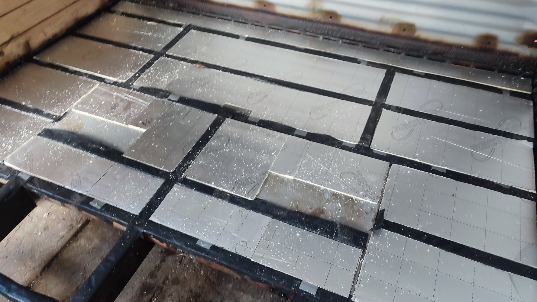

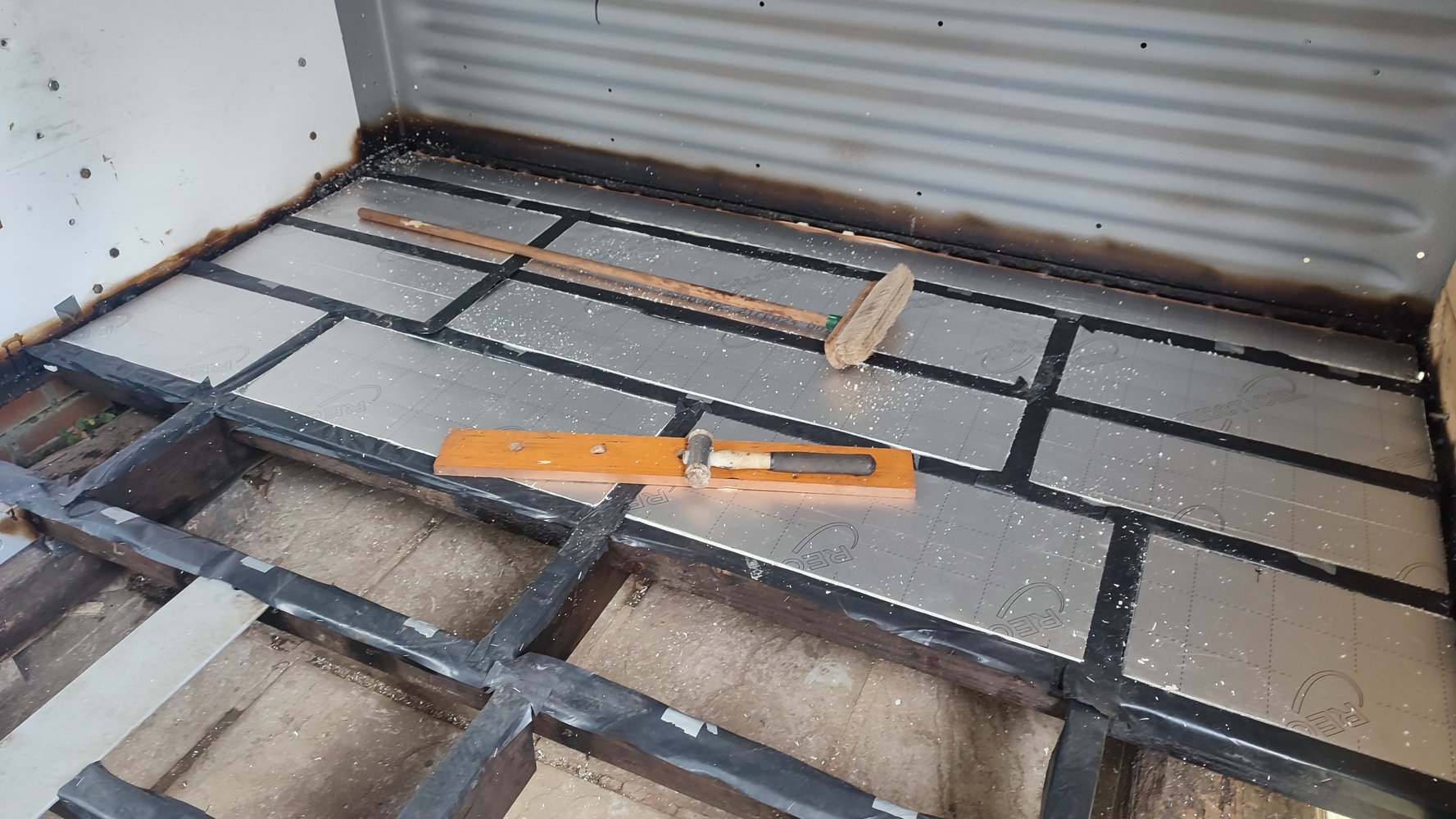

That is a tidy job!

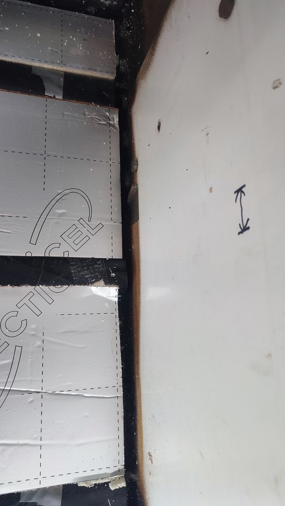

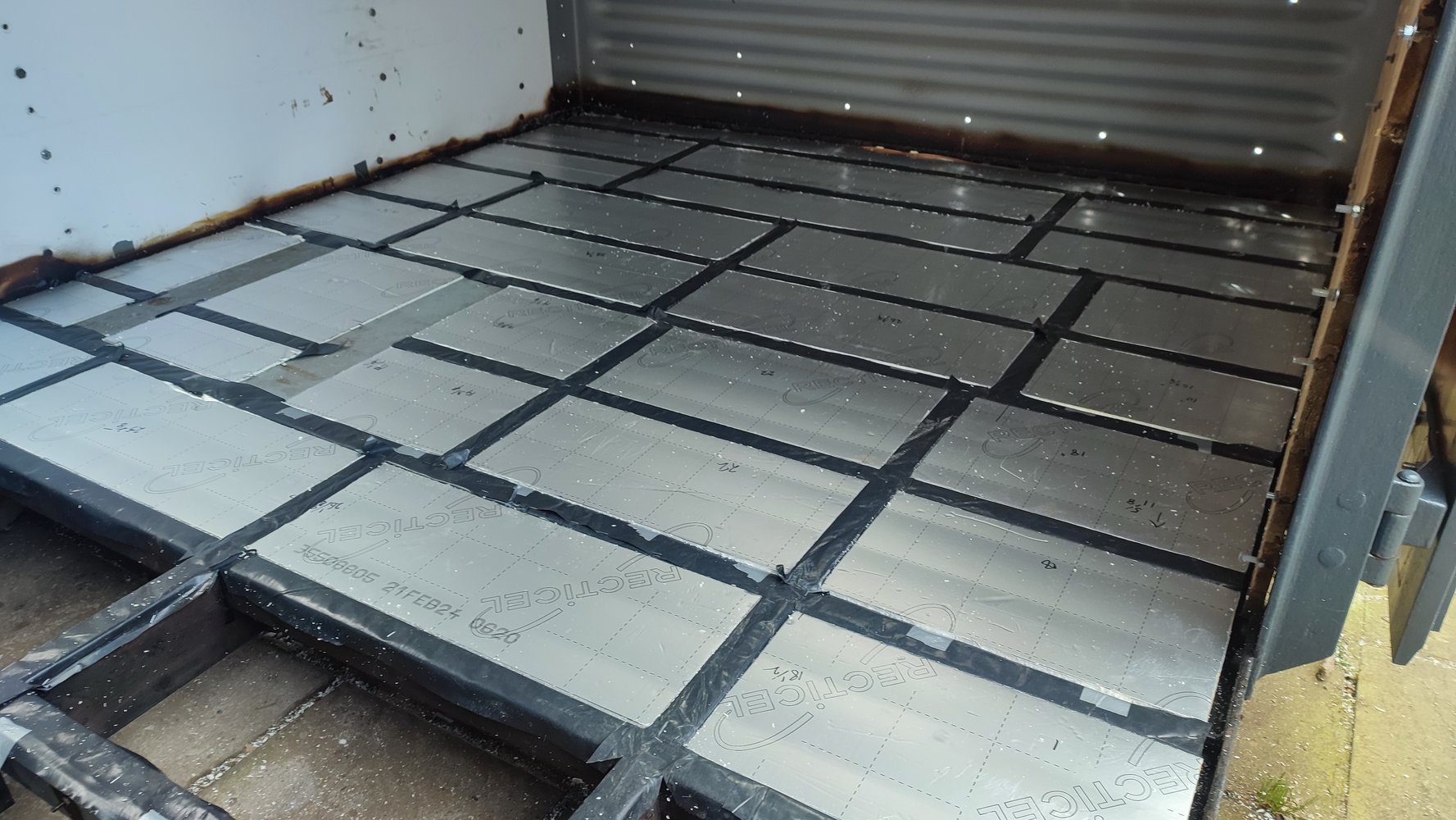

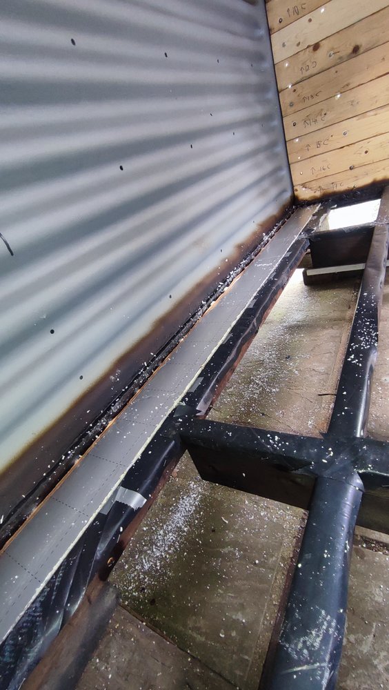

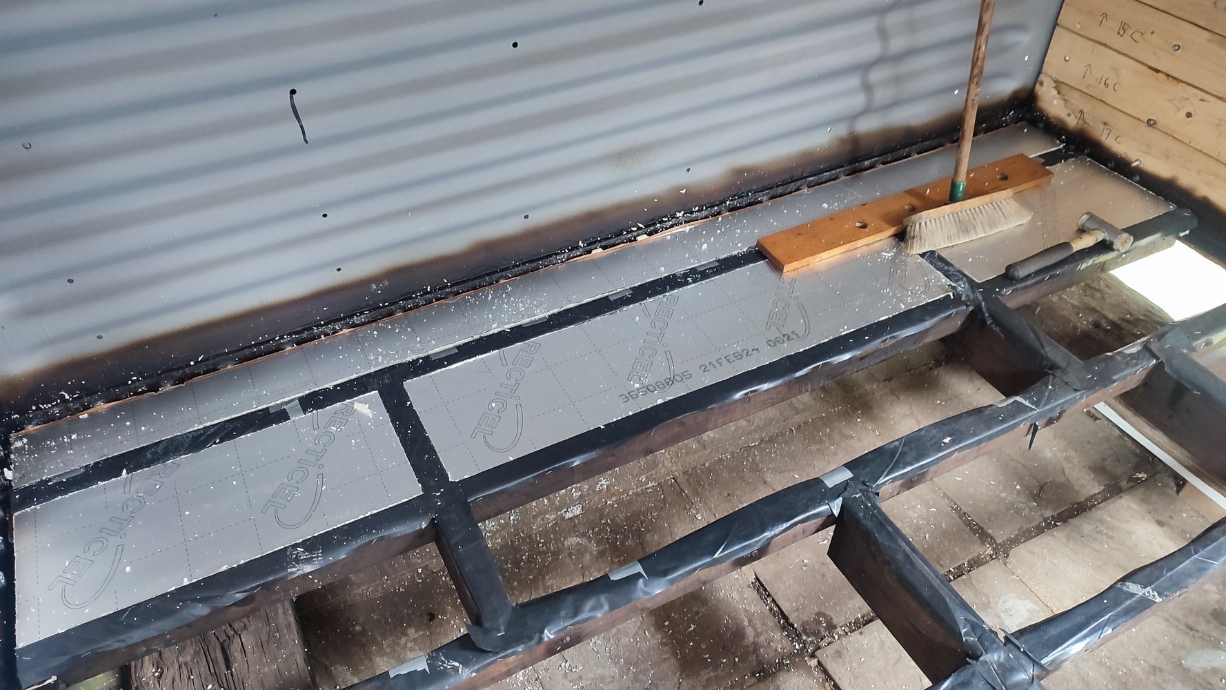

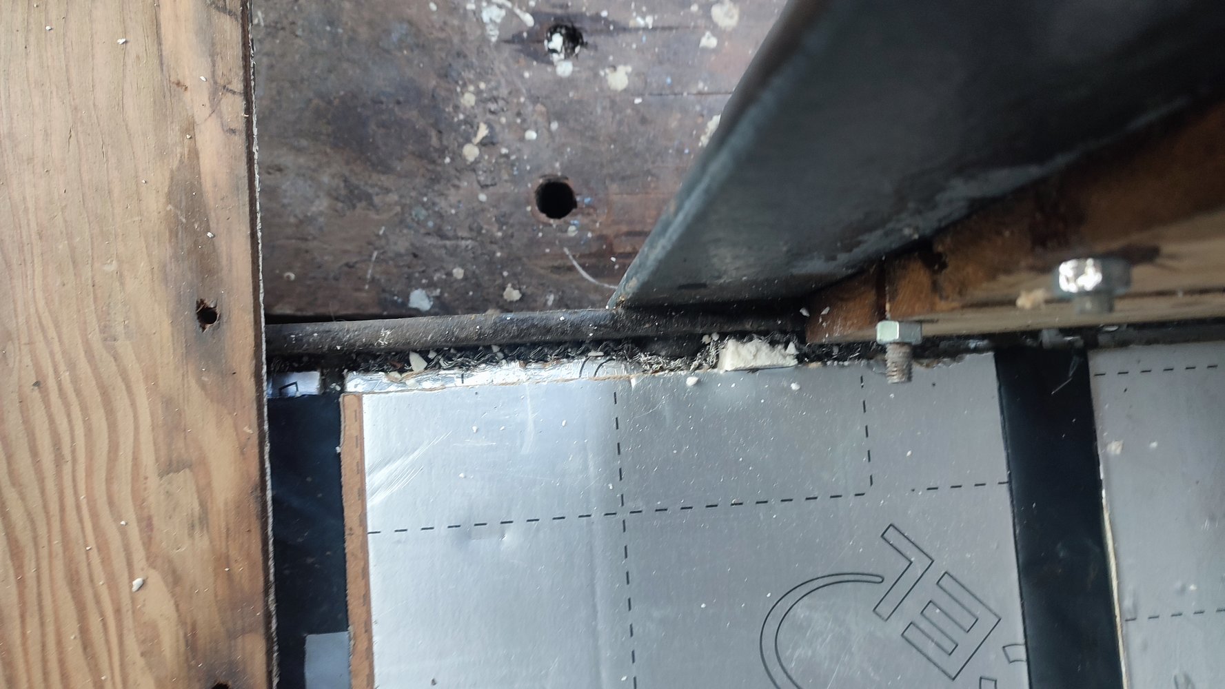

Is it glued or supported from falling out below?
It will move over time and what was a snug fit will fall out if not.
Ask me how I know!
It's only friction fit. But as in hammered in using a wooden batten as a drift. I'd not walk on it, but it's tight. Still tempted to put a shot of PU expanding foam in each corner.
From past experience I would at least put a shot of PU on it.
Even though they are tight right now they will over time shrink slightly and with traffic above the floor the slight movement will with the aid of gravity slowly move them out.
I can tell you that once the final floor is in, it's not much fun scrating around under it fitting them back in and supporting them!
Lucky for me there was enough room below to do that and not have to rip the floor up and start again!
The rain held off enough, so I was able to get it finished. I've also started to glue them in. I drive a screwdriver level into the side, and squirt PU into the gap.
I think it will work. Next step after the glue, is the anti mouse mesh.

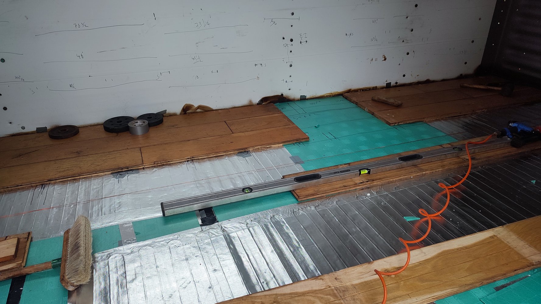

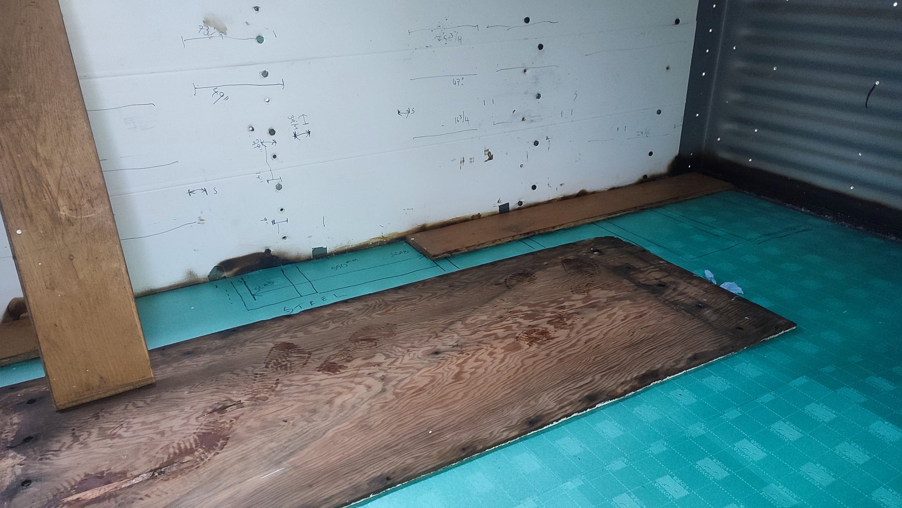

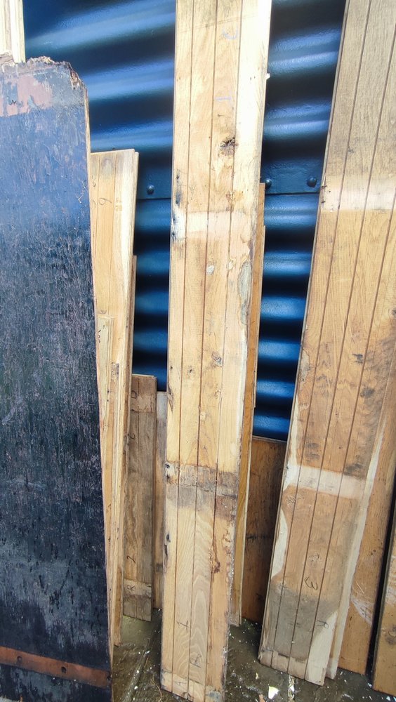

The forecast for tomorrow is good. Which is good, as I'll need to have all the planks out in front of me so I can pick the right ones. Sounds daft, but I take time picking planks that work for each space. Looking forward to having the floor down!

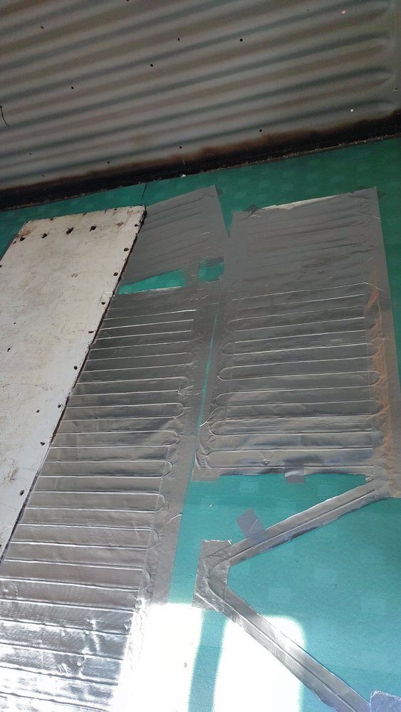

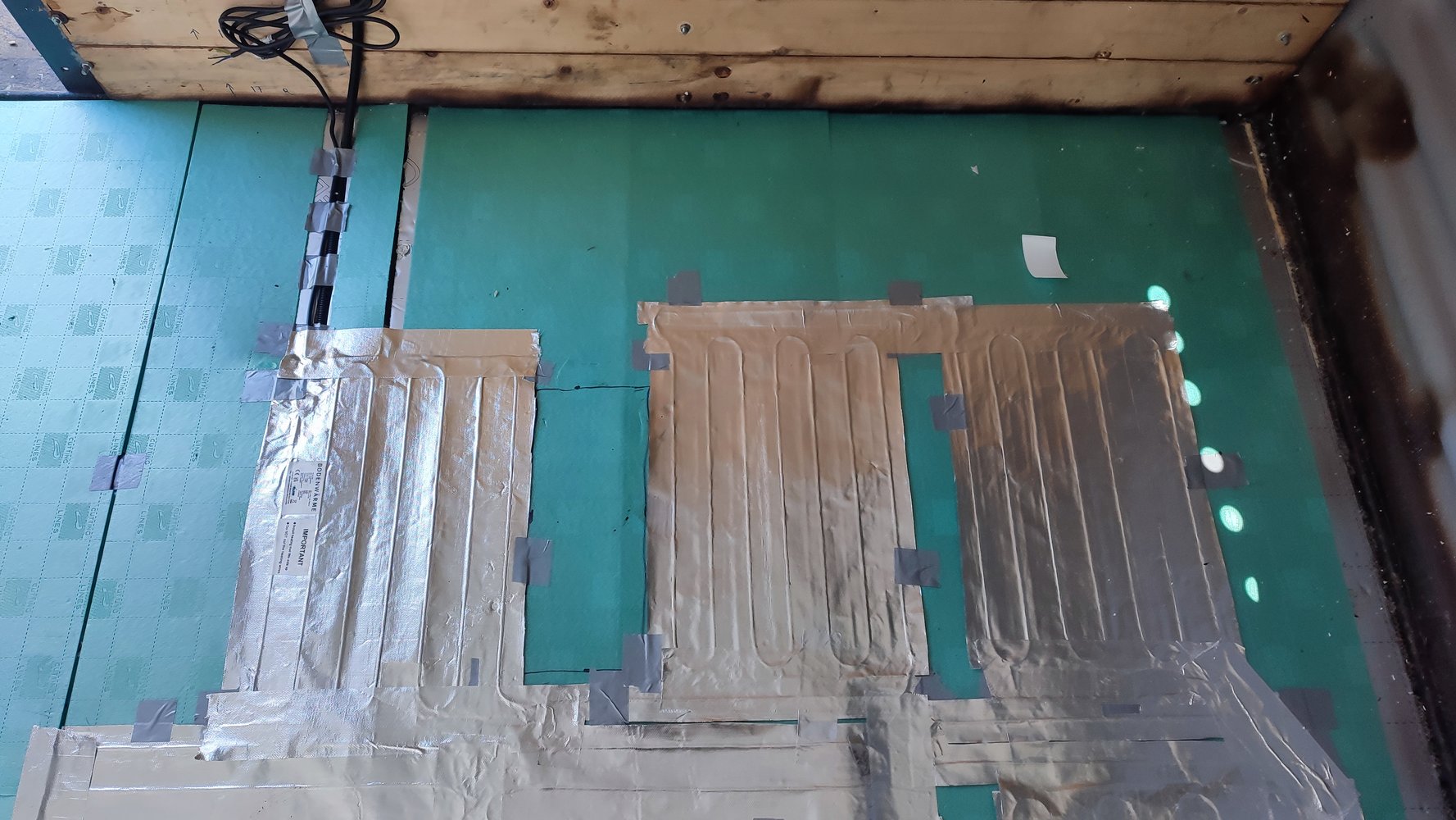

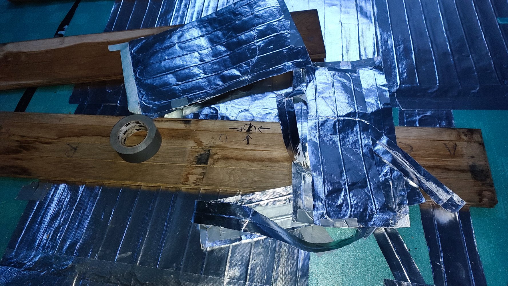

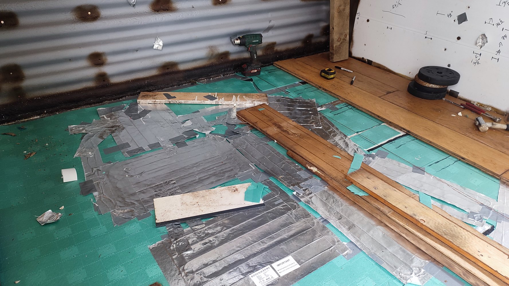

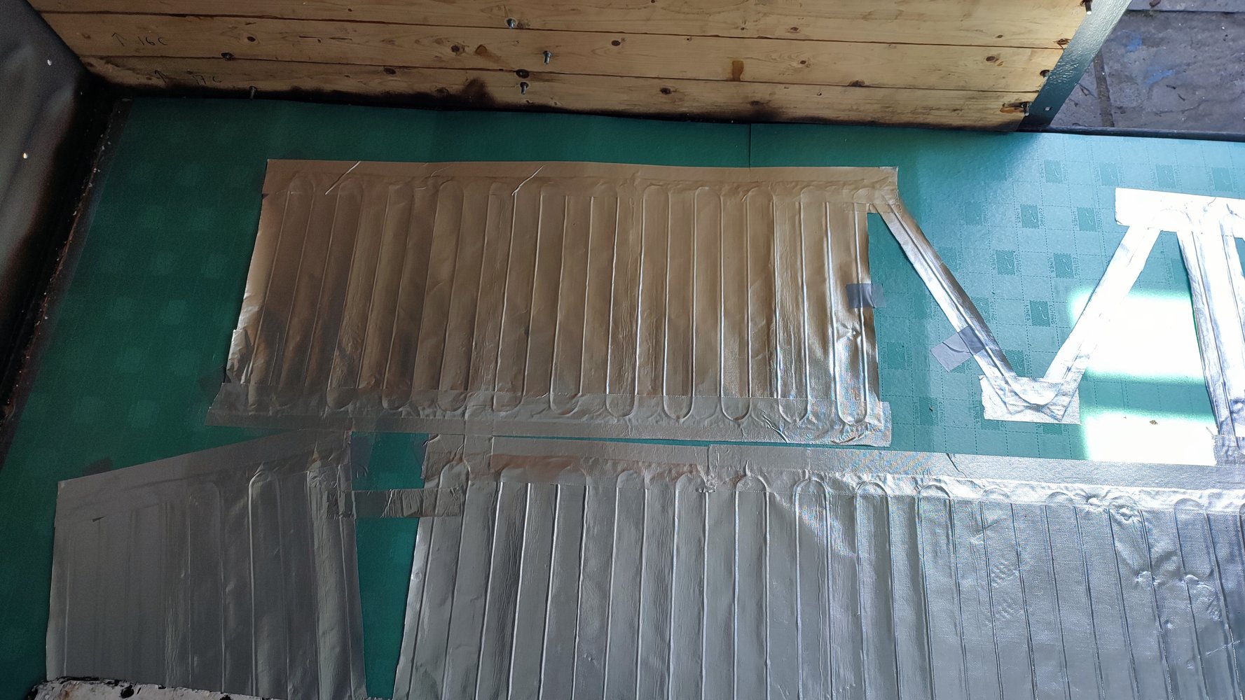

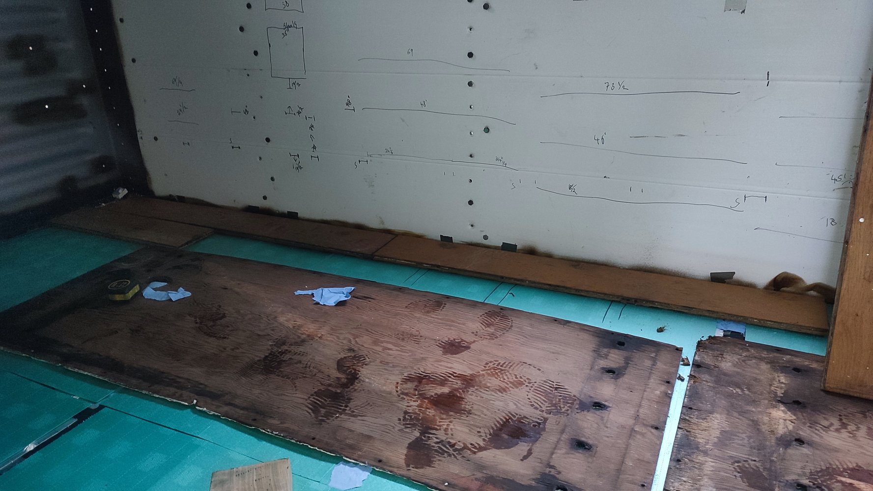

Well. The good news is I now know how to patch electric underfloor heating....
The bad news is I've not got a floor down.
I nailed one of the wires, stupid, but I fixed it.
The resistance was miles out, and there was a earth cable leak, too. So something else was wrong. Still not established what, but I'm closing in on it.
I was hoping to take tomorrow off. But that's not going to happen.
