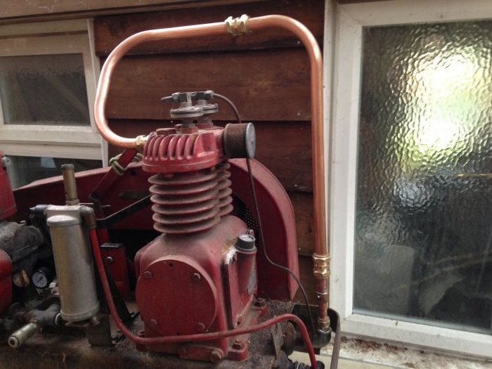

With that engine (motor to me means electric motor
) you could move up one size of pump to a AC18/25, It just looks to me as if someone had that engine and decided to use it, which is ok, but you don't get more CFM out of the pump just because you have more Hp on tap, you get more CFM by spinning the compressor faster, so if it spins faster than the manufacturers specs then you are going to shorten its lifespan especially when working it hard like when blasting, that's the point I'm trying to make.
