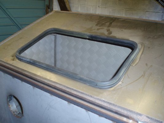

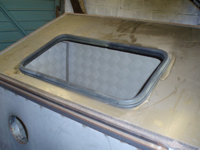

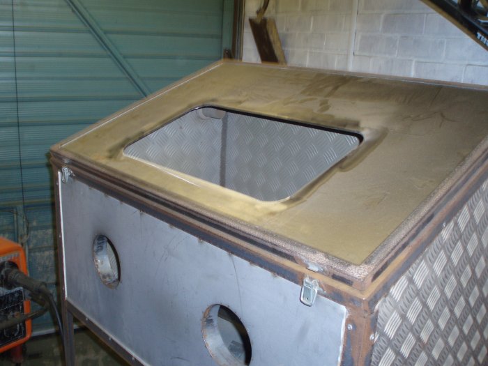

USED SOME TAILGATE RUBBER SEAL![]()

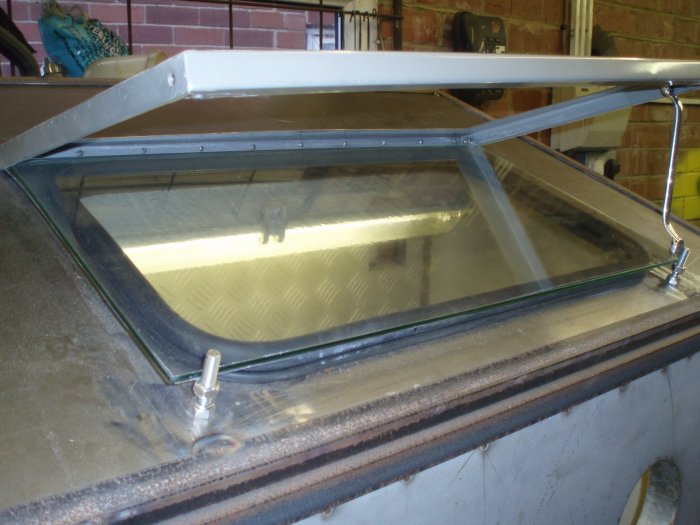

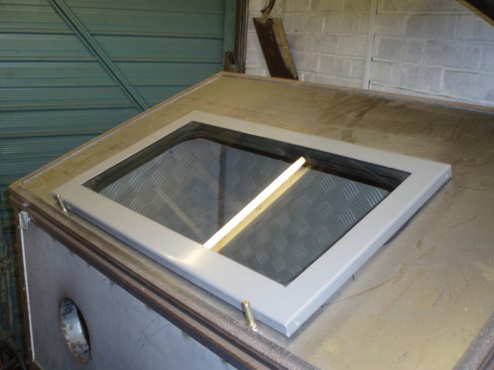

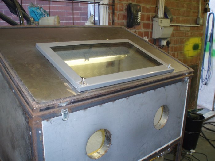

found an old steel shelf cut out the opening for the glass and it's looking good. not easy to see but the glass is in the frame. it just needs a strip of foam between the frame and the glass and a peice of plastic between the glass and the rubber then a couple of captive bolts and wing nuts. i may put a piano hinge accross the top edge
:QUOTE=atconut;208118]i've got a big dust extractor it's like a big hoover but it's a propper dust extractor
it's hard to see so heres a pic with the frame propped up there is a sheet of plastic under the glass
