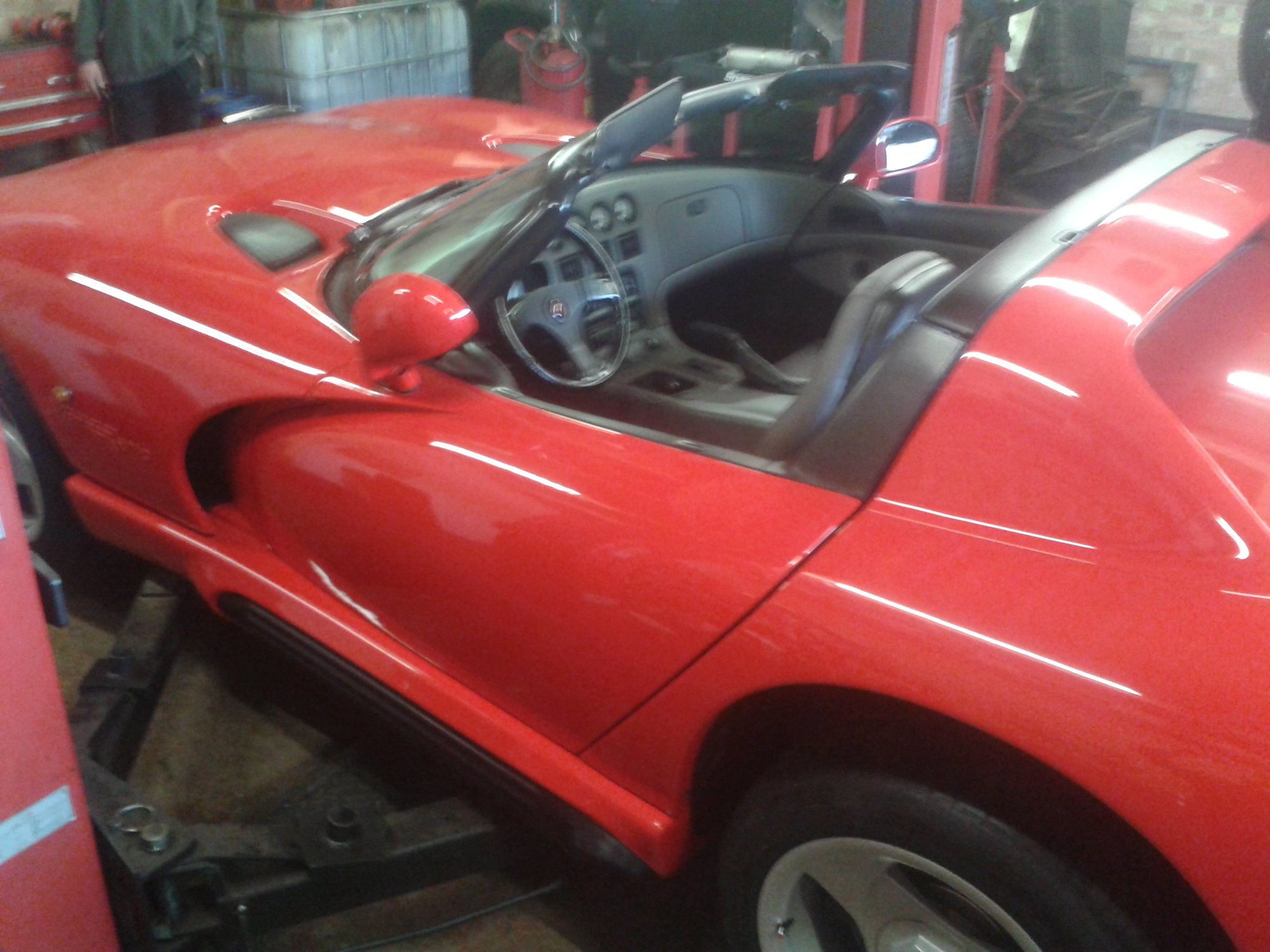

scissor jack lift forget it its a pain to work anywhere near theat engine gearbox and exhaust working at certain points to weld well forget it with that type its always in the way

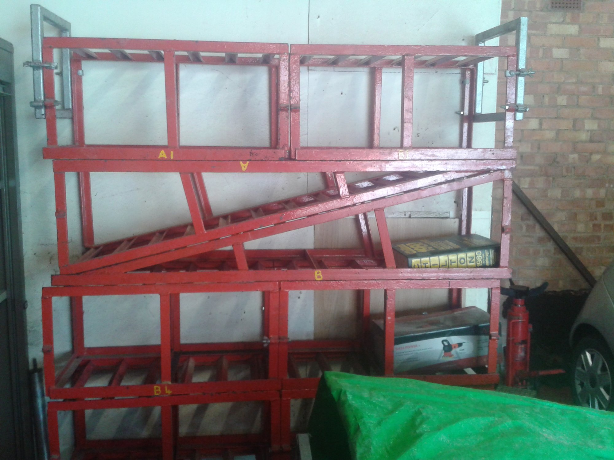

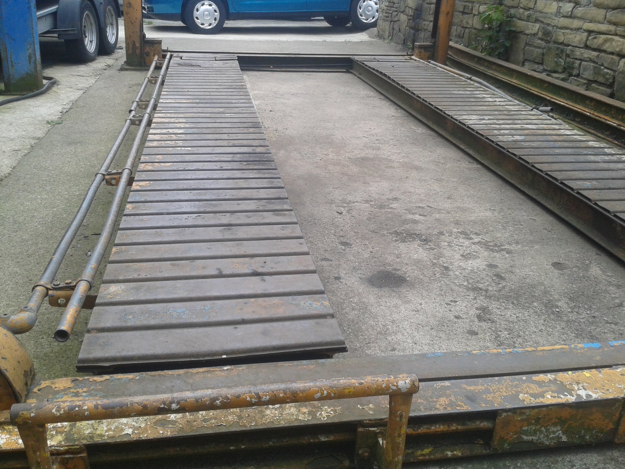

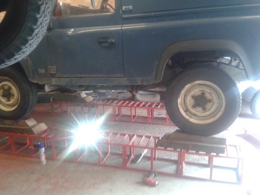

car ramps great access cheap to get with hydraulic jacks ackward to store not really those ones ive posted take up space 3ft x 6ft high stackable great can store stuff inside them when not needed
safer and lower but yes you can slot one ramp under each wheel then jack up again to add the wood beam chocks great stay in one place can weld and get to every part of the vehicle weather transit van long wheel base or even a landrover sat on them
every part can be gotten to and be welded and also sprayed up under there as well done it seen it done and grinded thick metal off for new metal to be shaped and welded onto again
