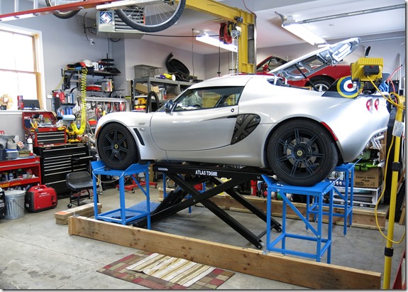

Do they do a full rise in this range?I have a scissor lift, this one: https://www.automotechservices.co.uk/products/as-7530d-garage-scissor-lift/
However, it's not exactly mobile given the weight of it, so I plan to recess it so I have a clean flat floor when it isn't in use.
The main advantages for me is that I don't have a solid enough slab for a two post, and limited height available.
The scissor doesn't need a thick slab, just reasonably flat ground and I can squeeze the mid rise in with the average height car. It also gives you access to the doors which a two post wouldn't, and its not in the way when you aren't using it.
You are restricted for access to the sills, but plenty of room to get to front and rear suspension which you wouldn't get with a four post, and this model is fine for centre access.
I wouldn't choose the smaller units with the centre cross braces as this would really restrict what you could get to.
I was in two minds when I bought it and agonised over the decision for ages, but since having it for a few jobs I can safely say it was a fantastic investment and I wish I'd got one sooner.
Works great for suspension, brakes, driveshafts exhausts etc.
If I had the extra height I would have preferred a full rise for more comfortable working, but you can get by with the midrise and it’s a magnitude better than working on your back under axle stands.
I know they say parachute valves are inherently safe on their own, but I do like the fact it has a couple of heavy duty locking racks as well, it’s very solid and inspires more confidence than axle stands – obviously you do have to give some consideration to centre of gravity, but perhaps not so much a concern as with a two post. One modification I would like to do is put an extra switch in to disable the pneumatic lock release, so I can lower it onto the locking rack to take the load of the hydraulics if I’m leaving it for some time – no idea if that is necessary but looks to be easy to do and I’d feel happier.

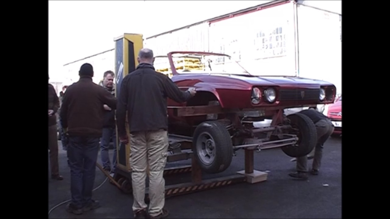

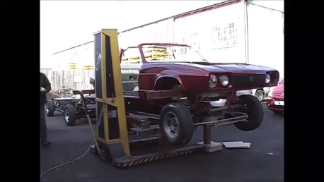

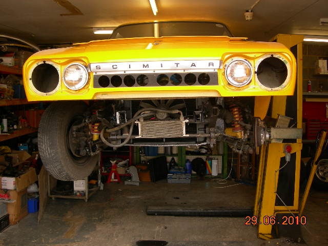

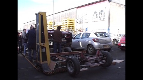

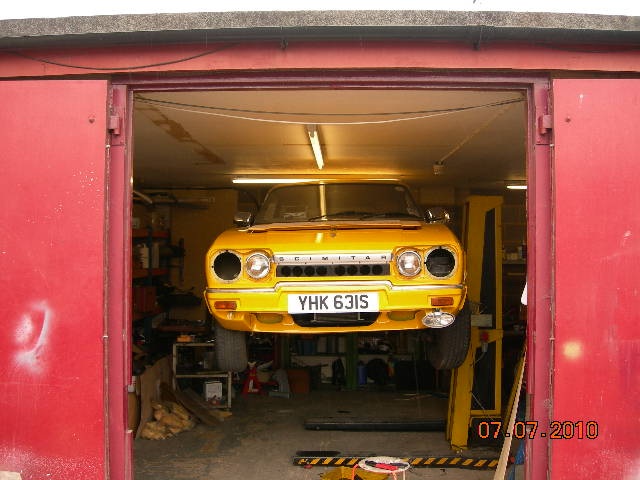

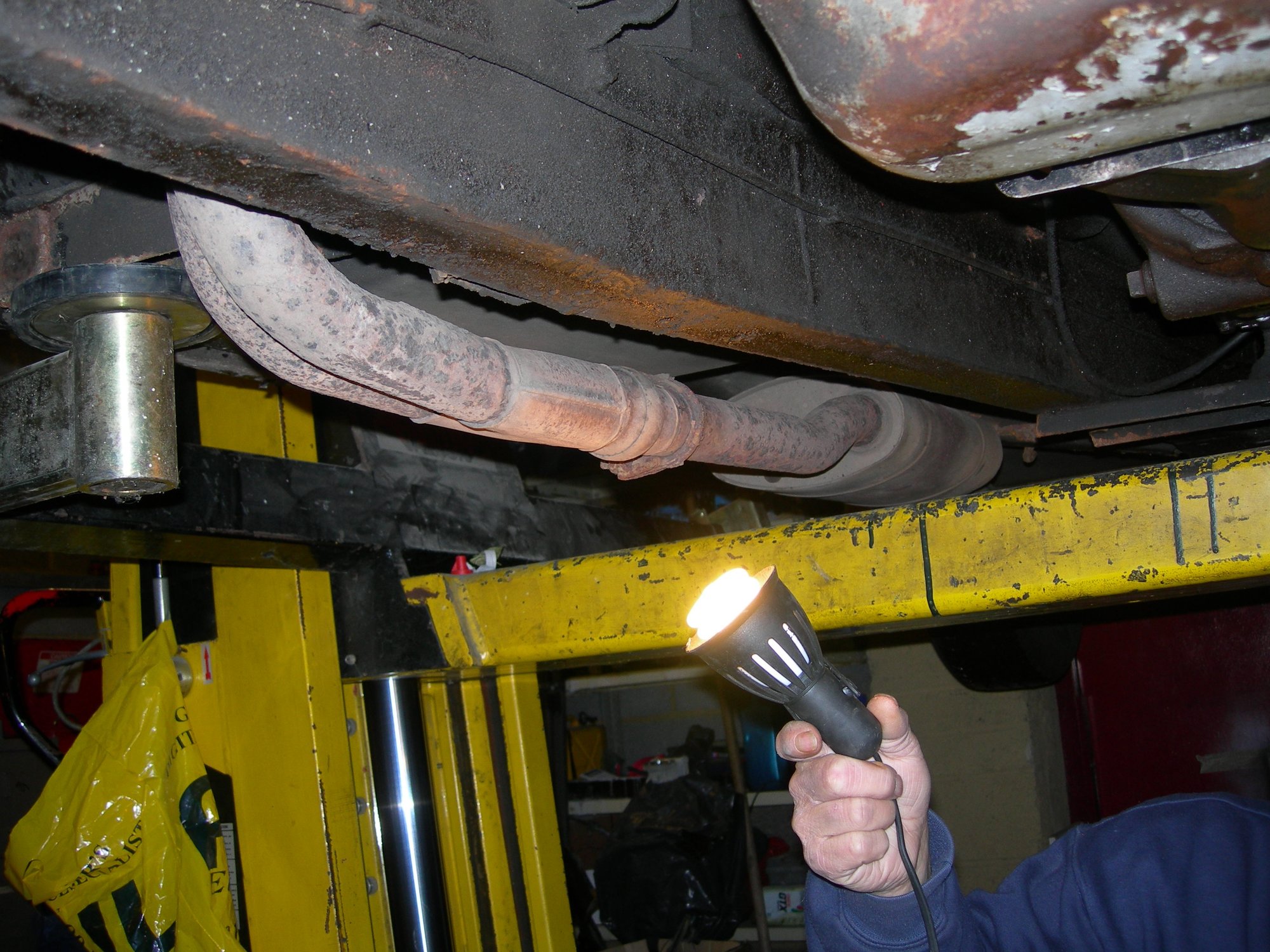

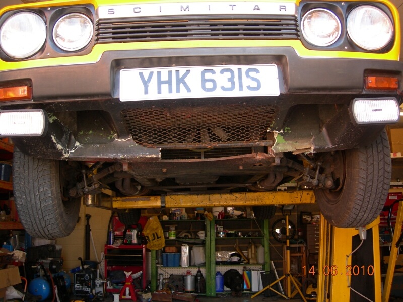

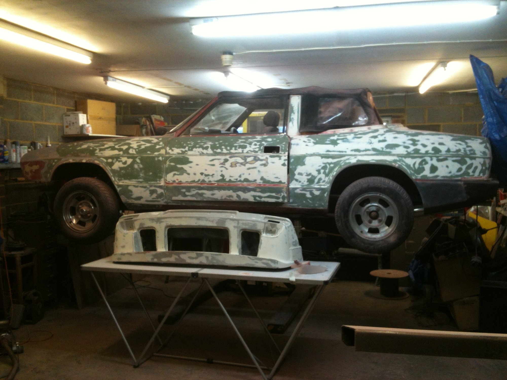

A lot of unfounded prejudice against single post. I use mine everyday and I would say that it was more stable than a two post. Everything from three wheelers to my Scorpio estate is lifted and there has never been an issue. I can spin the vehicle around 180 degrees and push it across the workshop out of the way and it doesn't wobble or move in any way. I feel totally safe working under it. Mind you, it is a proper commercial 3 phase lift, much better made than the one illustrated.
It's an Italian brand which I have never been able to track down! However it is probably more than 20 years old and built well.What make is yours?
@ajlelectronics OK, I am one of those who just doesn't like the look of it. I'm sure they must have gone through some testing so may I ask, is yours hydraulic? Do you have a make and model please? Most important, what is the capacity? I need 3 metric tonnes if I want to lift the Discovery but if there is something out there which would be suitable I would like to take a look. Thanks. Dom.
