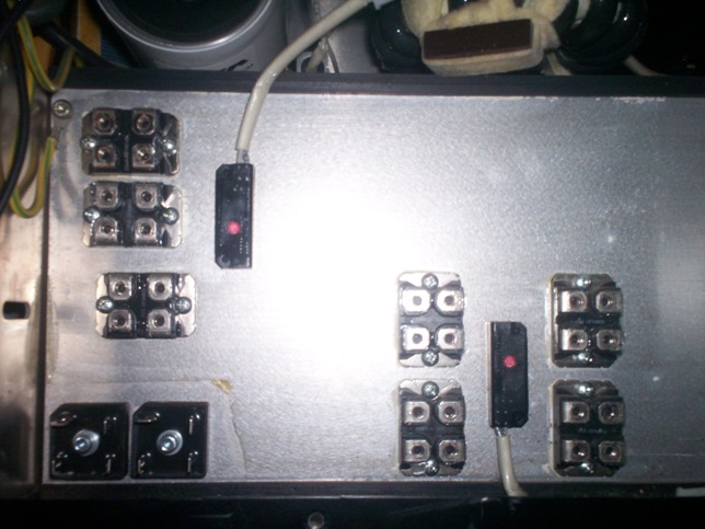

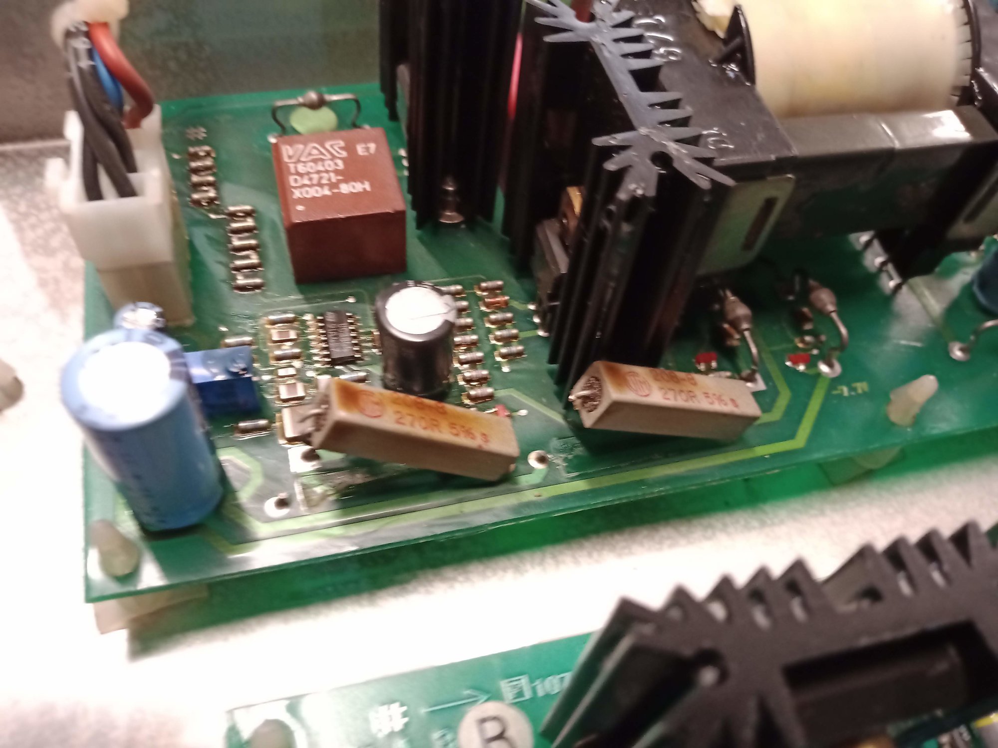

Today after work I found some resistors, and after soldering them into the board the machine now is confirmed as working.
Also swapped out some dodgy looking condensors, they were not bad persé, measured OK but looked a bit worse for wear.
So as a future reference the Lastek suffers from the same problem that plagues the Magicwave (resistors failign after time) and can be fixed the same way.
Symptoms were the same as described by HughF and ..
Only one working power led on the main PCB, instead of 1 next to each driver (this PCB has the Drive leds next to each drive, not grouped together in one corner) , HF but no actual arc and 0.0 volt showing when on MMA.
