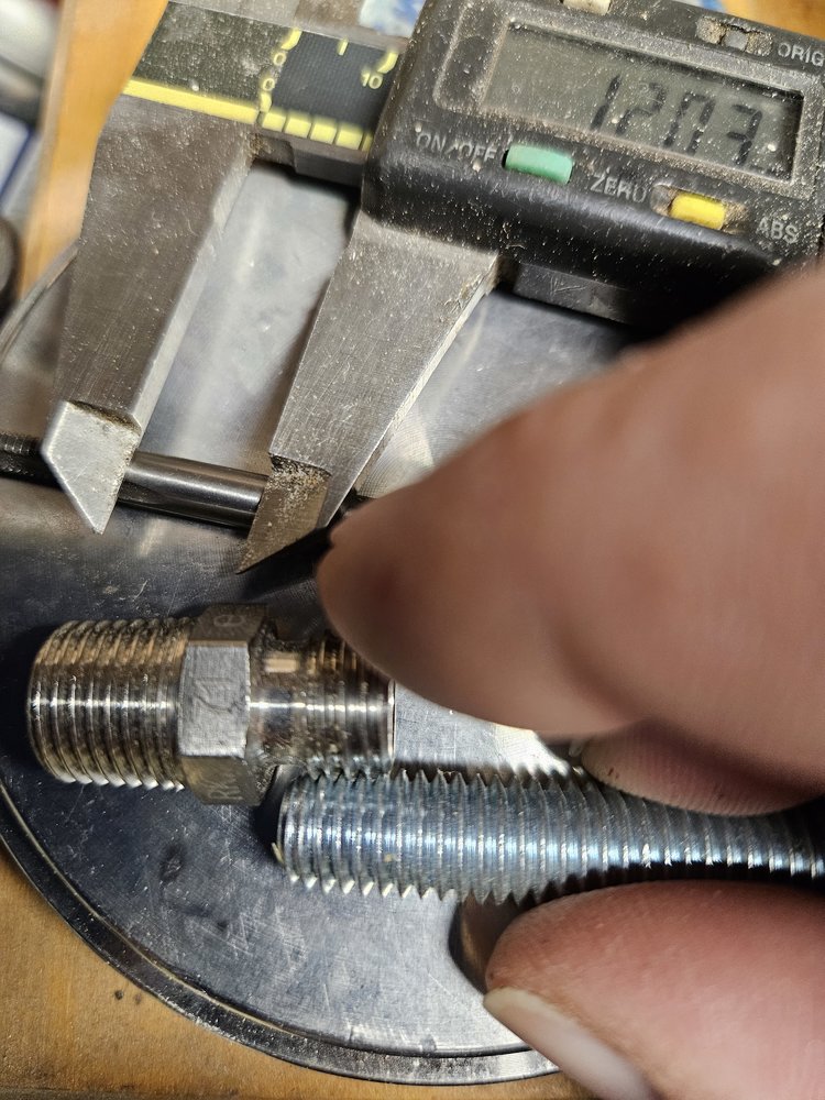

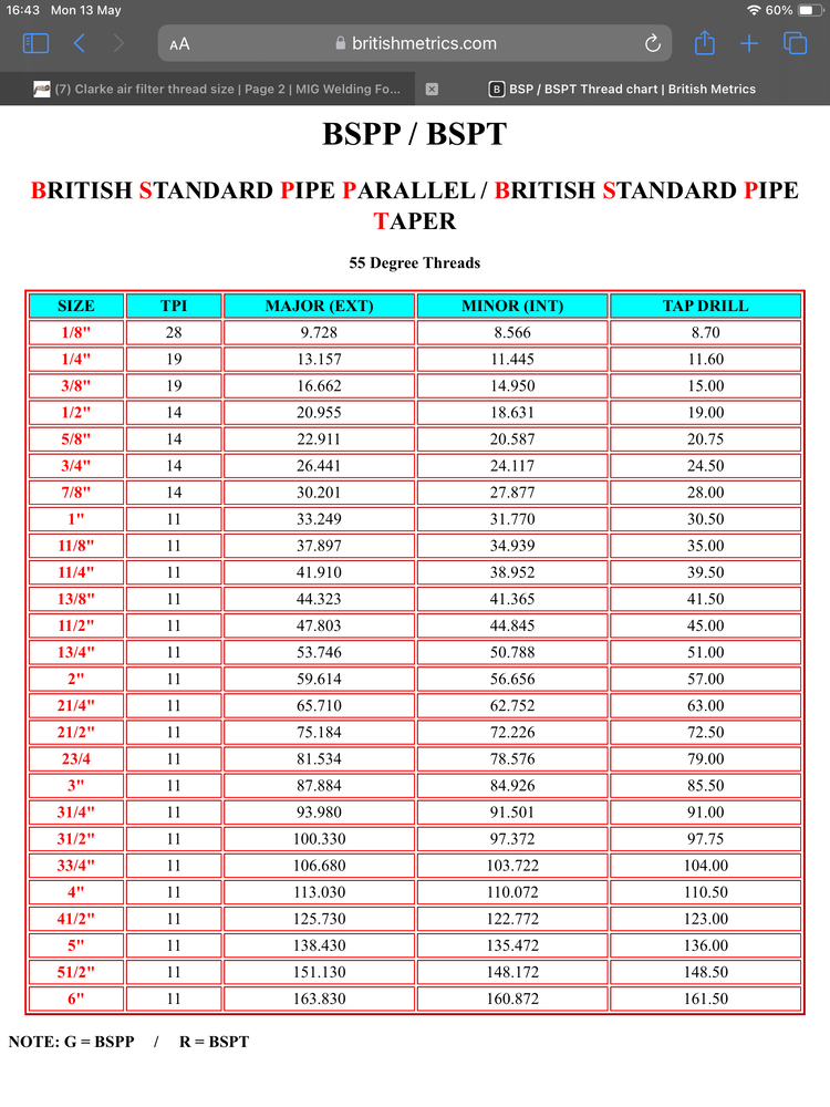

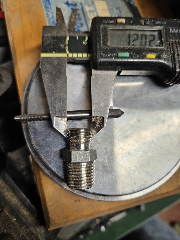

The pitch of an M10, not diameter.m10 is way too small m15 is way too big! m13 is way too small too
You said it measures 15mm diameter didn't you...
I just measured it 15mm diameter.
