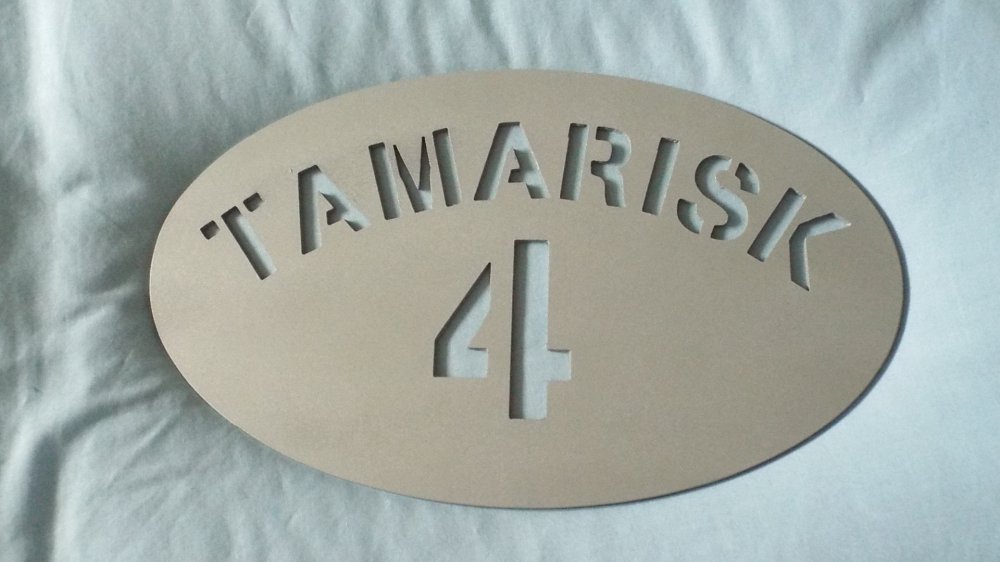

Was cutting 3 mm so had the current at around 32 Amps seemed to be good, first thing was a sort of house name plate.
This is 300 x 180 mm

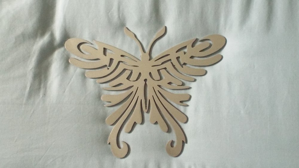

Then later did a butterfly "trible style", this is what got me getting concerned. A constant 6 minutes cut at reasonable current was wondering if something would melt and the heat it was putting under the tray onto the bench was a hell of a lot. I have a 2 mm plate on top of a wooden bench to stop all the sparks and it was warping with the heat and causing the whole frame to wobble.
A few hours later and no fires so think all is fine.
This is 270 by 217 mm

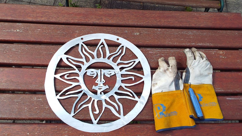

Both have been cleaned and cold zinc spayed.
The sign was acid etched in the stuff I got from brewdexta, nasty stuff that is, Ughhh. It removed all the mill scale easily but only an outside task and rubber gloves and glasses as minimum.
