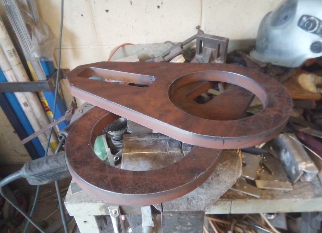

Jasic 80Amp, been looking for pics but can't find any, only one I can find is the one below and it is either 20mm or 25mm.30 mm what plasma supply ?

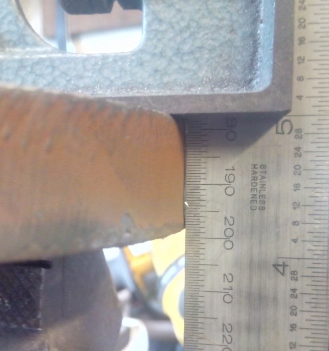

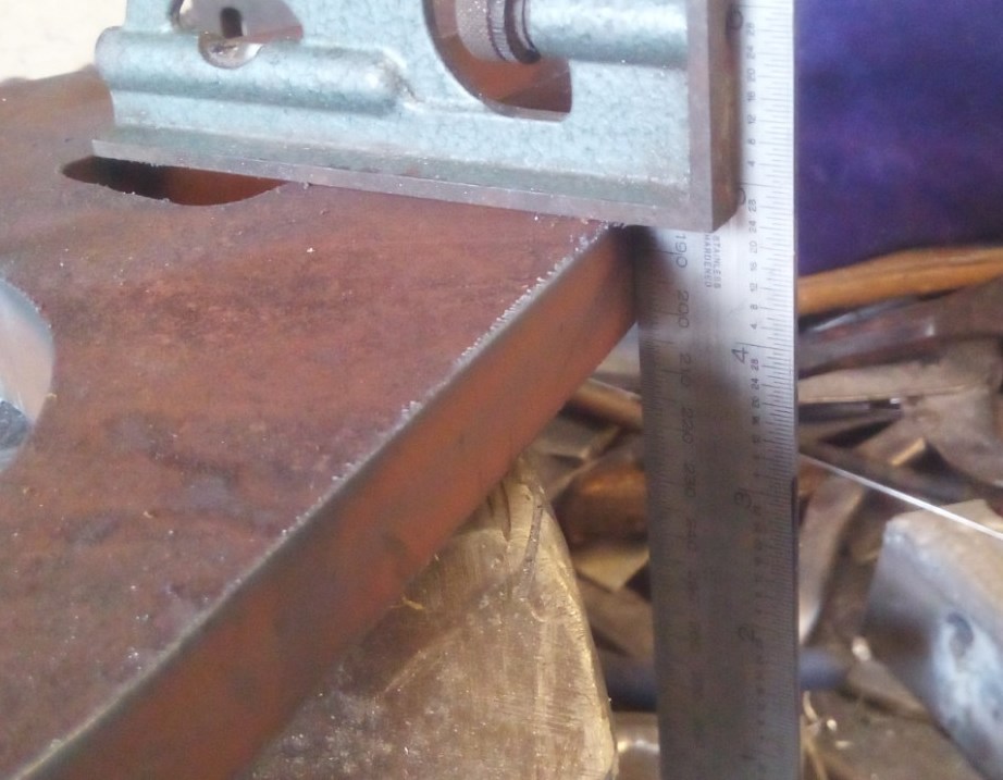

You're somehow getting HD plasma quality on that 20mm that's good enough to meet any thermal cutting spec. Its a million miles better than our laser.This was showing that there was minimal bevel on the above 20mm part.
And even on the scrap side it was minimal.

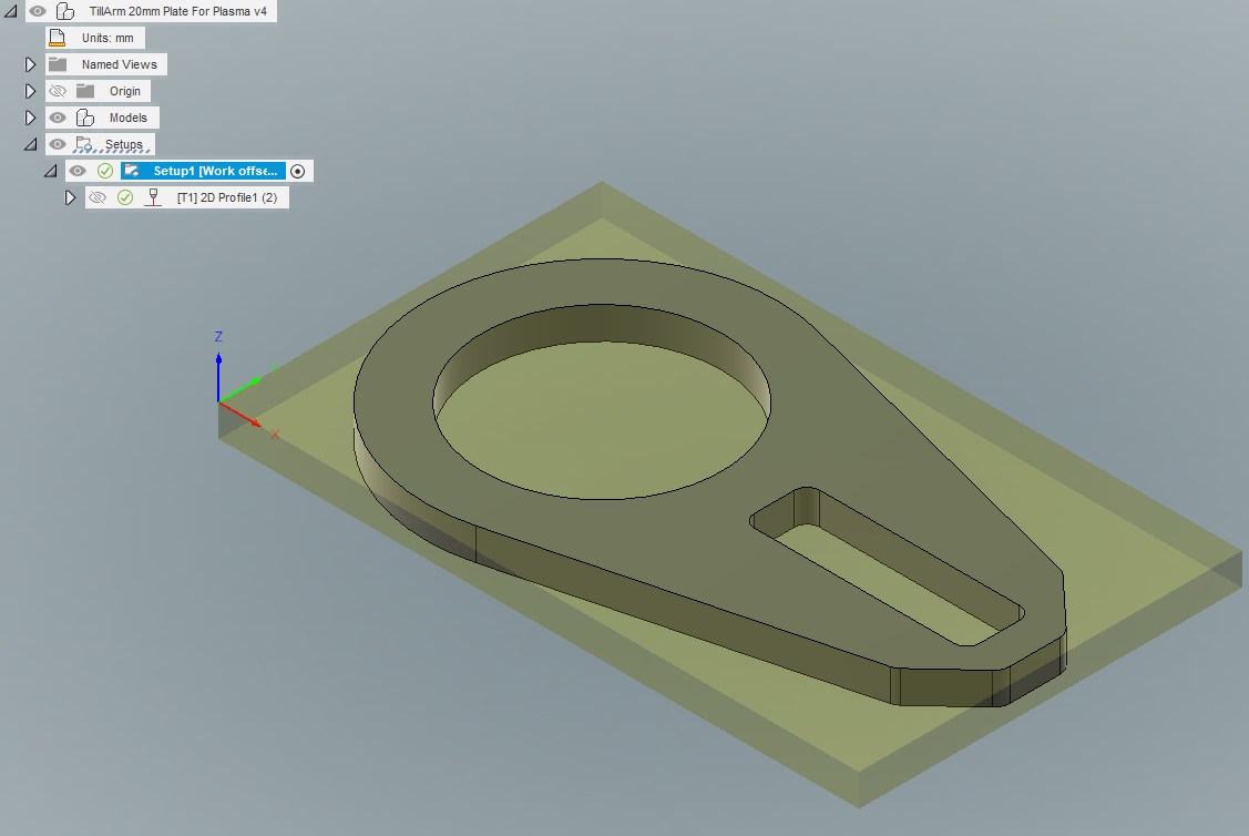

Your part has an interior cut out with what looks like 4 corners, but you designed the part with some larger
radius so to preclude corner slow down.
Which I do as well, however Hypertherm shows corner slow down for more accuracy.
