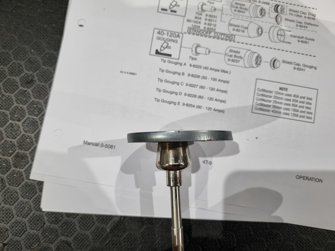

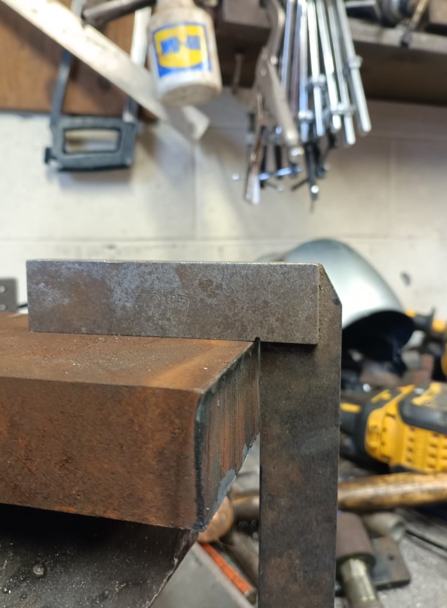

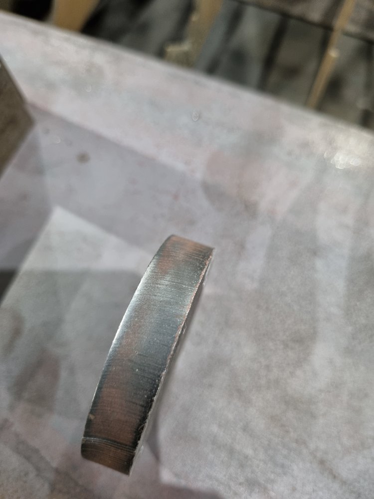

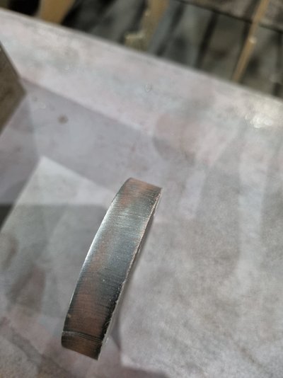

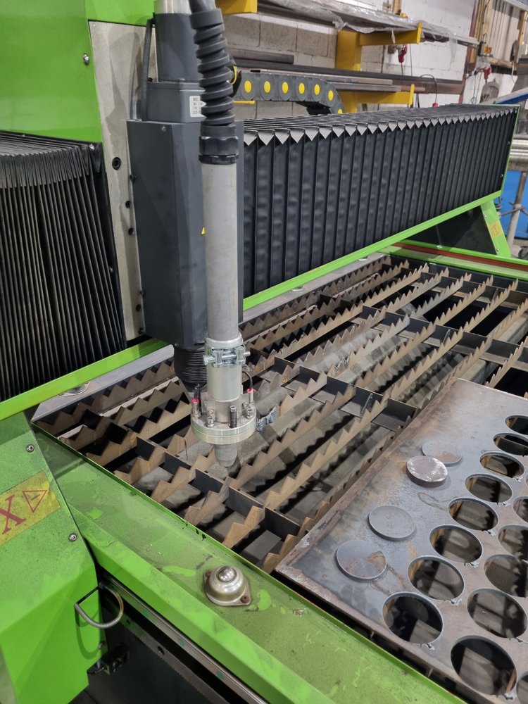

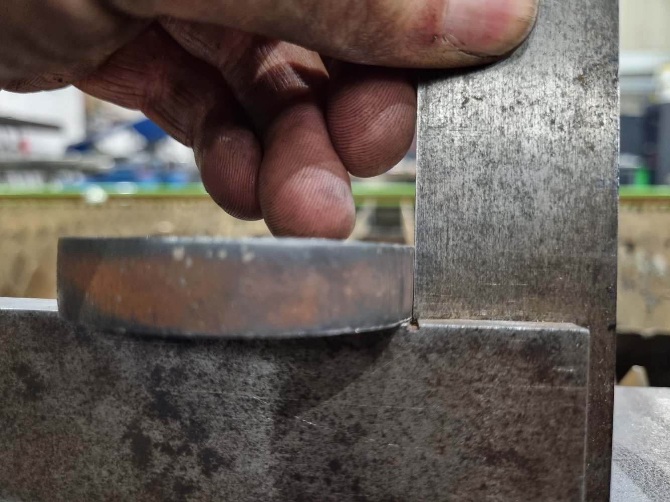

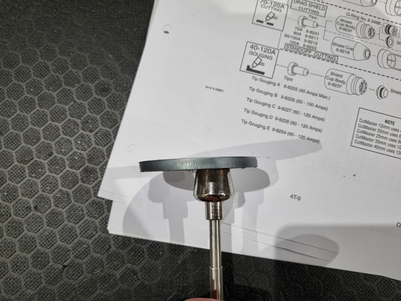

I have a retrofitted P-80 on an old max 100, and found cheap electrodes did not have the hafnium pitYes it does. Its a worn one I've got on there now but it still fires... Could it be causing a wonky arc?
Should be be around right according to the TD manual. The voltage on the THC is correct and the initial height is roughly right (guessed it not checked).Is your torch height correct, too high will cause a bevel . What height is correct will be torch and plasma source dependant.
Should be be around right. The voltage on the THC is correct and the initial height is roughly right (guessed it not checked)Is your torch height correct, too high will cause a bevel . What height is correct will be torch and plasma source dependant.
They are cheap electrodes to be fair. The real ones are £20-odd each... So these are definitely fakes.I have a retrofitted P-80 on an old max 100, and found cheap electrodes did not have the hafnium pit
concentric, caused the same problems. Bought higher priced, problem went away.
Concentricity between electrode & nozzle is a must.
Maybe the start cartridge is allowing some movement ?
yeah that'll be my next thing.Square the cartridge/cap not the torch to the table,
the hypertherm torches are known for it, the cartridge being out of alignment with the body.yeah that'll be my next thing.
Actually I was going to put the whole torch head in the lathe and check with a DTI for run-out on all the surfaces...

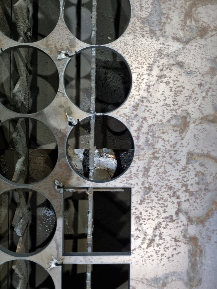

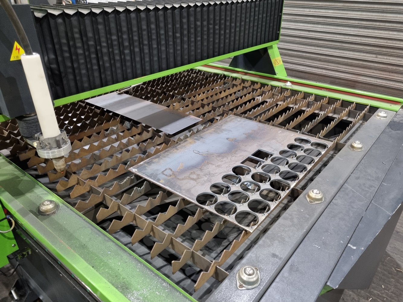

It actually cut some useful stuff today... The discs are packers for setting columns in foundations

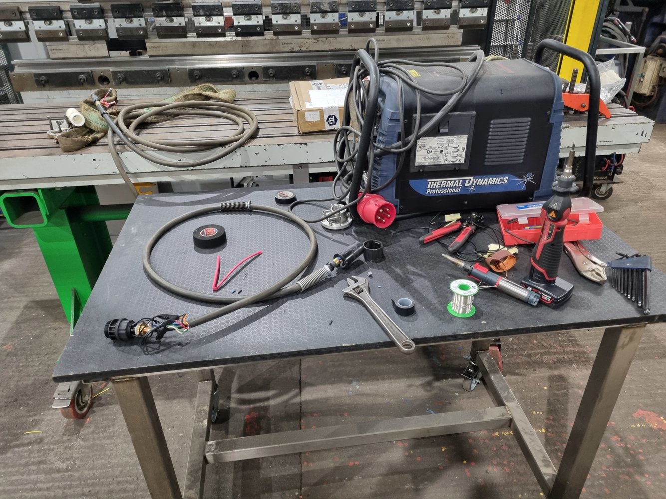

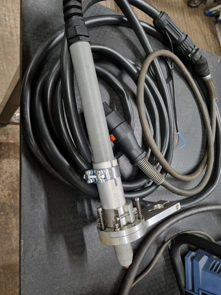

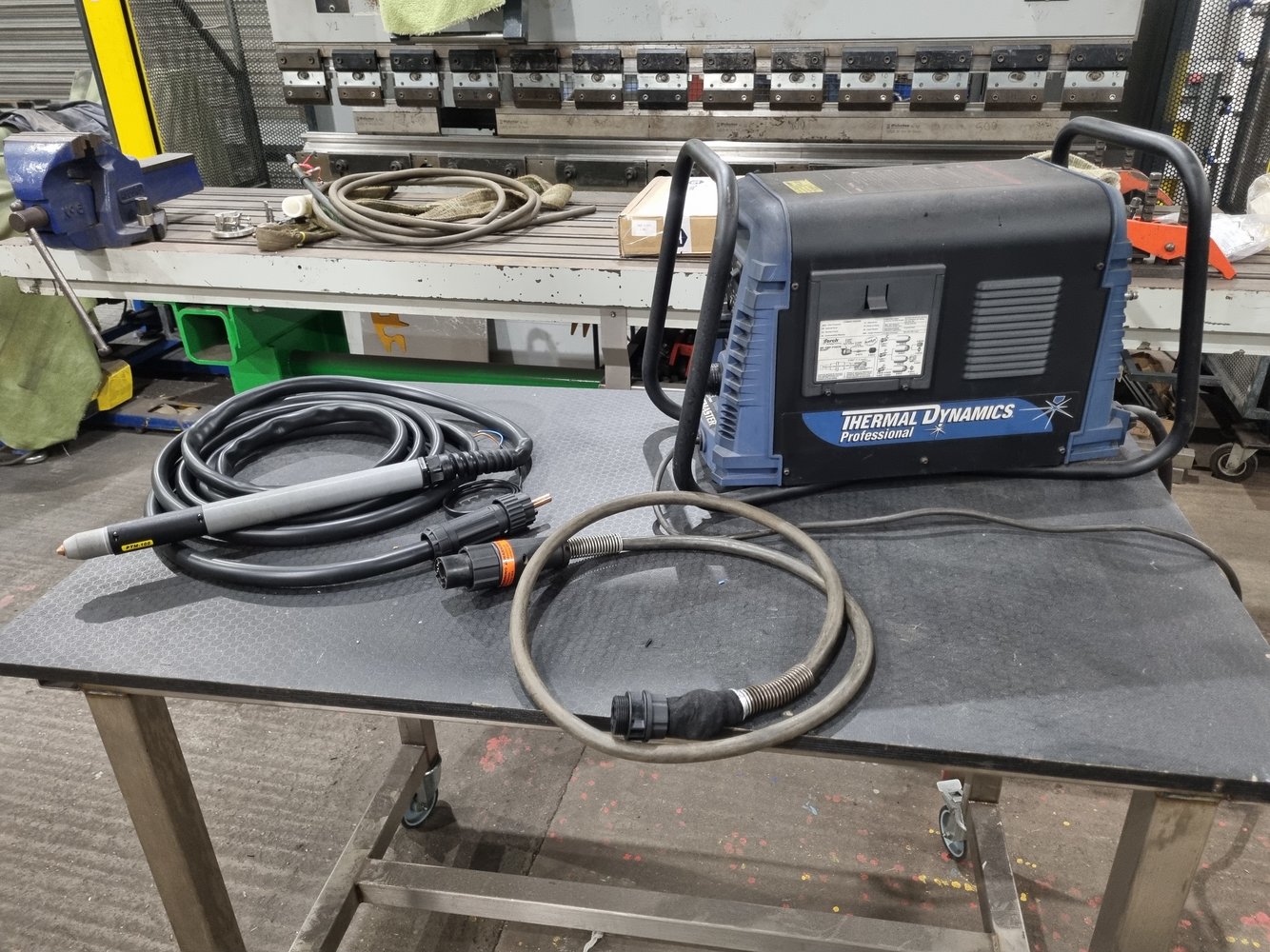

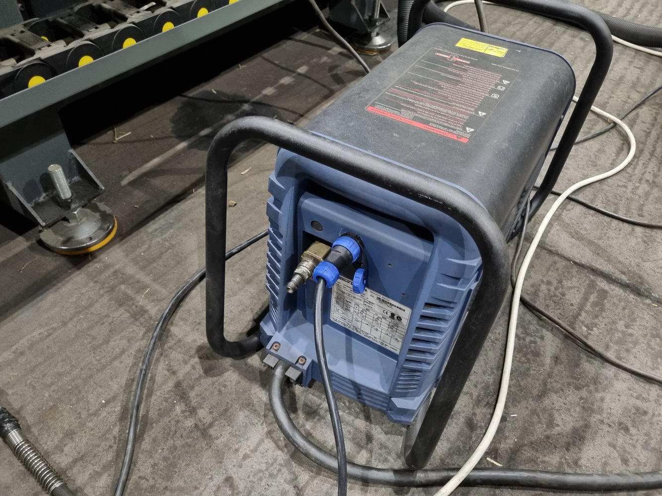

Yeah I think the voltages are way higher because its a shielded setup not bare like the PT100, and also possibly can condense more power in the arc, it looks like a hypertherm copy design.Just looked at the new online manual and it does seem they are supplying the PT100 hand torch (what I got) but the TM125 for the machine torches. I also see they are now listing some feeds and voltages etc for machine use, the voltages are way higher than I would expect with my setup.
Wouldn't the cut height from nozzle end be the same, and the shielded end cause height stack-up meaning it has to sit lower?Possibly.
One other observation from their cut charts is the cut height is much lower than I tend to use, 3-4mm works well for me where with the shielded torch they are saying 1.6.
