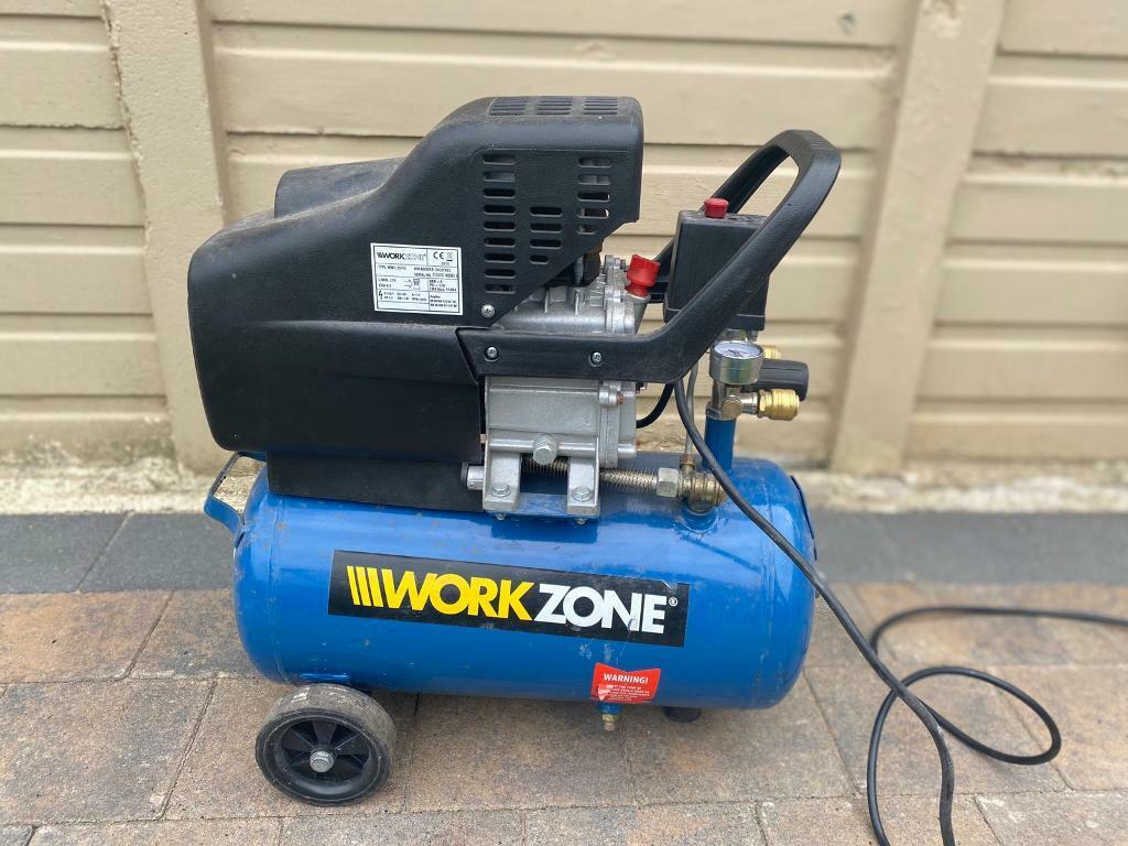

I’ve one of these 2.5 HP, 24 litres, it’s generic and pretty much similar to the one joe mentioned earlier, mine lives in a wheelbarrow so it’s ideal to move around to blow up tyres or operate a nail gun, they regularly come up on gumtree for around £40-50For a bit of thread drift - I’m looking at a smallish compressor, just for tyre inflating and air dusting. I like the look of the Abac L30P Hockenheim 20L, I know it’s direct drive so a bit noisy and a small tank, but it should suit my needs. It’s a lubricated pump - I’m not keen on the oil-free but am open to persuasio.

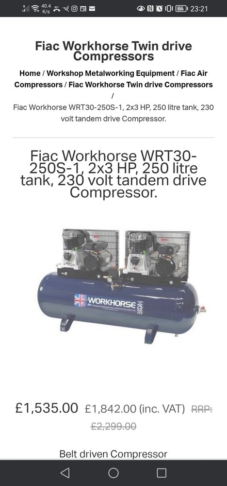

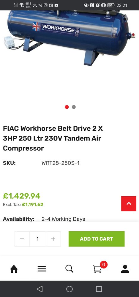

I've been driving myself mad in recent days looking at various options and scouting classifieds for bargain compressors. I did find a clarke xev16/150 that cuts out and needs reset for 100 quid but I think my best bet is to reorganise the workshop, save a bit more money and buy a tandem compressor that will run on single phase. I've already spoken to an old customer who happens to be an electrician and it won't be too much of an issue to sort a 45a outlet.Buy one and see how you go, if you need another then get it. Get a 14cfm belt drive if not upgrading the electrics.
You will need two most likely if using a air fed mask and doing big jobs.
I had actually been looking at the fiac workhorse range because the have been quoting fad figures.I think this is wise.
Buy cheap, buy twice. Or 4x times in my case. The used Tandem one is my 4th compressor and really I need that to serve my needs of blasting etc.
You can never have enough air for alot of tasks and running small compressors IMO makes air tools a horrible experience. Using a decent compressor, high flow fittings and 10mm bore hose etc and the experience is fantastic / night and day difference.
If you can be patient then Tandem is 100% the way to go and skip buying smaller ones then having to sell on and people looking them for nothing.
A 32amp supply is sufficent though and this can double as a welder supply if you wish. I used 6mm cable and a type C MCB which is important to avoid false trips.
EDIT: 32Amp supply is for 3Hp motors. I see some Clarke models are 4hp motors which would require 45amp supply. But would be VERY heavy duty I suggest a tandem 3hp unit

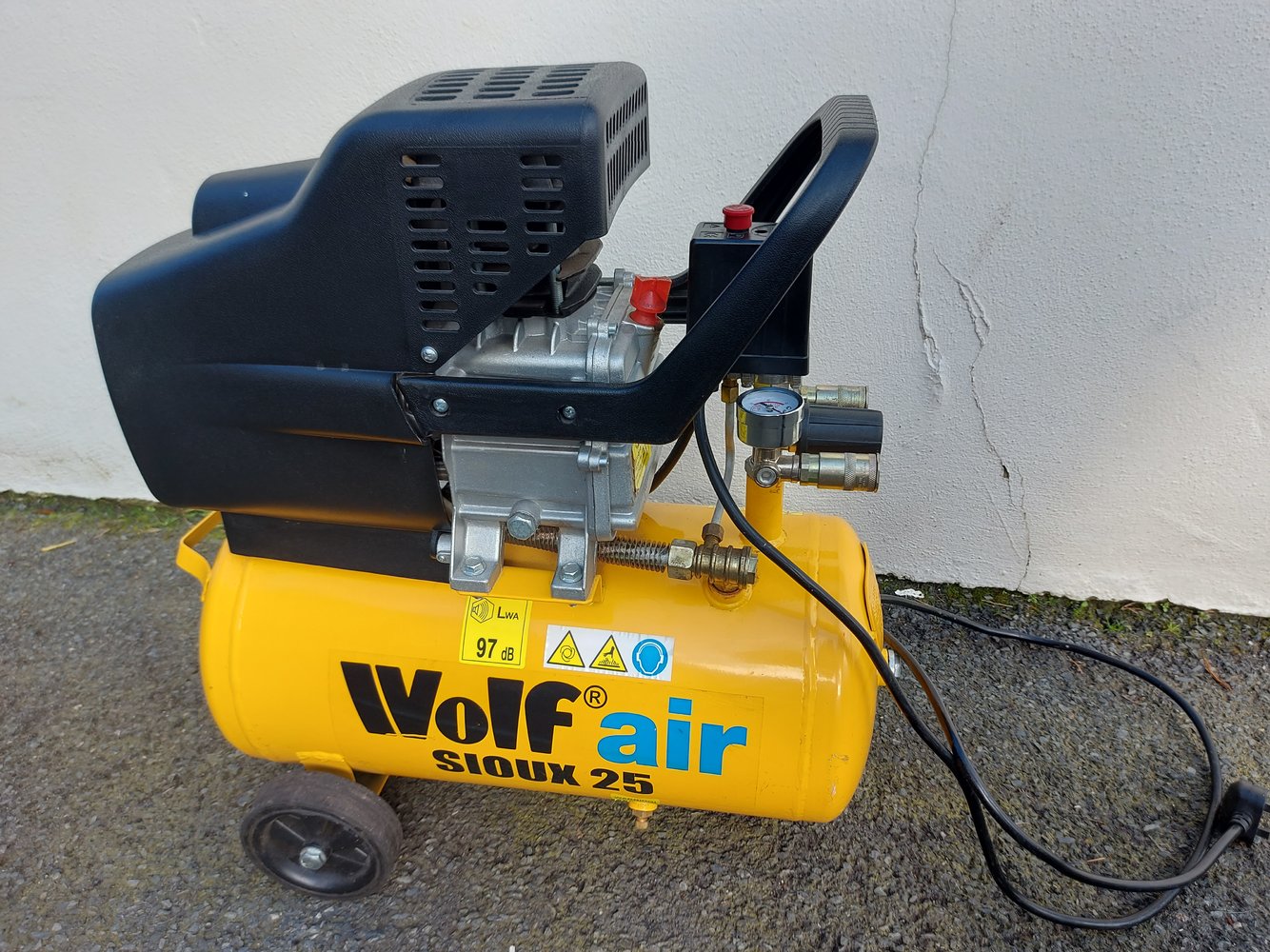

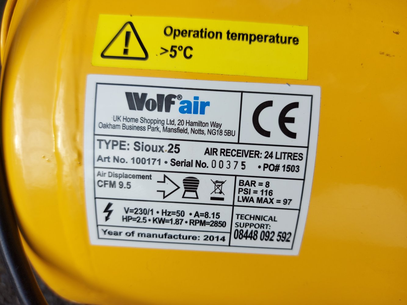

My friend is running a part time tyre business with a full blown tyre changing machine on one of those Sioux 25’s!I had one of these and it was OK for what it was. Not sure where you are located but if in UK they are cheap enough too
