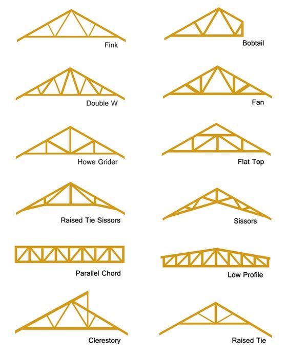

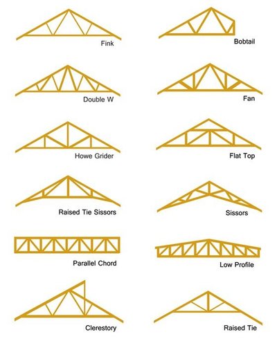

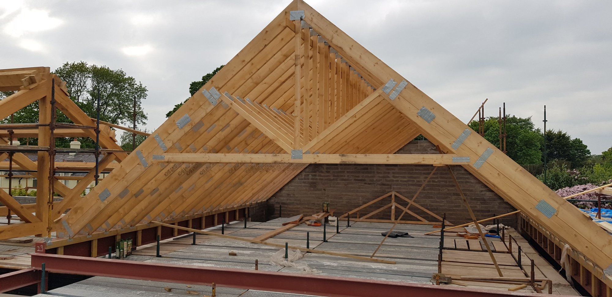

I refurbished an old stone barn. For the roof structure it was far cheaper and quicker to just order pre made trusses through a builders merchant than it would have been remaking trusses etc.

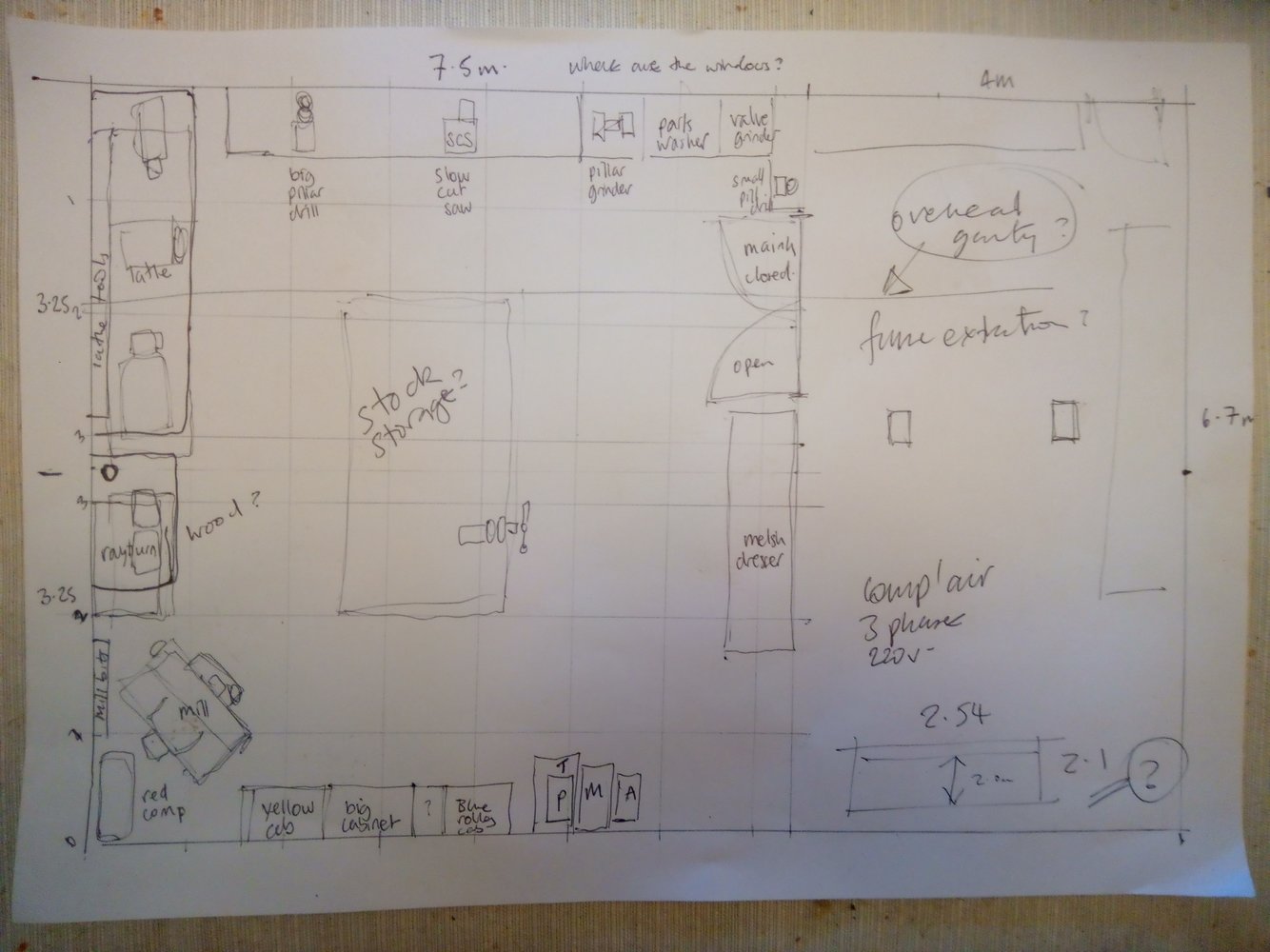

just to note here i wouldnt want a wood burner near anything that is oiled as it would suffer drying out the oilI'm going to divide the workshop.
2/3 Machine / welding shop.
1/3 2 post lift, for working on cars and vans, a wall between the two, so the machine shop can be kept nice and warm, I've a spare wood burning Rayburn to go in there.
Ceilings at 2.2 meters +-.
Here's the rough plan.View attachment 285330
