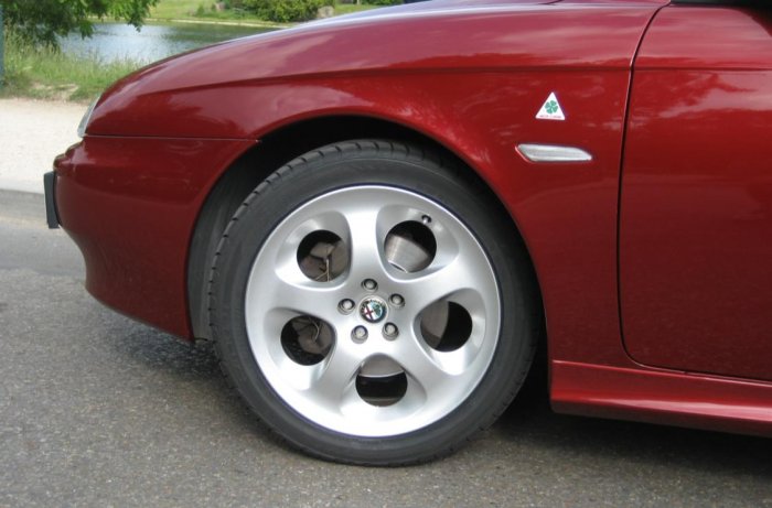

17" & runflats... my idea of hell on the road.....wont even concider any wheel that takes less than 65 section. & I dont care what it looks like, its comfortable, and unnessisary.

Last time I drove a car with that section of tyre I managed to fold them under the rims round a roundabout!
