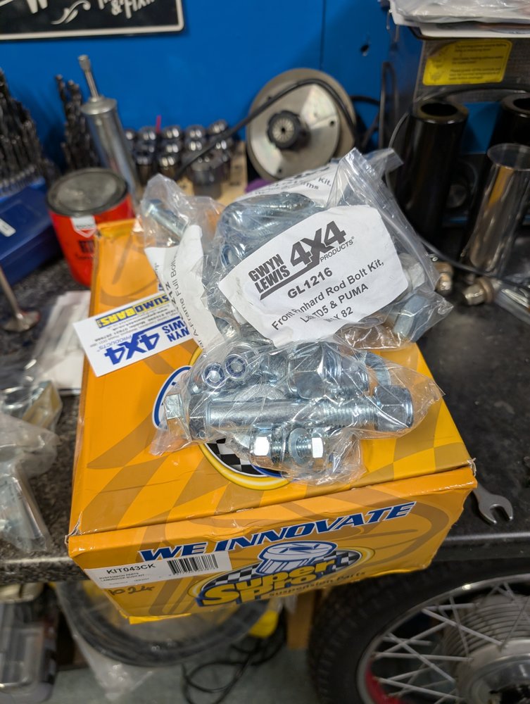

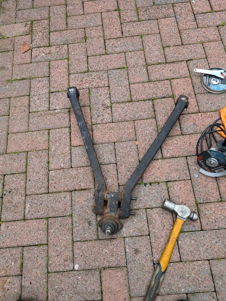

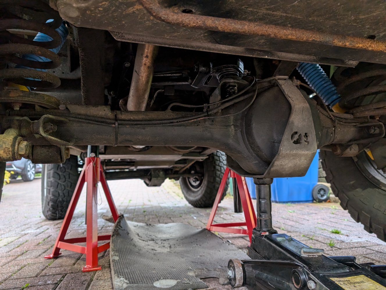

A good rest.Well the A-frame ball joint proved a marathon.

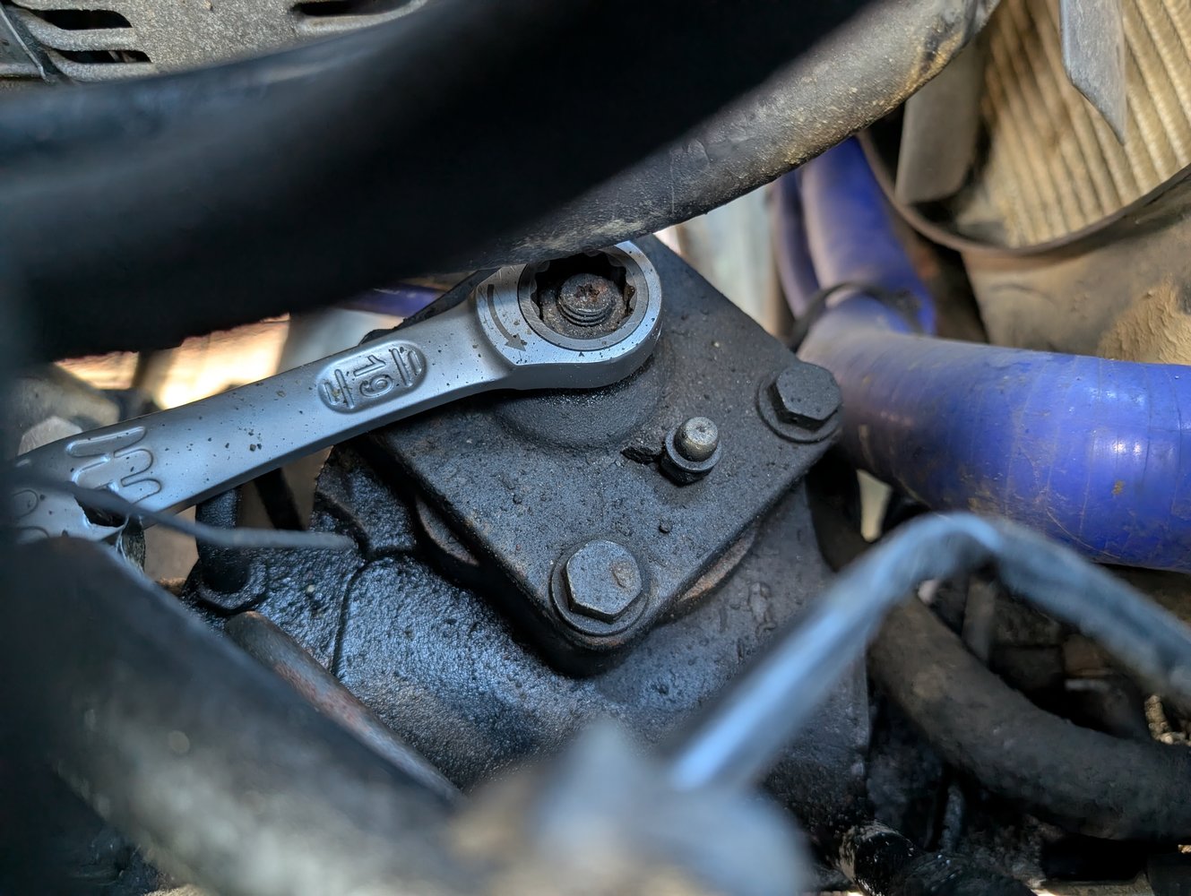

The long 19mm bolts that go through the ball joint casting would not move after an hour with the heavy hammer!

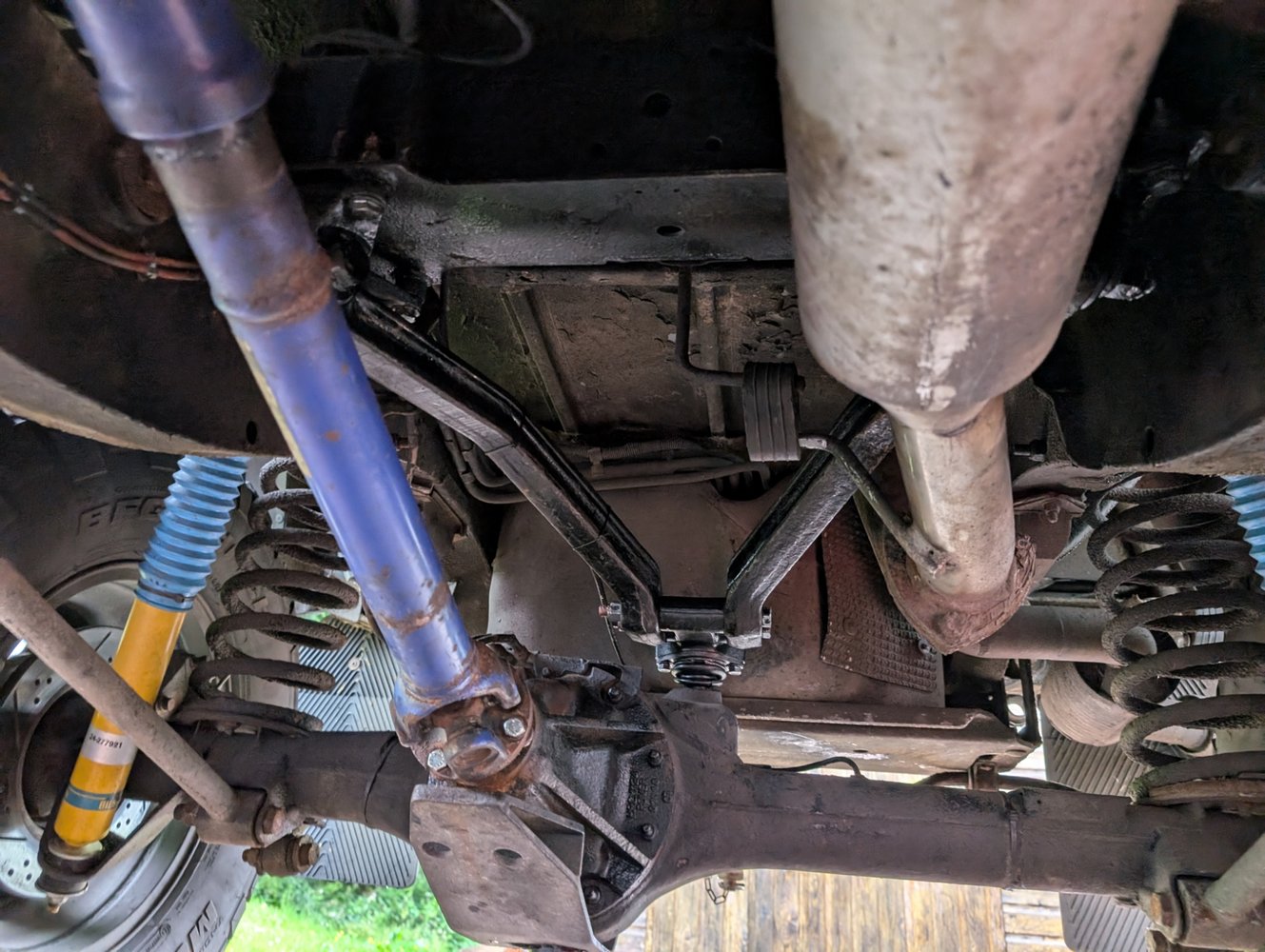

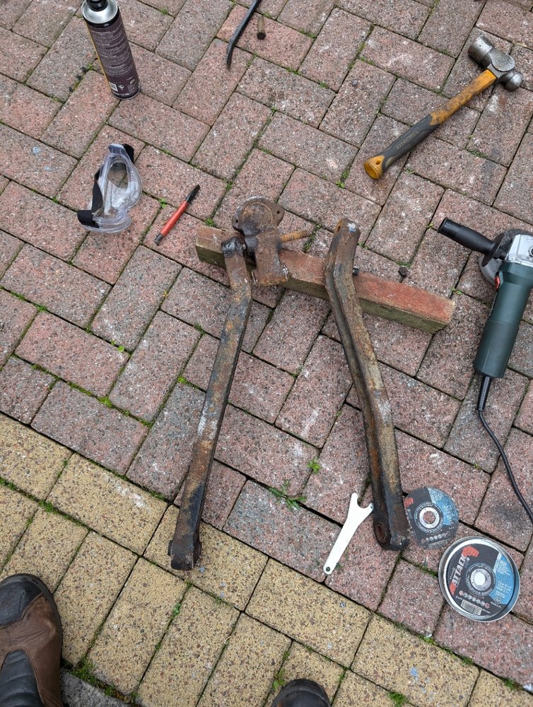

so just took the assembly out:
Then angle grinder!

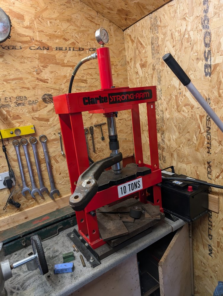

Needed the press to get the remains of the bolts out:

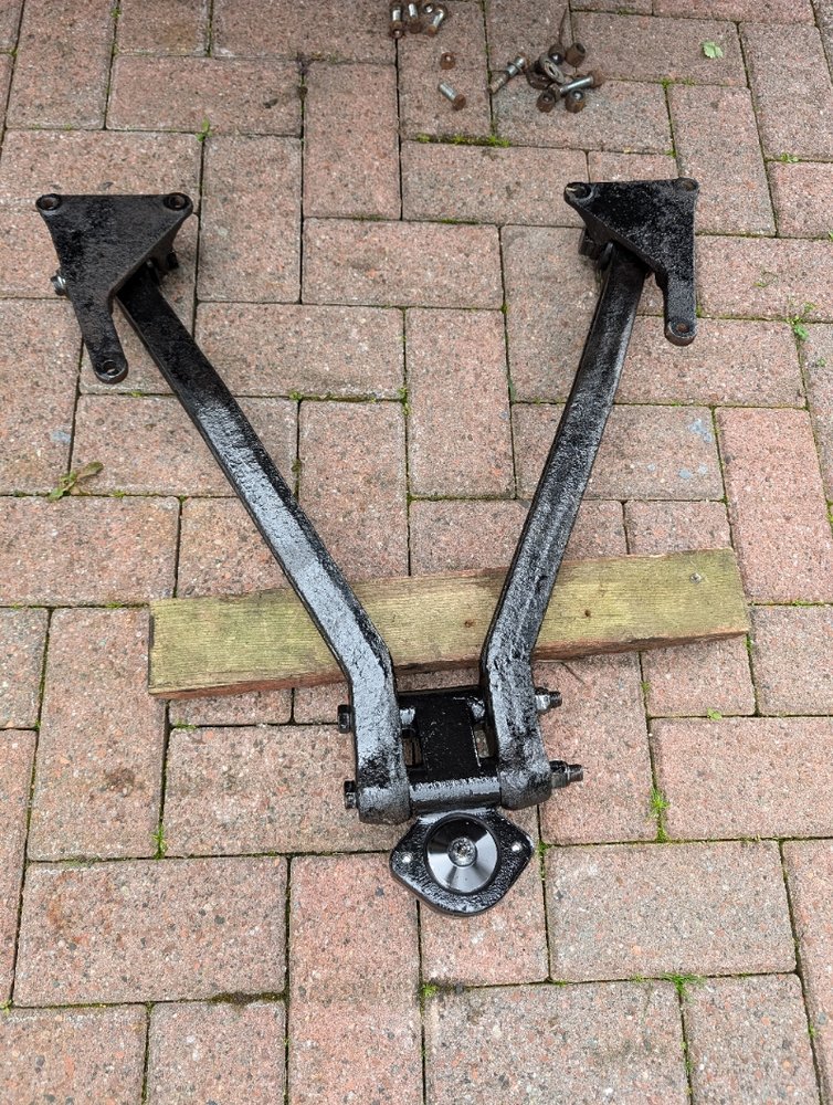

New super pro bushes, Gwynn Lewis greasable Lemforder ball joint with silicon seal and all new bolts well coated with coperslip
and wrestled it in with the propshaft out:
Glad that jobs done, was at it from 8:00 to 8:00 today bar lunch and dinner
